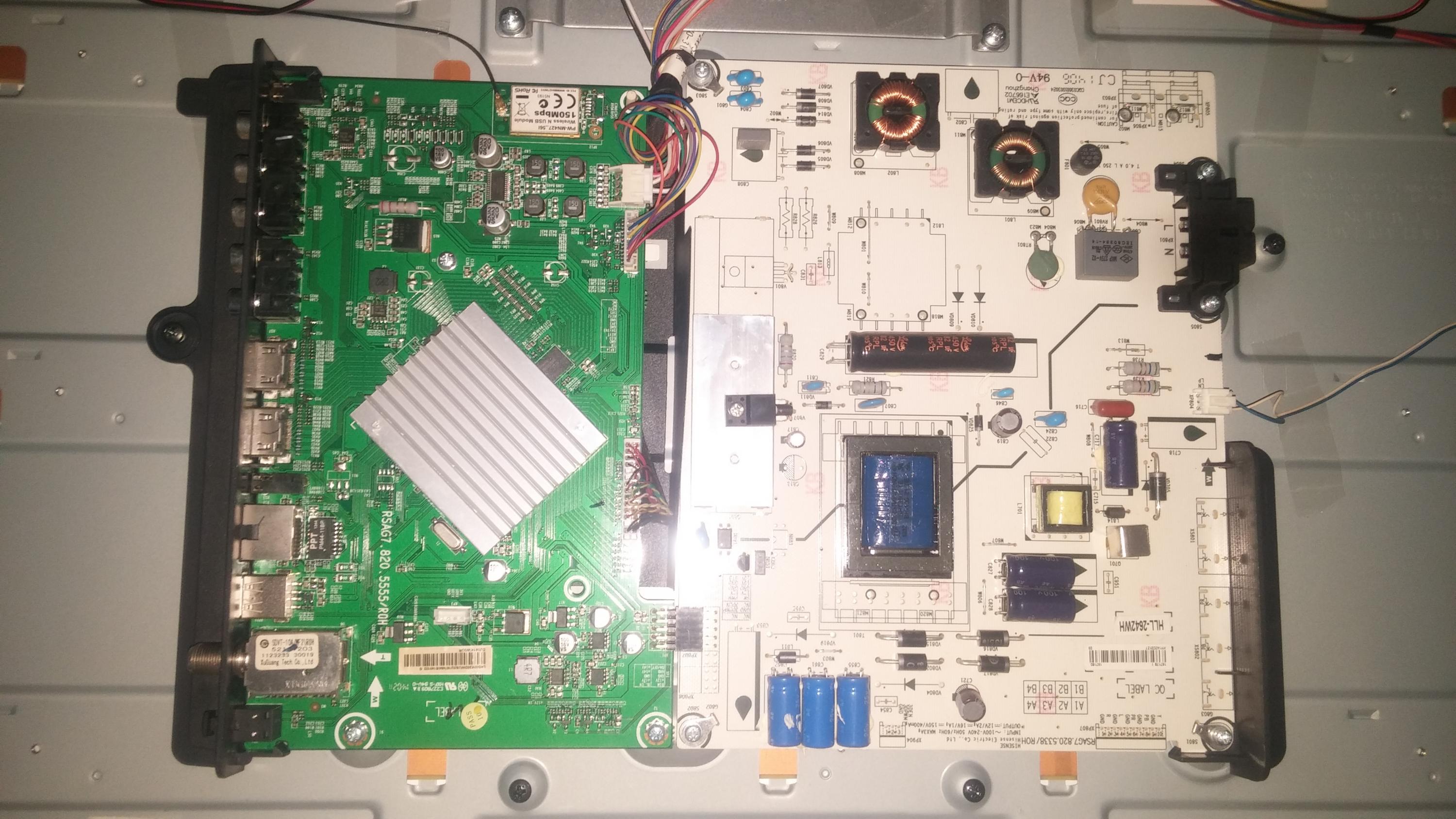

    Hi All!
    I,m troubleshooting a Hisense 32K20DW that won't turn on.
    5VSTB is present when the set is off. When turned on, 12V are present, SW >4V. No sound, video or backlight. The STB LED blinks 6 times, then goes off.
    Here are the pins and voltages at the 10-pin connection to the Main Bd:

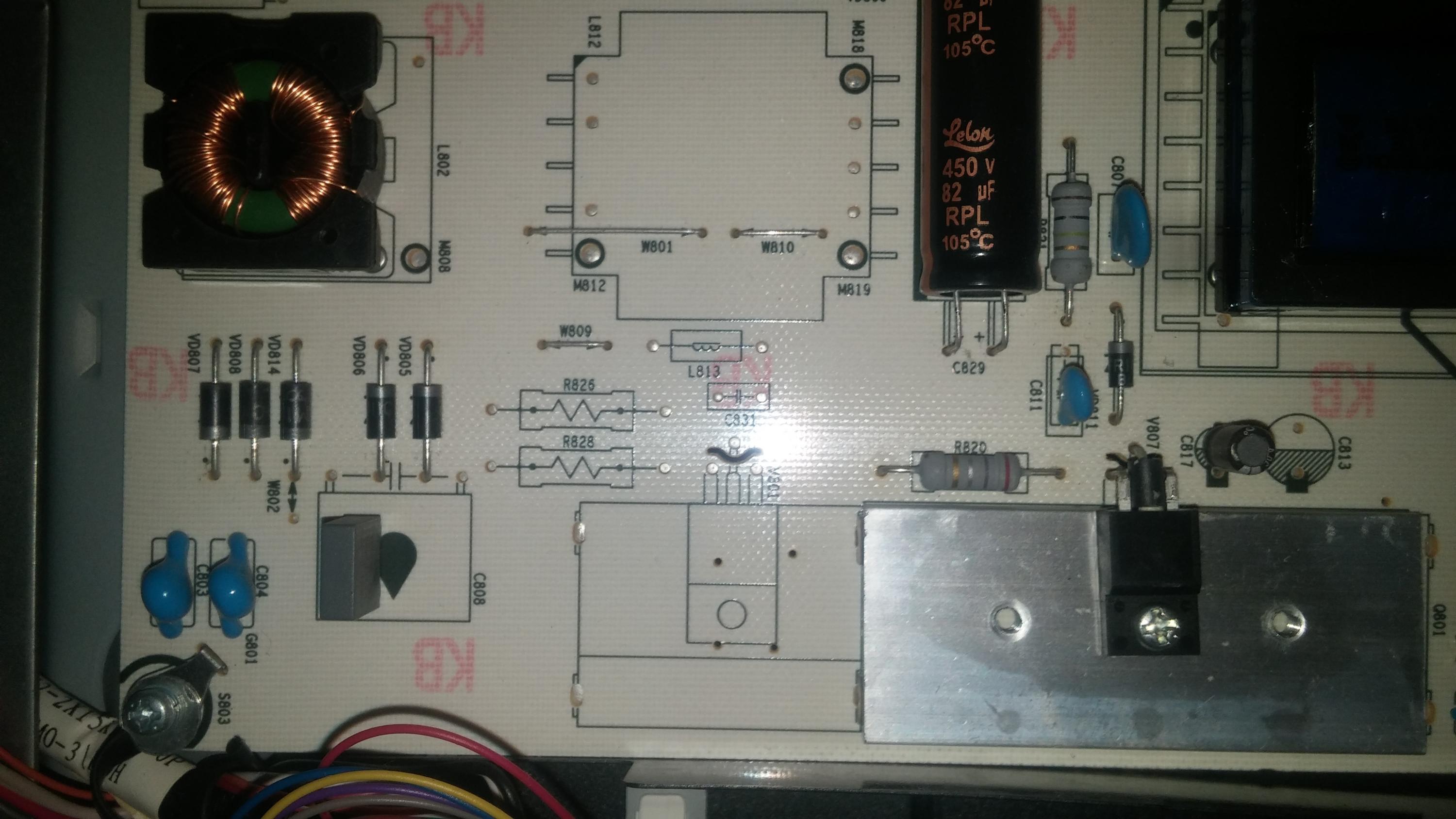

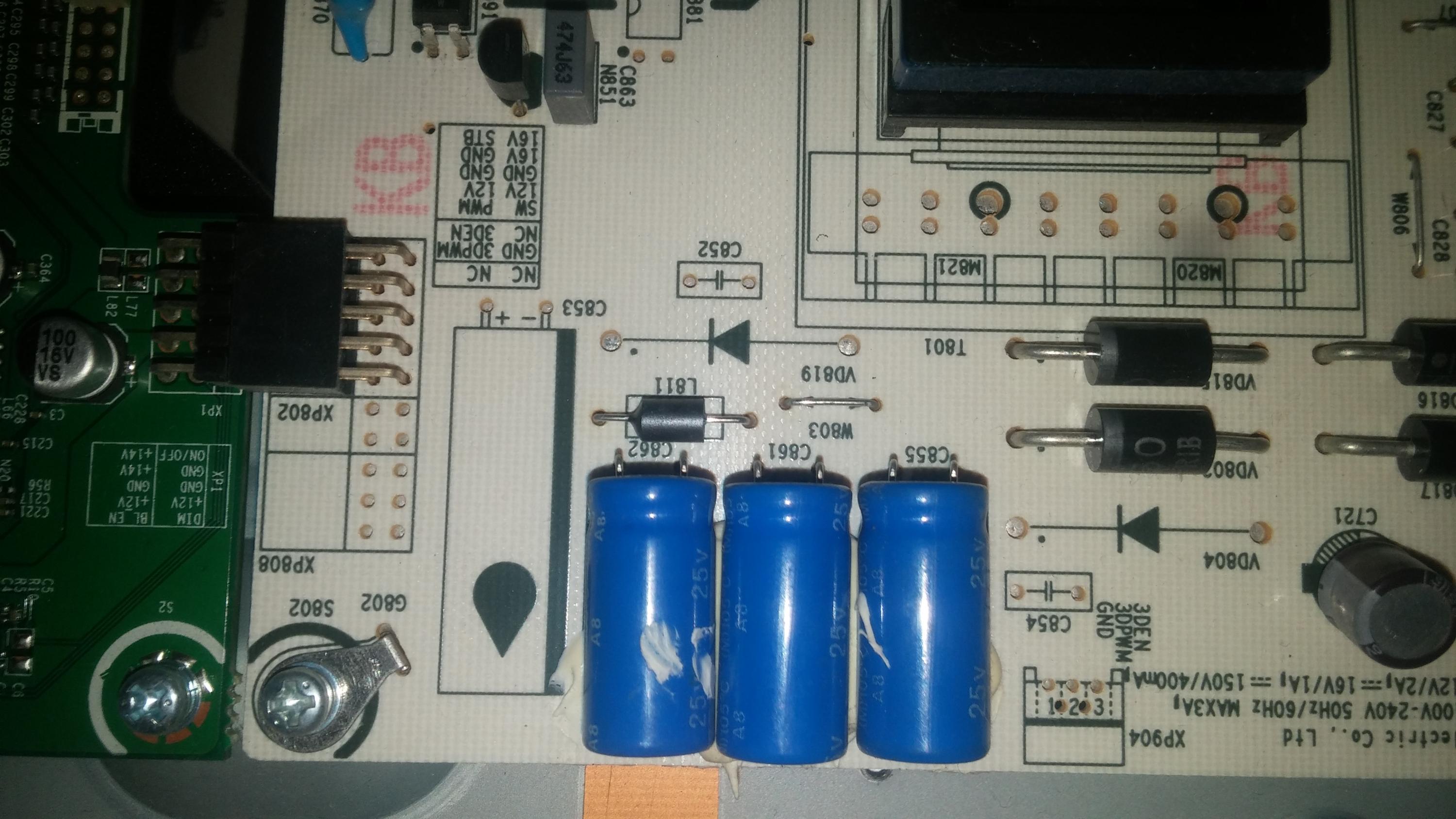

    Strangely enough, the largest cap C829 reads both 178VDC and 368VAC across it's leads with my VOM.
    Other caps on the PSB and their on voltages follow:
    C827,828 45V
    C855,861,862 12V
    C717 by LED pwr 0V
    I suspect power supply, would greatly appreciate knowing if these factors point to any specific component.

    The large cap reading 2 different voltages is normal. The lower voltage is rectified mains, the higher voltage is boosted PFC voltage. From what you are saying, the main board is turning the PSU on, but the 16V rail is dead. So either there is something wrong with the PSU on the 16V rail or the main board is dragging it down. You can try forcing the PSU on without the main board attached and check if the 16V reappear. Or try to take the 16V pin out of the connector?

      I separated the PS from the Main Board and jumpered 12V to ST on XT802 with a 1.2K resistor (since STB was not present, it seems to be made on the MainBd.)
      Still no 16V.

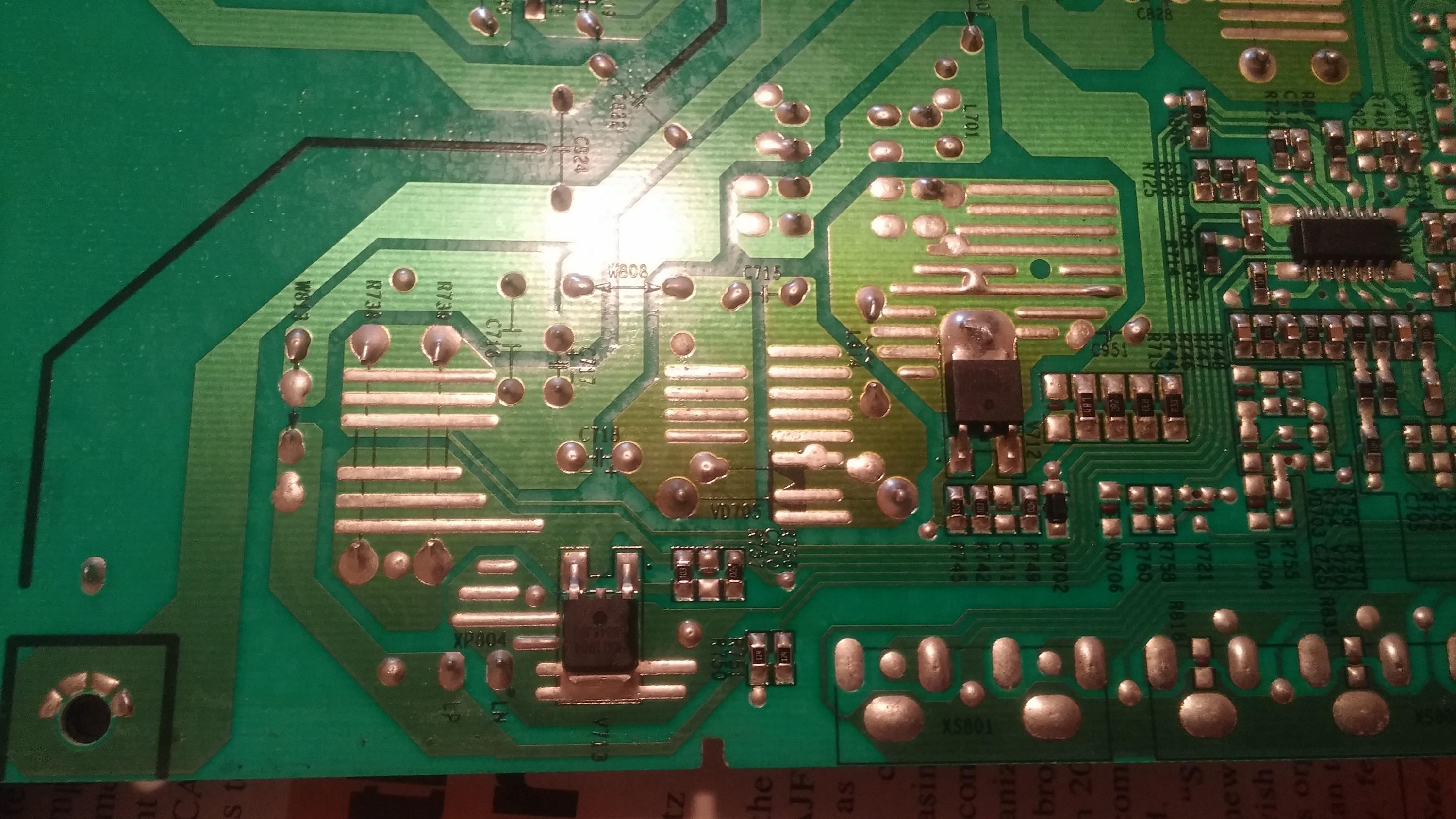

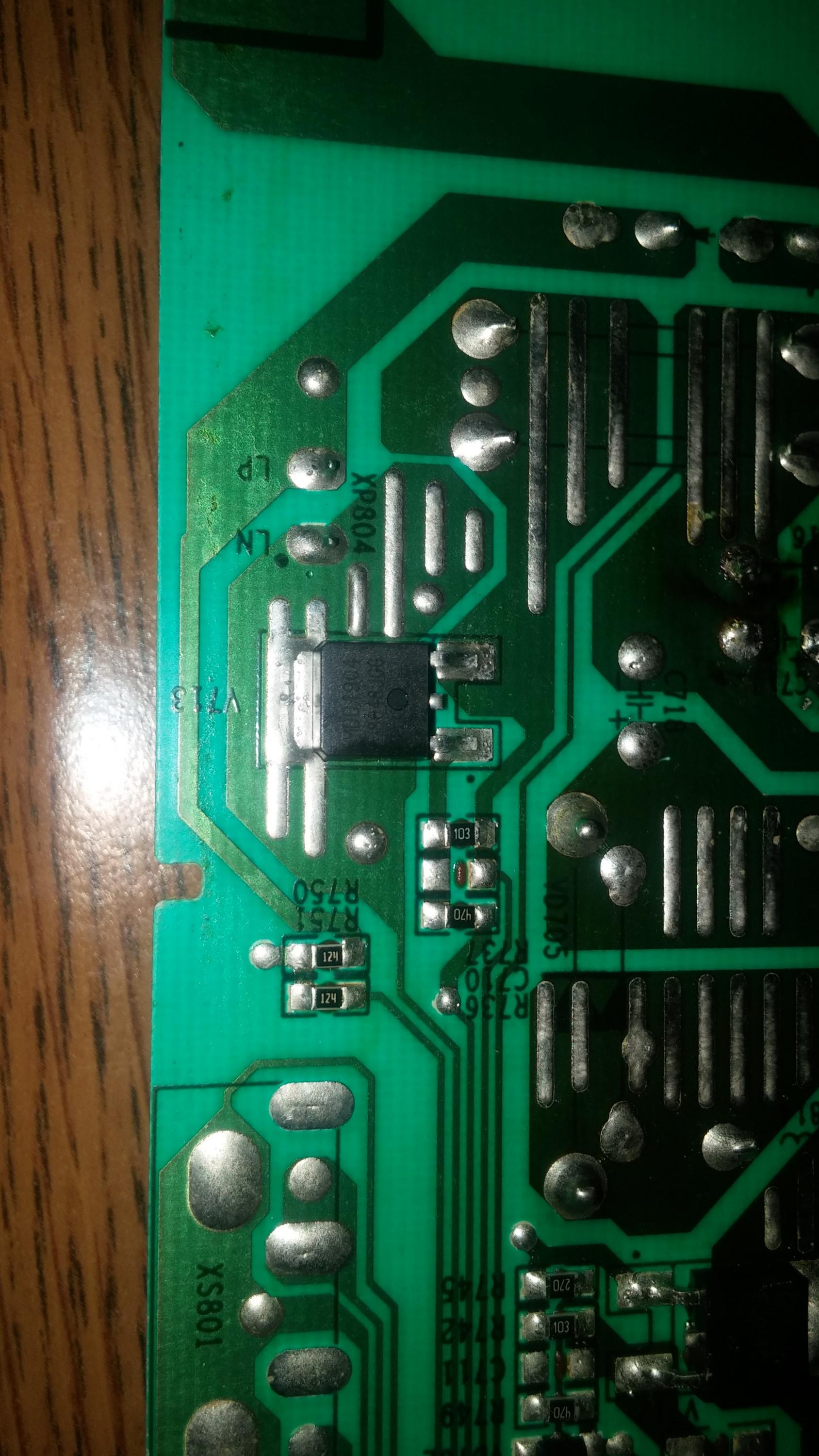

      The attached photo shows the rear side of the PSB. V712 and V713 look like voltage regulators. One has 46VDC on the large solder tab, but nothing on pins 1 or 3. The other has no DCV on any pin or tab.
      I'm digging through the attached Hisense schematics elsewhere on the web site. If anyone has a link to RSAG7.820.5338 PSB and RSAG7.820.5555 Main Board schematics please point me there!
      Thanks for reading!

        I was able to look at that PSU over at SJ on the front and back. Looks like the 16V is not installed on yours. The cap C853 and diode VD819 are not installed on your board. So you can't have any 16V.

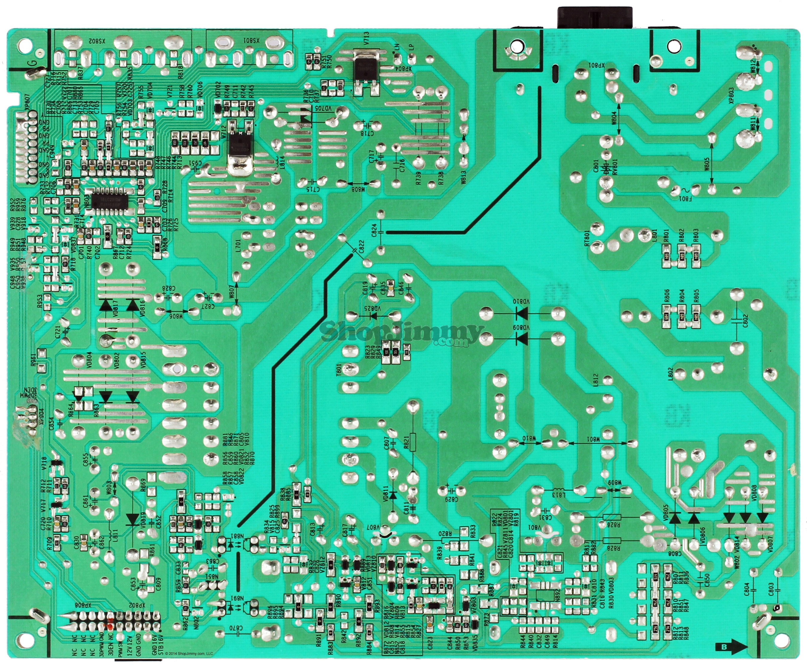

                    can we see the straight shot pictures of the whole bottom side of the board? There should be an IC controller for the LED backlights.
                    Right now you have 45V input to the boost converter but no boosted output Voltage for the LEDs.
                      courtesy to SJ
                      http://assets.shopjimmy.com/media/ca...180-bottom.jpg
                        Re: Hisense 32K20DW missing LED voltages and 6 blinks

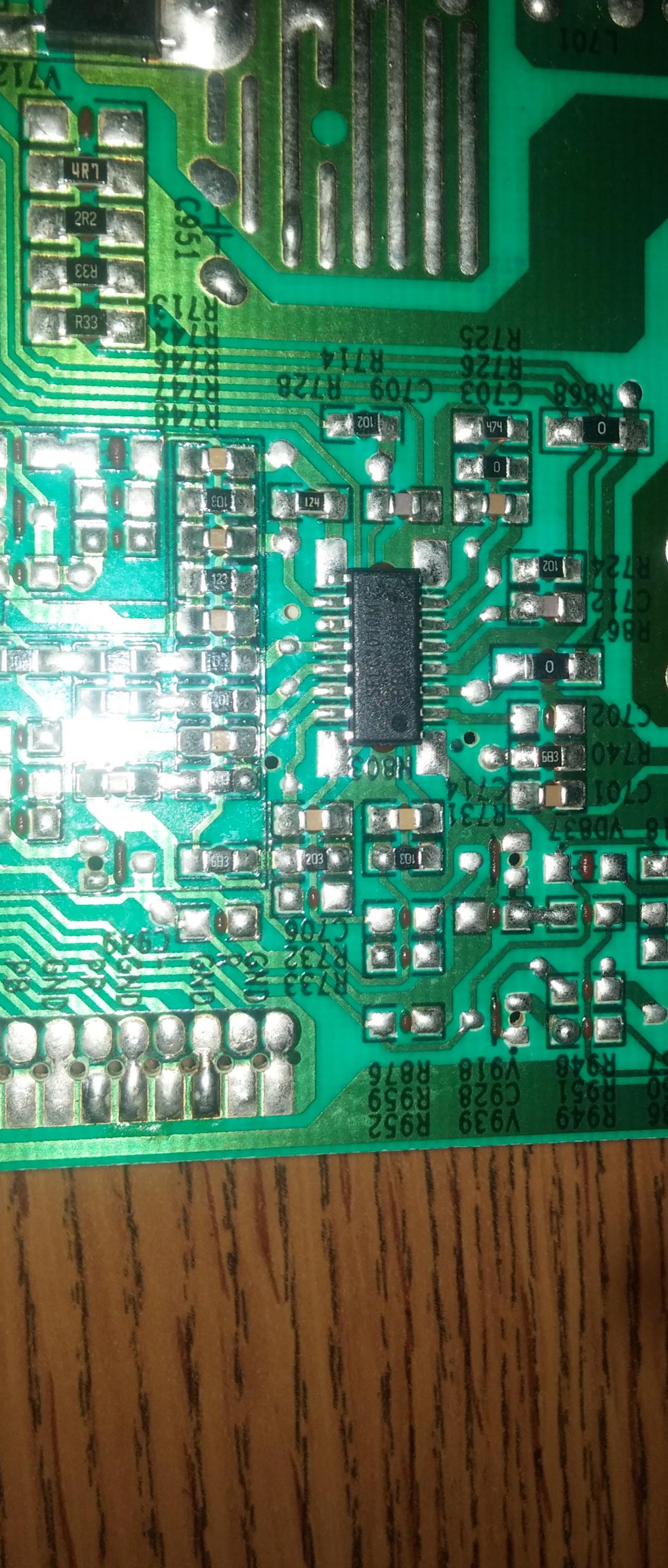

                        IC N803 is the LED Backlights controller.
                        MOSFET V713 is the PWM controlled for the LED string (Cathode) return side.

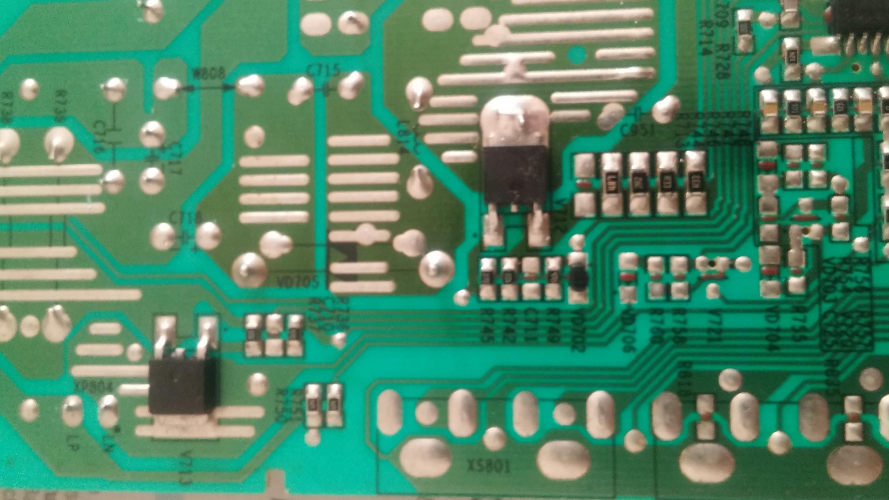

                          V712 has 40.5VDC at the tab and at XP804 pin LN. V713 shows no DCV at any point. It's tab is tied to XP804 pin LP.
                          What are the key pins to probe around N803, the controller IC?

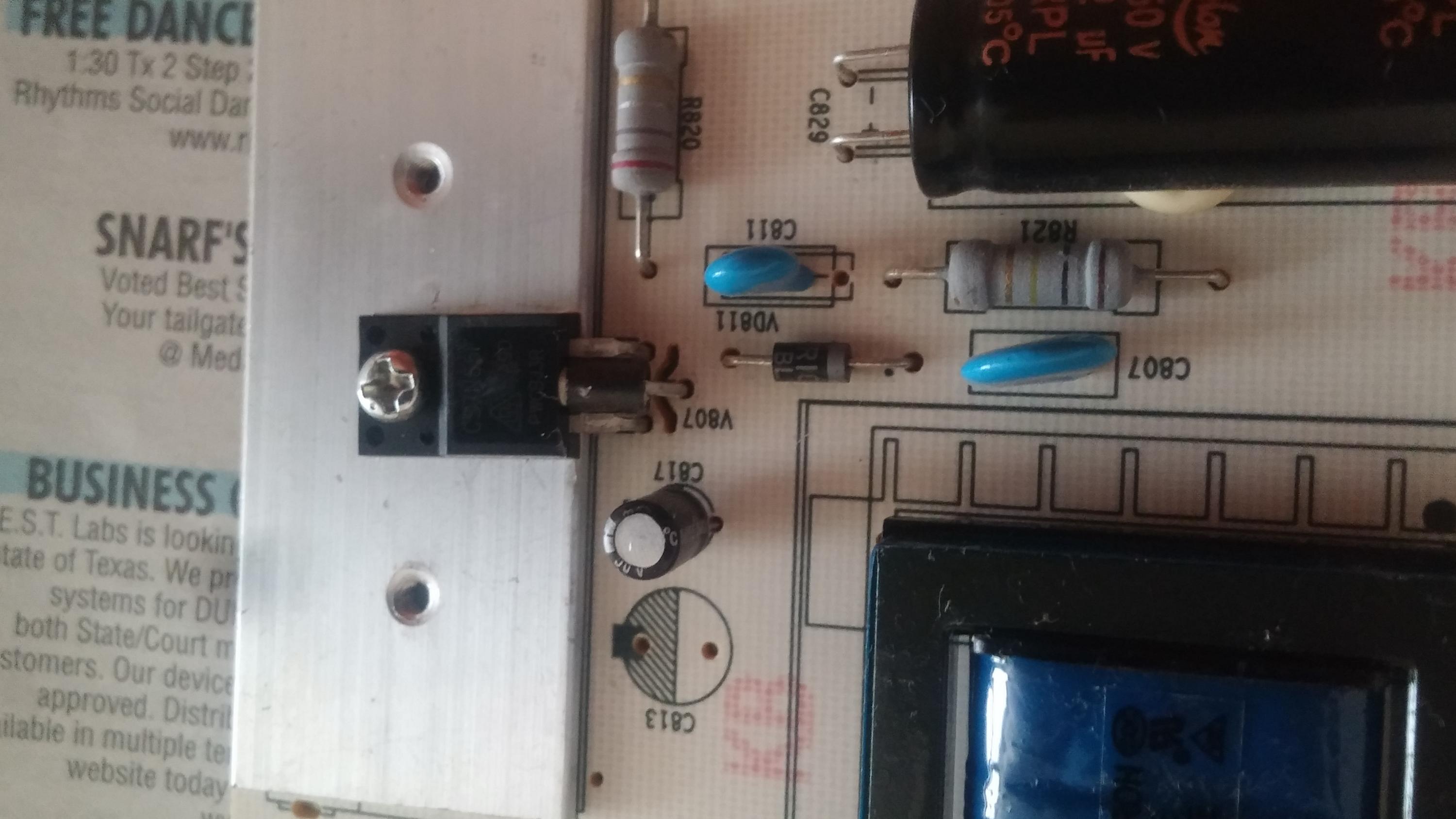

                          On the photo of VD811 and V807 on the top side of the PSB, what is the significance of 180 VDC on the center lead, which appears to be a diode?
                          What range of voltage should I be looking for on the return side of the LED supply?
                            I think you have measurement error, the LP pin of the xp804 connector is the boosted output pin to the Anode of the LED string, this LP pin is connected to the Cathode of the diode VD705 and it is also connected to the + pin of the C717 (filter cap for the booster circuit which you said it shows 0 VDC between the two legs of the cap), the Anode pin of the Diode VD705 is connected to the output end of the inductor L814, input end of the inductor L814 is connected to the big tab of MOSFET V712 which you indicated that you have 40VDC on the tab, so it must be measurement error to have 0 VDC on the capacitor C717 unless the inductor or the diode has open circuit. You need to verify that again, I am sure that you should also have 40VDC at the LP pin of connector XP804.
                            If you trace out the connection at the bottom side you will see what I have describe how the circuits are connected together.
                            Right now 40V is just an input Voltage to the booster circuit and it is not being booster high enough to light up the LED, I expect it to be around 70~80V range.
                            We also need the P/N of that LED controller IC.
                            BTW, the LN pin is the Cathode return side of the LED string.

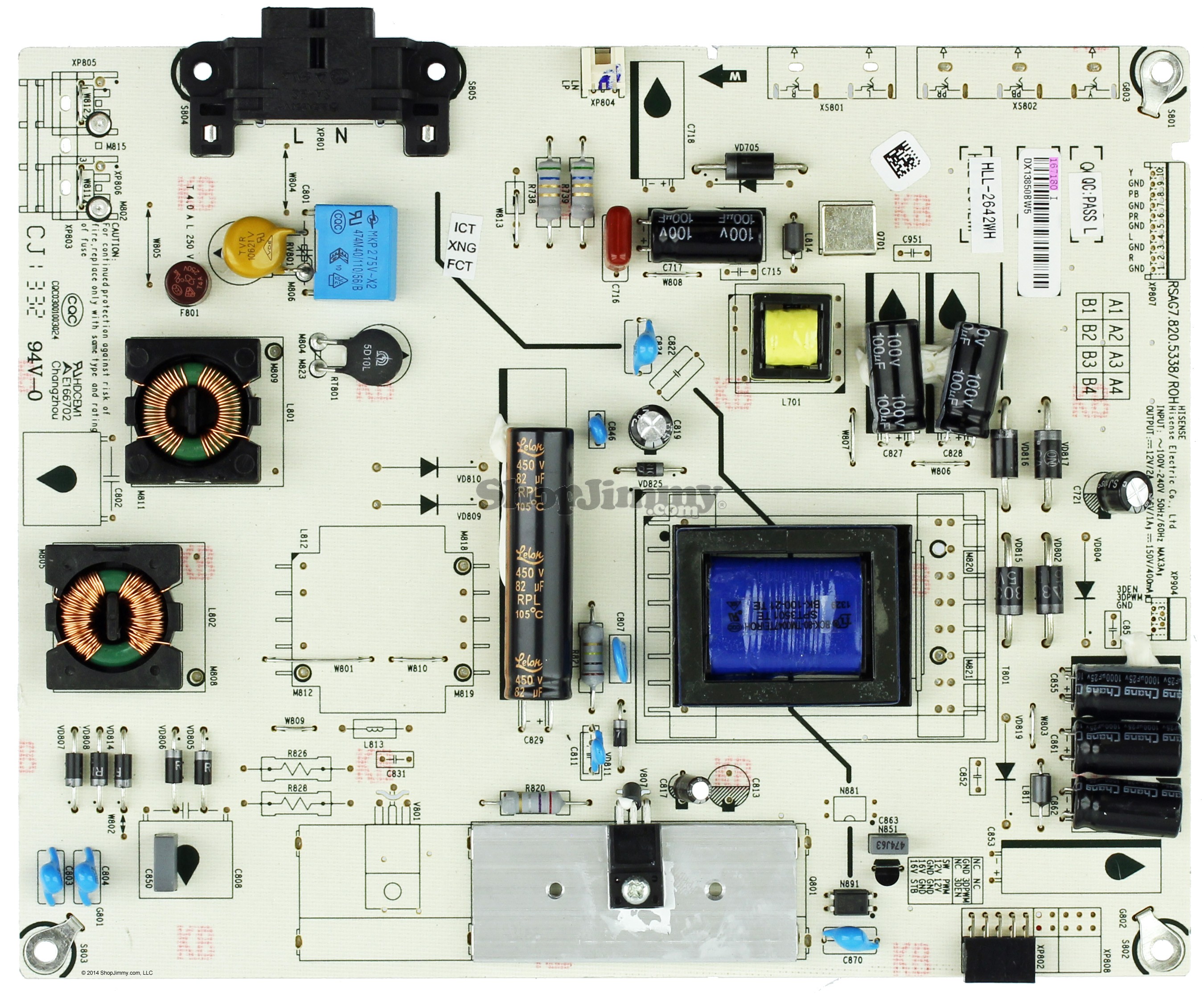

                            Pictures provided by shojimmy:
                            http://www.shopjimmy.com/hisense-167...upply-unit.htm

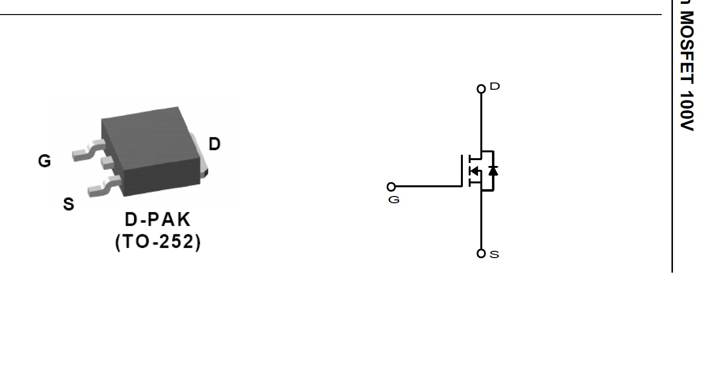

                              V712 is shorted pin to pin. I confirmed this by raising one leg. MDD1904 is printed on the FET. It's a good part number so I'm going to order a couple.
                              The 14-pin voltage controller N803 has a number BB0533GP.
                                The picture you show: https://www.badcaps.net/forum/attach...4&d=1462678576 is for V713 (MDD1904) which is for the Cathode for the LED string return.
                                <1 Ohm reading between pin ? and pin?

                                  I measured 0.2 ohms or so between S-G, G-D(tab) and S-D, even after desoldering and lifting the S leg.

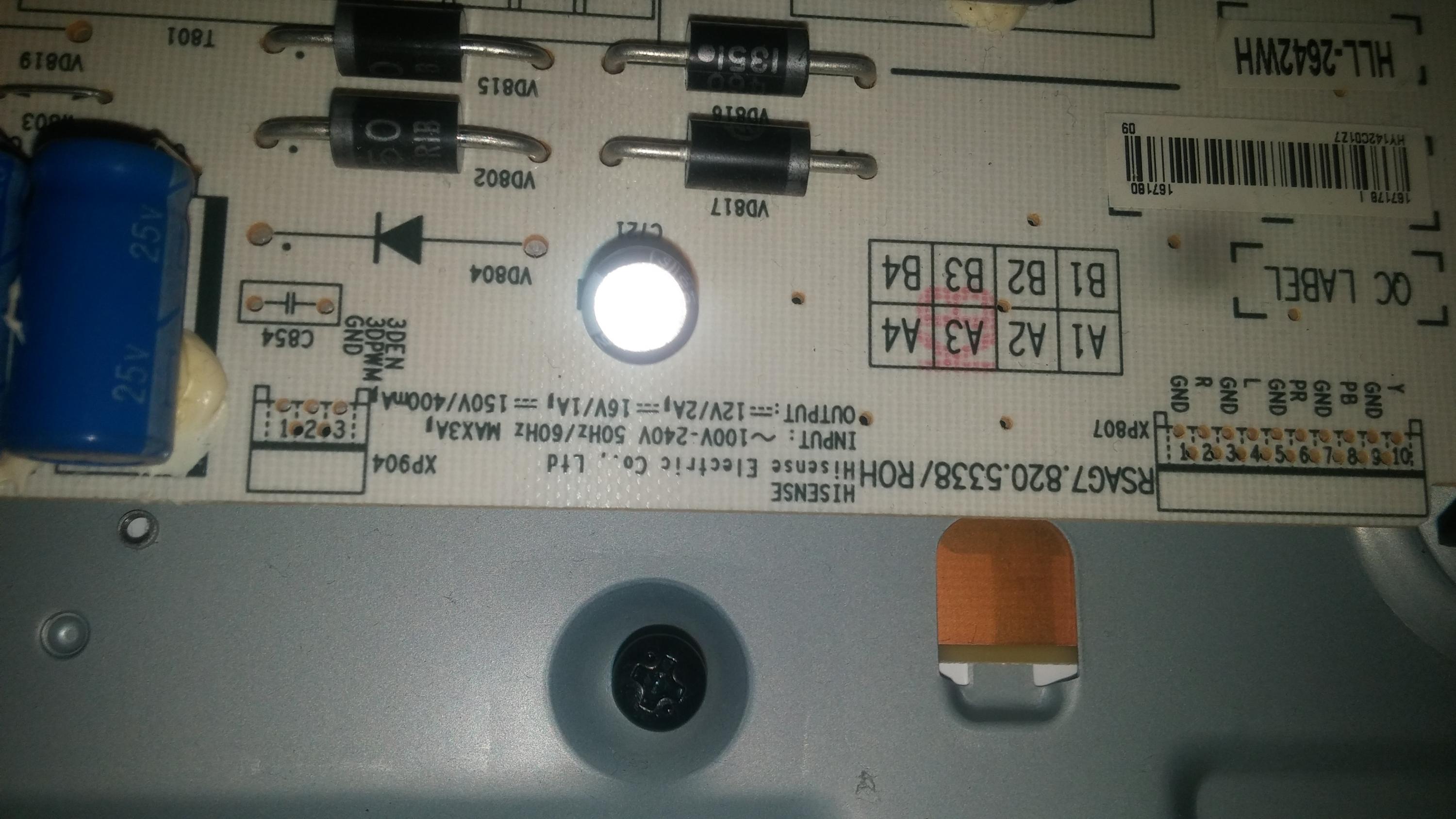

                                        I believe the led voltage should be 150V at 400mA as written on the power supply board.
