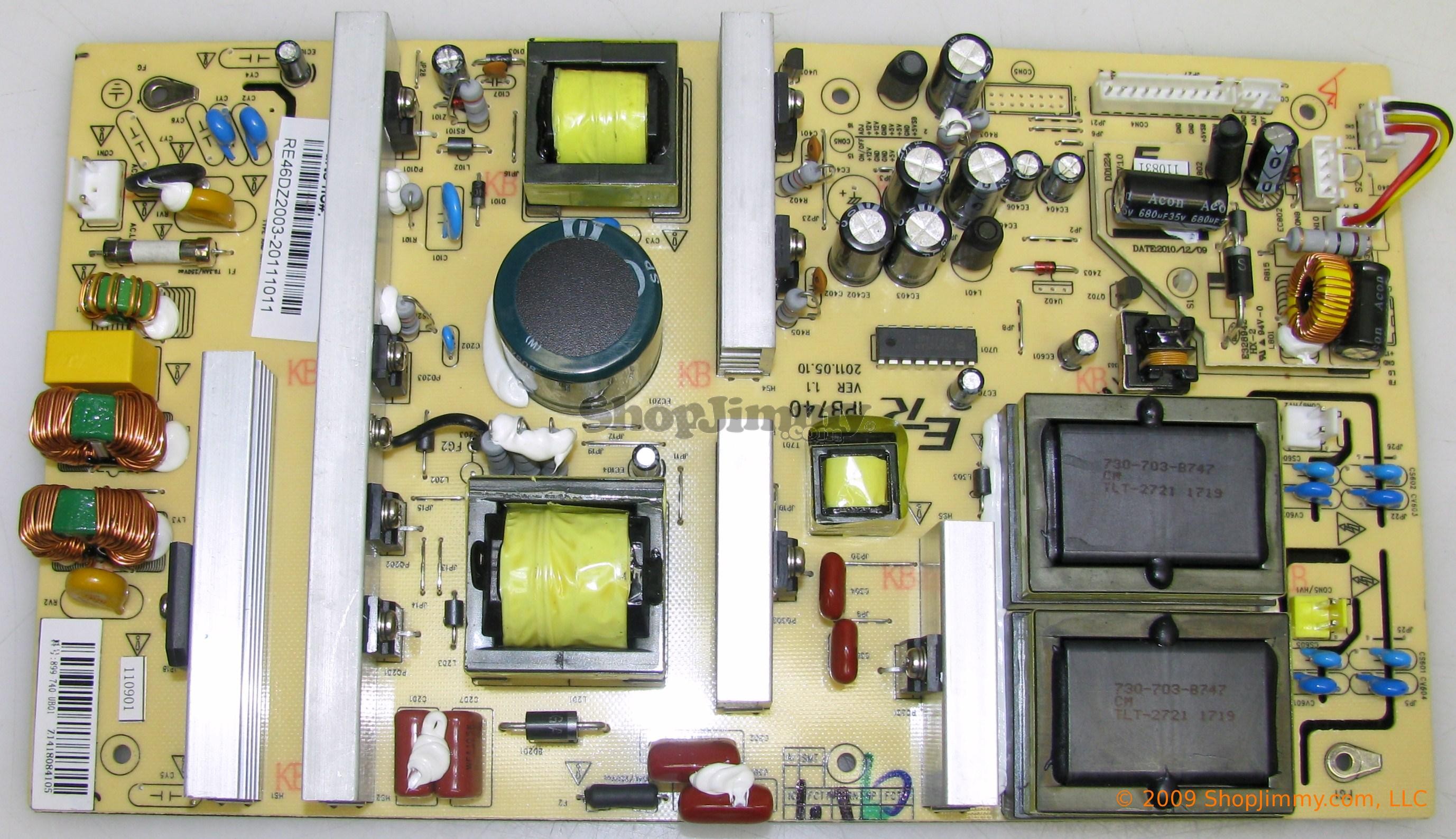

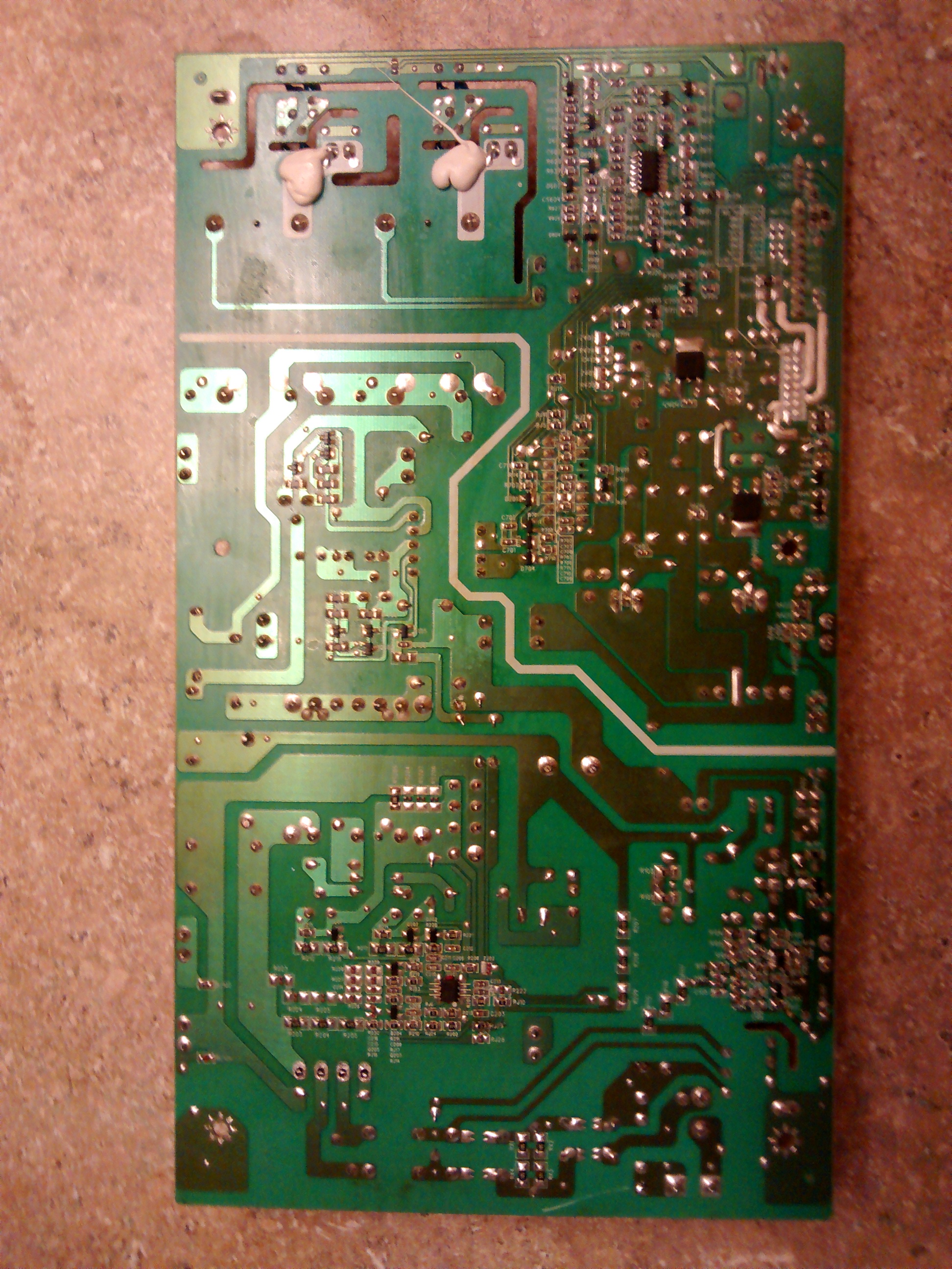

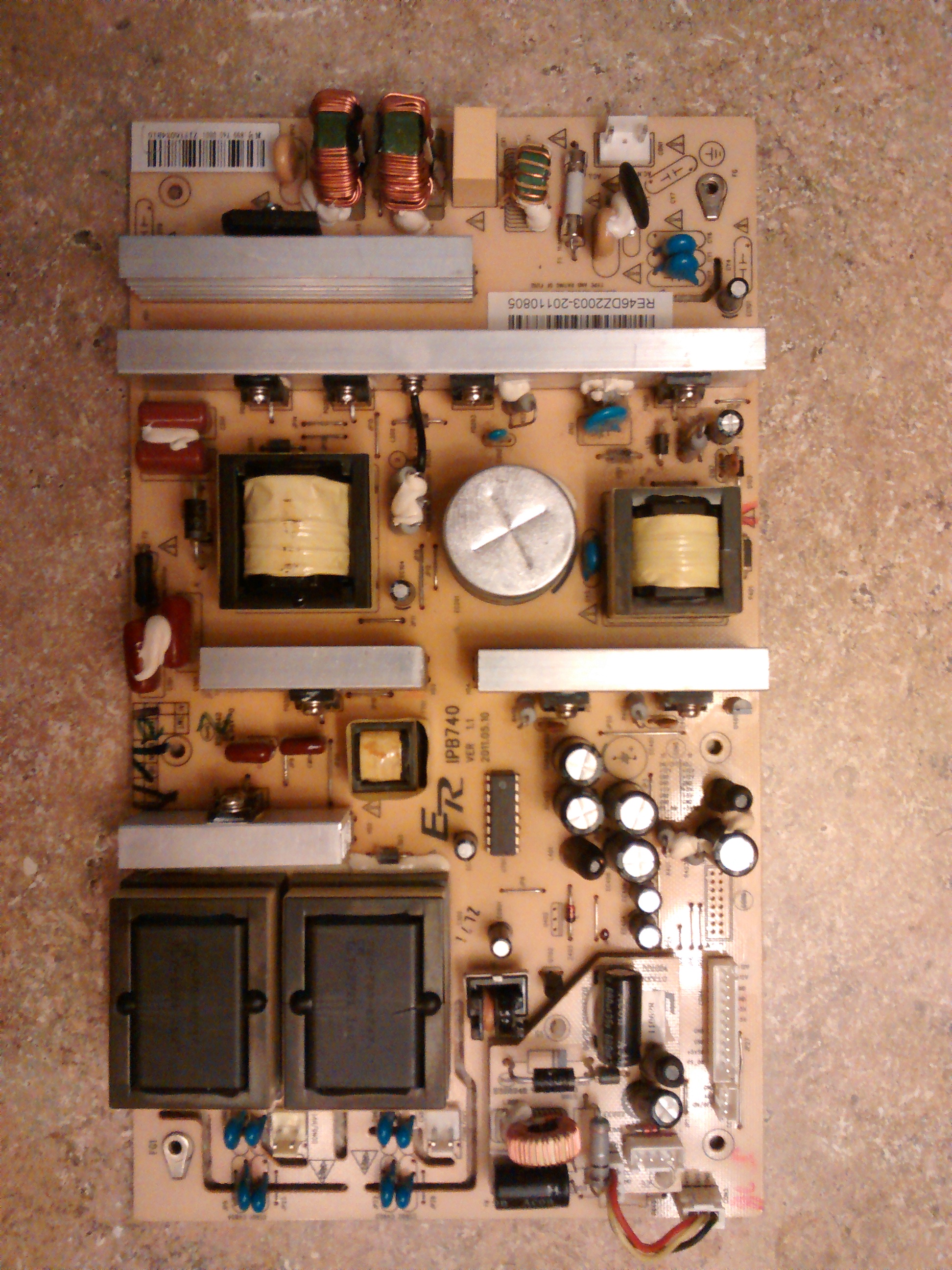

So I picked up this TV and it would not power on at all, not even a standby light. Took the back off and went straight to the power supply board. First thing I checked was the fuse and sure enough it was bad. Ordered a new one and put it, the second I tried to fire up the tv it instantly popped again! So I looked into the board itself and what I found has me scratching my head, I have never come across this before. Board number that came out of the tv is RE46DZ2003 and if you go to shopjimmy or any other vendor for that matter this particular board is not listed under this tv model. This board according to all the sites belongs in a RCA 40LA45RQ. So my question is is this common to come across? Does this board even belong in this tv? Did the people i got the tv from try to fix it themselves and put the wrong board in?

I type in your model number into SJ site and it shows that RE46DZ2302 as the board for your TV.
Oops, ah it is 2003, not 2302, never mind.Last edited by budm; 04-26-2016, 07:20 PM.Never stop learning

If the substitute board has the same output Voltages and current handling capability and the pins of the connector matched up then it will have no problem using it. You will need to look at all the connectors to see if all the pin labels are the same as the correct one is. I did not look at details of the 2003 and the 2302 to see if they are the same or not.

Thats the thing how would I figure this out? At SJ this TV has like 7 options for power supply boards and none of them have substitute boards and the board that is in there is not on that list. Am I just reading to much into this and this power board goes in this TV or am I on to something here?Last edited by bleed4me; 04-26-2016, 10:40 PM.Comment

OK, I download both pictures, they are not the same.Never stop learning

http://www.shopjimmy.com/rca-re46dz2...t-inverter.htm

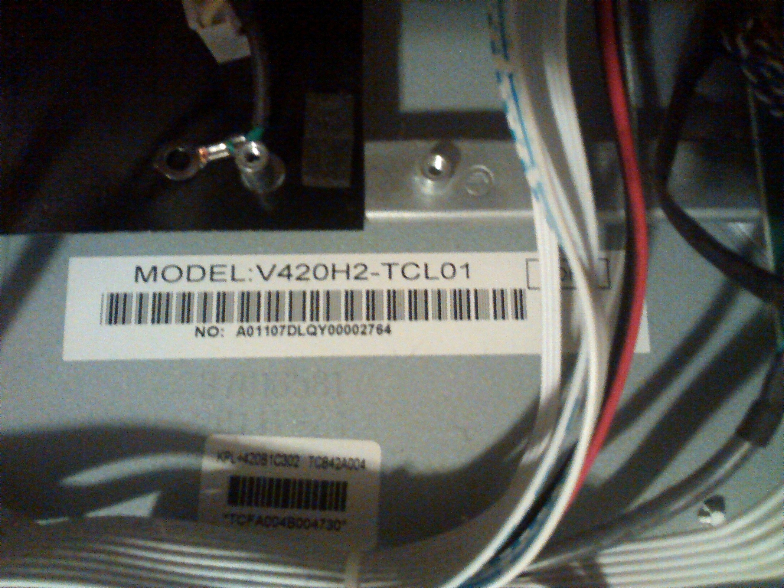

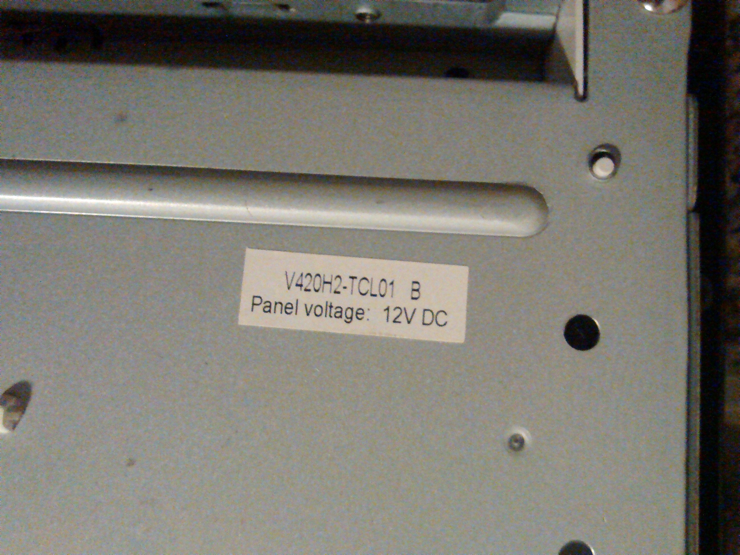

Your LCD panel sticker is this?
Panel Sticker Number: LC420WUE-SCV1
Panel Manufacturer: LGNever stop learning

V420H2-TCL01, it is made by CMO (CHI MEI Optoelectronics) not LG panel.
So with something like this I would contact SJ to see what they will recommend. You should also give them the main board P/N too.

The panel sticker as shown in the picture is not made by LG. TV manufacturers can use more than one suppliers of the LCD panel to put them in the same TV model.
Just tell SJ the numbers S printed on the panel sticker.Never stop learning

So I got in touch with SJ and explained the situation. I provided them the panel number and main board number like you suggested. This was their response...
As long as the part number on your power supply matches the part number found on our site then it should be the right part. RCA has used so many different set-ups during their TV productions that we have not seen all of them here so sometimes we don't get all the models listed that a particular part will work in. And really the only difference between your TV model and the one listed is the size. I hope that makes sense. The part should work for you!Comment
