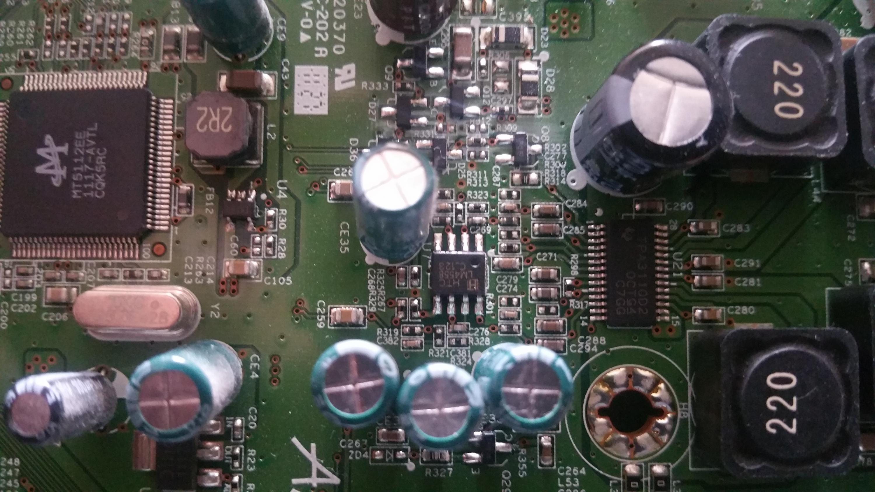

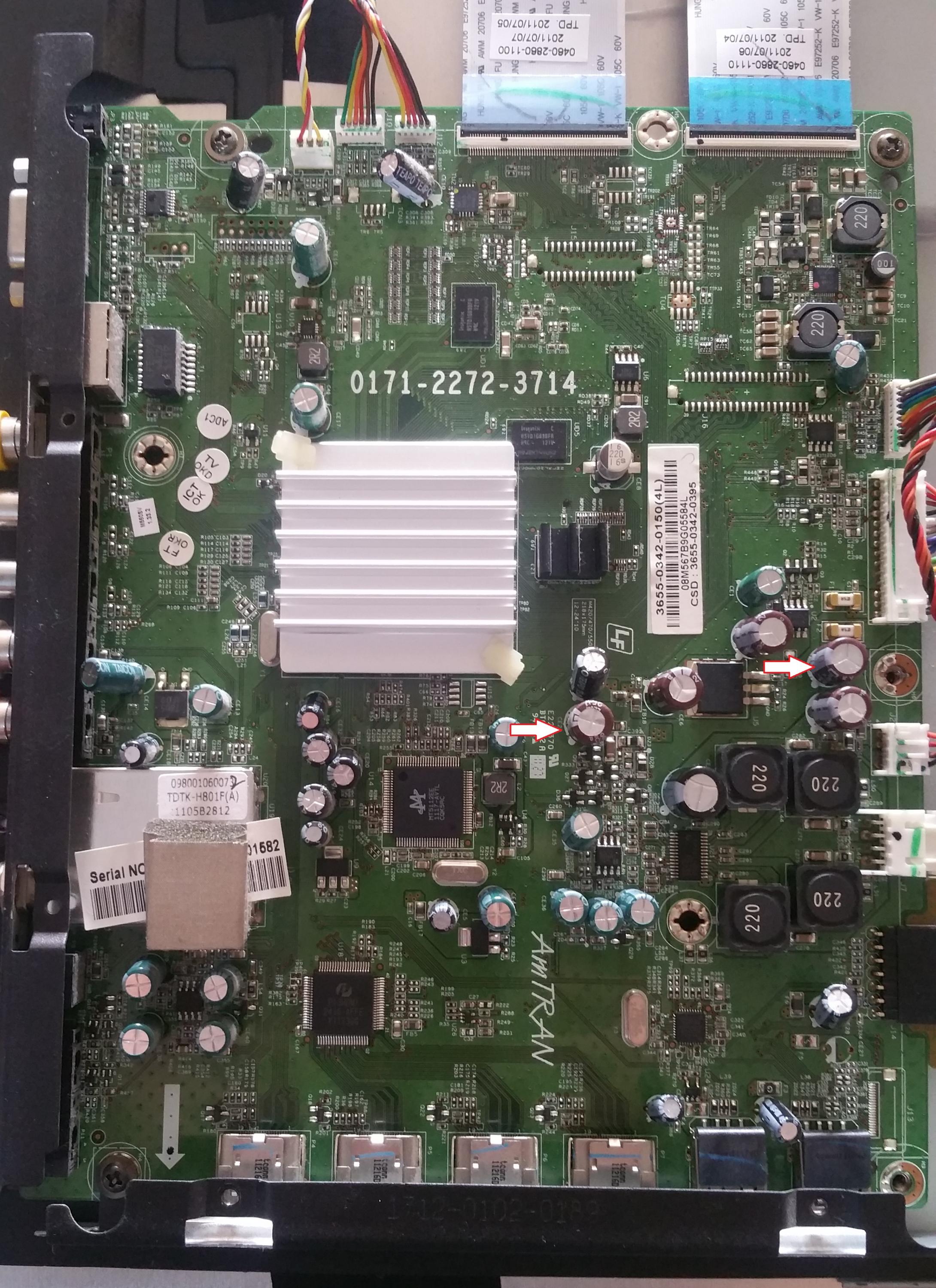

    I replaced this 2 capacitors (bulged) see the picture.
    The speakers are ok.
    Amplifier TPA3110D2
    Pin 7: 18.24v
    Pin 15,16,27,28: 18.31v
    Amplifier LM4558
    Pin 8 (VCC): 17.61v
    I don't have a scope, my bad

    Do you get at the Headphone jack or at the RCA Audio line out jacks if the TV has those connectors?
    Speakers are turned on in the on screen user menu sound setup?

      Hard to tell for sure from your pics if it's just dust but it does to me look like that board has moister damage.If water gets on a board it will cause white spots and corroded the circuit usually pins will rot on regulators etc too.

          EH: The board is in good physical condition.

            Then it is not headphone amp or the speaker amp problem then since line outs are way before the output section. May be the MUTE line is stuck on some how or the preamp sections are bad but since both channels are dead then it will have to be something in common such as power supply.

                If you have scope then it may be helpful to trace the audio from line out back to some kind of opamps which you should check the VCC (it may not use +/- supplies so the input will have to be bias at +input to get 1/2VCC at the output. You can also make audio probe by using powered PC speakers and a 1K and 1Uf cap in series to the input of the PC speaker, the end of the resistor can be used as a probe, the GND shield wire is connected to the chassis.

                          I found a mainboard with a very good price, replaced and audio ok again.
