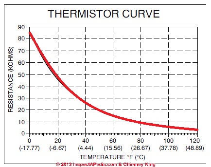

    The property of the thermistor is that it's resistance changes with temperature.
    Attached is a chart as an example of it's mode of operation.
