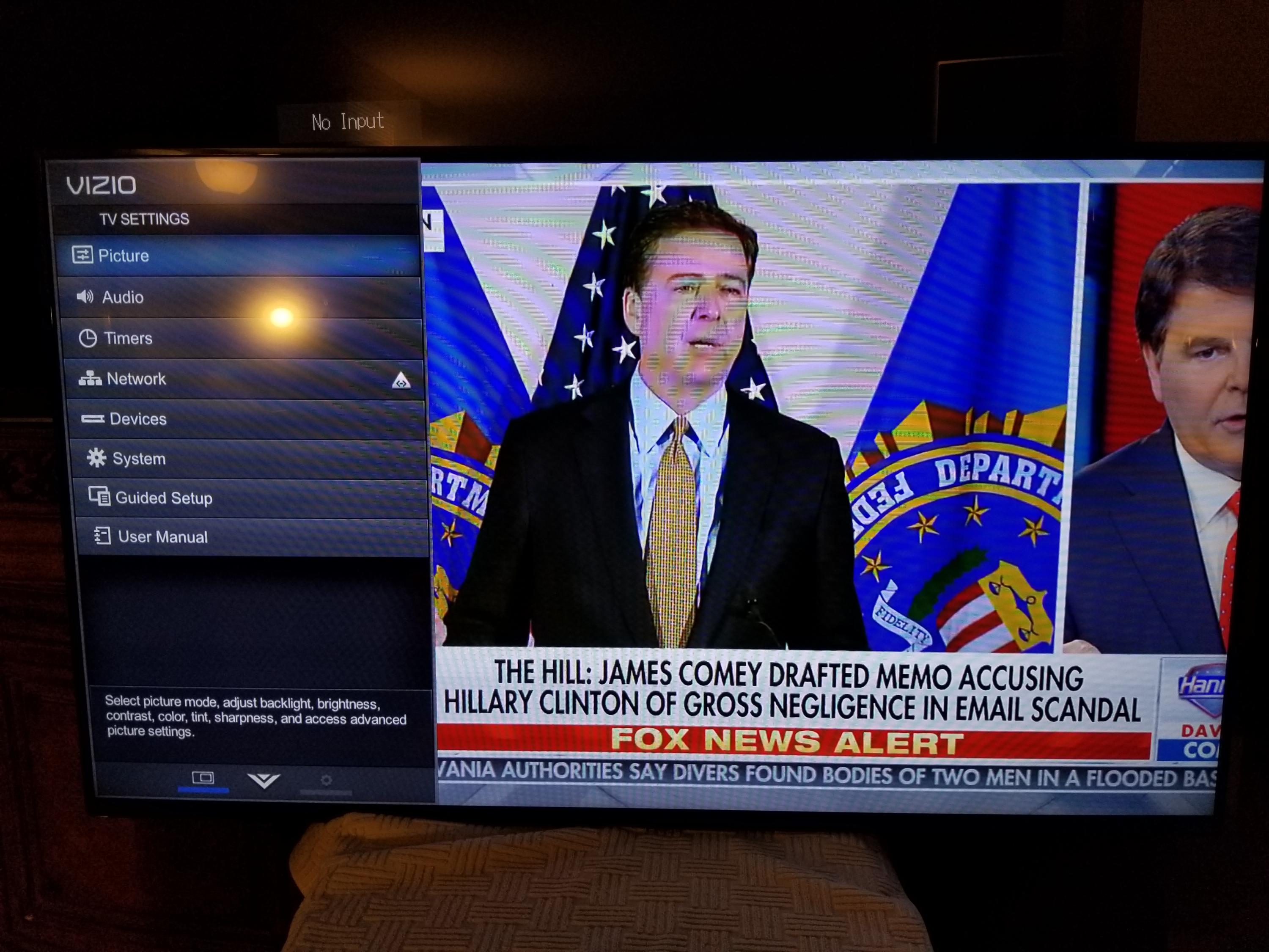

    sorry ya i thought I had posted a pic, but it is just basically the left half of the screen perfect pic, with a blank right side. I have checked the components not finding anything wrong so far. What's the process of removing the side tabs? I've already considered the panel bad so nothing to lose trying..
      #42
      Re: VIZIO E550i-B2 Sound - No Video Problem
      you basically tear all the tabs on the right side off. They are thermally bonded to the screen as soldering at the manufacturing stage would be detrimental to the panel at that point. But this may only work IF there are tabs on the other side of the panel to drive the screen.
        #43
        There are tabs on both sides. I'll give it a try and see what happens.. Thx
          #44
          Nice job budwich! Can't believe the panel survived the abuse I put it through!

            something bad has happened to one tab. It is causing "loading" across the panel which affects mostly timing of the signals. Removing the tabs takes that away. Of course, the set has been "saved" BUT no manufacturer puts in "things" that can be easily dropped or removed. The set will have some "compromise" and ultimately the tabs on the other side will have to work harder which will shorten their life span... but for now, enjoy your set.

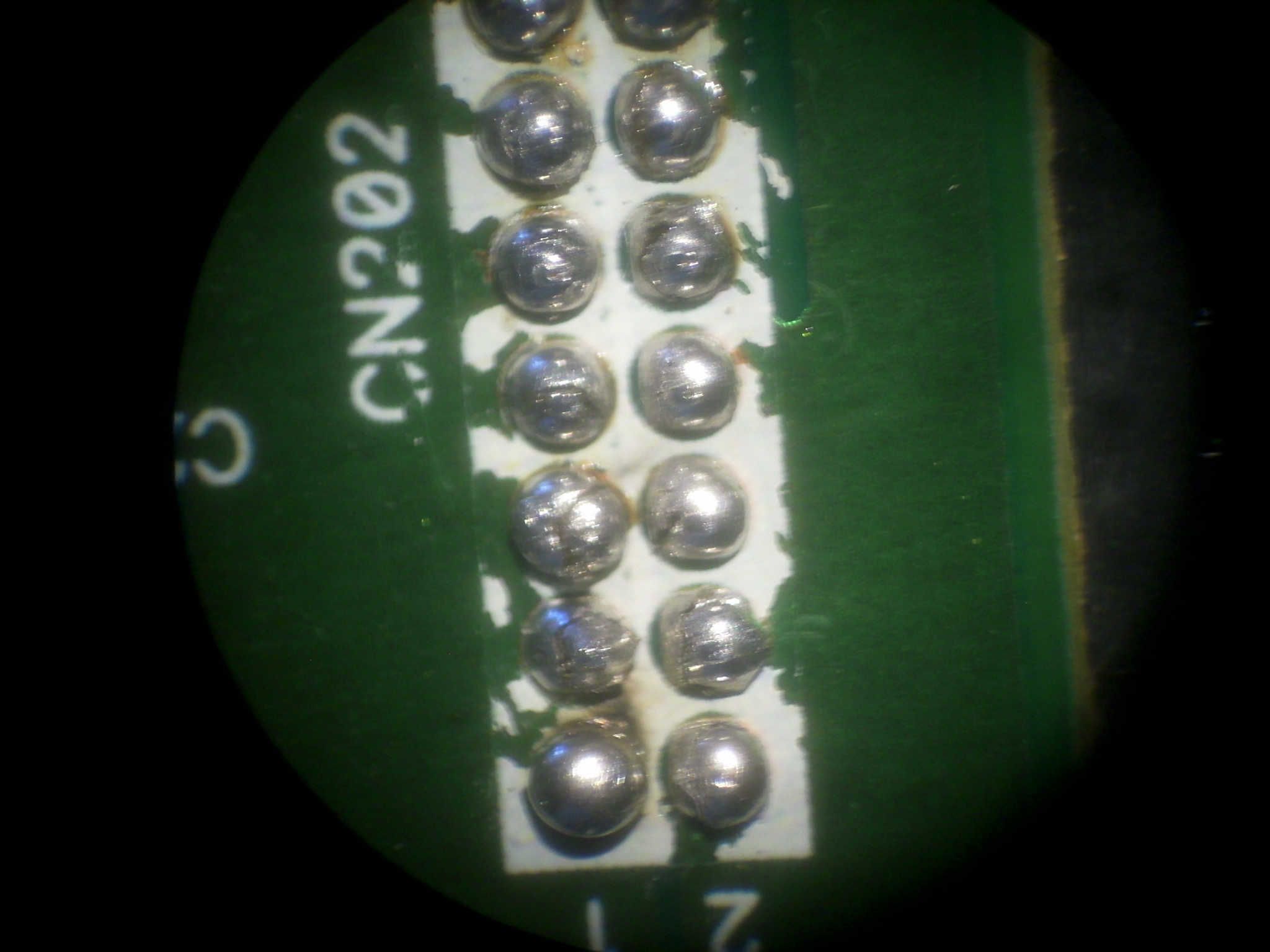

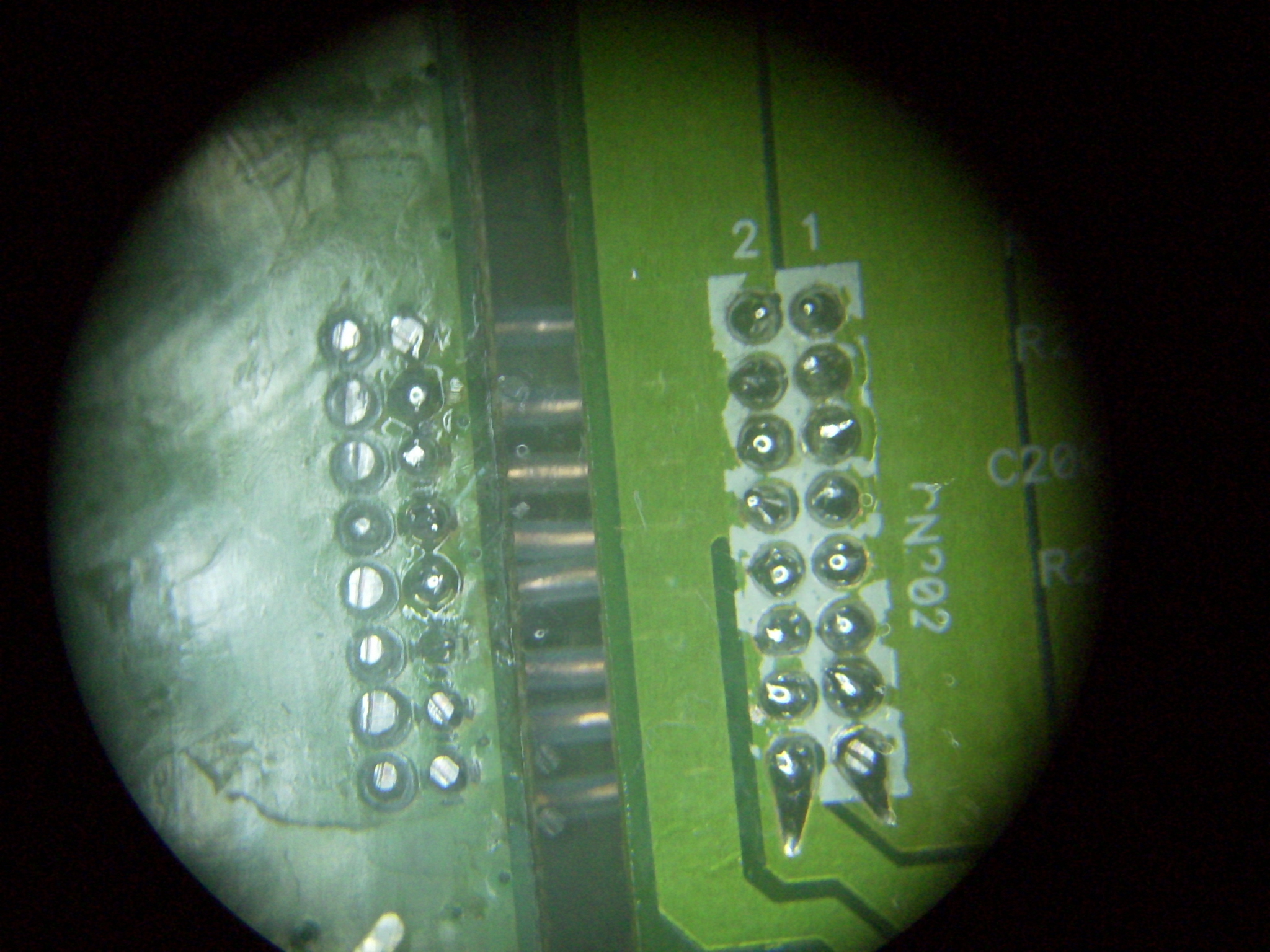

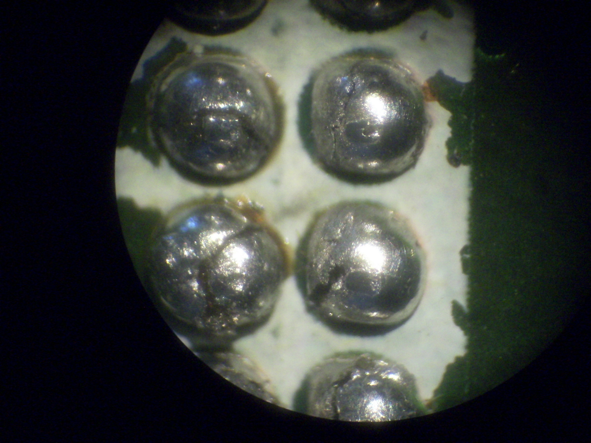

                    Update on my repair
                    I turned on the TV a couple of days ago and all I got was the audio - no video. I figured that it couldn't possibly be a repeat of the original problem, so I searched all the boards looking for a tell-tale black marking of a blown component. None were found, so I took off the power supply board to look at the bottom. I didn't see anything obvious and, just as a lark, I looked at the connector between the two boards. This is what I saw:
                    Once again, all of the joints were broken.

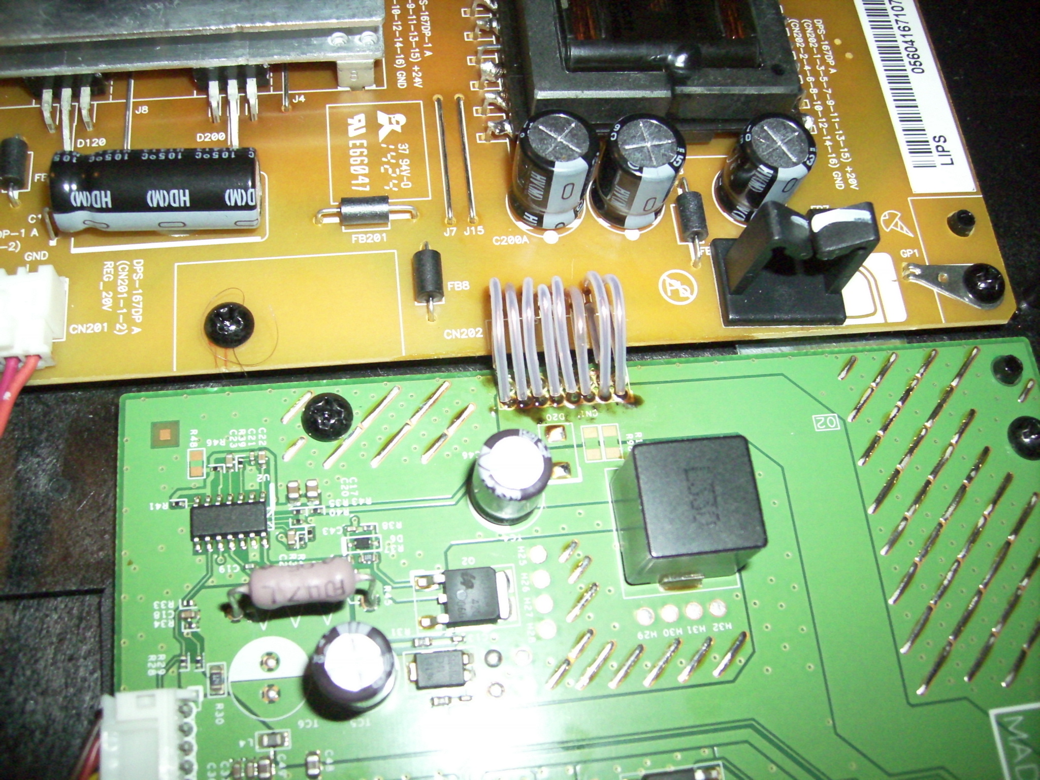

                    A closeup of the connector:
                    To permanently fix the problem (I hope), I decided that that connector had to go, so I removed it from the boards. I replaced it with some 22ga wire with some tubing slide over the wire for insulation. The wires are arced to have some slack for whatever is causing the failure. Some photos of the modification:
                    Hopefully, this will be a permanent fix, like I hoped that the first fix would be. The first fix lasted about 22 months - let's hope that this mod lasts the life of the TV.

                      Add me to the list of people who have had to fix this rather silly issue. Fresh solder on the connections and hot glue on the connector brought this Vizio back up. That connector seems to have been designed to fail just outside of the warranty period .
                      In this particular case, it wasn't even powering up at all. The white power light would slowly pulse and then the thing would eventually just give up. Every single point for that connector had broken free.
                      Yep, same problem here, joint looked almost exactly like the one in the pic. A minute or two with a soldering iron and it works just fine.

                                    Any insulated wire (22 gauge) will do the job - in fact, using insulated wire is probably easier than using uninsulated buss wire with plastic tubing (it's what I had on hand at the time). It is probably easiest to use a solid wire with insulation, as opposed to stranded wire, for a novice. Do the inner wires first, then do the outer. It's not difficult, just cut and strip the wires as a set, take your time and you should be okay.
