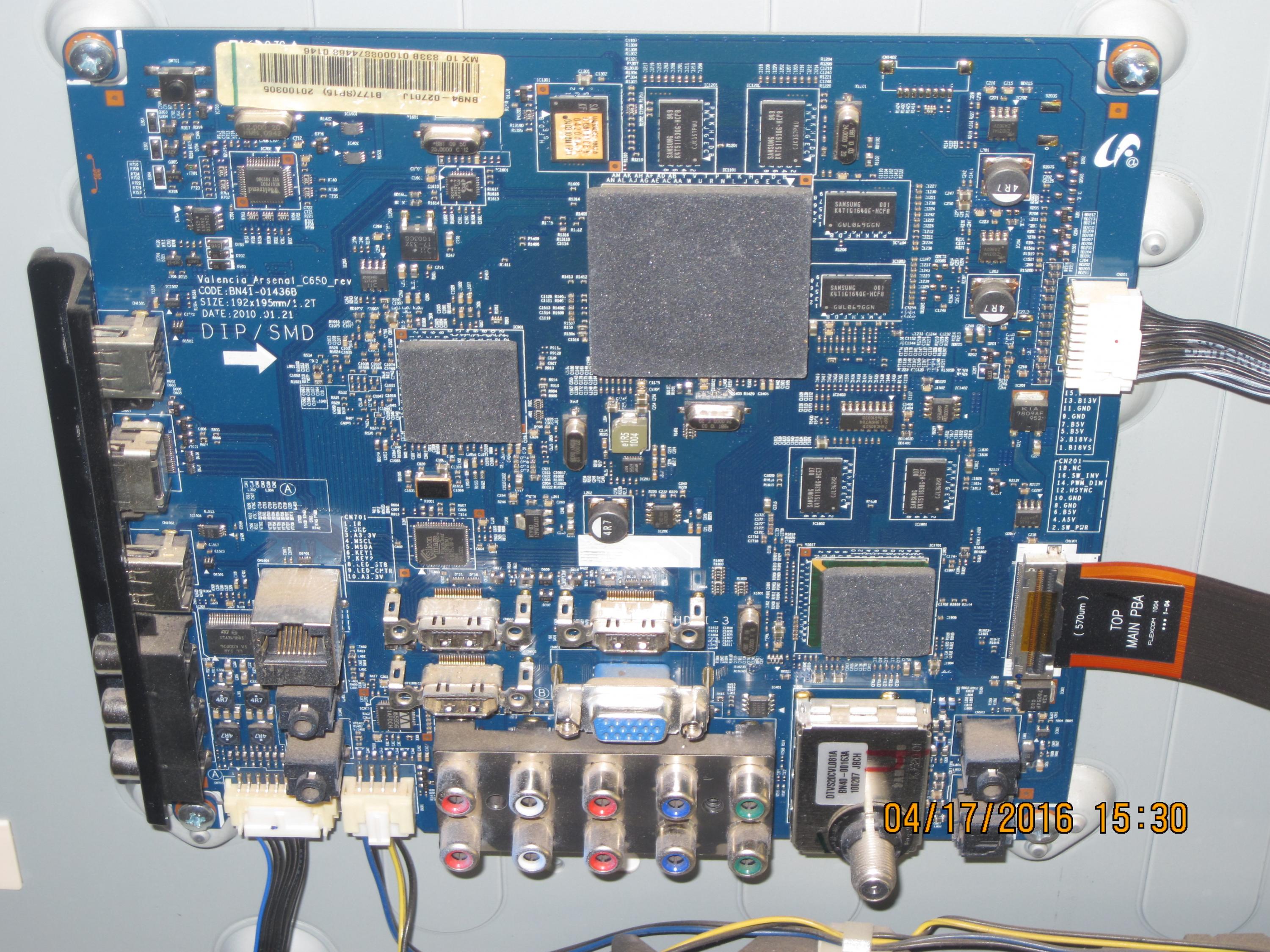

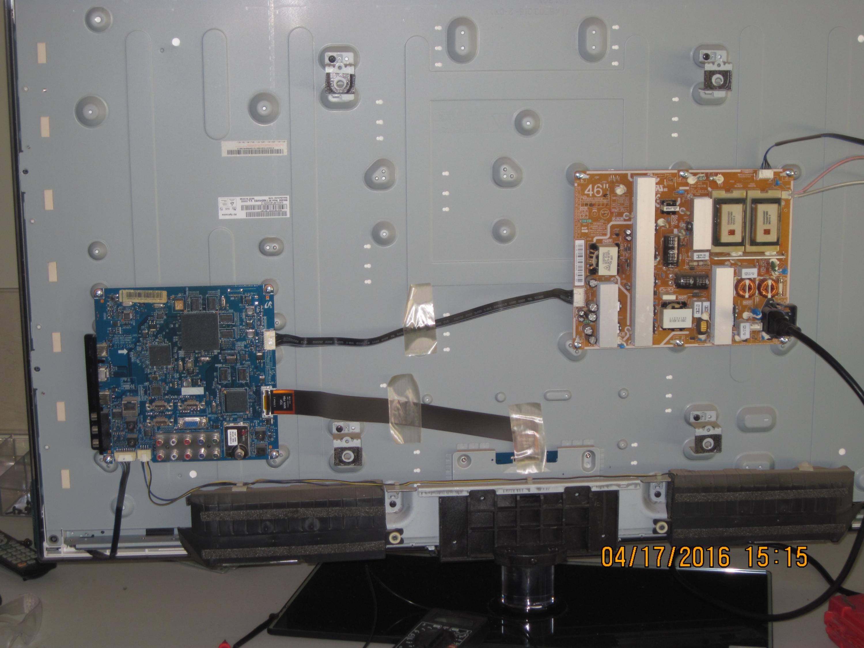

    Came across this tv. The standby light is on, but when i press the power on on the remote. Stand-by light goes out and nothing happens.
    When i disconnect the mainboard form the power board the backlight turns on.

    You have main board problem, as to what it is at this point I do not know.
    You can try cooling and heating, press on the board, etc. to see if it will do anything.
    You can also check to see which command signal to the power supply board is missing, also try diconnecting the T-Con from the main board to see if the backlights will come on.

      i got nothing with the heating/cooling and pressing on the board. I was thinking main board issue. I'm going to order on and cross my fingers

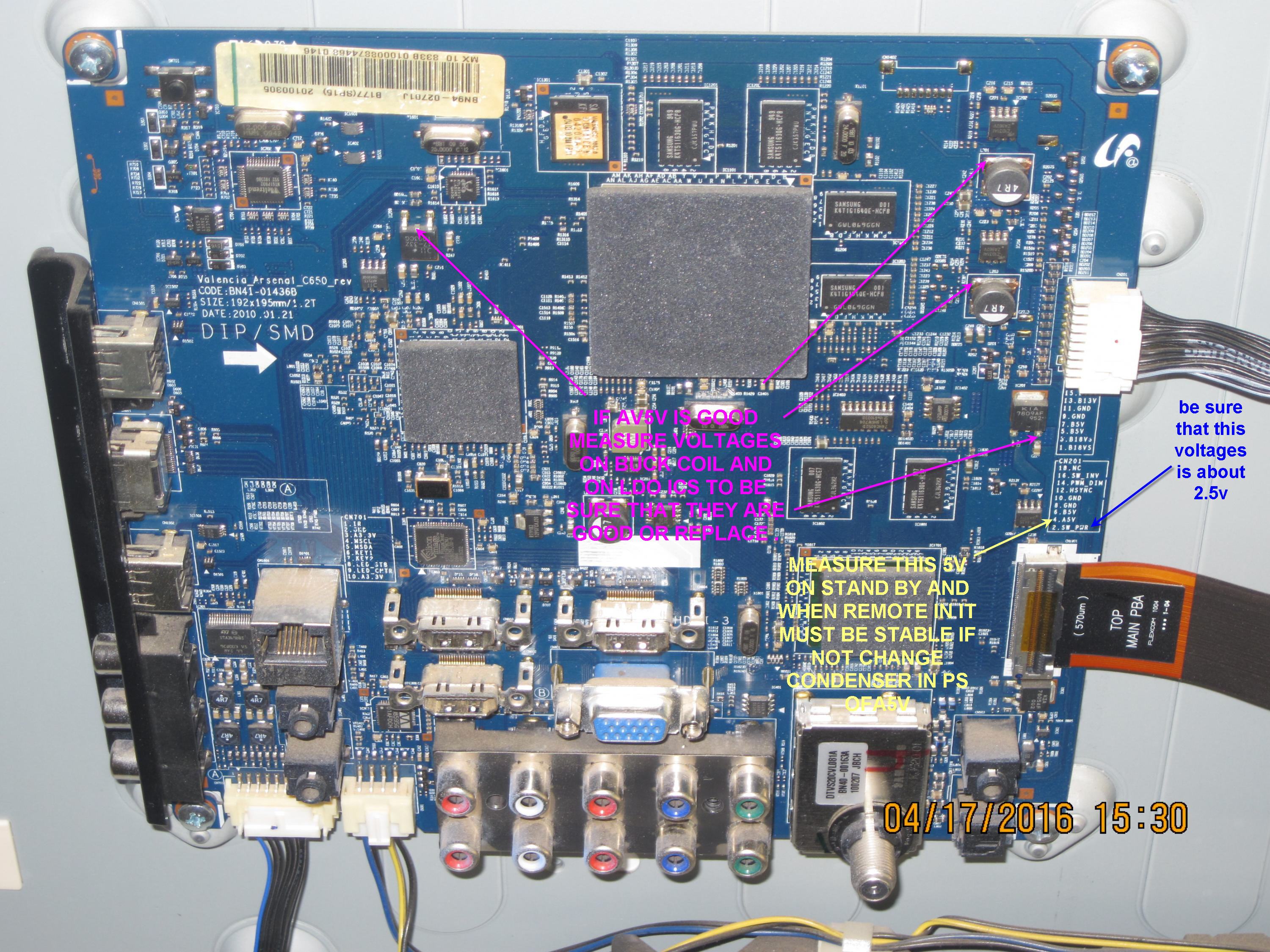

        hi
        in the photo try to measure the voltages according to arrows .
        I think it will lead you to solve the problem .
        please write what you measure to help us to understand exactly the problem .
        thanks

          Thanks fredaelsadany,
          But i have replaced the mainboard already. It works and ive button it up.
          Thanks to everyone!!!!!
