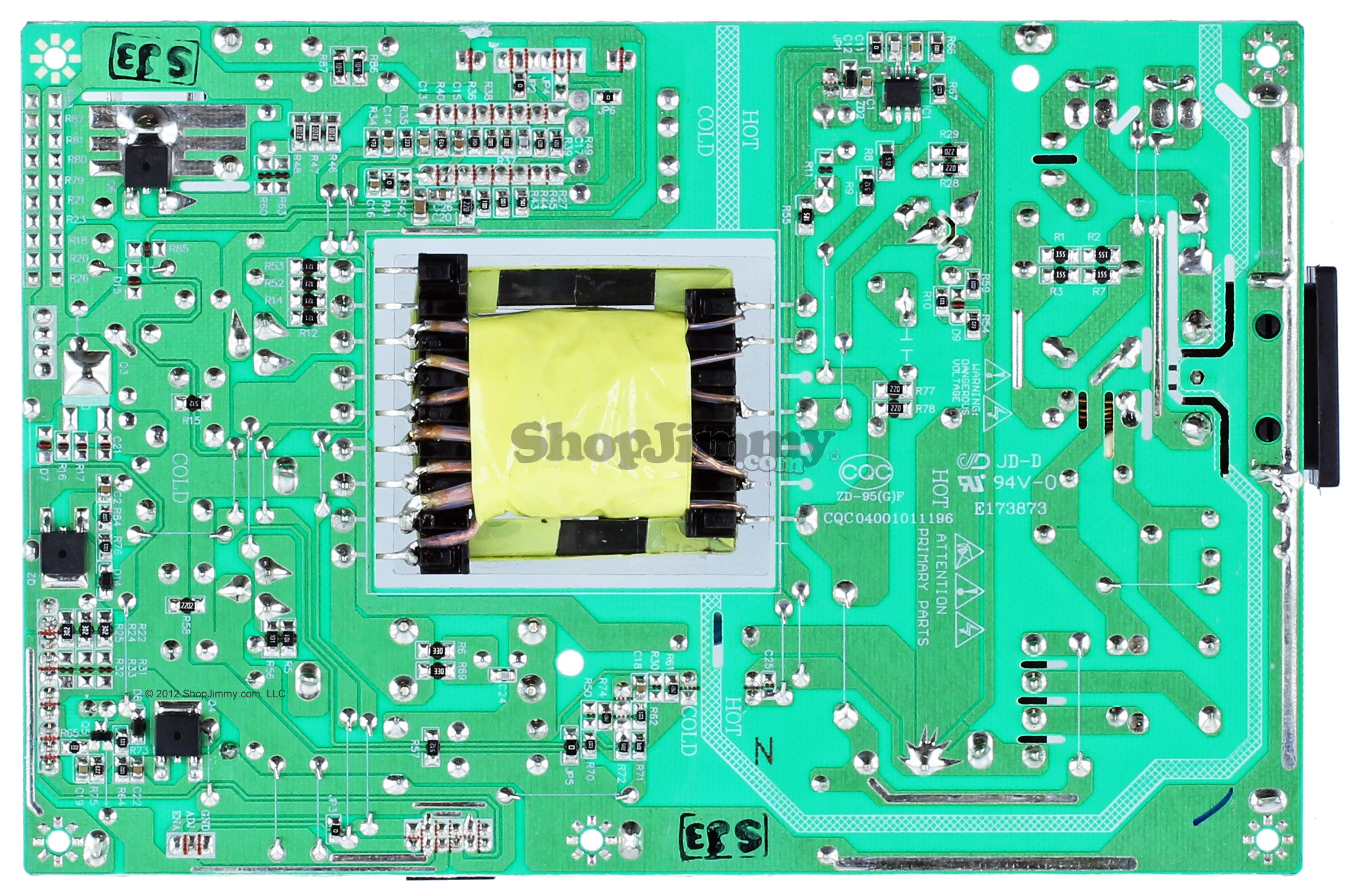

    Re: Spectre E325BV no power.
    I don't see a board marked IC1
      Diodes on the heatsink? The 3 legged components?
        It is on the bottom side of the board.
          Its the 8 legged device (IC) at the top of the board.
              What is the number printed on the IC on the underside of the board marked as IC1
              Dang, with my readers on and jewelers loops I can barely see it.
              I think it's GR8876A
              BC010

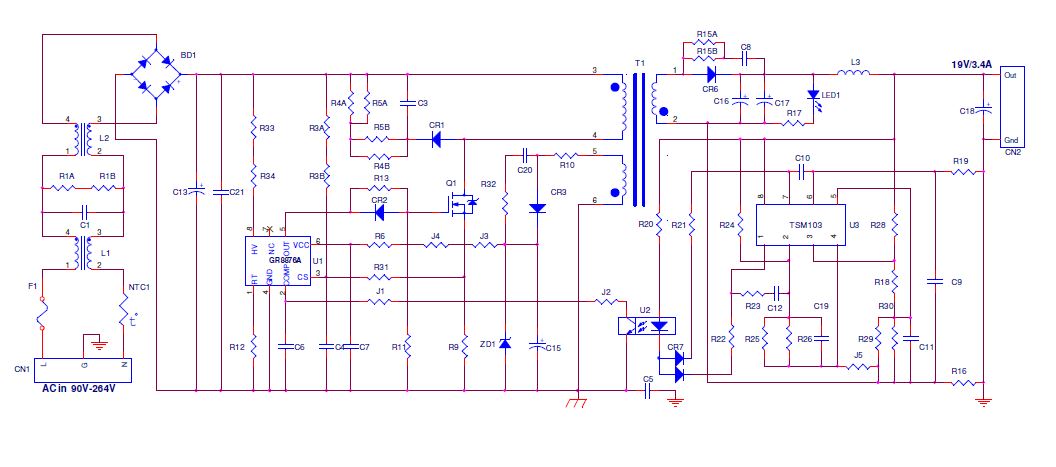

                    #29
                    That's the right number. Your circuit should not be to dissimilar to the schematic. Maybe changing the capacitor budm asked you to heatup may get you going. You need to check you have voltages on Pin6 & 8

                      #30
                            What were the voltages read on IC1?

                              #34
                              I didn't check. No one asked and I didn't know. Lol.
                              One of the contacts read 70v, another -80v. How can it be negative?

                                  #36
                                  You are right. Sorry dick. The pins aren't labeled that I can see.
                                  Most of them have a negative reading. Only one has a +70v. The rest -80 or 0.

                                    #37
                                    Did you connect your negative lead of your meter to the negative lead of the large capacitor and not chassis.

                                      #38
                                      No, since the board is off the the TV and laying on a piece of carboard, I put my black lead on a spot labeled GND.
                                      I'll try again using your suggestion.

                                        #39
                                        Doing it that way, only one pin gave a reading of 2.7V.

                                          #40
                                          Because I don't have the schematic for your power supply, looking at the pdf for the IC I posted earlier indicates that there are resistors up to the +ve supply of the large capacitor.
                                          What voltage are you getting across the two terminals of that large capacitor?
