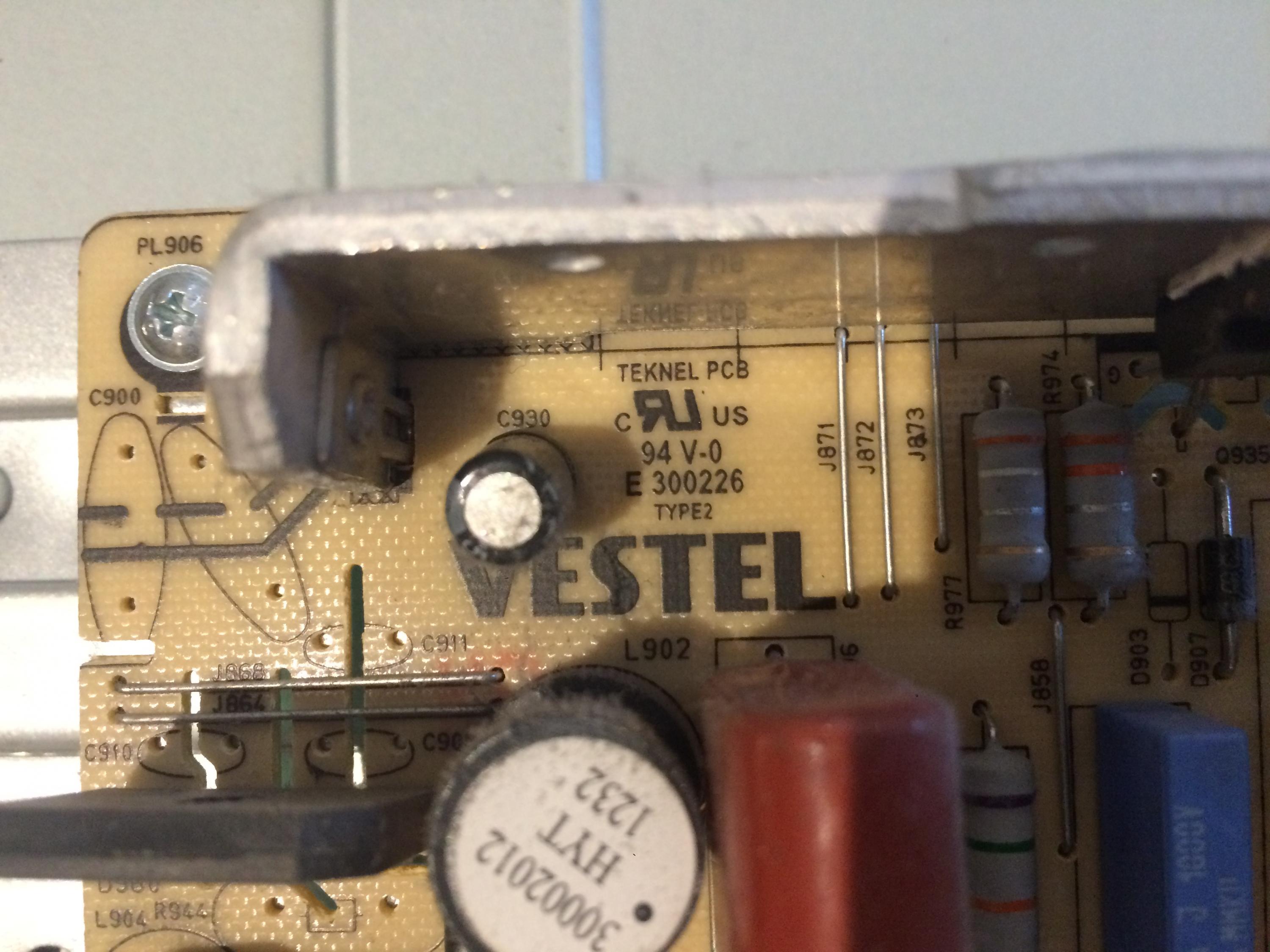

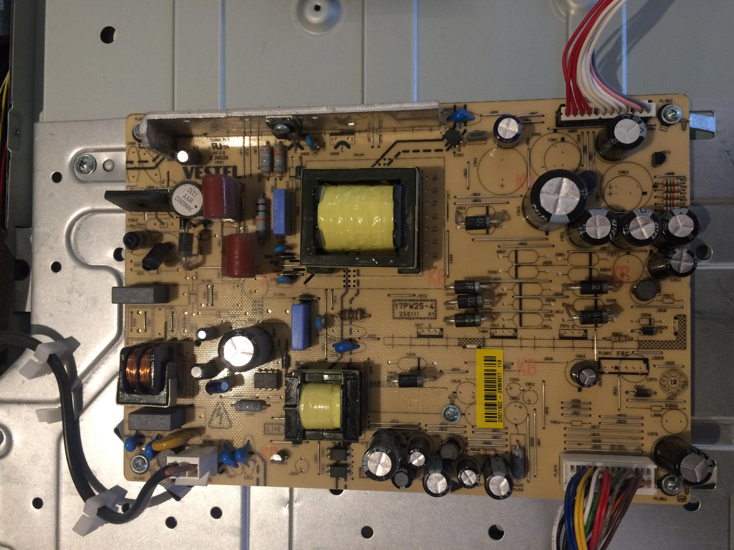

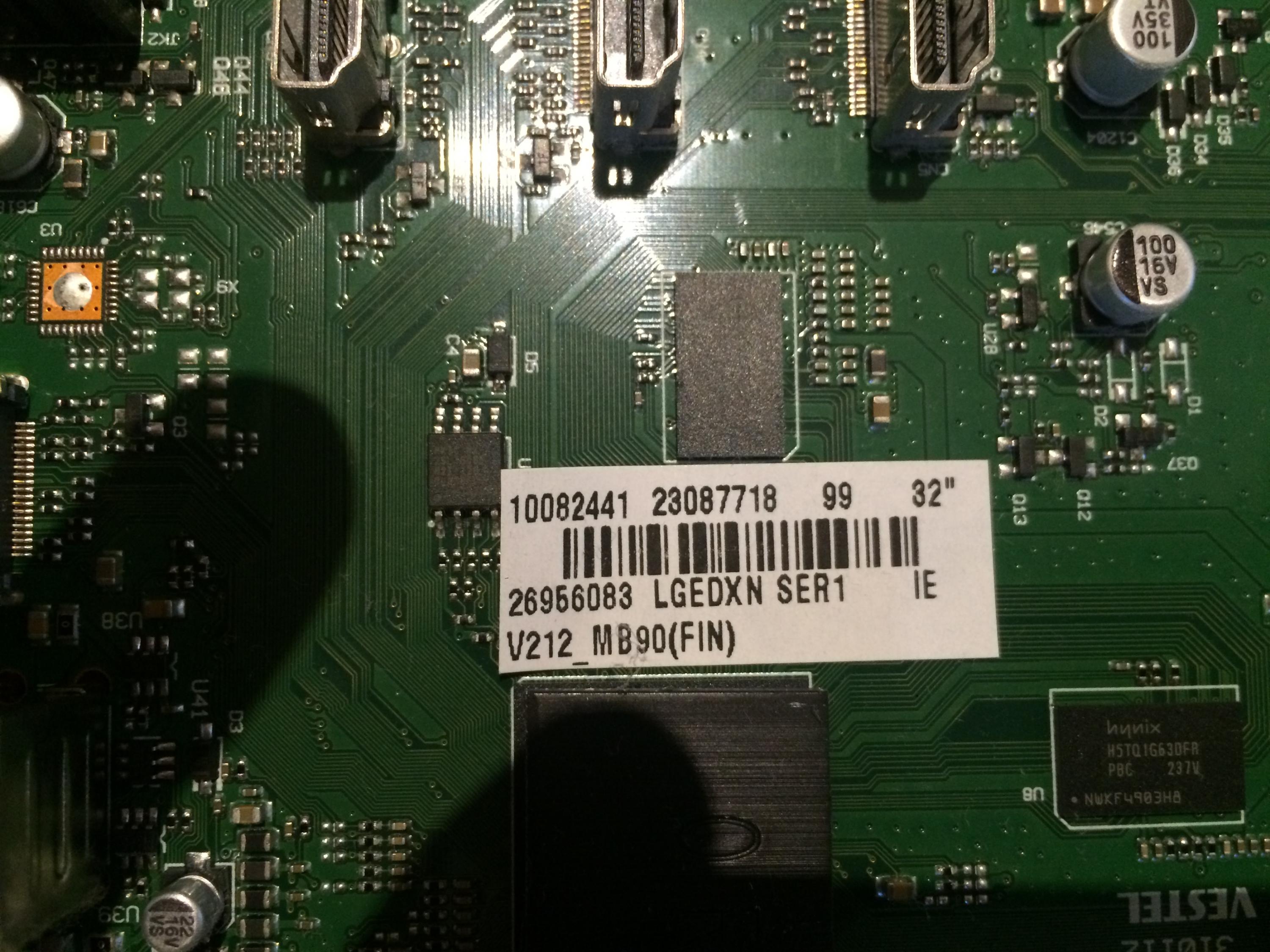

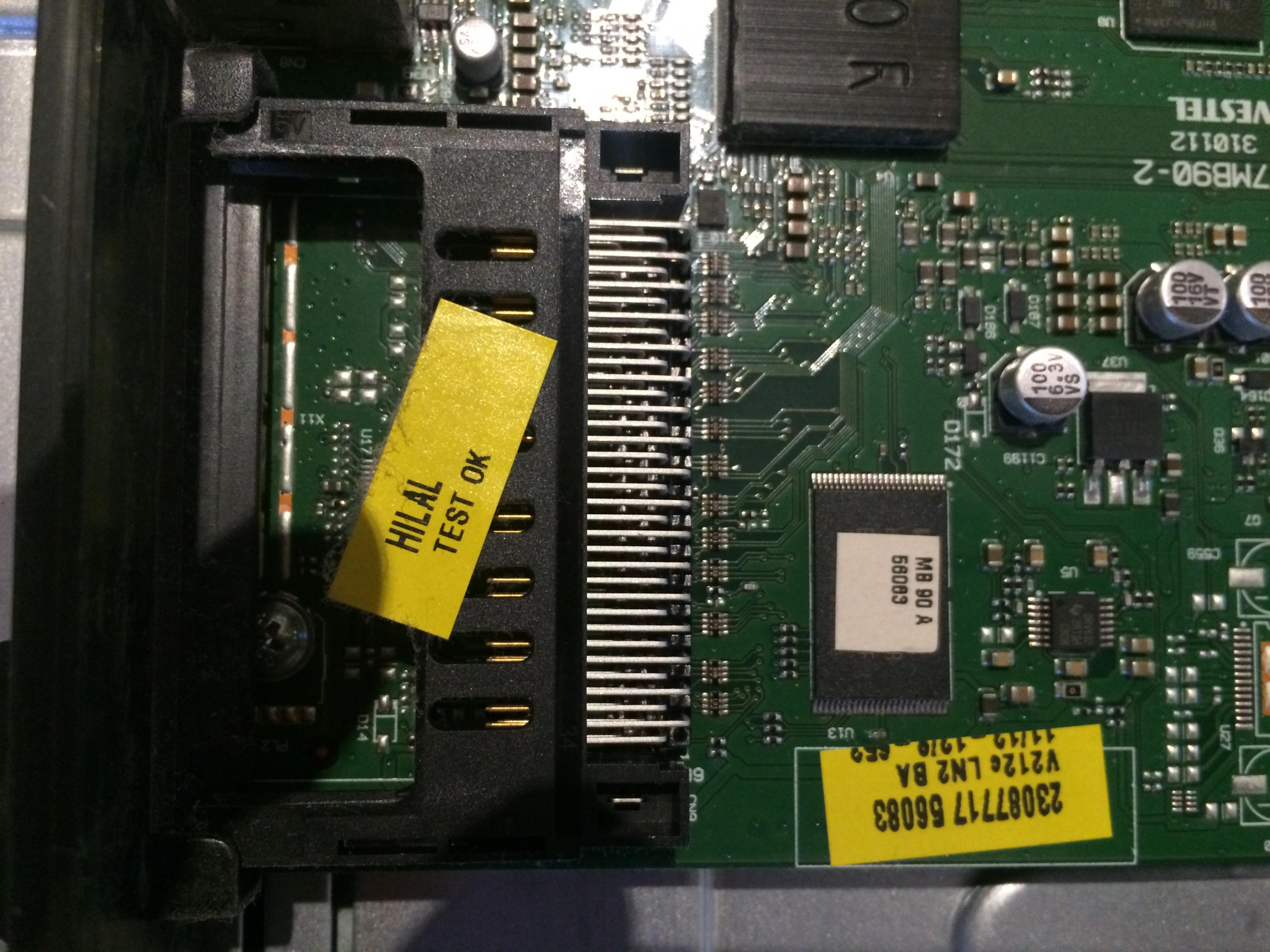

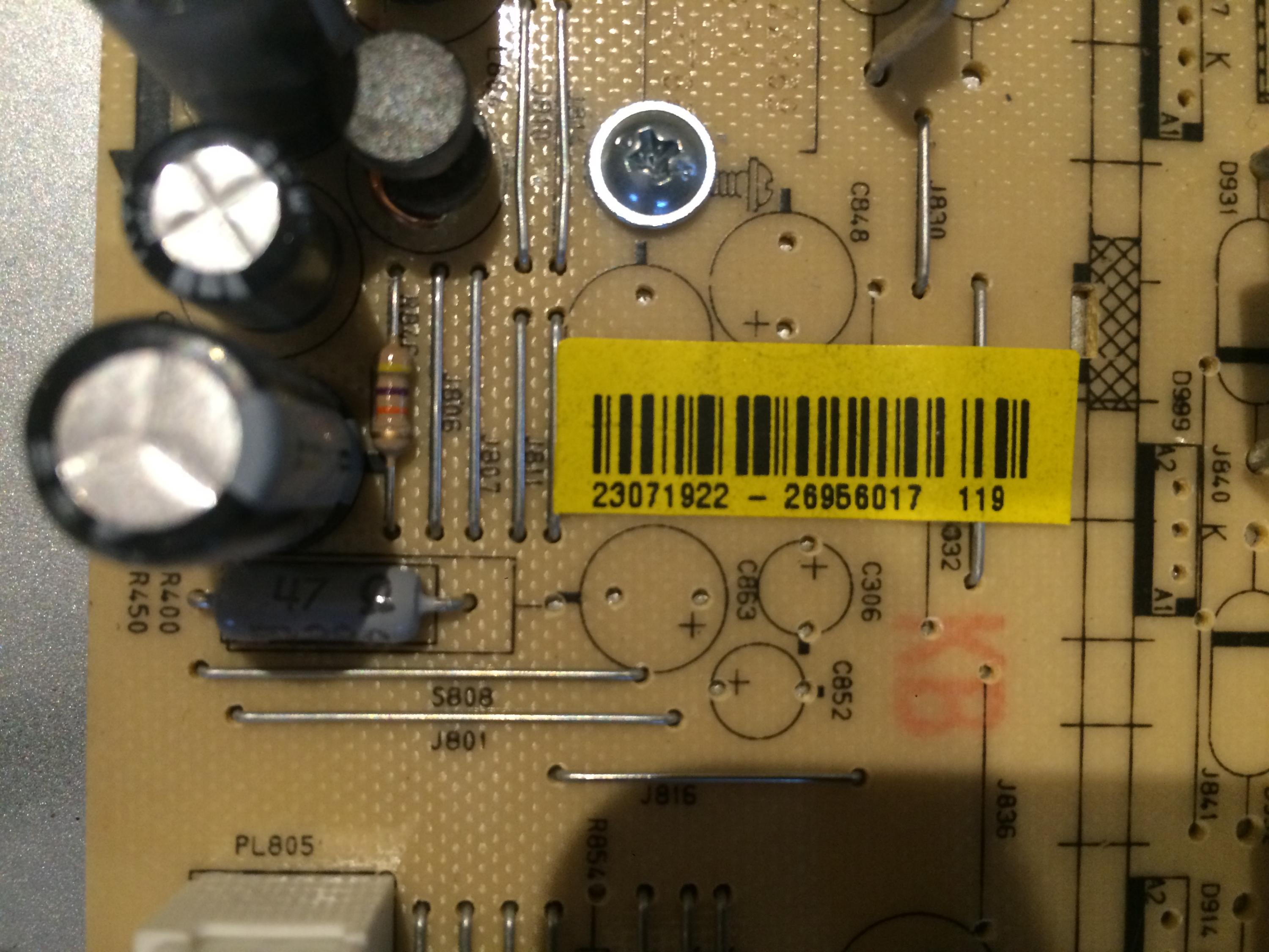

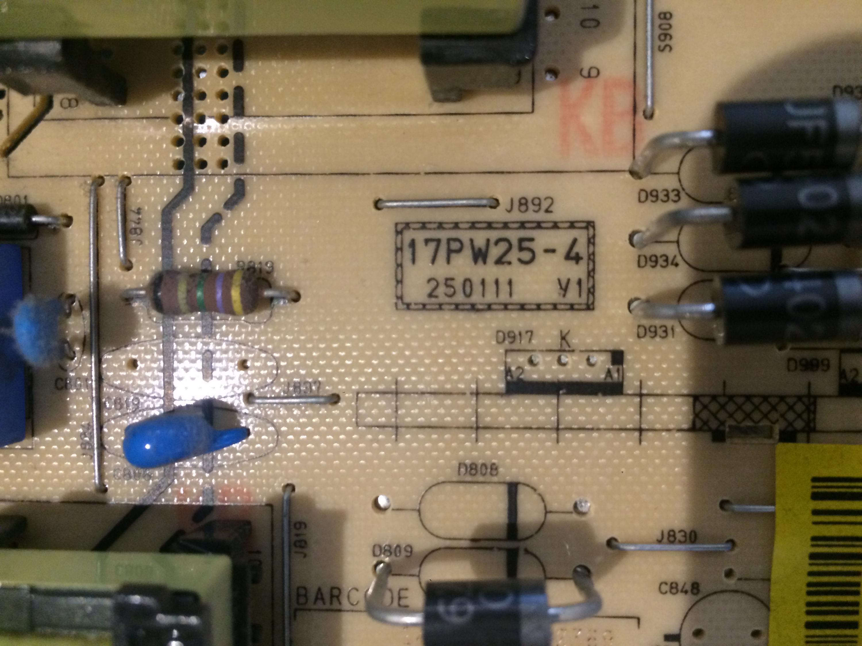

                Hi hear are pics of board.Tv gives a chirp and turns on and off in an instant.If tv is in standby it will come on by its self.

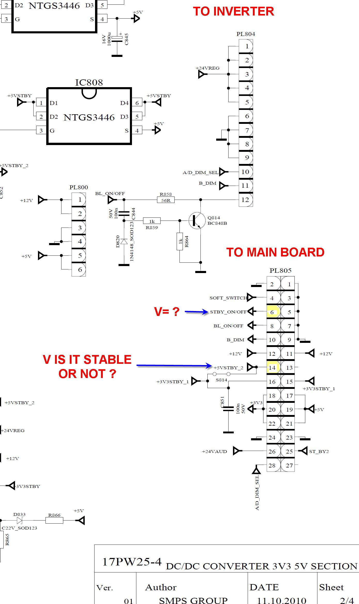

                  HI
                  in the photo please measure these voltages in this socket specially that with arrows .

                    Hi do i disconnect that block with power supply connected to get readings and do you not think this is a firmware issue?
                      Re: Finlux tv keeps turning on and off
                      You can test initially with everything connected and check as requested above to see what happens with the 5VStby and Stby ON/Off supplies.

                                  Try heating the Psu and mainboard see if it goes off faster. Common isssue is the polly caps failing on the primary side of the Psu causing issues.
