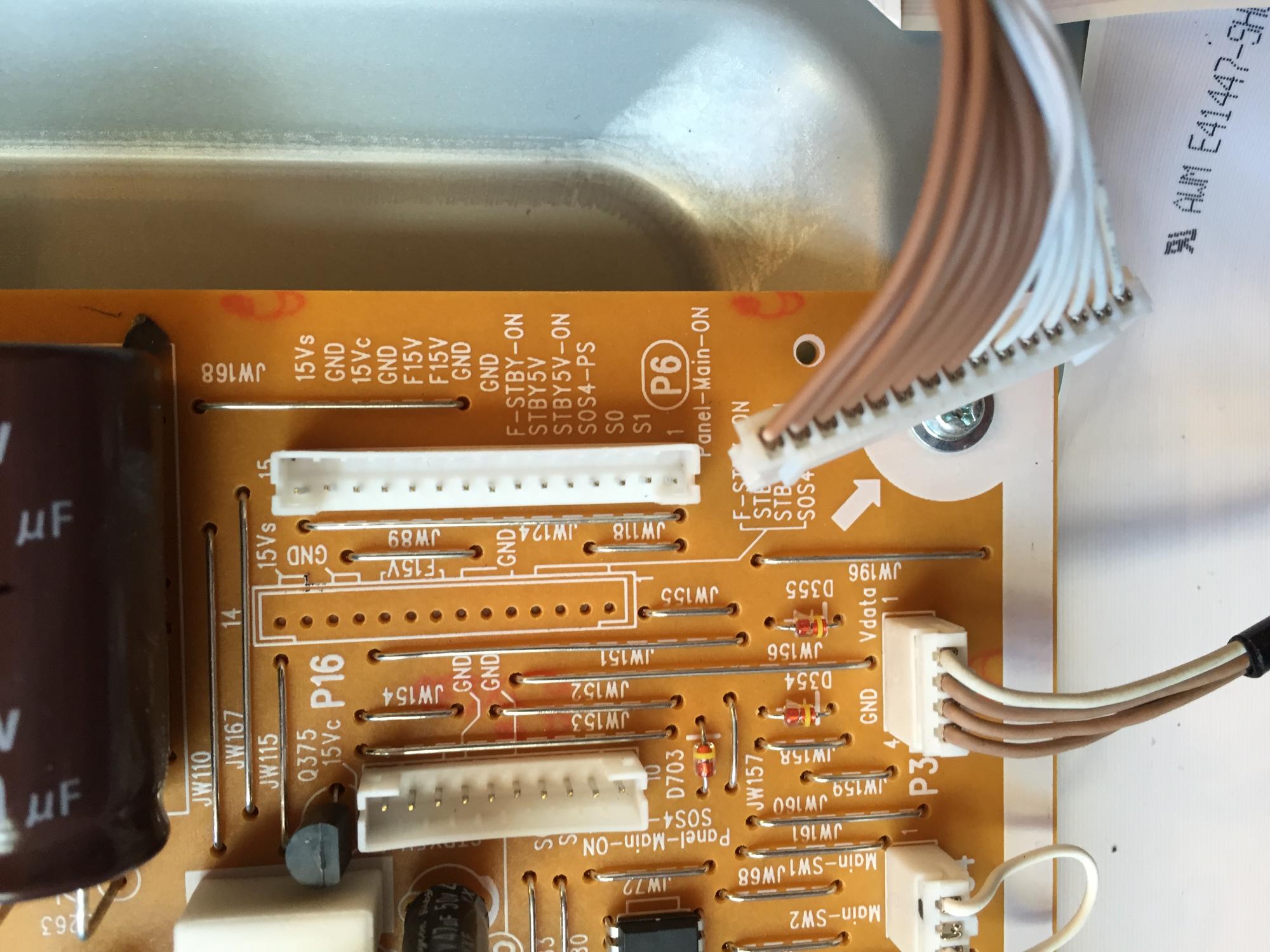

                    Re: Panasonic TC-P42ST30 14 blinks.
                    I get 3v on sos4-ps
                    5v on stbv5v
                    3v on f-stby-on
                    0v on the two F15v pins
                    0v on 15vs
                      Originally posted by Malachi
                      No voltage at all on any of the P6 pins.
                      OK--But that still doesnt mean P board fault....
                      What tests and stage isolation have you done?
                        I edited my post Alaistair.
                        I unplugged the sn board and checked for shortage at SN2 as some suggested at the avs forum.
                              Thats good then, so does the 15v come up at all even briefly ?
                              • Malachi
                                • Dec 2015
                                • 1077
                                • Usa
                                F15 will hit 10v as soon as I plug it in but then drop off
                                15Vc will hit 9v if I hold the power button in
                                15Vs will hit 9v if I hold the power button in. Then the both drop off.

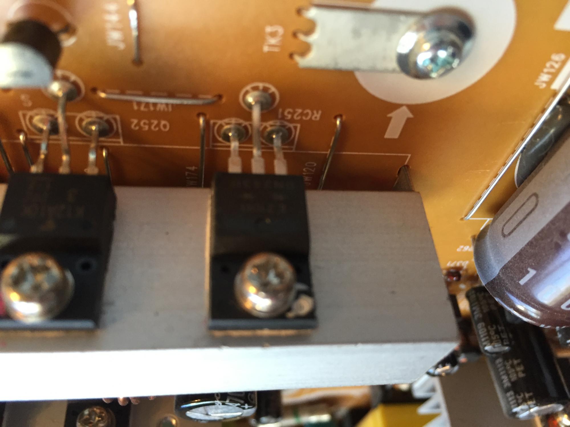

                                  If I remove the connector from P6 I don't get anything on F15.
                                  • Malachi
                                    • Dec 2015
                                    • 1077
                                    • Usa
                                    With my meter in diode mode, when I touch the 2 outside legs of this black bottom component, it beeps.
                                      That's because that item is a diode and the outer legs will show as a short, and will either both be cathodes or anodes. The image is too blurry to tell but the marking on the front tells you.
                                      You should be able to try disconnecting sn2,ss11,p35 and the 3 white ribbons on this Tv and turn on to see if it still 14 blinks.
                                        Just tried that. No blinks.
