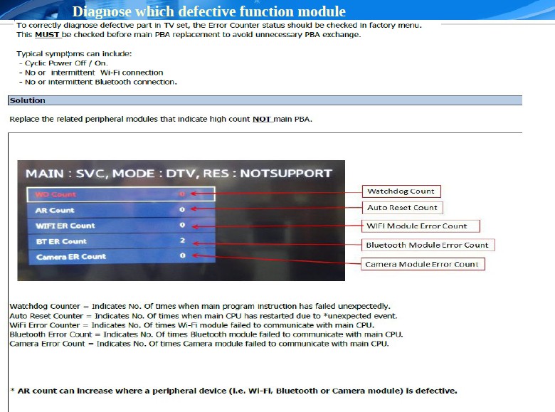

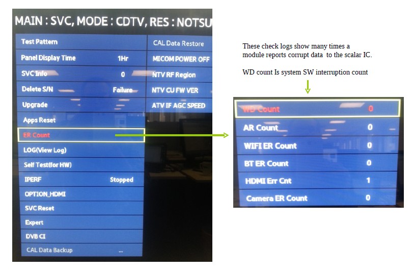

      Do you have the latest software ?
      Check the wathdog and error count.

        I will upload pictures the next time i have a chance to tear it back apart. meanwhile how do i check the error count since i can't get it to stay on?. I beleive i do have the most up to date software because i did update it during the 3 day period that it was working.

          ok so i was ripping this back apart and decided to reseat the LVDS cable going to the tcon board. for some reason the tv is now (for the moment) working properly. How do i access this menu to check for error counts?

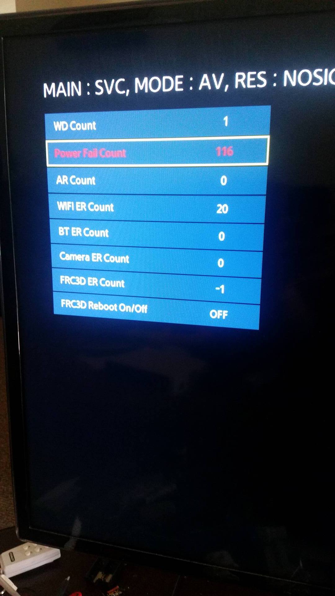

            Re: Samsung un40f6300 power issue
            Did a little digging and found out how to get into the menu. This was the rsult of the log

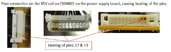

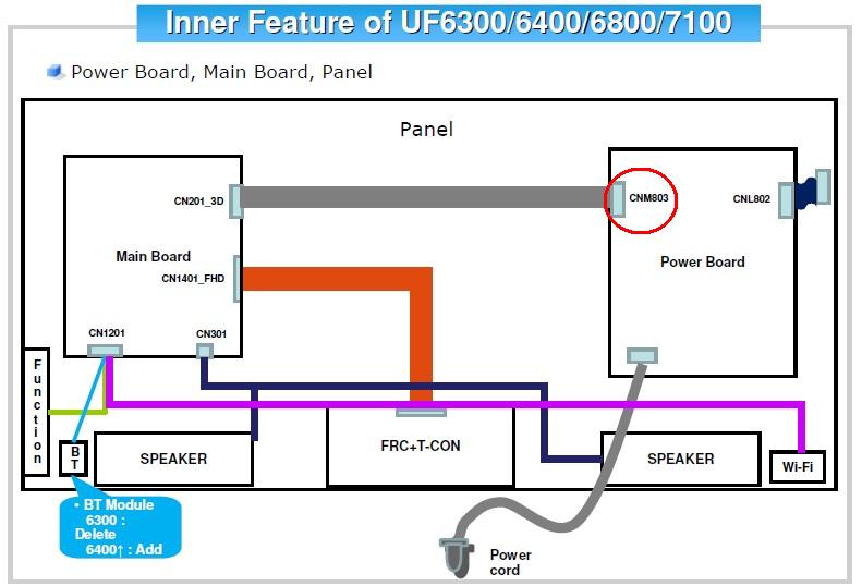

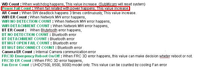

                  Many "Power Fail Count" so it seems to be problems with the PSU.
                  As you said many have had their PSU replaced.
                  As you also said it could work randomly,
                  so I have checked the connector CNM803 to see that there is no
                  poor connection.
                    sorry i've been busy with finals so just now have had a chance to look at this. I've checked the connectors you asked Kilroys, The connector seems fine.

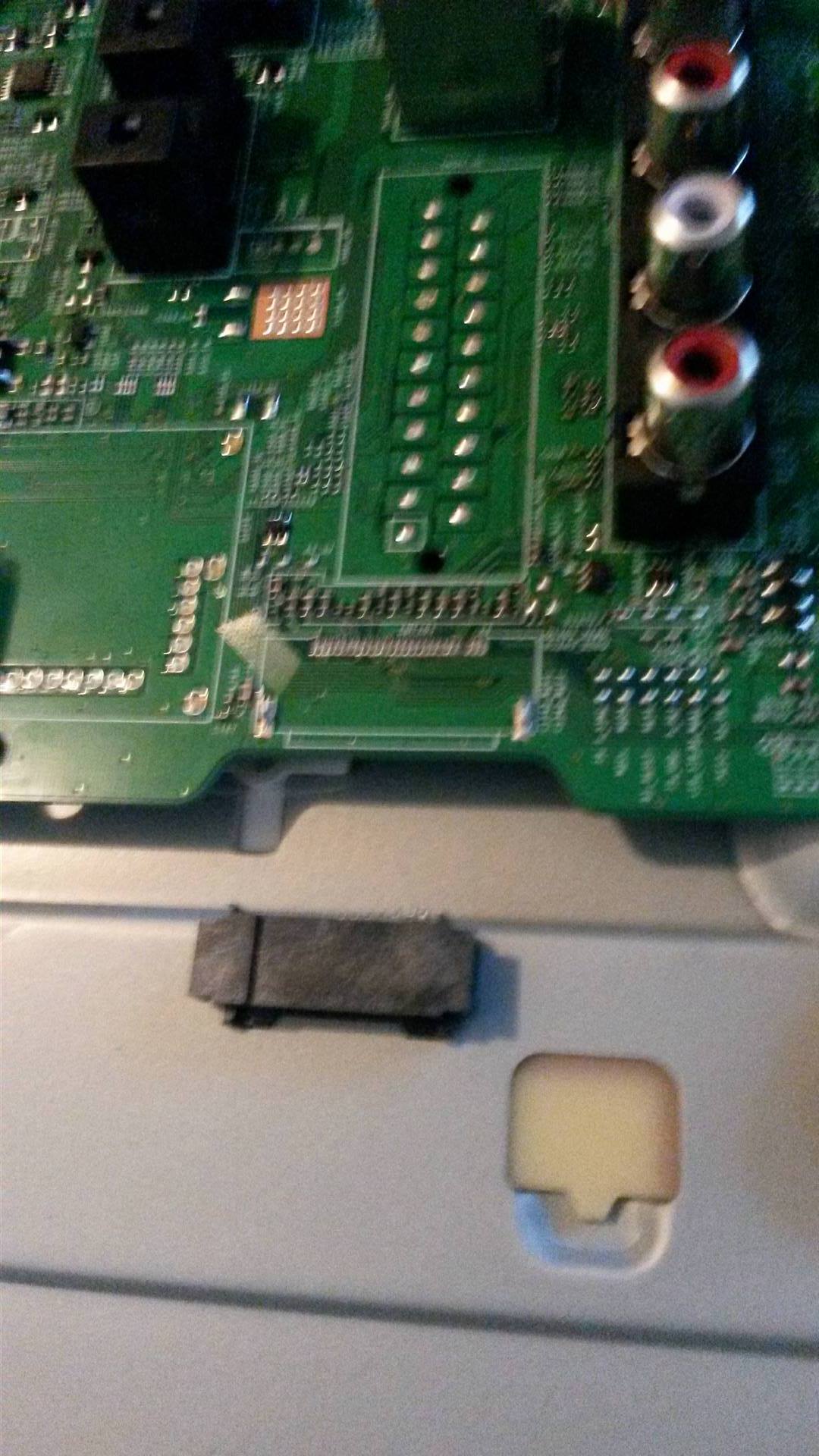

                      Well...crap. I was reassembling the tv and apparently was a little too rough reconnective the part on the main board that connects the IR sensore, button, and WIFI. Those pins are too small for me to re solder and i can't find the main board online. ShopJimmy is out of stock, Ebay doesn't have the right one. The break was relatively clean but I just can't solder somethinglike that. :/ this might be a dead project. I appreciate everyone's help as always.
                      Edit: I did find a compatible board on ebay and am ordering it I'm hoping it kills 2 birbs with one stone. Fixes the connector issue i just broke, and fixes the power issue i was having.

                      • birdboy385
                        • Nov 2015
                        • 145
                        here's a picture
                          Hey guys just wanted to give everyone an update. I installed the new main board and have been testing the tv for over a week now without incident. The Wifi is also now properly working and it wasn't before. It would appear that something did happen to the main board. Thanks everyone once again for their help.
