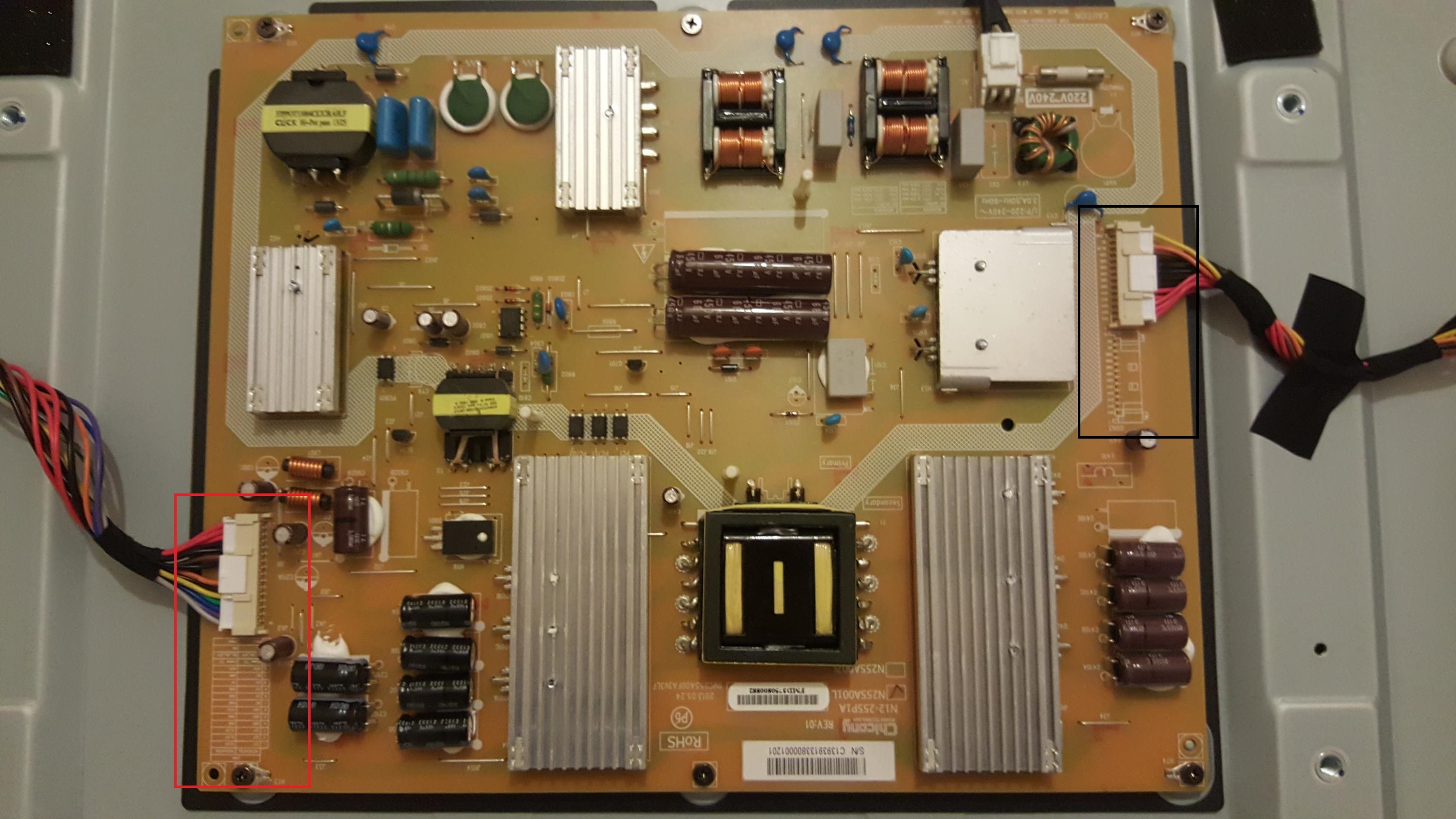

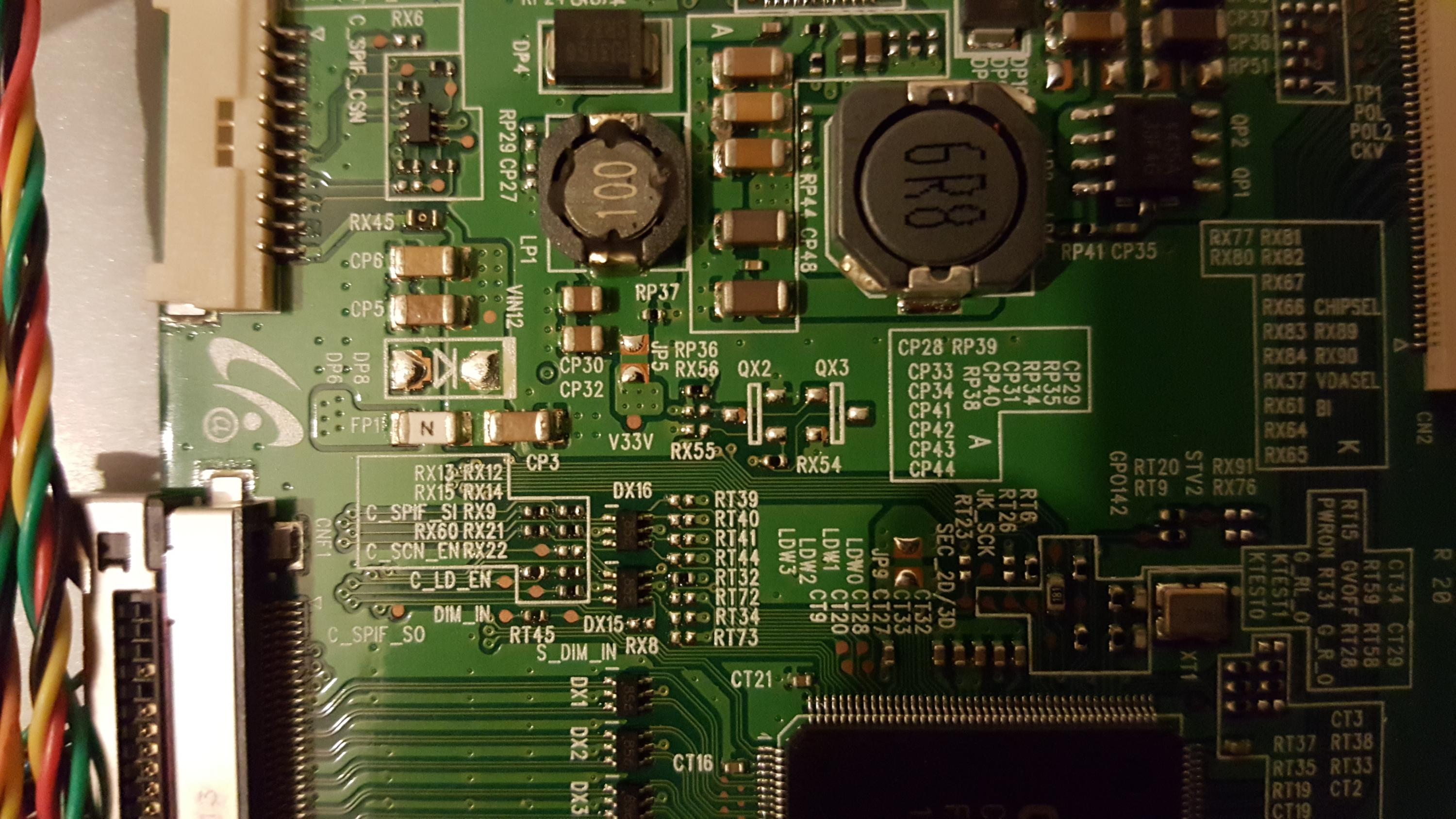

    toshiba smart tv , only backlight , no picture

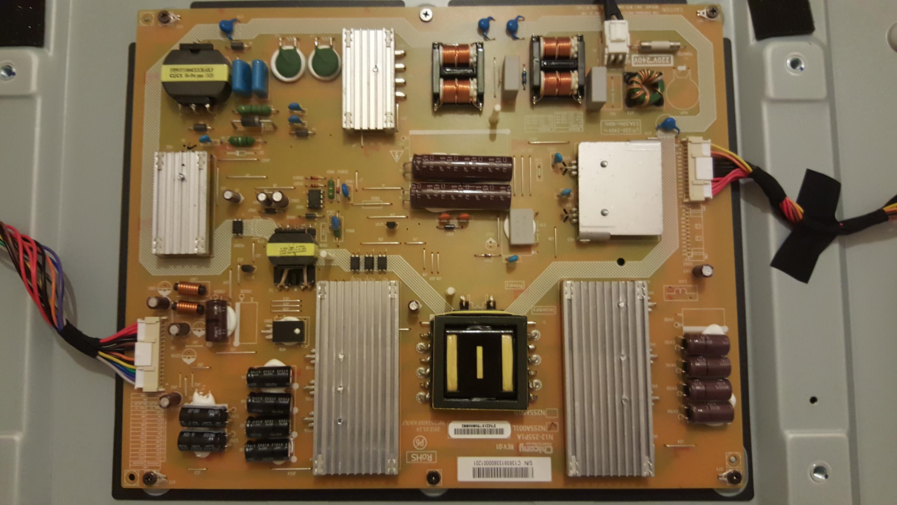

    hi,
    as soon as i plug the power cable to the main , the screen comes on with bright screen(backlight) but no picture , no sound, and it stuck in stand by mode, would not responding to the remote control or the normal buttons on the back of the tv, i suspected the main board , i searched online i couldn't find any? is there anyway to diagnose the main board?
    thanks in advanced

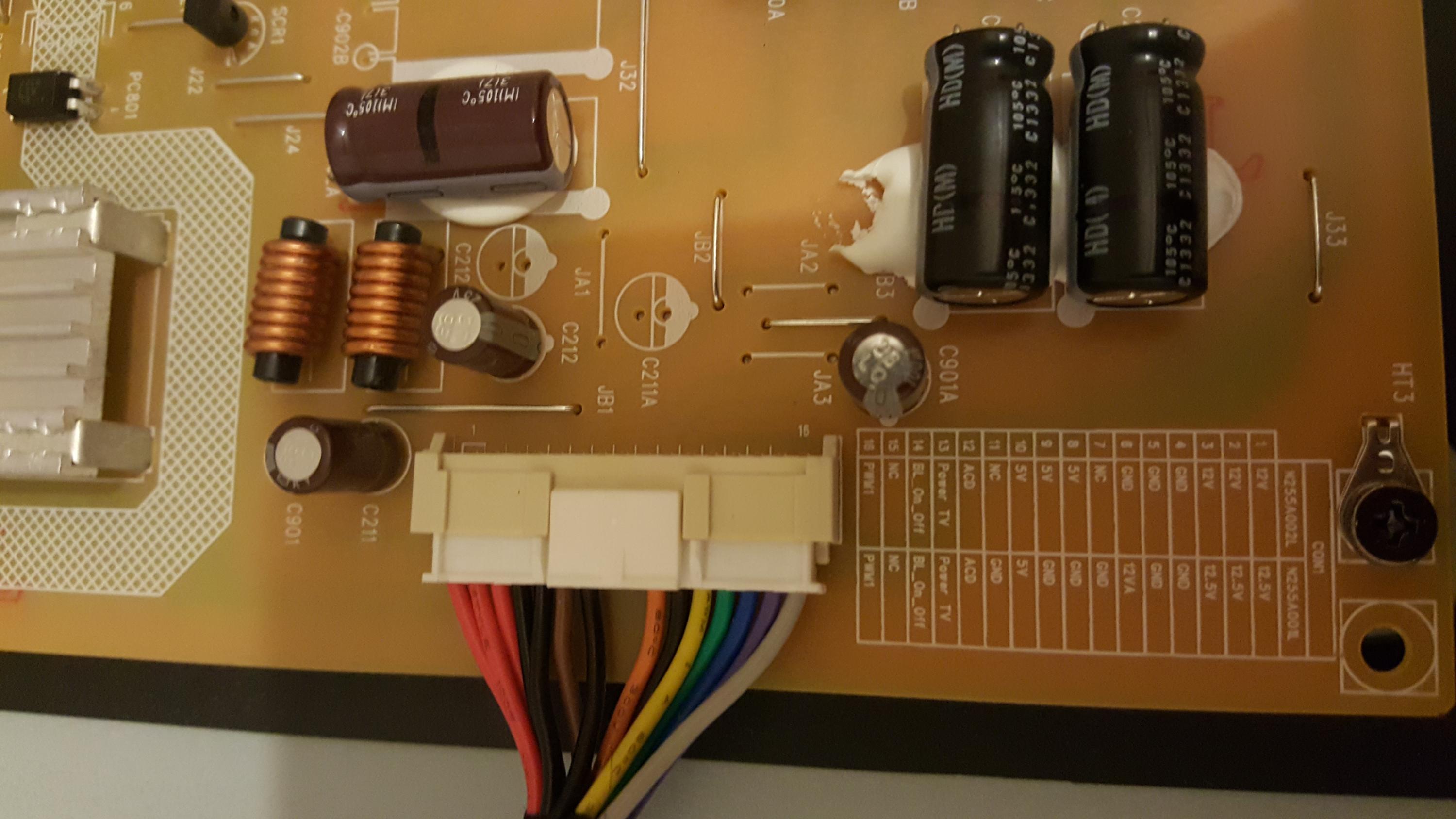

    Can give the pin legends and what voltage is measured at each pin?

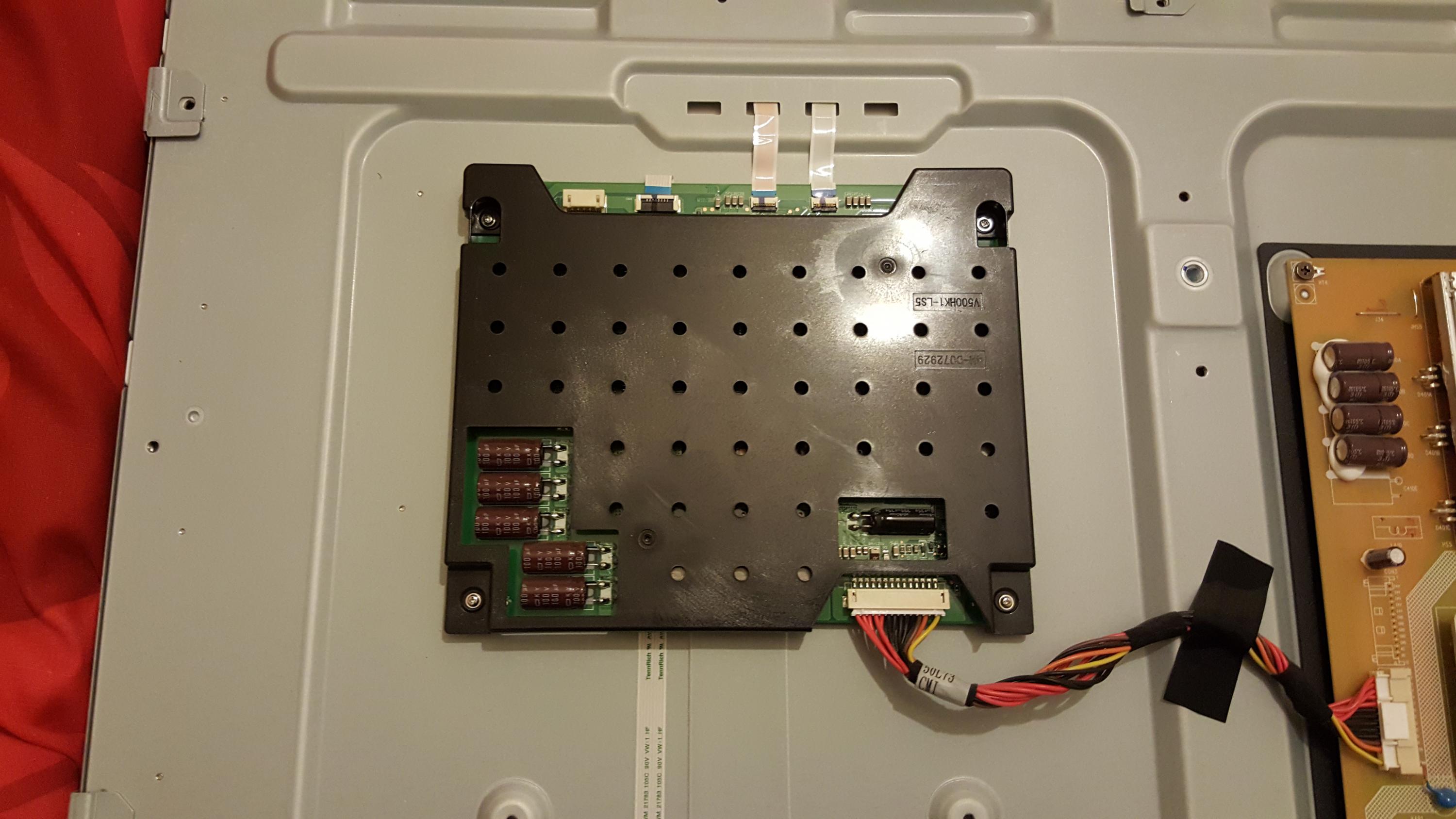

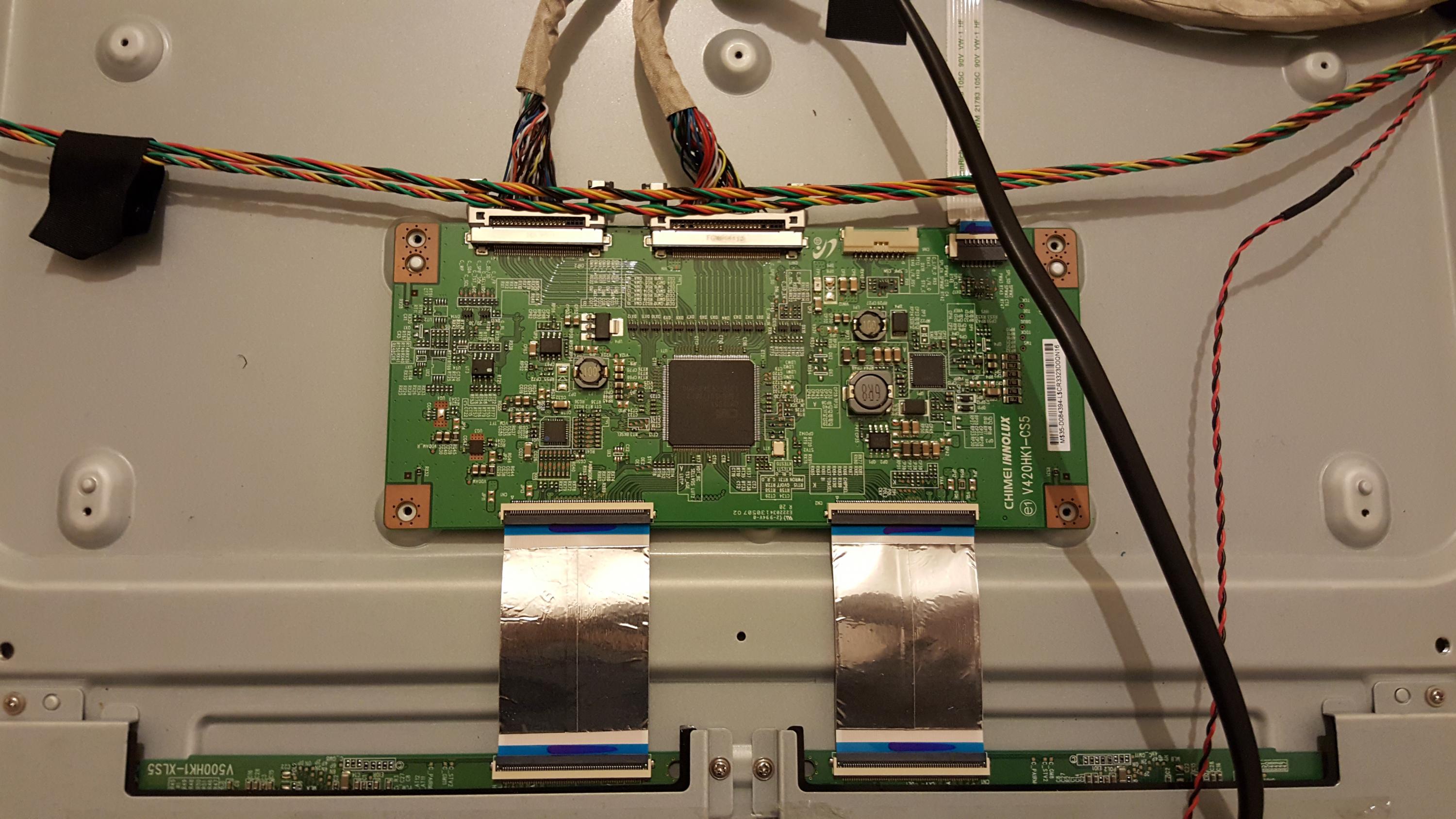

        Re: toshiba smart tv , only backlight , no picture
        We need to have the exact model number of your TV. I suspect the Tcon board. Turn the TV on and check the fuse on both sides on the Tcon. If the Tcon is directly over or under the LCD directly tab bonded on, you can't replace the Tcon and the TV is more or less junk. I know you reported no sound.
        Also could be the EEPROM on the main board. In this case freeze it with a can of air upside down and turn the TV on.
        Measure voltages with as requested in post #2 with the TV on and off.
        I think that is enough to chew on for now.

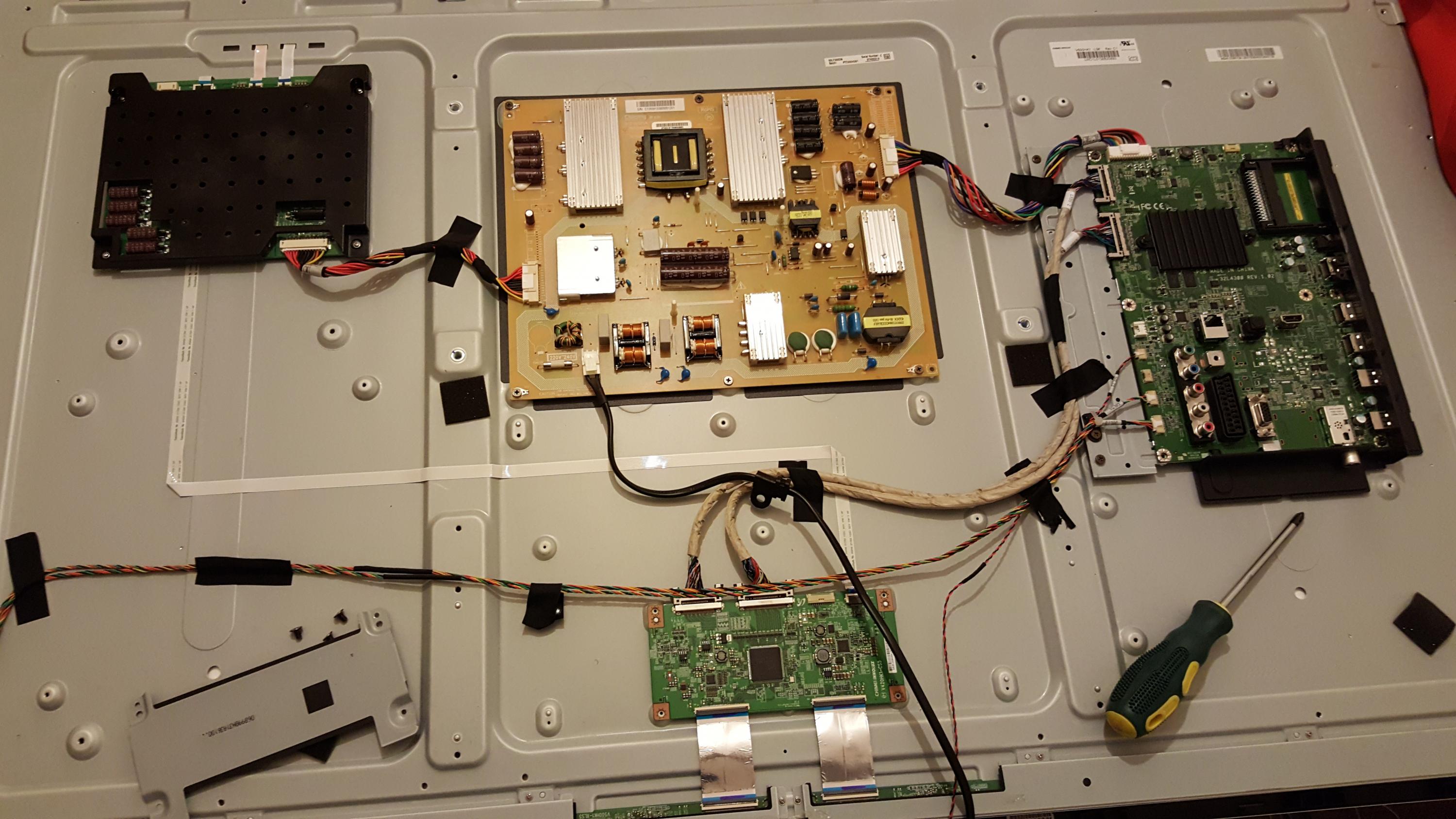

          Hi, thank you. The tv is Toshiba 50l7355d I think . I'm not at home yet, I think the t-con is a separate board I don't know why you think I can not replace it!, is it possible that the t-con can freeze the tv an stop it from coming on ? Plus the tv powers on straight away with backlight only without touching any button. I'll check all the points have been asked to do . May you explain to me that part (In this case freeze it with a can of air upside down and turn the TV on) please. Thank you again
            Some Tcon's are not made to replace, as they are tab bonded on to the panel. In this case, things do not look good at all.
            You can check the LVDS with a 100Mhz oscilloscope and turn the menu on and off all the time... this way you can verify you got signal coming from your main board.
            Bad Tcon = No picture but sound. ( Since you can't see anything I am not sure if you are on the correct input or not). So more investigations needed there.
            The EEPROM on the main board can inhibit the TV to boot correctly. This case, no picture no sound, TV turns off again and other weird things. I have a 70% success rate by freezing the EEPROM to make the main board boot correctly. If there is a bad EEPROM, you need either a new main board, or replace the EEPROM with a programmed new one. So either you program the new EEPROM yourself or buy an already programmed one.
            It also would be good to see the voltages on the PSU (bottom left connector) while the TV is on. Post pin out name with voltages measured.
            So all in a nutshell right now we have to figure out which board is causing the problem.

              Unfortunately I don't have oscilloscope.by the way the tv stock on the stand by mode. Red light on and stays on.the red light is not not changing by Pressing on any button on the remote control or on the back of the tv . I don't know if that can make you ignore the t-con, may you explain to me how to freeze the EEPROM with extra details?

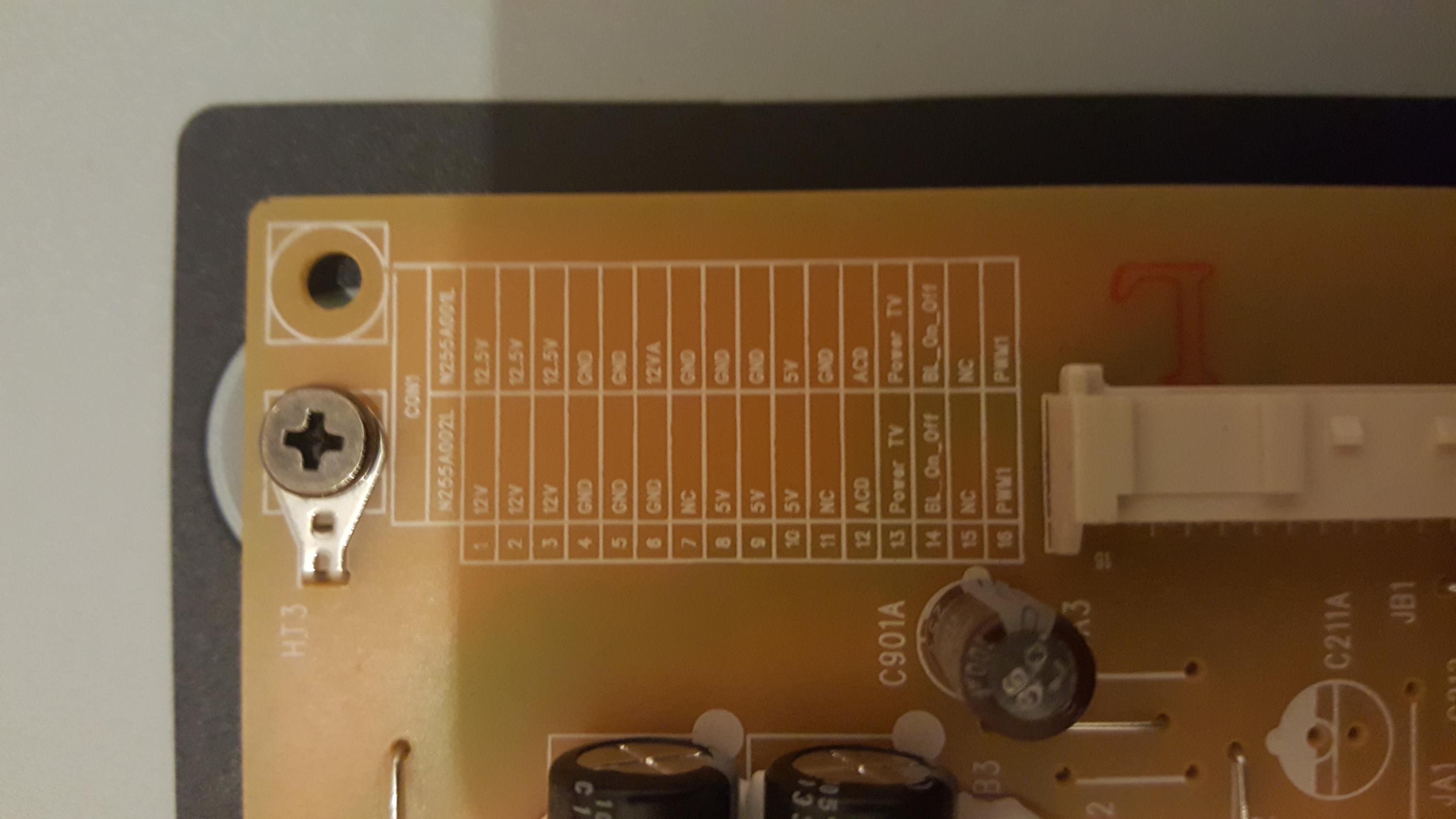

                  hi again
                  pin 1: 12.15
                  2: 12.15
                  3: 12.15
                  4: 0
                  5: 0
                  6: 12.15
                  7: 0
                  8: 0
                  9: 0
                  10: 5
                  11: 0
                  12: 3.28
                  13: 3.15
                  14: 3.33
                  15: 0
                  16: 3.26
                  voltage on both sides of the fuse( on the t-con board) is 12.9

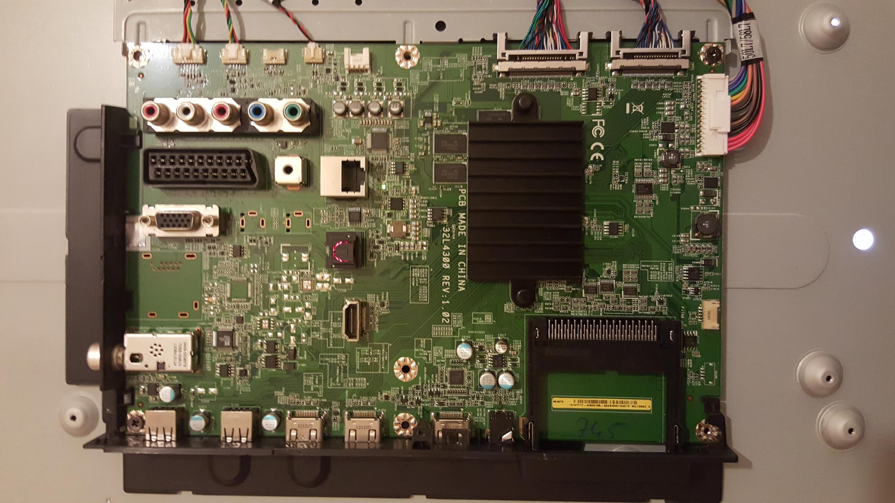

                      Not good news by the looks of it.
                      All the voltages you give appear to be what is expected. The 12V supply is on both sides of the Tcon fuse. The backlights work.
                      Looks like an EEprom problem or main board processor fault.
                      Hopefully someone else can give you better news.
                      Edit
                      Just taking another look at your reading. Should Pins 1,2,3 be 12.5V and Pin 6 be 12V
                        yes thats right , it might be the multitester i use is not good enough to give the right votage!!! or?
                          press on that black heat sink on the main board a little and turn on the TV. see what happens...
                          PSU voltages are correct. How did you get these? Is the PSU turning fully on just by plugging it in, or did you turn it on with the remote / button on front?

                            Thanks I'll do it today night after work, when plug to the main without touching the remote control or any button on the tv start blank for a 5-10 seconds , in the same moment(within the 5-10 seconds) the led infront the tv flash one or two times with green light then the screen goes bright with no picture and the green led goes red . So I read it the pins after that
                              yeah... main board problem...
                                pressed on that black heat sink on the main board still the same, thanks anyway
