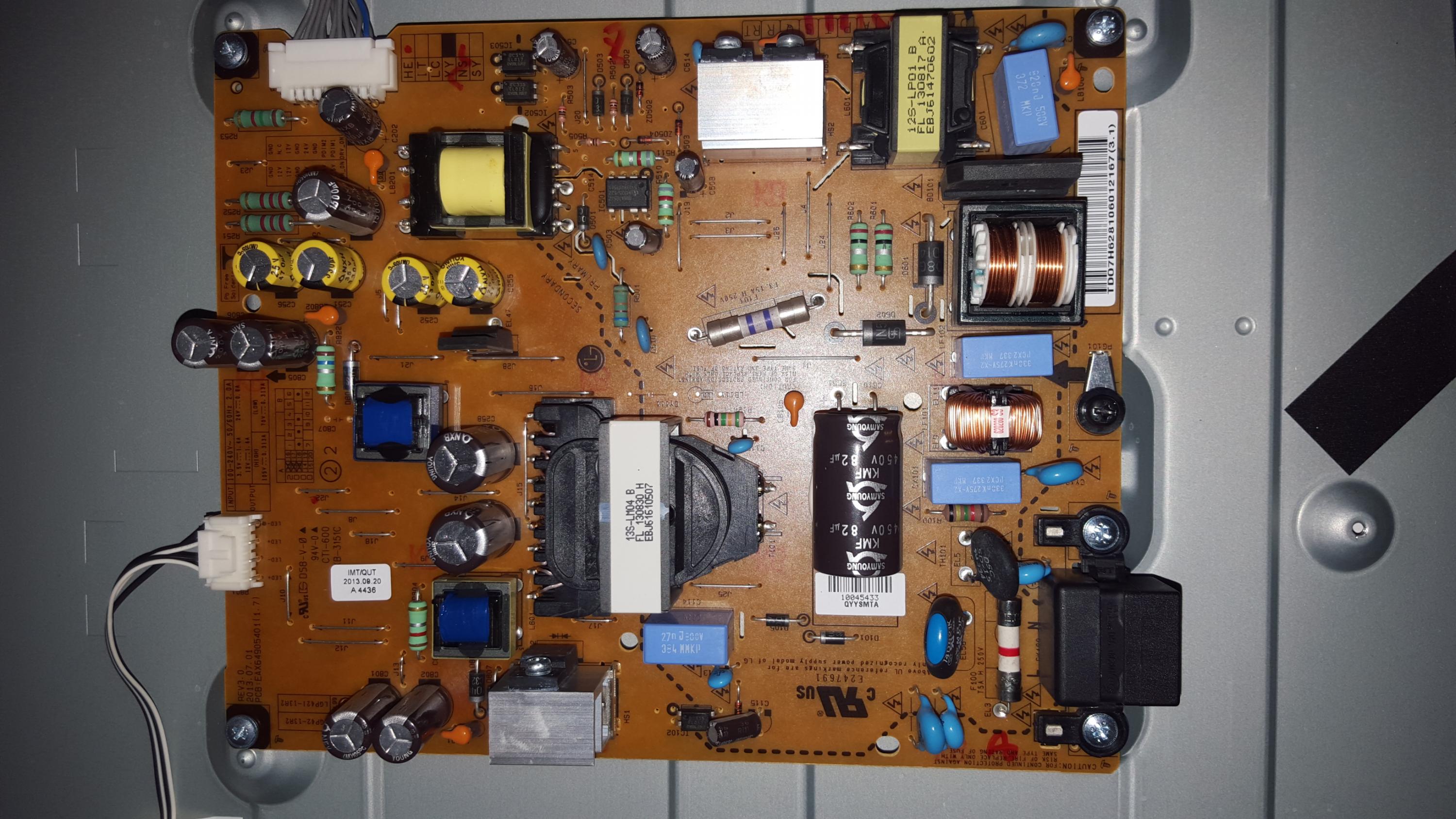

    Backlight flashes once on start up then no backlight but with a torch shining onto the screen you can see images ok
    voltages seem fine also 58 volts going to the panel/LED`s not dropping
    anyone come across this before or is it a bad led ?
    thanks

    Re: LG42LA620V no backlight
    take it in parts till strips of LED, led shorted or open.
      What is the Voltgae rating of those two lyrics cap by the bottom left of #2 picture where the boost converter for the LED driver circuit is?
      58V seems low but I cannot tell yet until I have a chance to look closer at that boost converter section later on, I expect it to jump up higher than 58V at first and then drops down to 58V, but as history of LEDs backlights I will not be surprised if you have bad LEDs.
        hi budm
        do you mean the two caps i have circled in the picture ?
        and yes when the tv first boots up voltages are 59.8 volts then drops to 58.4 volts and stays steady
          NO, the two brown electrolytics caps to the left side of the board, and actually there are six brown lytics caps in the LED driver sections and also two inductors for boost converter circuits so the LEDs are not connected in one large LED string.
          According to the Voltage chart next to the LED connector, the Voltage for the LED is 105V, 0.313A? I cannot see the chart that clear.
          You need to leave the red probe on the L+ and black probe on GND then turn on the TV and watch the meter to see how high the Voltage goes up too, you need to do that twice since you have two L+.
              correct
              105V, 0.313A HIGH
              70V, 0.313A LOW
              and yes 105 volts when i first turn the tv on then drops so its pointing to a bad led i think
                Fixed :
                luckily had some spare LG LED strips from a cracked screen tv testing as we speak
                  Thanks for the follow-up on the repair, another failed LED backlights.
                  The trick when measuring the LED supply Voltage is to leave the probe on the Voltage supply pin for the Anode of the string before turning on the TV and have good meter that can response fast enough to capture the Voltage rise before dropping down due to protection circuit kick in. 58V is the feeding Voltage to the boost converter circuits.
                  BTW, what are the Voltage rating of those caps I asked?
                    No budm sorry i could not see any ratings on them
                    • dick_barton
                      • Aug 2015
                      • 6642
                      • Wales
                      The two brown capacitors C801 & C802 are both 33uF 200V
