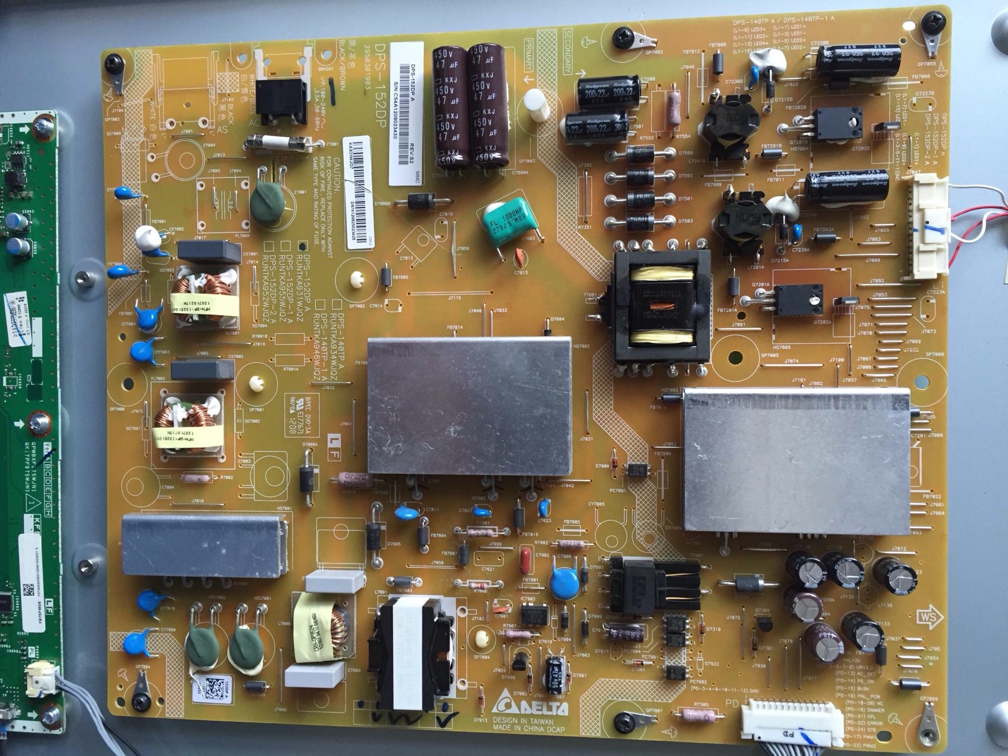

    I just picked this tv up. Owner said he went to turn it on and wouldn't come one, just a flashing logo which I have verified. The flashing pattern is 1 slow one followed by 1 quick one.
    He took it to repairman, who after taking it apart told him it needed a new psu for $130 plus labor.
    He declined and bought a new tv.
    I'd like to try my hand at fixing this psu at the component level before I try to just swap the board. So I need guidance from you masters.

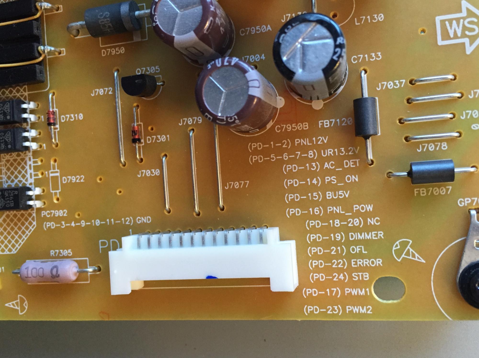

      Re: Sharp LC-52LE640U flashing logo.
      I get 5v from pd-15 bu5v.
      That's all. Nothing from the other pins on that connector.
        you have to "fool" the power supply to come on but "strapping" the "PS_ON" signal coming from the main board to the ps. This usually done thru a resistor to the 5v supply.

          I looked at a YouTube video, I'm not getting any voltage on the ps_on as the video shows. The only voltage I get it 5v on bu5v.

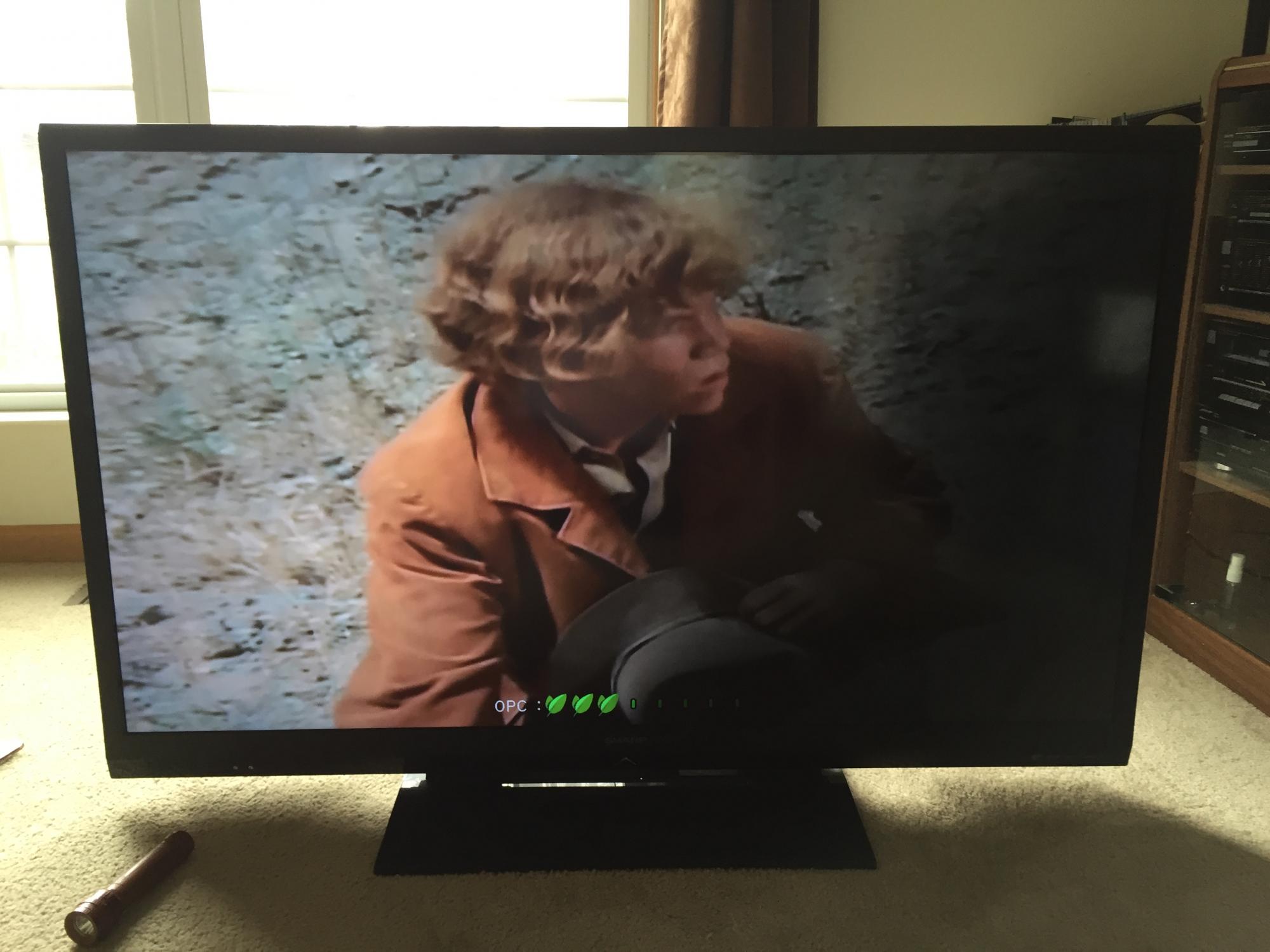

              Was able somehow to get it to turn on. When looking at it, the right side has a darker side then the left.
              Would that indicated bad/shorted LEDs or something in the psu/inverter?
                    You have an Oc or shorted Led in the screen. You need to take it apart to test and replace them.

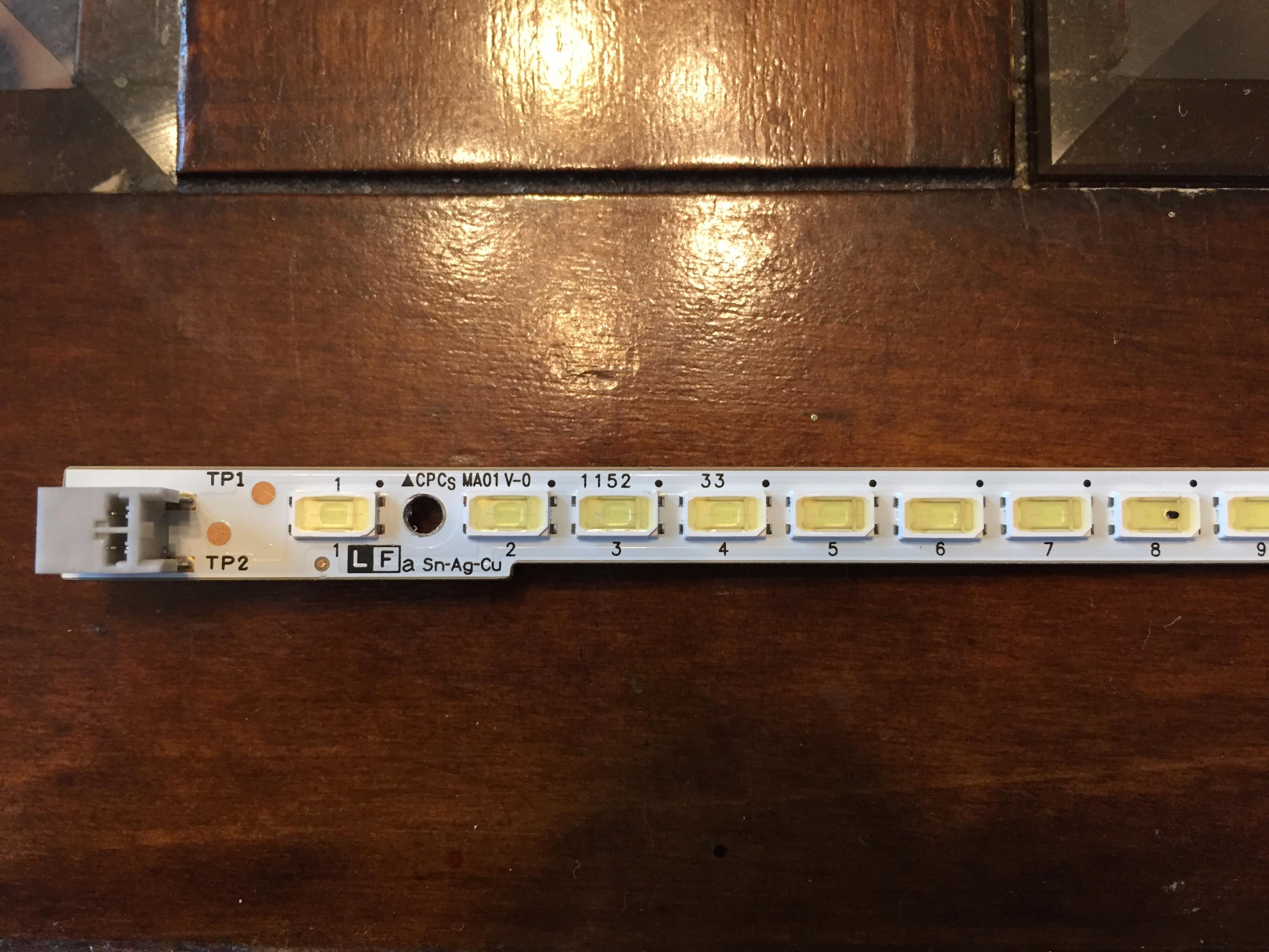

                                  I took it apart and got the led strip out, can anyone help me identify the part number?

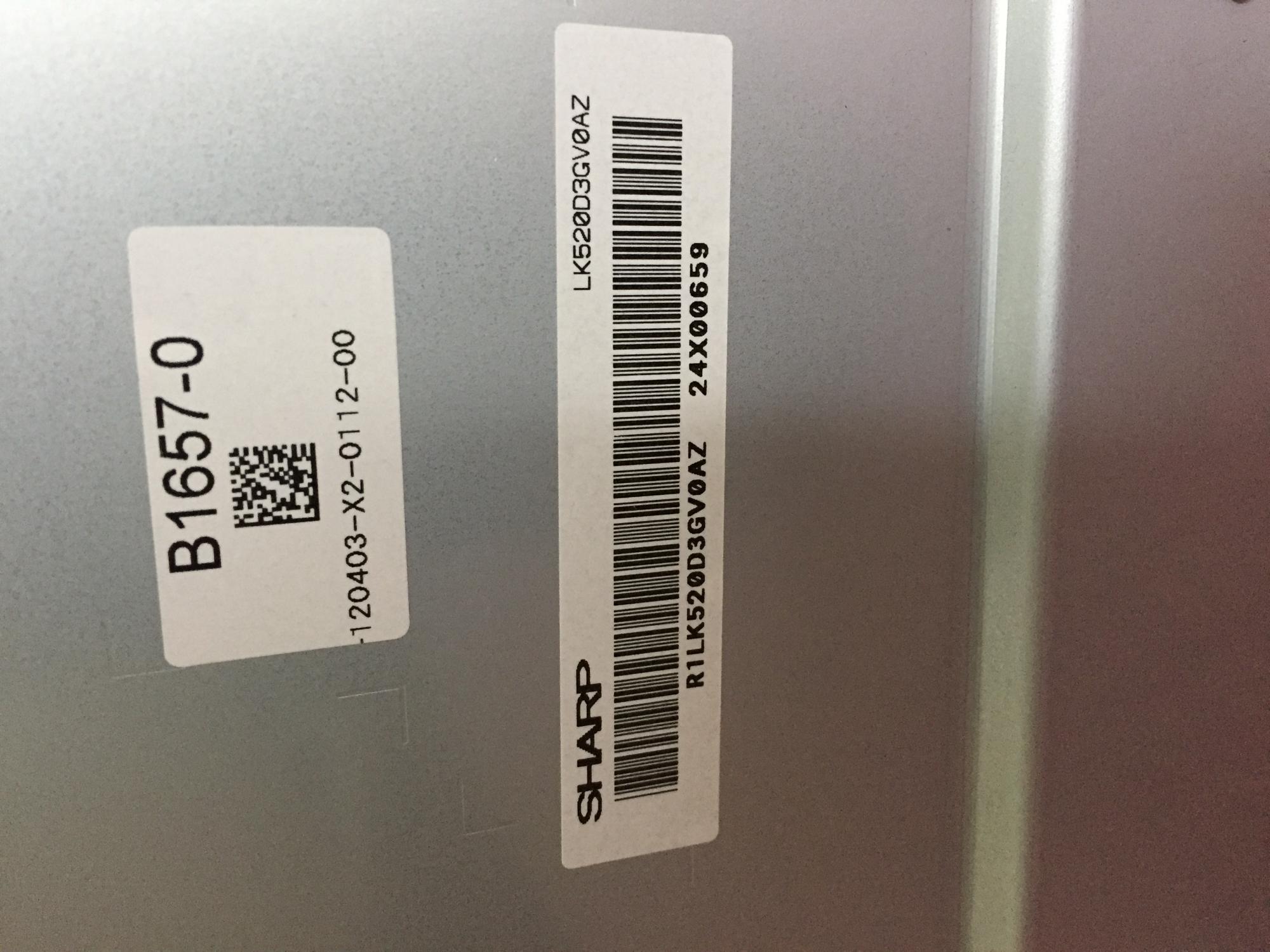

                                    BTW, do you have the LCD panel model number?
                                    http://www.ebay.com/itm/SHARP-LC-52L...p2047675.l2557
                                    Part# RUNTK5208TPZZ and RUNTK5209TPZZ

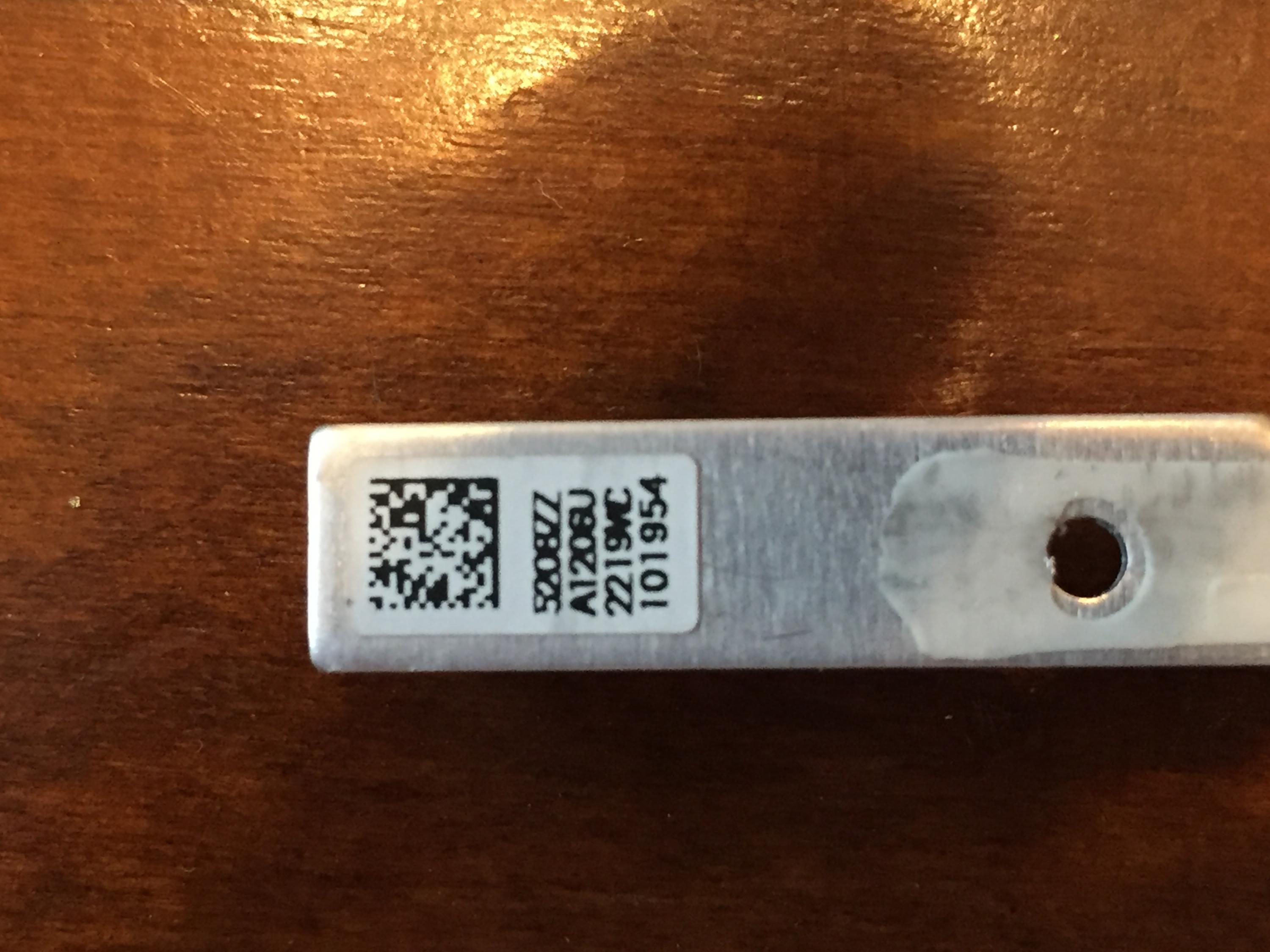

                                      Is it one of these numbers?
                                      In my picture folder its posotioned coeerectly, I don't know why it sideways here.

                                        That is it, BTW, see the my previous post for the Sharp P/N for the LED strips.
