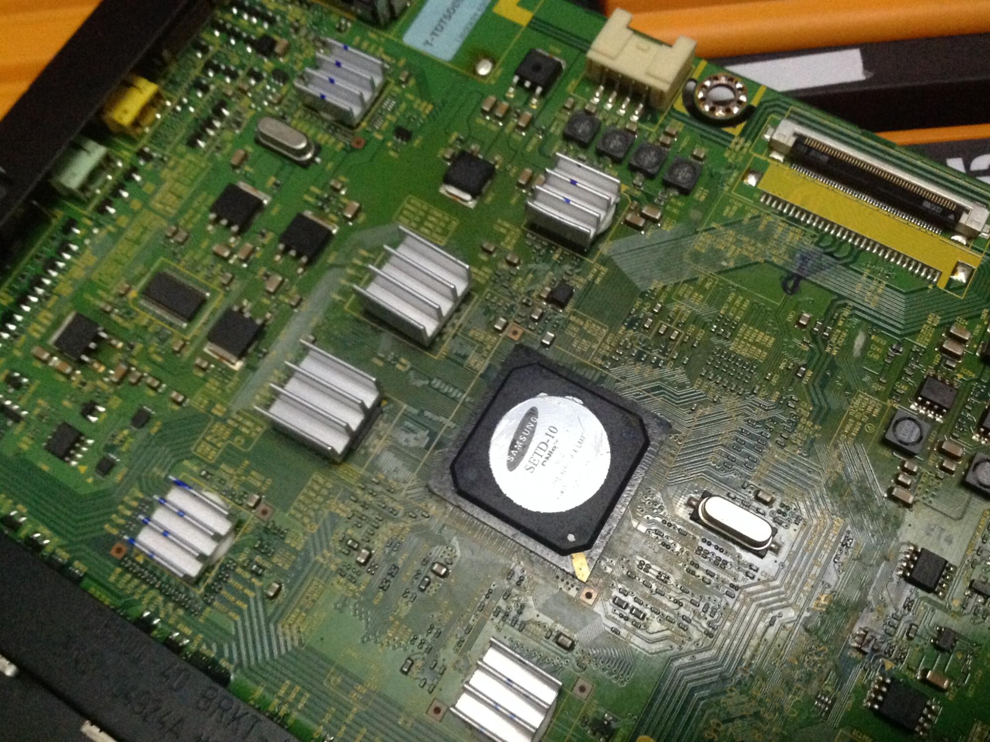

    A final update it didnt work out for this one, after Diif kindly did a reflow on the Cpu it still failed. Come to the conclusion the actual Cpu Ic which is a custom Samsung SETD-10 chip is failing internally so will need to be replaced.
    Replaced Mb and the Tv is working great, I will be uploading images soon showing how hot this chip was getting, the thermal pad went rock solid and brown it got that hot and you can also see the scoring on the case in previous images.
    The new Mb I replaced the heatsink on the main Cpu with a better one and added thermal silicon to it which works alot better should help it cool better and last longer.

      Glad you sorted it in the end Reece.

        Cheers mate, I really appreciate your help with it always worth a try. I could have ordered that Ic which had pre applied balls but thats alot of messing. Anyway after all that hes buying a new one in the next two weeks lol but I will be selling this on
