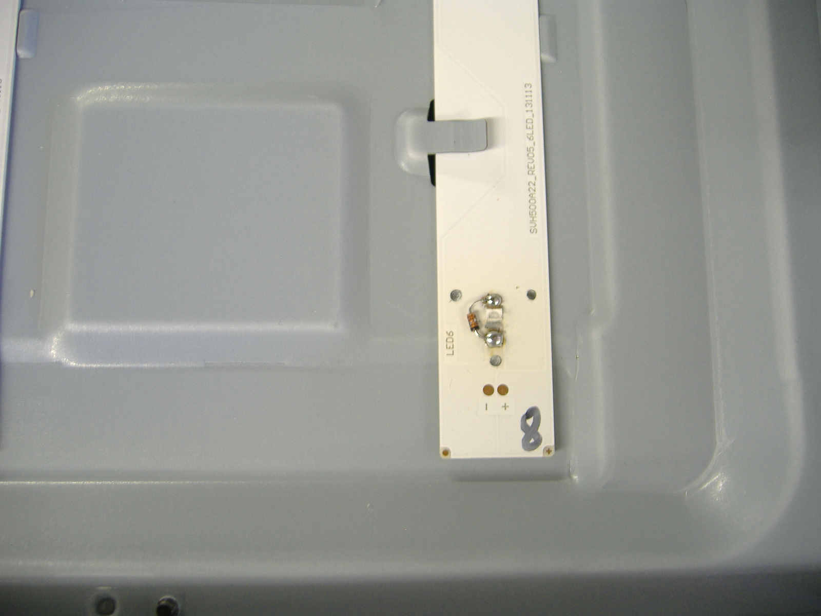

    Another dim display solved by repairing the lamp house.
    photo 1 shows dim illumination with the last led on strip 8 not burning.

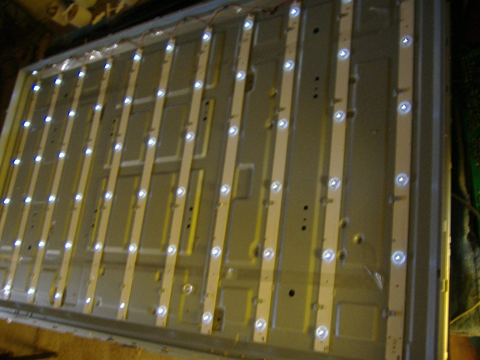

    Photo 2 shows that i swapped strip 8 with strip 12, putting the faulty led in the bottom right hand corner. lamps still burning dimly.

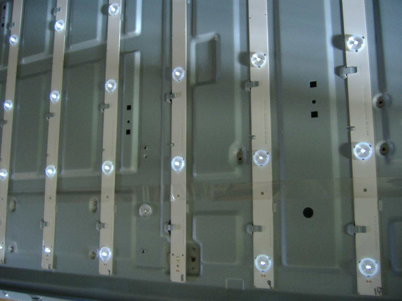

    Photo 3 shows the faulty led have been replaced with a 1n4148 (i dont know if this is "legal")

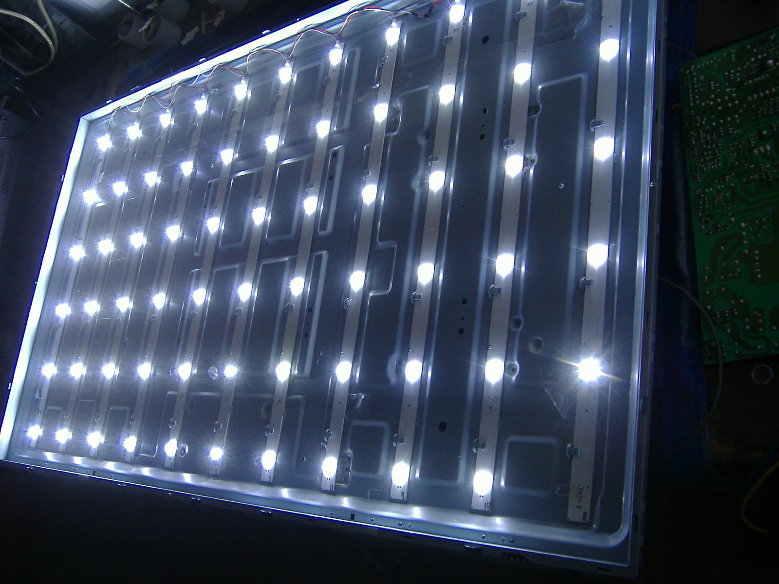

    Photo 4 shows leds now all burning brightly.
    The faulty led read about 1.5 megohm either way.
    A good led showed no resistance either way on my dmm's resistor setting, but illuminated when i foward biased the led on my dmm's diode setting.
    Thanks to the guys who posted the information on led & flourescent illumination.

    You should use 5 1n4007 in series to simulate one white LED, 1N4148 is not going to last.
      Re: Hi Sense LEDN50K20DGP Dim picture Repaired
      better yet another LED from some junkers...
          Thanks Budm, I didn't know the Led's handled so many amps, in future will use the stacking method as demonstrated in ReeceyBurgers video.
