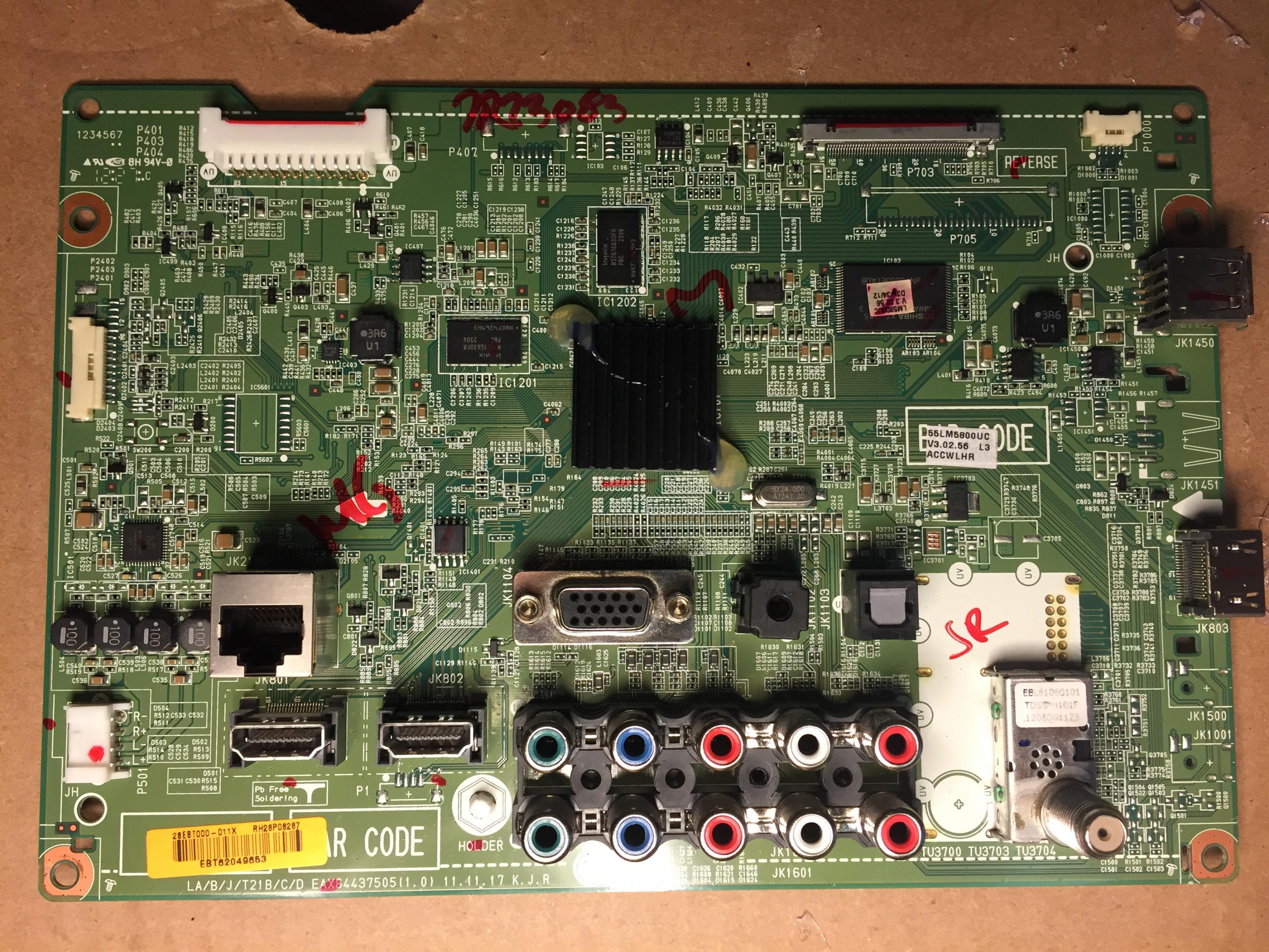

    You can start by uploading good clear pictures so we can see all the boards and how all the boards are connected together, then you will need to do good visual inspection and then Voltage checking at the connectors.

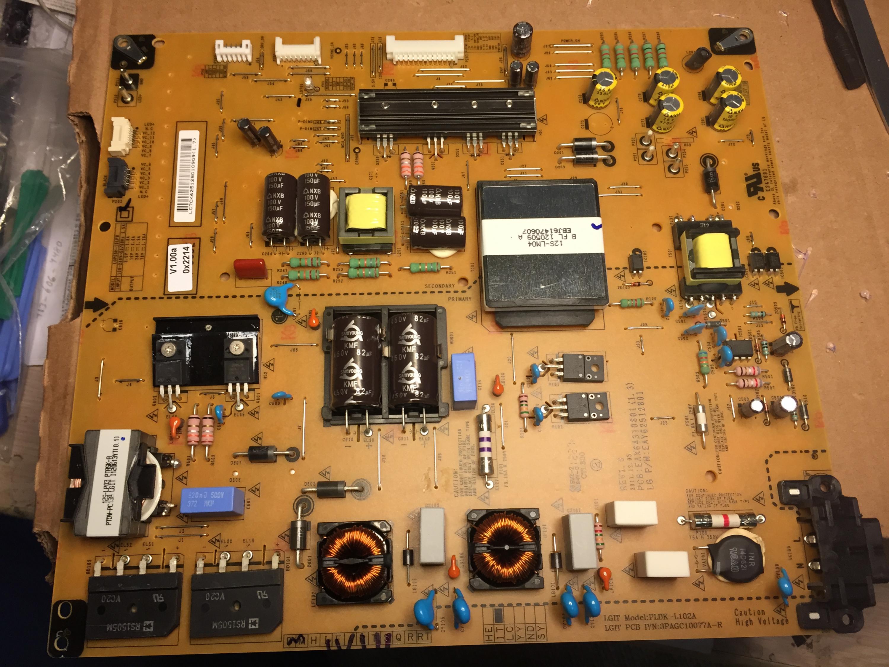

      Here are pics of the main board and power supply already removed.
      There is 3.5V standby on the power supply but that's about as far as it gets...
      Visual inspection does not reveal any burns or bulging caps.

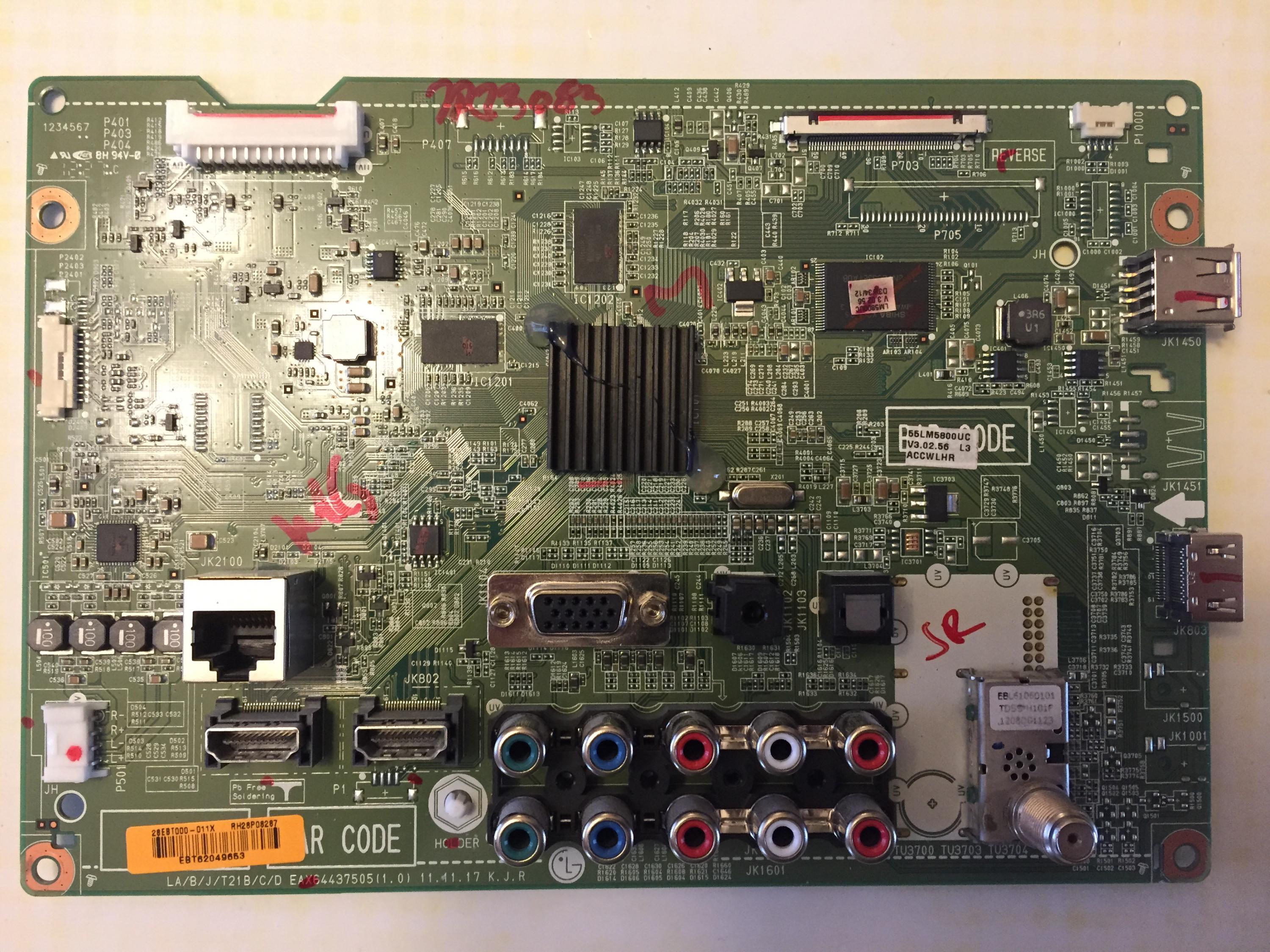

        this is hopefully a clearer pic of the main board

          If the PWR-ON pin on connector P201 the the main board is not sending the PS-ON to turn on the main power supply and since you also indicated all other pins are showing 0V but you do have 3.5VSTBY Voltage then it points to the main board.
          Did you try disconnected all other boards to the main board but still have the Power board and the Power button board connected to see what happen?

            Yes, with the T-con and speaker cables disconnected from the main board (and also tried LED cables disconnected from the power supply), the result is the same.

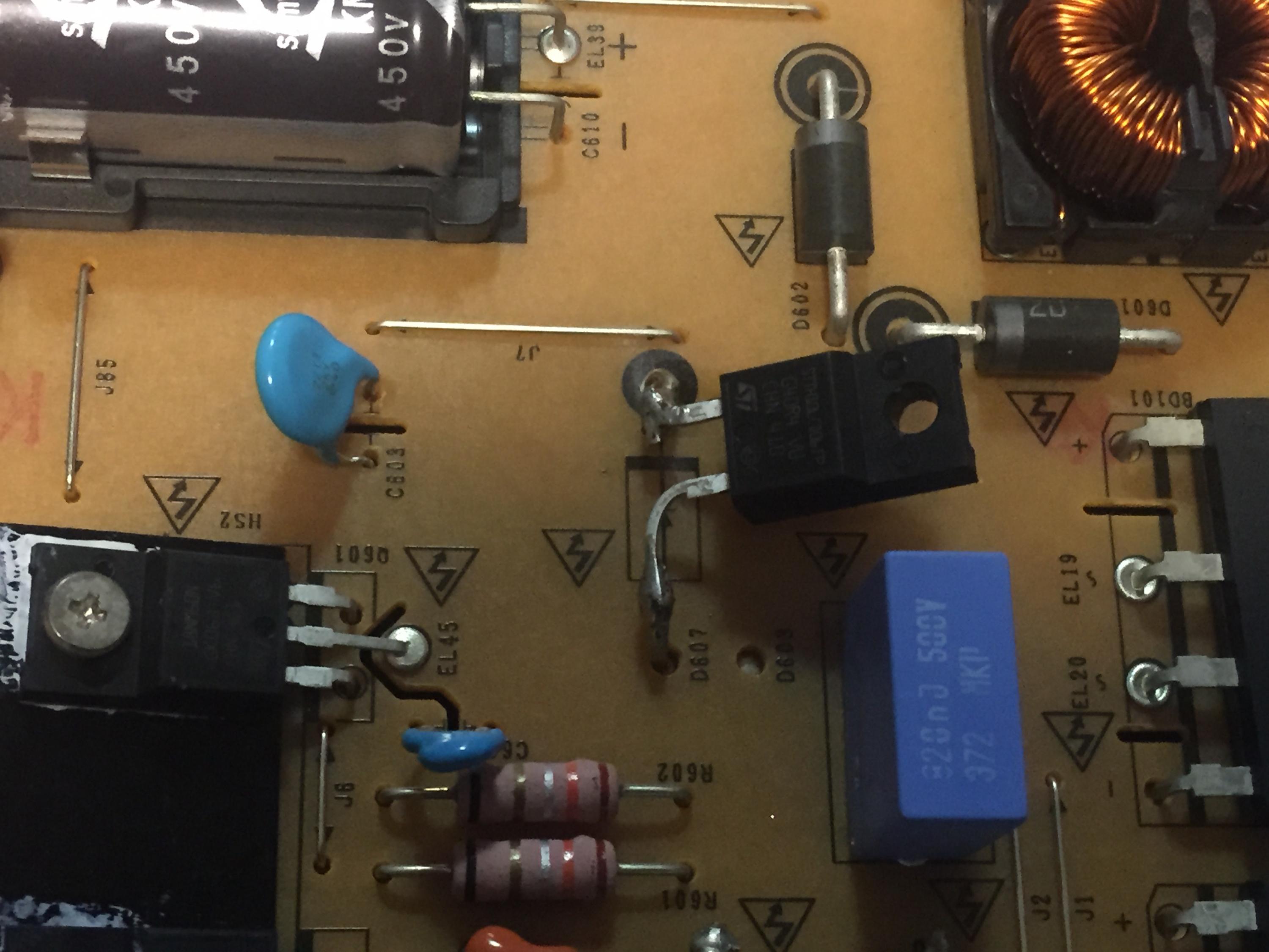

                  Just to follow up. The troubleshooting process, by following the service manual, suggested the power board was the likely culprit. This was not what I initially expected. I began searches using the power board number and discovered that a ceramic cap C603 and diode D607 often get shorted. Sure enough these two components were shorted on my board.

                    That is why were you sure that you do not have the PS-ON signal since you do have the STBY Voltage, the C603, D607 are part of the PFC Voltage booster circuit, when those parts failed you will not have boosted Voltage for the main SMP power supply section.

                      A search of the part # of this board "EAY62512801", will bring up a schematic of "Revision 2" of this board. The only change is D607 is upgraded from the mentioned 4 amp diode MUR460AG, to a 10 amp rated diode. Part number of the new diode is STTH10LCD06FP. I've replaced mine with the new part, and it works well now. It is a different style package, a TO-220 instead of the axial type. So it took a little creative soldering to get it to fit on the Revision 1 board. Also it has to be kept below the maximum component height of 15.5 mm. One leg through the board, and a short jumper to the other leg works well.
                      So I installed the upgraded 10A diode component and also upgraded the cap from 200pF 1KV to 200pF 2KV and the TV works well!
                      I've attched a pic of the board with new components.

                          For anyone who finds this thread like I did, this repair worked for me. I upgraded the D607 diode (P/N: STTH10LCD06FP), and used a 220pF 1KV capacitor at C603 (P/N: C322C221JDG5TA).
