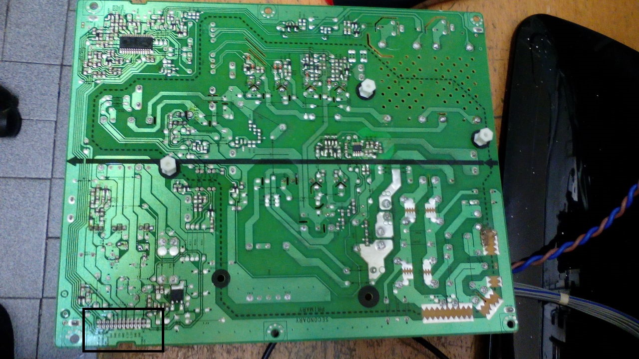

    what happens is:
    i connect the main cable power nothing happens completly dead, no standby led nothing... then i measure the +5v of standby and i got 5v on standby voltage, if i disconnect mainboard
    i still got the 5v standby but no led on front
    so what i do is to disconnect the mainboard and turn on psu with a 10k resitor shorted between +5v and pwr on, then i connect maisn cable again with the mainboard disconnected and measure
    the voltages and i got all voltages, +5v +12v and plus 20v, also on inverter error i got 3 volts more or less, so i assume the psu is working....
    i connect again mainboard and i put multimeter on the 5v line and when i press the button i notice that the voltage drop to 2 3 volts and back on to 5v when i release...
    this board has inverter in it so what i do next is disconnect mainboard again, short +5v with pwr on with a 10 resistor to turn on psu and then i short with a wire the pwr on with the inv on
    to see if i have backlights... and i dont have... so the psu is working but i cant have backlights...
    on the board there is two inverter transformers, when i measure the primary it gives 0ohms, when i measure primary vs secondary it gives OL but when i measure the two pins on secondary side i get 0 ohms...
    on both transformers
    here is the image where i get 0 ohms reading:
    http://postimg.org/image/keloc3vor/
    adult image hosting
    each transformer has 2 pins underneath where i put the red circle i think it is the secondary because it goes straight to the lamps after that...
    is the inverters shorted? or this is normal ? i dont know if i should replace the mainboard or the psu ? can you help me please ?

          please post a picture of the full power supply
          bright clear images of front and back thank you
            Re: 42lg2100 dead, no standby led help
            ok here it is...
            i only need to know if to turn on the inverter is just short the pwron with inv on ?
            is it normal to have 0ohms of measure on both sides of the both transformers on the secondary ?
            http://s24.postimg.org/49of2du5x/IMG...403_200946.jpg
            http://postimg.org/image/g1cad6os1/
              What are the labels on the pins and what voltages do you have on each.
                ok labels are:
                nc p-dim
                a-dimerroe
                nc inv on/off
                20v
                gnd
                12v
                gnd
                5.2v
                5.2
                gnd
                gnd
                nc power-on
                with psu off i have all 5volts only
                with psu on with a resitor of 10k ohms shorted between 5v and nc power on i have all 5v 12v ands 20v
                on a-dim error i got 3 volts more or less...
                  So it looks as though the power supply is working.
                  If you reconnect the power supply back to your mainboard but disconnect the wire Power_On that comes from the mainboard to the power supply and measure the voltage on that wire.
                                Sorry but just checking that you were measuring the voltage coming from the mainboard and not the voltage on the Power_ON pin on the power supply.
                                If you have no voltage being sent to the power supply from the mainboard then it would indicate that your mainboard is at fault.
                                Can you post a sharp image of your mainboard. Perhaps one of the voltage regulators are faulty.
                                  yes i measure on the wire coming from mainboard, and i disconnect on psu
                                  here is the image where the cable enter so i assume is those regulators you talking no ?
                                  http://postimg.org/image/ceftsvxnl/
                                        The two regulators I can see are marked although there could be more on the circuit board that are not shown.
                                        Can you check what voltages, if any you have on each one. Also check that they are not shorted.
                                        Edit
                                        I have missed out IC801
