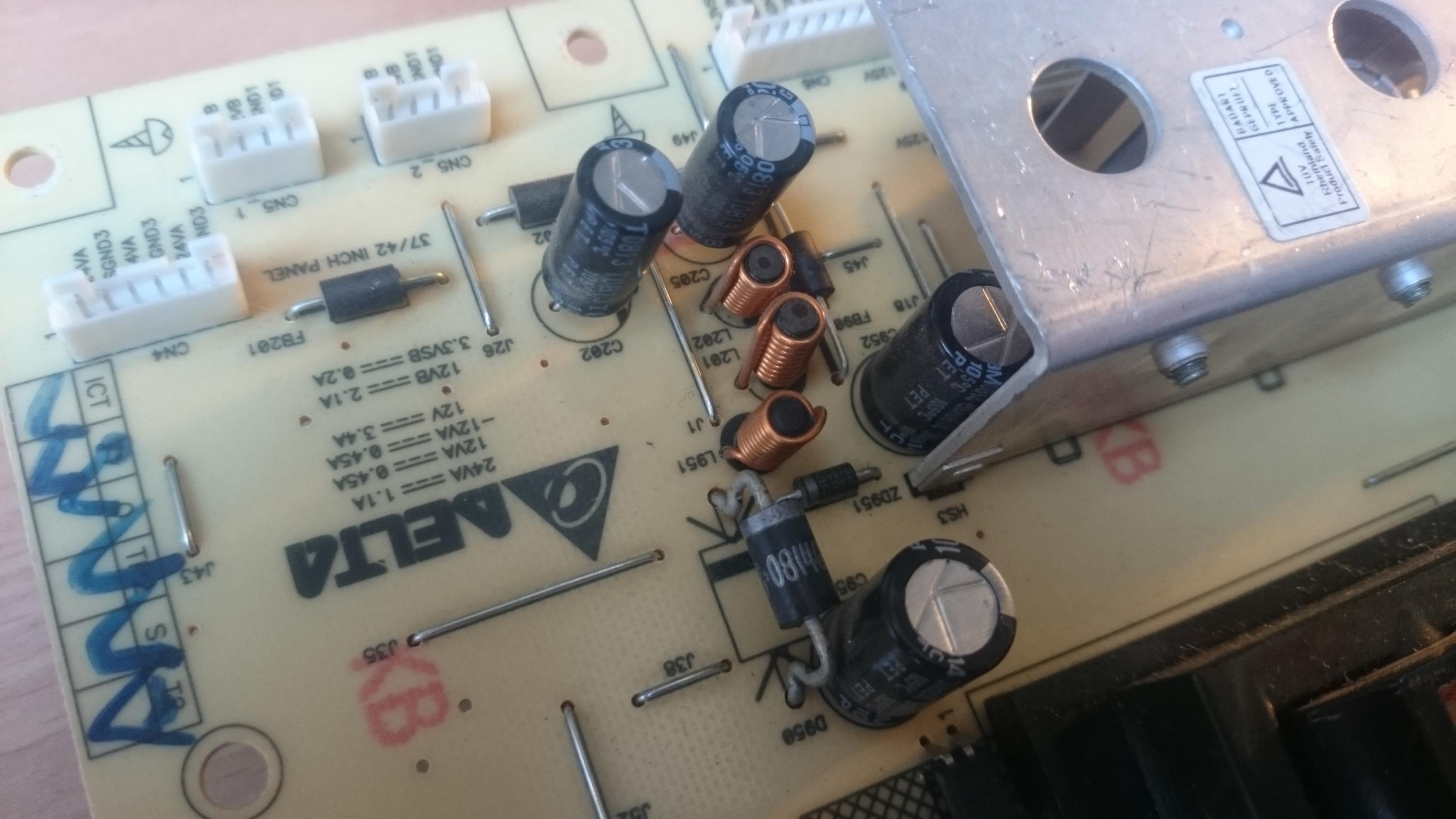

    already check it, and fine, but no voltage though it or to it, same with all other diodes.

        How did you test it? Were you looking for the Voltages?
        I request you to test the resistance, not Voltage and no power to the TV.

            Re: Philips 42pfl7603d/10 dead
            yes i was looking for voltage, tryed to follow voltage from mains and across F2 it goes though some resisters and reduceing the volts down to 7v AC at a SM cap and then cant get any think after, so then tryed traceing from 3.3 stb pin back into the board and again cant seem to find any voltage,
            so any idea as to what resistance i should get, and from what points do i test ?

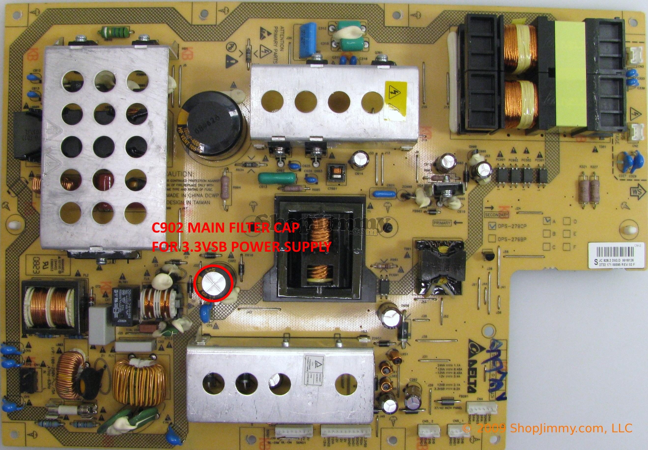

              So you did not do the resistance test as I requested, and also the Voltage test on the cap as I requested:
              Post 20:
              Check the resistance of D950, ZD951, ZD902 for very low resistance in both directions.
              Check the to see if you have about 325VDC between the two legs of C902.
                set my meter on 2000, D950 red on black end of diode and black on silver end =255, reversed =over 2000 so set meter to 20k and got 2.10.
                ZD951 = 256, reversed =over 2000 so set meter to 20k and got 3.12.
                ZD 902 = 634, reversed = 1033.
                C902, is this the main cap,? as on my board it is C808 and no voltage
                  Look for C902.
                  Pictures provided by shopjimmy.
                      Look for C902.
                      that one, sorry did'nt even look at that because of the voltage you said, so thought it must be the main cap you was after, but yes, tested and got the 335v

                                      I took the working powersupply and plugged in the mains. No other boards connected.
                                      I measure only 3.3V on the 2 diodes on the picture.
                                      I do not measure the 12V etc but thats because the mainboard turns on the rest of the board.
                                      Do you got 3.3v?
