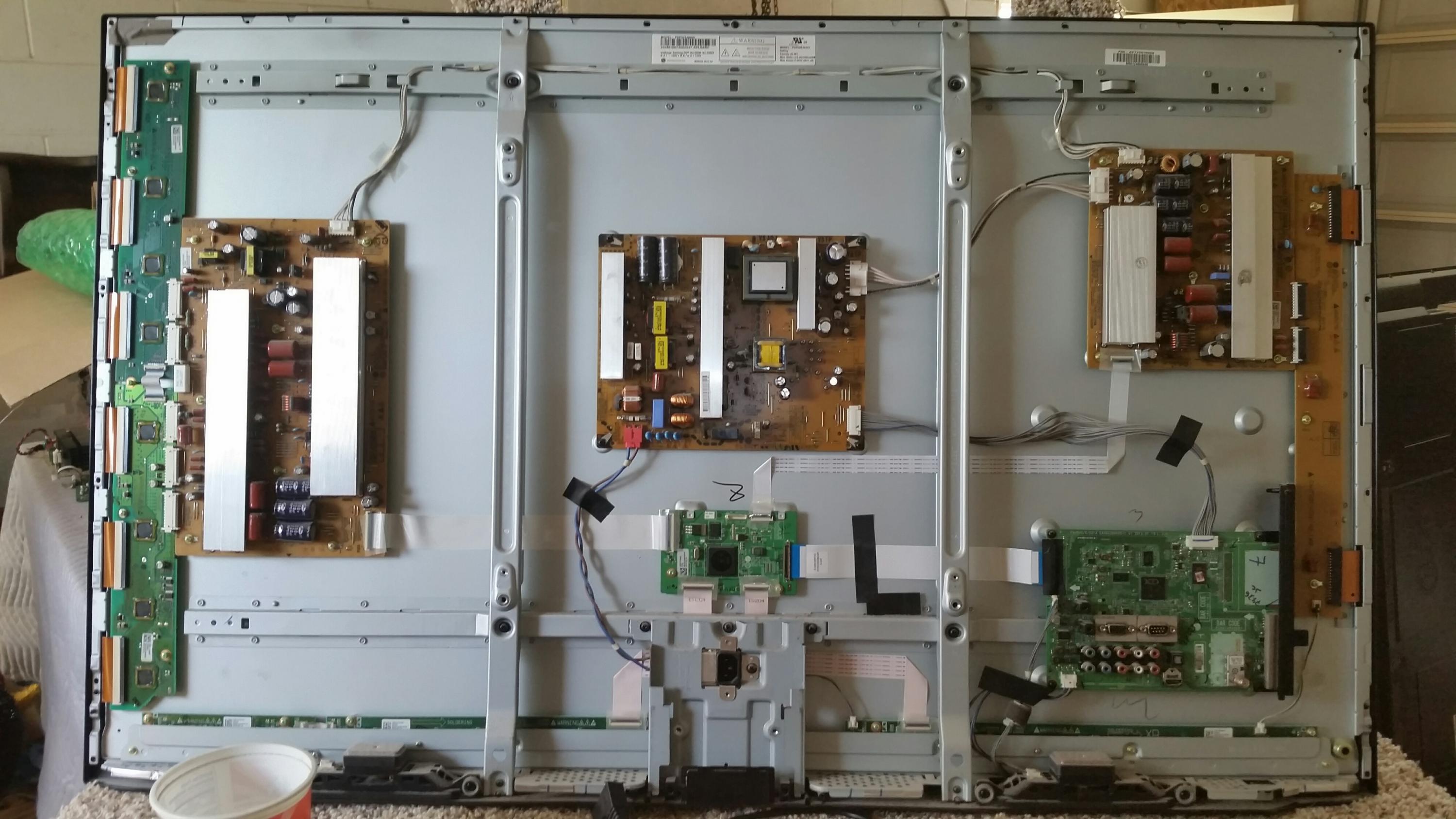

No sound, no video, no clicking. One red LED on main board. No reaction to ON button from remote. It's like it's ON as long as 120 volts is applied to the set. I have all the proper voltages everywhere i.e. 5.2, 17, VS=204.5, VA= 55. I have proper voltage to both sustain boards. C802 on SMPS is not bulging nor deformed, but it is Black in color. I have ordered a replacement for C802.

Yes motherboard fault.Please Do Not PM My Page Asking For Help Badcaps Is The Place For Advise, Page Linked For Business Reasons Only. Anyone Doing So Will Be Banned Instantly !

would be interesting to take a good look at the board and see what got replaced etc when you get it back.Proud owner of dozens of broken TV's and many,many,many boards.

Probably reflowed it or reballed it god knows.Please Do Not PM My Page Asking For Help Badcaps Is The Place For Advise, Page Linked For Business Reasons Only. Anyone Doing So Will Be Banned Instantly !
