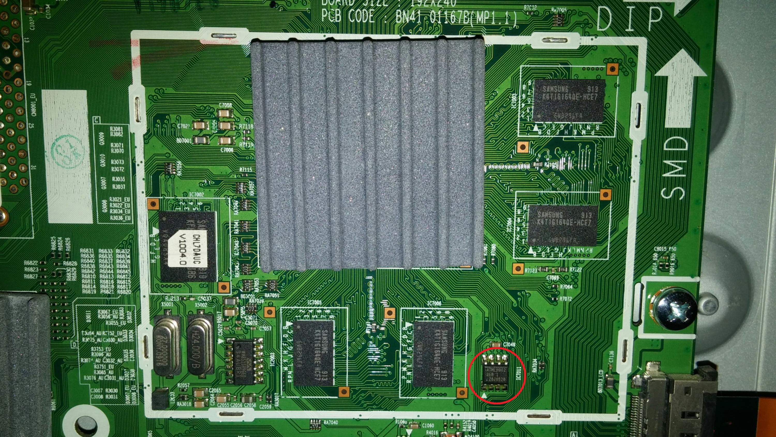

    This set previously had no standby voltage but that has been fixed and all power board voltages are correct when set is on. When turn on is activated the red light gives four slowish flashes as is normal the backlight comes on but red light is then blinking very fast with nothing else happening. Remote signals are received and will put set back to standby but no other results.I suspect ic1803 is the eeprom (not certain) and have tried reset but no change. Am now considering fitting new ic and have read elsewhere that the replacement would self program when set activates. ???? No nothing much about this. Main board is BN41 01022d but I can't supply good pics due no suitable camera. Anyone have experience with this model and eeprom?

    I have posted recently on that same model and approximately that problem, in this thread:
    https://www.badcaps.net/forum/showthread.php?t=38510
    Yes, the blank replacement AT24C256C IC should self-program when you power up the set, but it is likely to have some errors, and this will not be corrected by applying the Samygo fix to rewrite the EEPROM contents. I suggest you save a picture of the summary screen in the service menu, to get the type number of the TV - mine is 40A1UFOC, and I expect yours will be the same. Since you are in Australia, you need the Region to be Asia_DTV. I expect your tuner type will also be the same as mine, which is ALPS. Those three were the only setup problems that mine had after it had flashed the new EEPROM, but I did have to carry out a Service Reset to get everything working after manually correcting the three setup items I've listed. The only remaining issue was that the Time was two hours out, but it corrected itself when I changed the Australian state from the default (NSW) to Victoria.
    In principle the original EEPROM should not have become unstable without a reason. It has been reported that the usual reason is a defective electrolytic capacitor, either on the power supply board or the main board. I checked the ESR of all of the electrolytics on the power supply, and the only two that were present on the main board, and all were good, so I ended up with no explanation of why the EEPROM had become damaged. Note that on my TV, the setup changed itself frequently - at least daily, sometimes more often - before I replaced the EEPROM, but has never changed since, so I feel confident that the original EEPROM was damaged or had been defective from new. I suggest that you check your electrolytics before you replace the EEPROM, rather than risk getting erratic results if you have a bad capacitor problem.

          If you decide to focus on the EEPROM later, you'll probably find that it is the one circled in red in the attached picture of the area around the main processor on the main board.

            Thanks for that info and your good wishes. Just to update while awaiting tcon. Believe now indented eeprom but no luck with pins 5 and 6 short trick. All voltages are good and hold up, backlight activates and stays on, the remote is received, but red light continues fast blinking after initial normal 5 slow blinks. Screen stays black although very light glow seen in darkness. All steps towards a start seem to work OK but just the last step to bring up a picture won't activate. Tcon fuses etc test OK and 12v is on that board.

                I had to replace the EEPROM, not reset it. The Samygo trick (briefly shorting pins 5 and 8, not 5 and 6) is intended to get the TV working just enough to enable you to open the Service Menu, it isn't supposed to fix whatever is wrong. Did you try the Service Menu once you had the raster?
