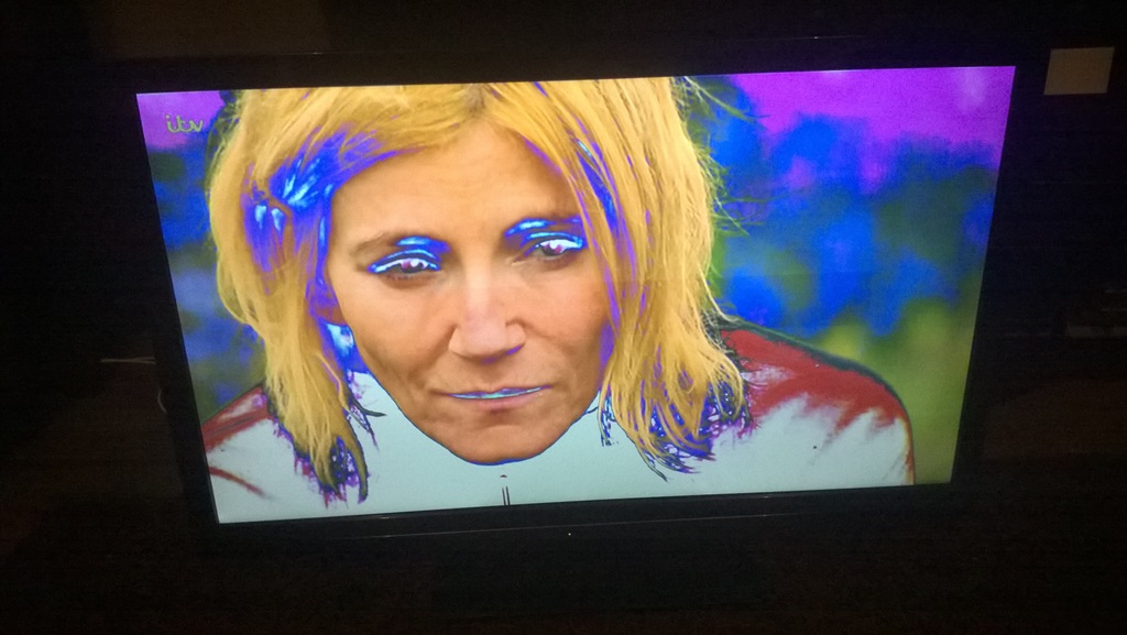

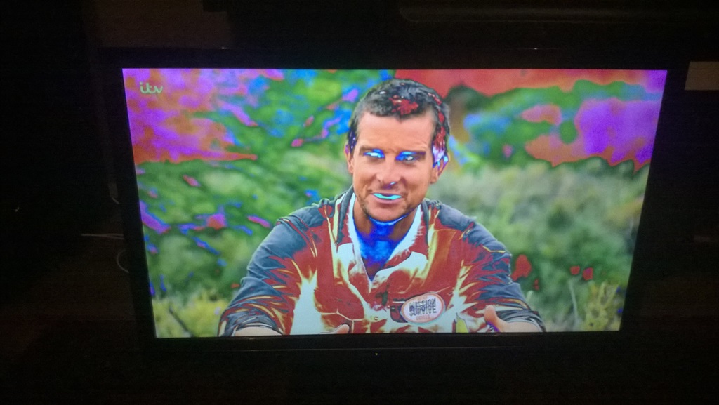

    Panasonic TX-L42E3B LED tv, solarized picture

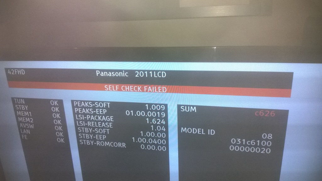

    Panel LG, changed T-con already. Still same.
    Self check failed: sum c626.
    What else can I check.
    Thank you.
    Regards.

    Re: Panasonic TX-L42E3B LED tv, solarized picture
    Corrupted eeprom on the A-board which is pronsbly why there's a checksum error.
      Thank you.
      Is there any way to fix it, please?
      Eeprom reset?
          nope... buy a new EEprom with correct software on it, or buy an empty one and burn the software yourself on it.
