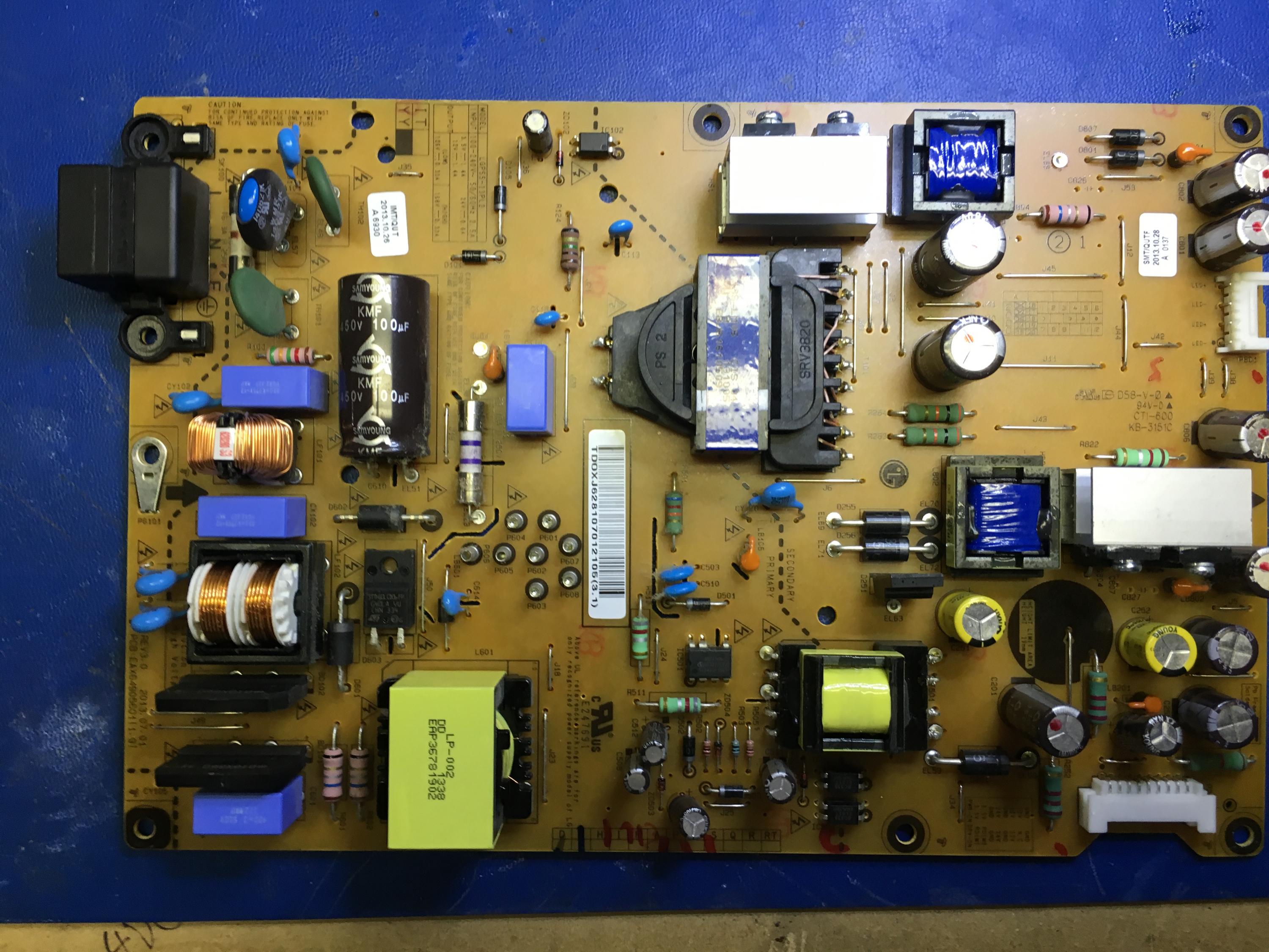

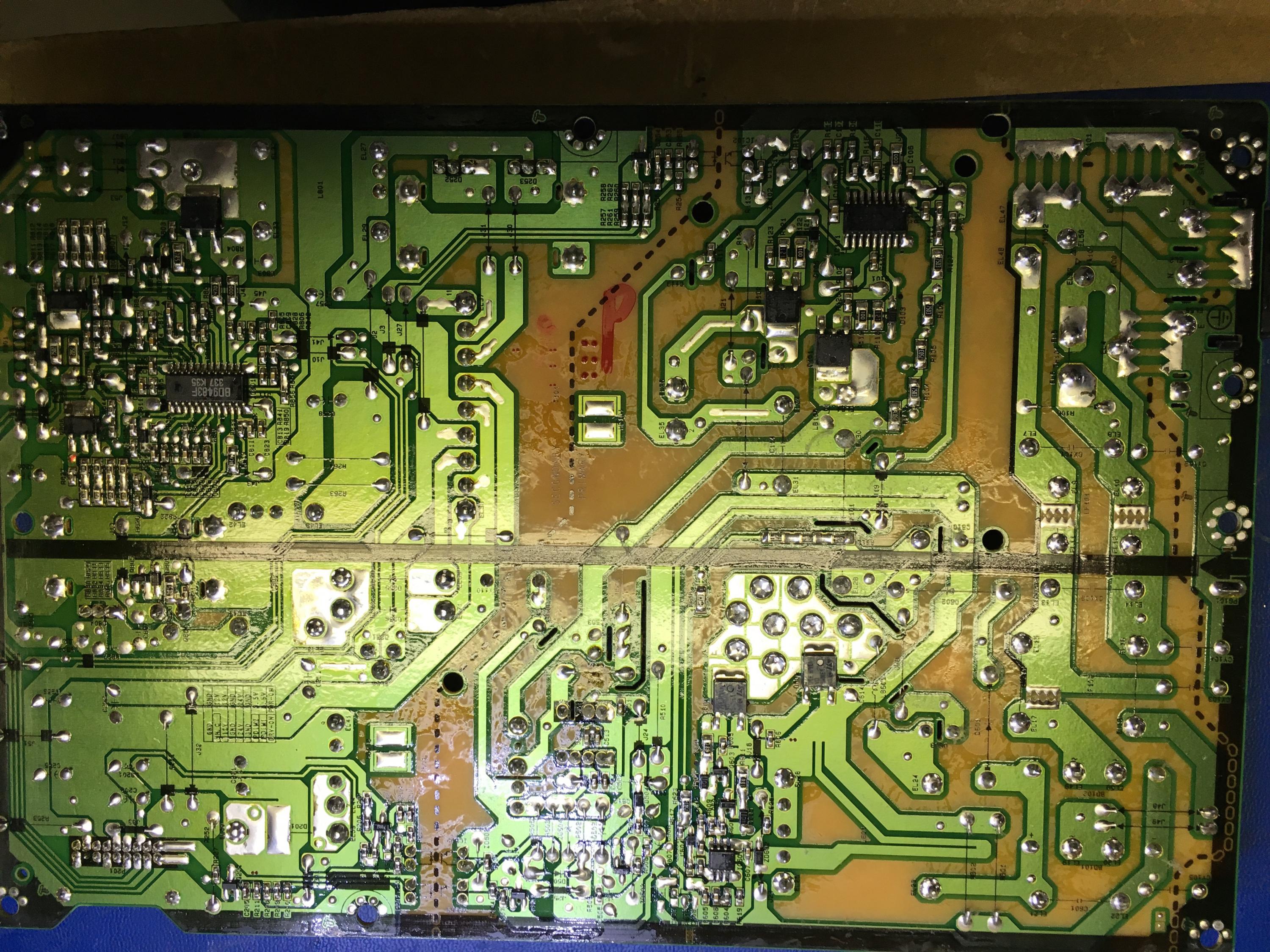

                    Re: LG 55LN5310 dead
                    Here are pics of the power supply.

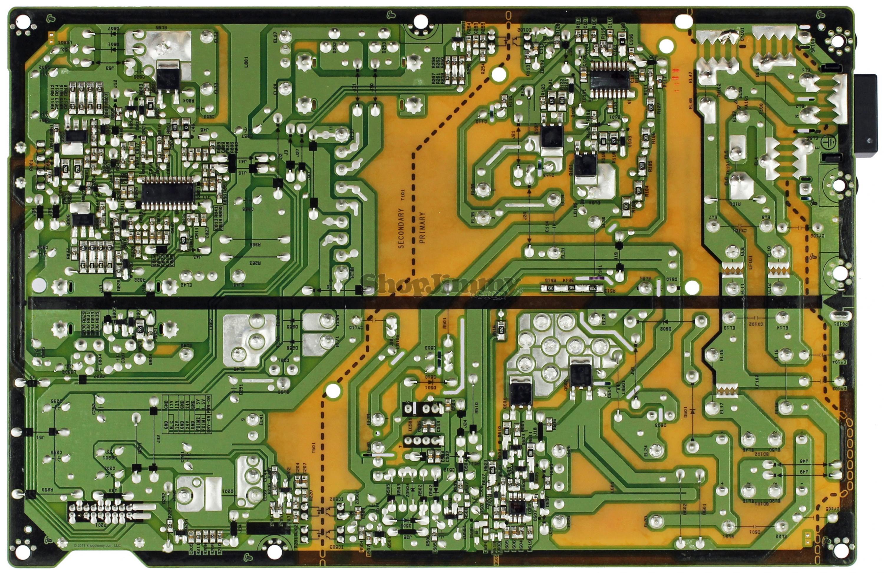

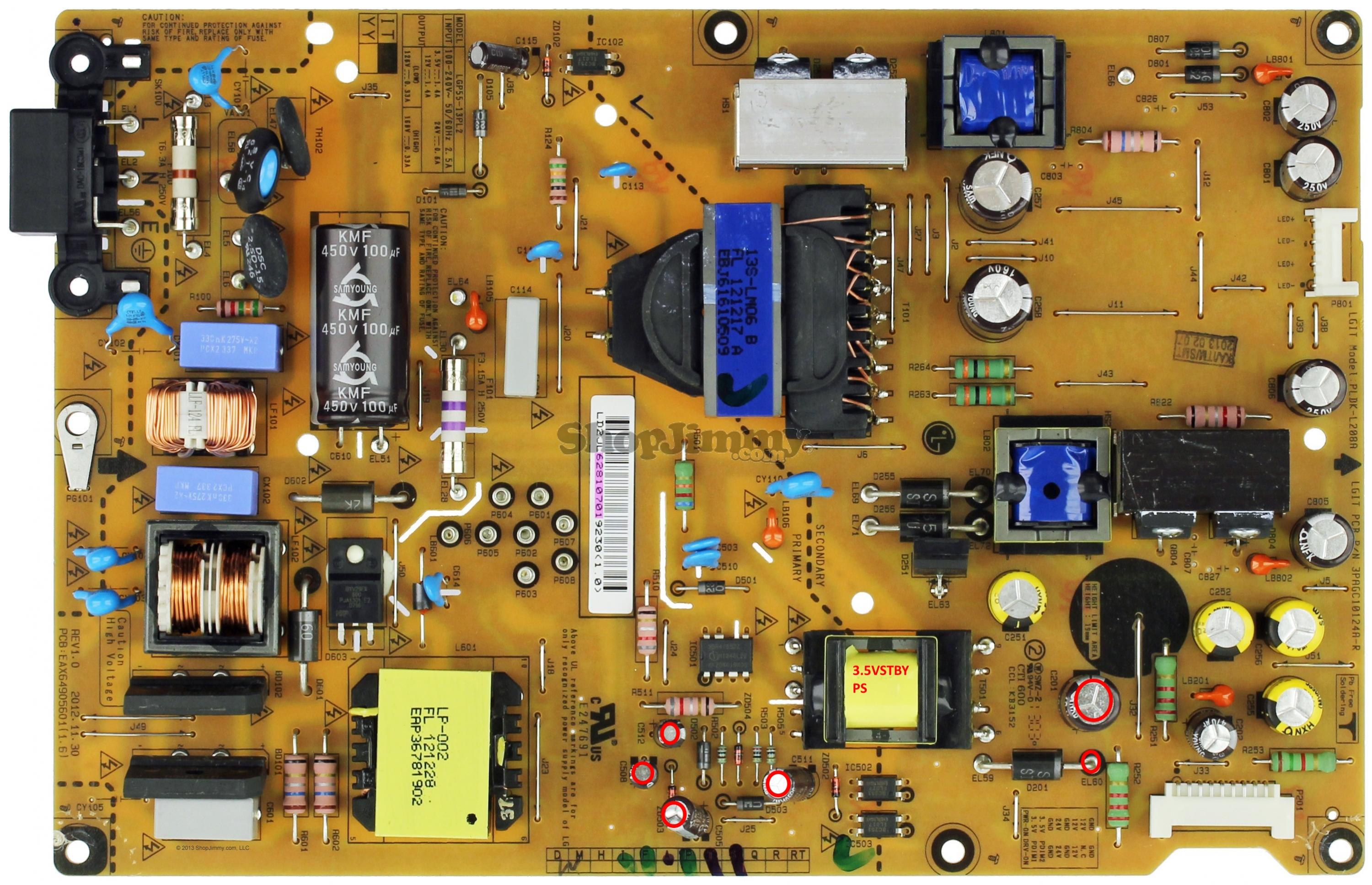

                      LG EAY62810701 (3PAGC10124A-R) Power Supply / LED Board
                      http://www.shopjimmy.com/lg-eay62810...upply-unit.htm
                      So this the board, right?
                      Pictures provided by shopjimmy.
                          So the 3.5VSTBY is not stable at this point, right? The transformer T501 that generates the 3.5VSTBY also generates the dc (AUX winding of T501) through the switched (Q501) Voltage to provided VCC for running PFC Controller IC and the other SMPS IC.
                          You already inspect the board real close for any bad solder joints?
                          You can try heating up those small caps in the primary side by the 3.5V stby IC to see if the 3.5V will be steady and the PFC Voltage will be steady, see post 11.
