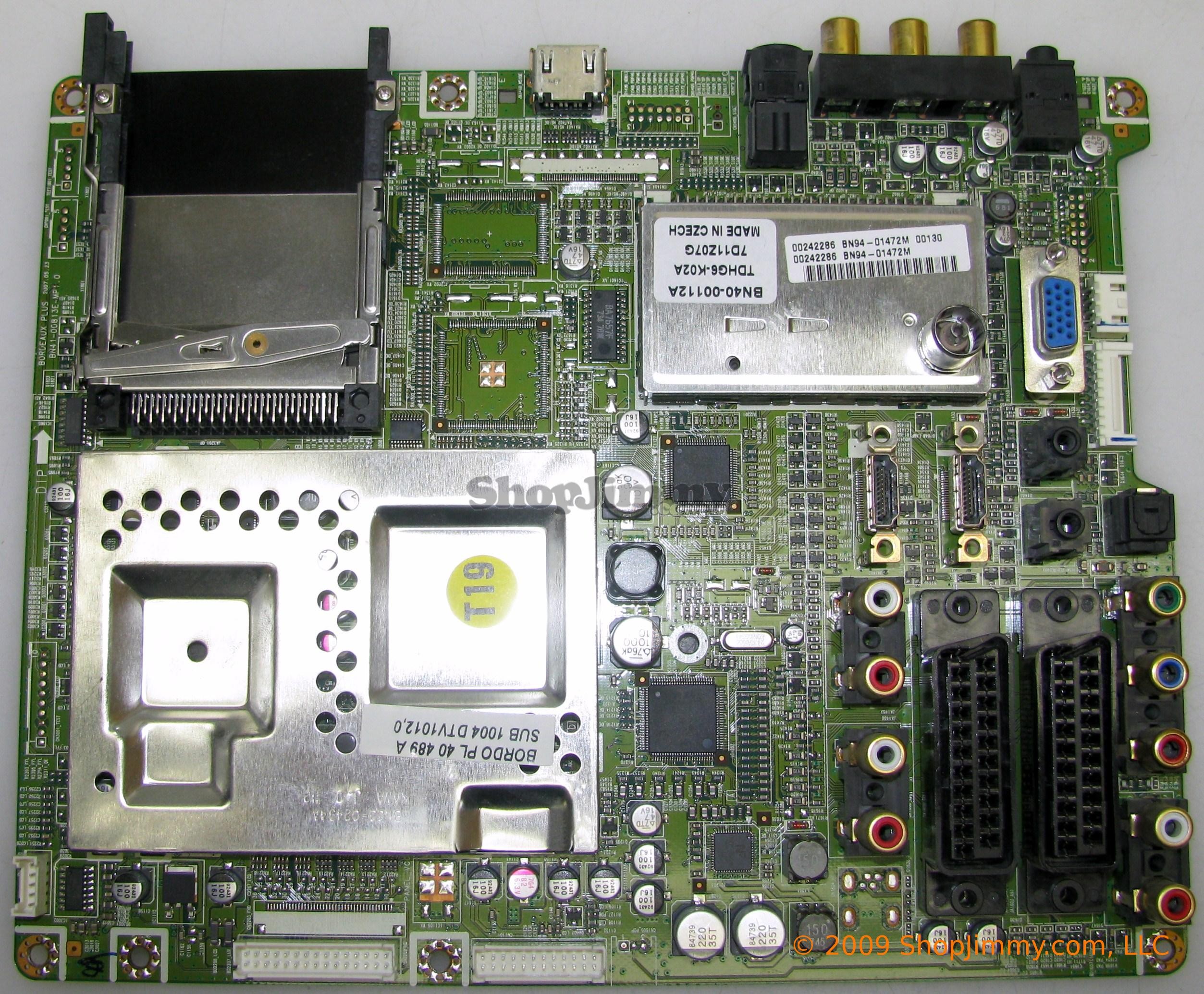

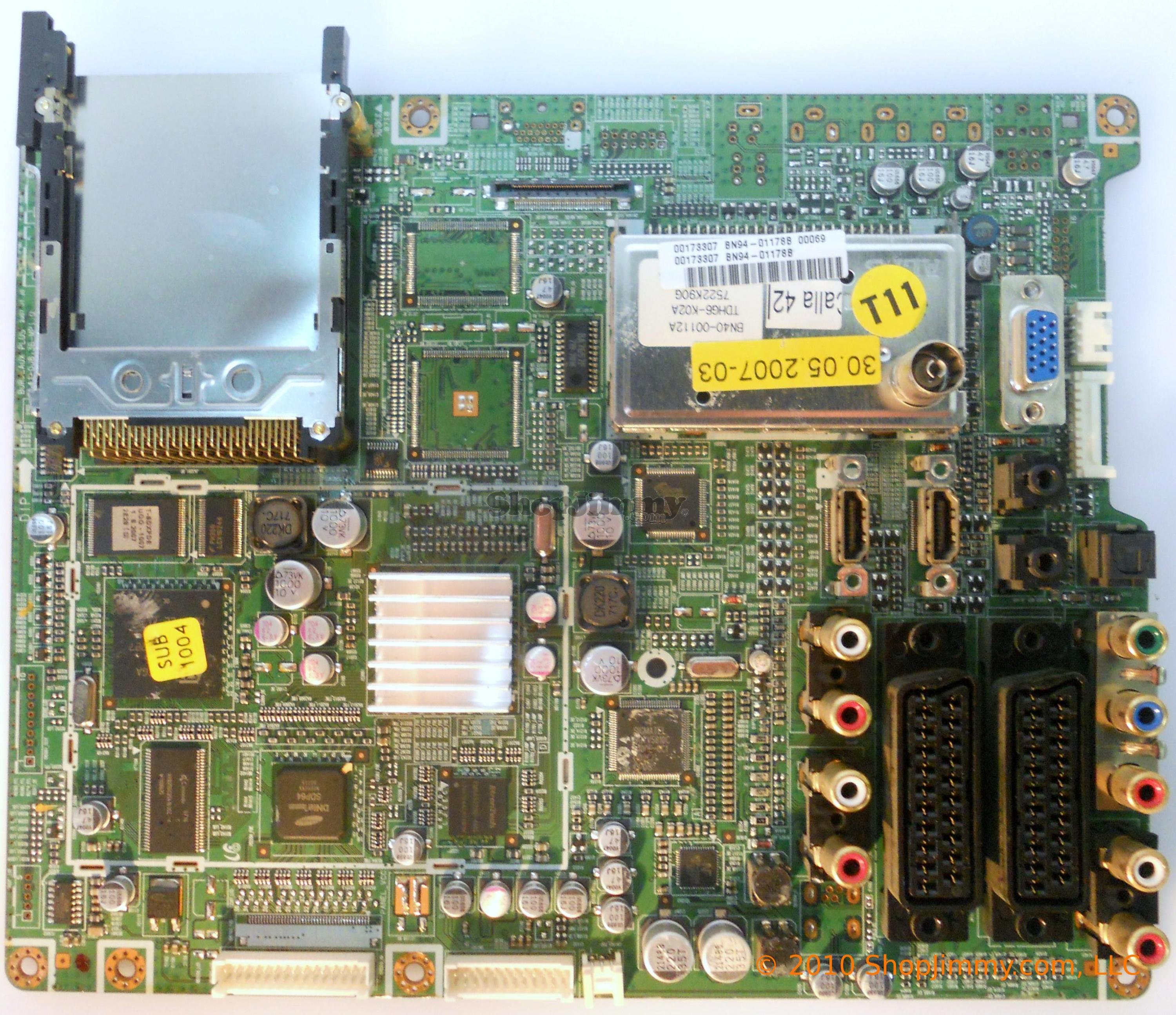

    Post the part number of the board BN94-
    also if you could post a picture of the board that would also help us.

      Samsung BN94-01178B (BN41-00813B) Main Board.
      Samsung BN94-01121S (BN41-00813D) Main Board.
      Samsung BN94-01472M (BN41-00813E) Main Board.
      Picture provided by shopjimmy.
