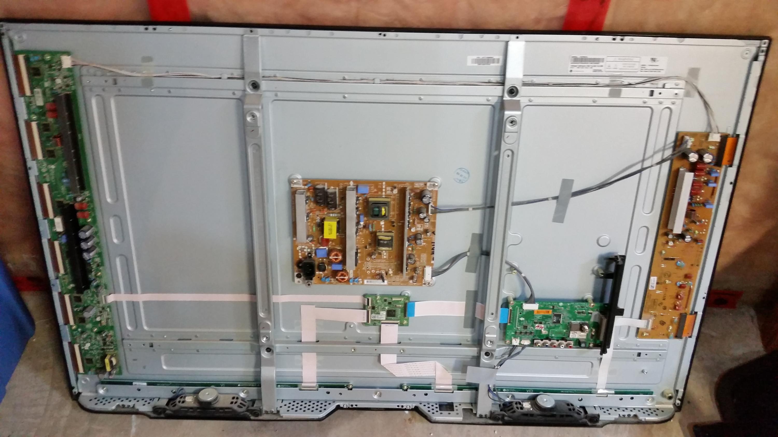

    Don't see anything wrong with any of the boards. The tv is very clean and has had very minimal use.
    looking for some guidance or if someone has had the same problem with this particular tv.
    pics of all boards attached.
    I have a multimeter but I do not know what I should be looking at.

      also need another pic from the whole back side of the TV to see how everything is connected.
      But having backlight and sound, but no picture... sounds awefully like a TCon board. So check it if it has proper voltage on both sides of the fuse(s).

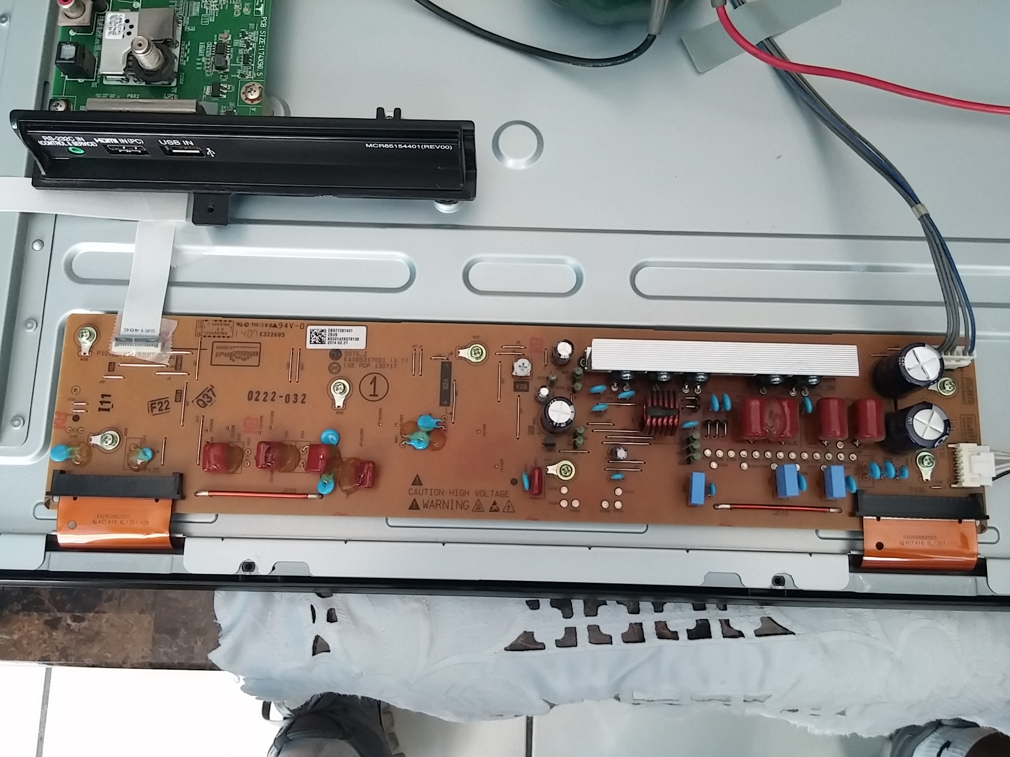

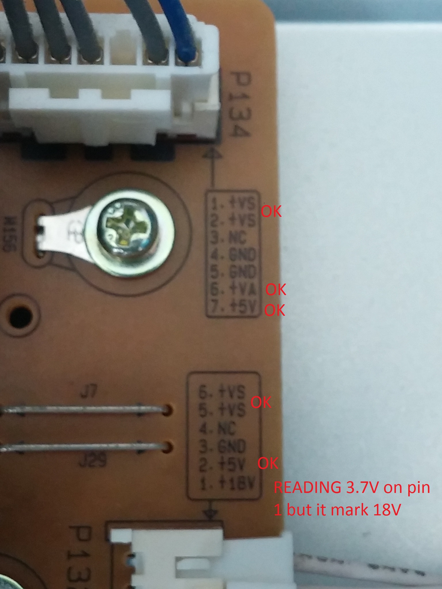

                              I have the same model with sound no display. From the voltage reading i have done i think my problem is the z-sus board. The power supply voltages are good but the z-sus voltage are good except P132 pin 1 only reads 3.7v and it's mark 18V even when I disconnect the y-sus connector it still reads 3.7v
                                Re: LG 50PB560B-UA Sound no video
                                It's probably not your z sus that's at fault. Its the y-sus.

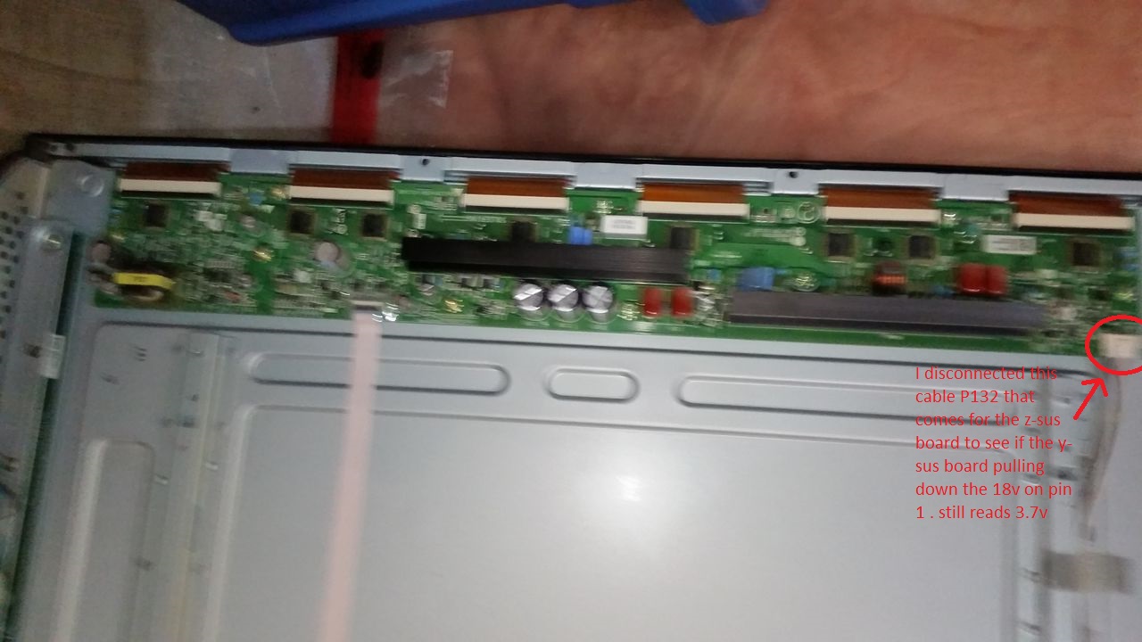

                                  I discounted connection P132 the runs to the y-sus board to see if it is pulling down the 18v on the P132 pin 1 but it still reads 3.7v. Which section of the z-sus board produces this 18v supply?
