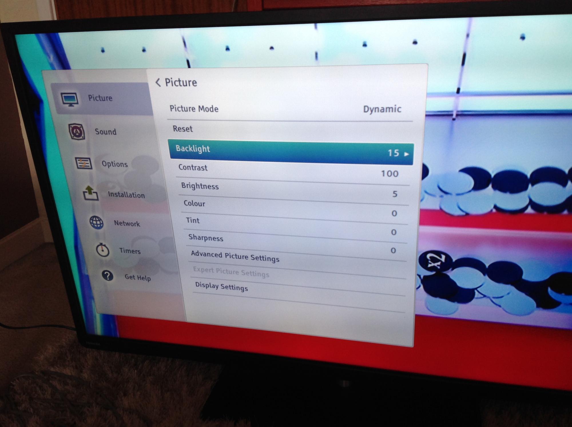

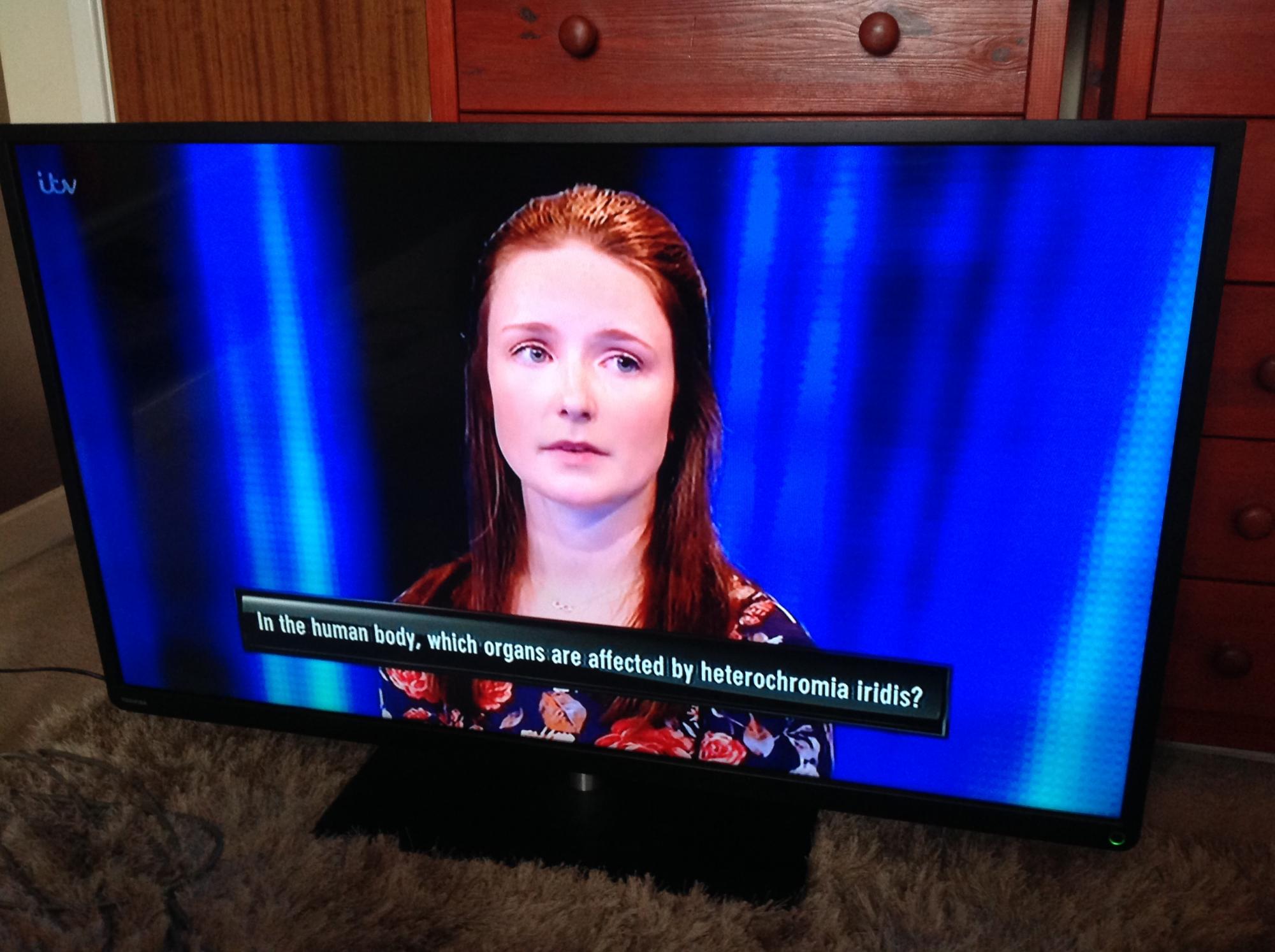

    I have this 50" Toshiba Smart Led Tv here and its not a Vestel ! It would turn on but no backlight. Lcd is working fine and can be seen using a torch. Anyway after diagnosing that the Panel (LC500DUE SF R1) had a bad Led inside it I took it apart.
    After doing a bit of testing on the Led strips, I was able to find that this set had 5 bad Leds in total all in different parts of the Led backlight ! There was 4 O/C and 1 that was S/C really odd to me as normally only one needs to pop and they will all go, so I dont know how it ran with this many bad ones because I know they didn't all fail at once.
    Anyway I did the stacking method for repair and used thermal plaster to mount the new stacked Leds, now the set works fine as you can see in the image:

    After repairing any Led backlight I always set the brightness to the lowest I personally feel it can go before the Tv just looks crap. I set it to 15 it orginally was at 100 which is why the Leds burnt up so fast. Anyway working good now and it actually sold before I had repaired it lol
