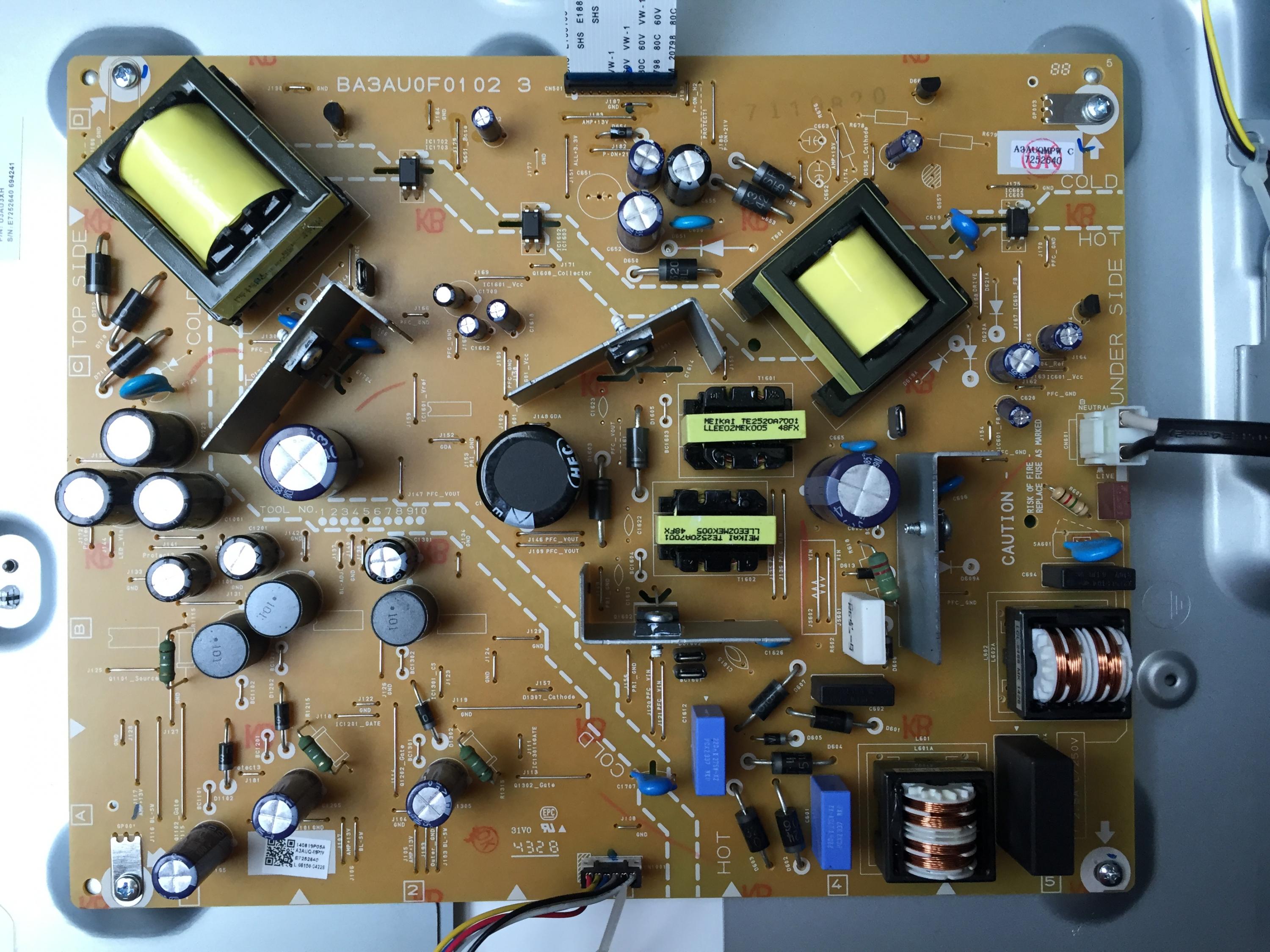

    Emerson LF501EM5F shuts down right after turning on.
    I just bought this tv for $25. Owner was watching tv last Sunday and it turned of. When he turned it on he quickly sees the "emerson" flash on the screen along with this, see picture, then it shuts off.
    Which happens with me also.

          Re: Emerson LF501EM5F shuts down right after turning on.
          Here are the pictures.
          I unplugged the led leads from the psu same cycling. With a flashlight I could see it doing the same thing.
          I disconnected the main board same thing minus the writing on the screen.
          Does that help?
                  Just the power supply board by itself, what DCV do you get at the STBY 3.3V (the test point is on the jumper J151 (ALL 3.3V) close to the black connector CN501 to see if the 3.3V is steady.
                  Did you also test all those black diodes? I.E. D650 and the rest that have the same big body
                      I was told about an hour ago that to test any components on a board that they need to be taken off the board.
                        You can do the quick DCV test first.
                        As for component testing I.E. you can test them on board first and see if it shows bad reading then you can lift one leg off the board and then test it again.
                          I get 3.277 on j151.
                            The board is still mounted to the chassis? Black probe on the chassis?
                            OK, you do have Voltage, not 0V as you reported earlier.
                            • Malachi
                              • Dec 2015
                              • 1077
                              • Usa
                              With my meter on diode mode I get a beep on D607.
                              But testing it the third time it doesn't beep anymore. Same with others.
                                OK, so you do have Voltage. Is it steady?
                                How about the DCV on jumper J182 (P-ON+21V)
                                J183 (AMP+13V)
                                  You are not testing them with TV is still plugged into the outlet, right?
