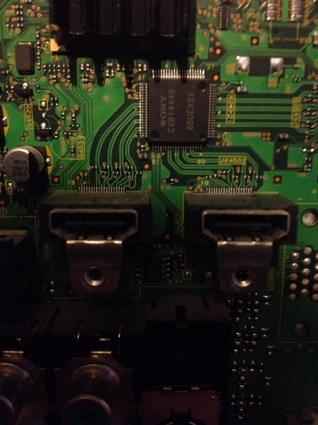

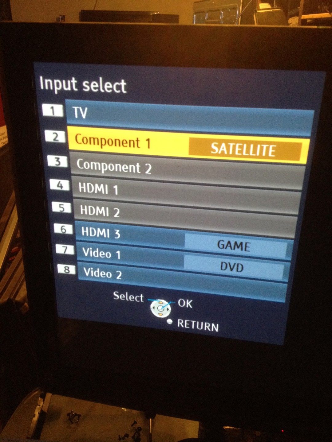

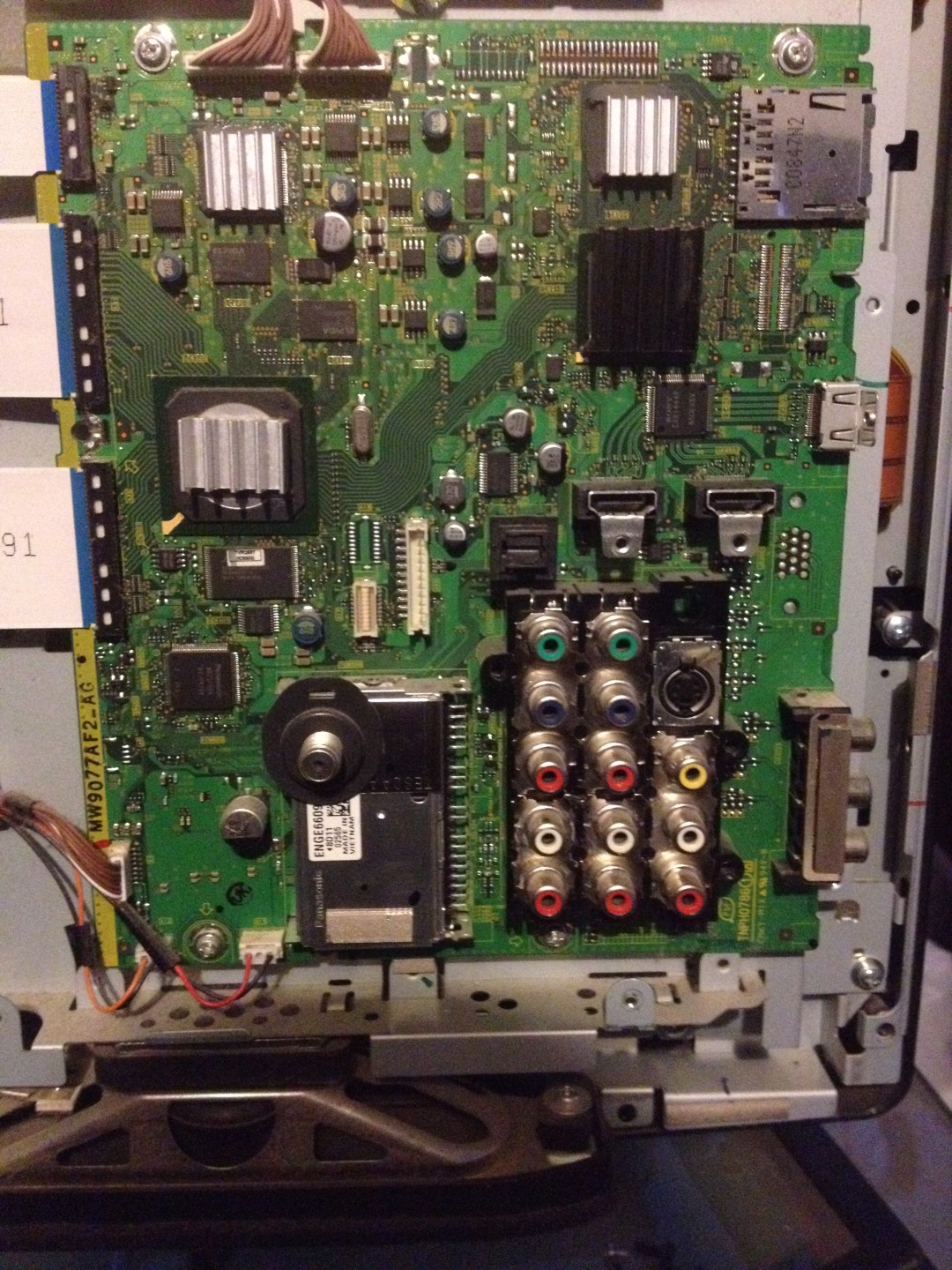

    Hello all,
    TV came in dead.7 blinks. Ysus board TNPA4829 AC was shorted.
    I replaced:Q401,Q421,Q422,Q661 and D685 to repair board.
    TV works great,it's test running atm.
    BUT,see pic#1,out of the 3 HDMI ports only port 3 works,menu had port 1 and 2 greyed out togetherer with component#2
    Question I have: Is this software related or did the HDMI chip fail,and how about the component#2?
