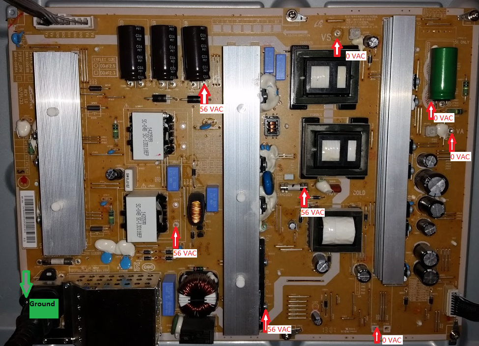

    It seems like it is the power board. I have a basic understanding of electronics and if I had a schematic I could test various components but not sure what all to test with just this board.
    I edited the picture to show which few pieces I tested using the ground screw in the bottom right.
    Tested the first fuse to make sure that wasn't blown. The 2nd fuse confuses me. It is 77 VDC on one end and -80 VDC on the other from the ground peg.
    Across the 2 points is -162 VDC
    The VA and VS both are at 0 VDC. Pretty sure I saw it at 10VDC one time, could have been from a CAP discharging.
    Any help on what I could test next would be helpful. Thank you very much.

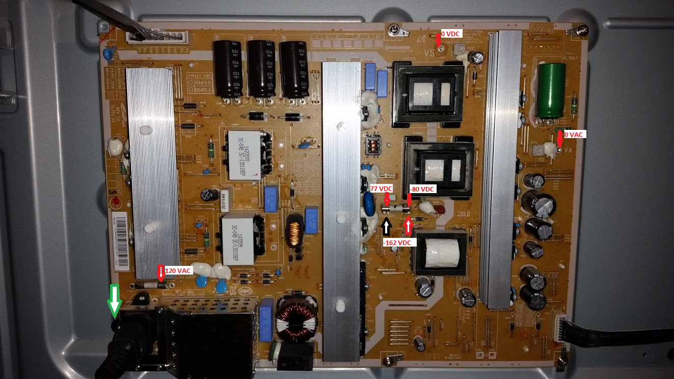

    Well I I just realized I should have been using AC across most.
    So I updated the pic with new readings. Can't edit current post.

      your power supply more than likely is fine, it sounds like you may have a bad main board however. What voltages do you get out of the VS and VA lines going to the sustain boards? I assume you are not getting anything since the screen is black, but if you are please let us know what those numbers are. If nothing, disconnect both sustain boards from the power supply and check again. If still nothing let us know and I will let you know how to isolate the power supply to test it.

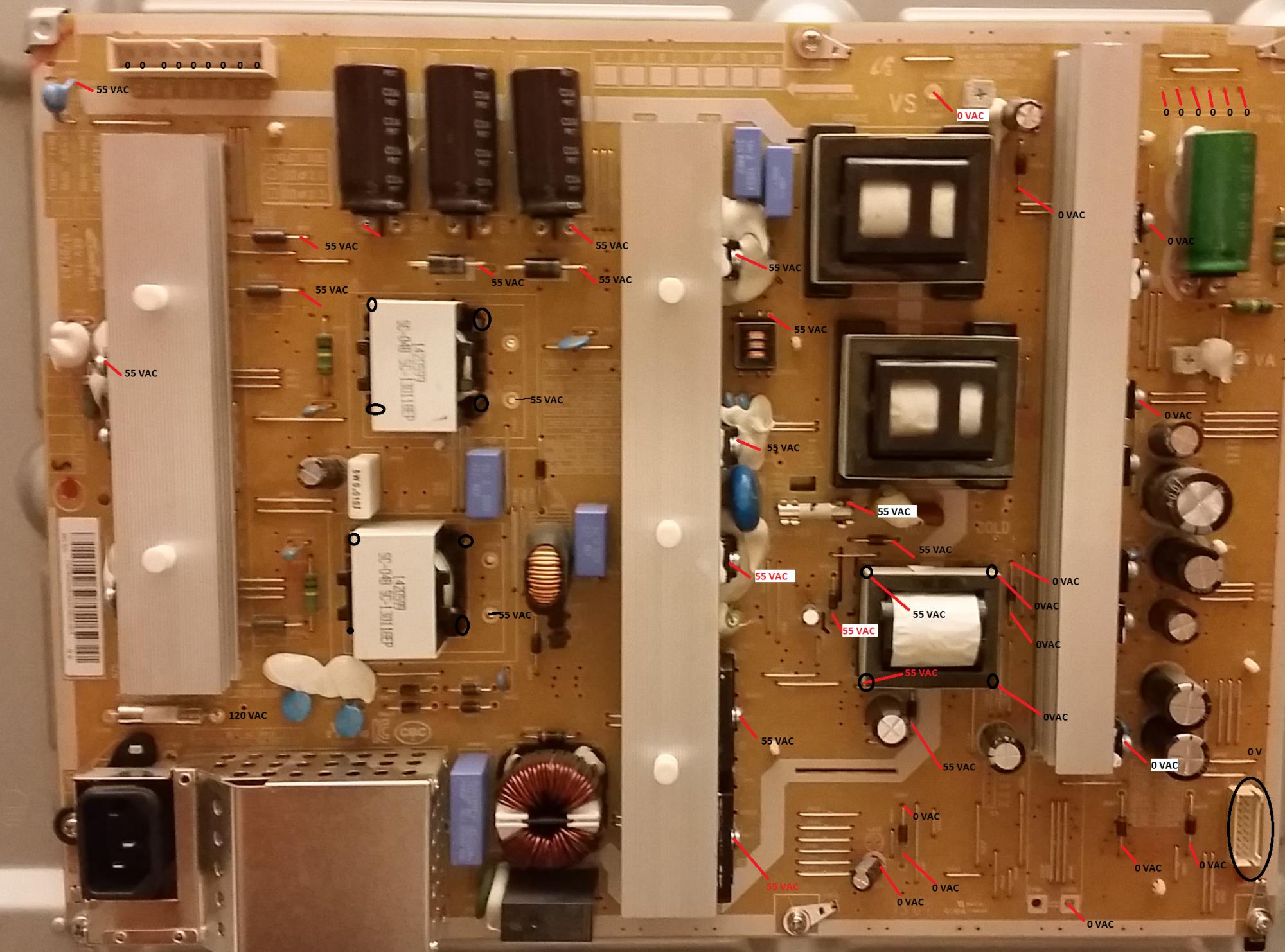

                  I may have narrowed it down to the bottom right transformer. Not quite sure how to test it. The left 2 have 56 V on all 4 points. The bottom right only have 56 on the left 2 and 0 on the right 2. The 2 above them have plastic covering so I cannot test.
                  There are voltages on the 2 diodes next to it on the left and bottom but diode to the right is 0. I checked all transistors on the left and middle which are supplying power.
                  I did look at the back of the board the other day and could not see any bad joints.
                  Should I be testing most of this in AC or DC? Because if so all voltages on the left side of the board reading 55 VAC is 77 VDC and all the voltages on the right side of the board are reading -80 VAC. The fuse in the middle has the different voltages on each side.
                  The board part number is BN44-00618A
                  It's a big picture you can zoom in since I had to squeeze the readings in. Thanks a lot of your help.

                    Check these QS802 QS804. Are those transistors shorted?

                      Have you given the readings found at the connectors as DC? Everything looks marked up as "AC" or "0". With your black lead on chassis and using the red lead, read the connector voltages with your meter set to DC.

                          I wasn't sure at which point I should be testing DC or AC. But the first post at the top was mostly all DC voltage checks.
                          Any pin listed 0 on the board I checked both AC and DC. Only different is if I do DC most of the 55 VAC is either 77 VDC or -80 VDC.
