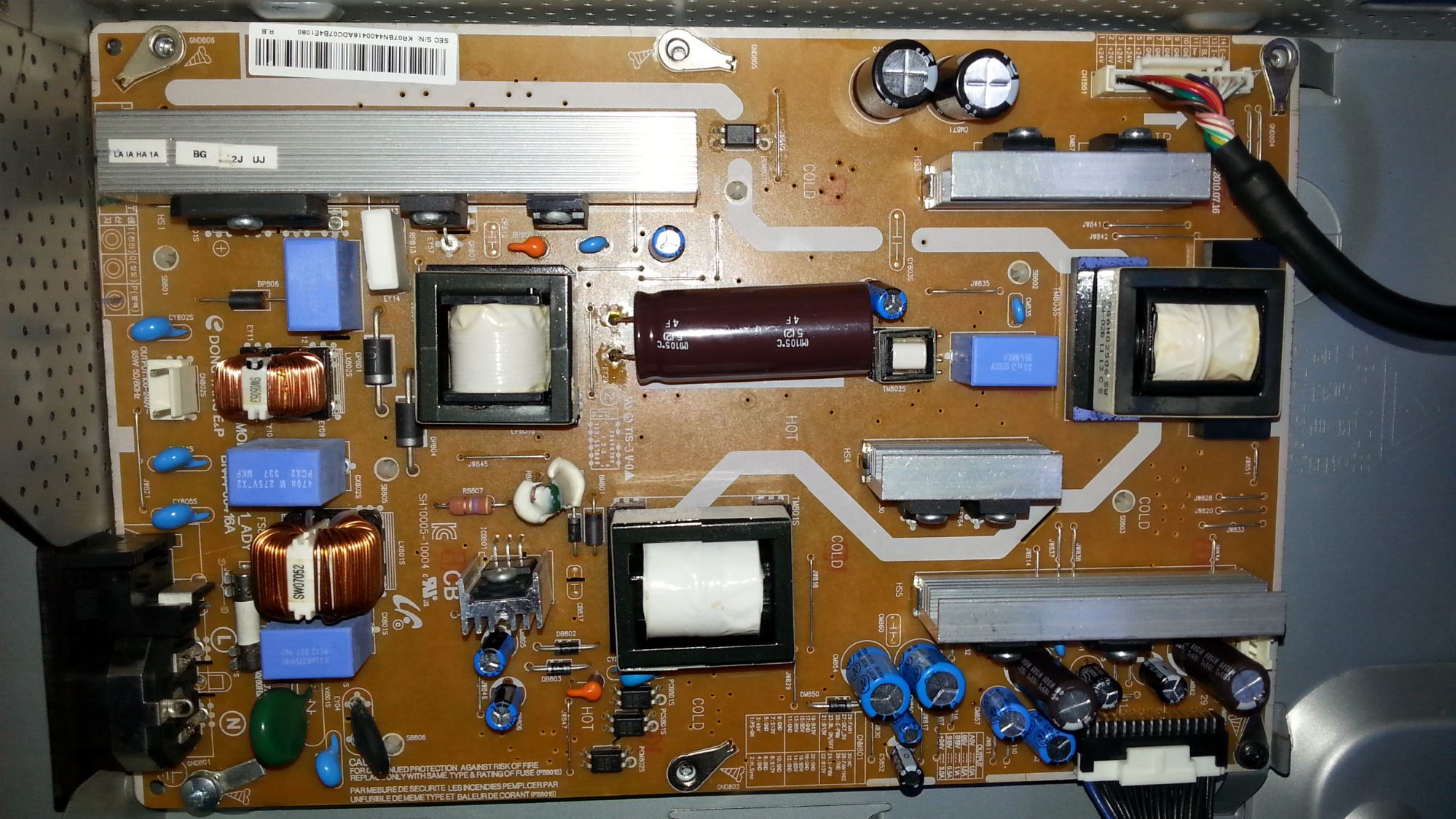

    I have a Samsung 320MP-3 (LH32HBPLBC/ZA) that the power keeps cycling on and off on. When I plug it in, the light turns green and what seems to be a perfect picture displays. After about 3 seconds, it shuts off and the standby light blinks about 3 times and then tries to turn back on again, repeating the process. I have already replaced the caps on the inverter board and power board and saw absolutely no change in the TV's functionality. Does anyone know what else could be wrong with this TV?

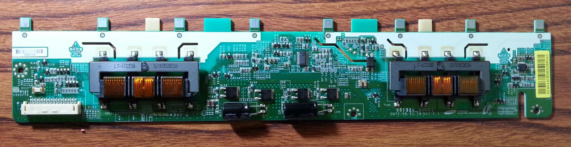

    Ok finally. Here's some pics of the LCD.

              BTW, the two legs of the big brown main filter cap laying on its side looks like it has some kind of brown corrosion on them?

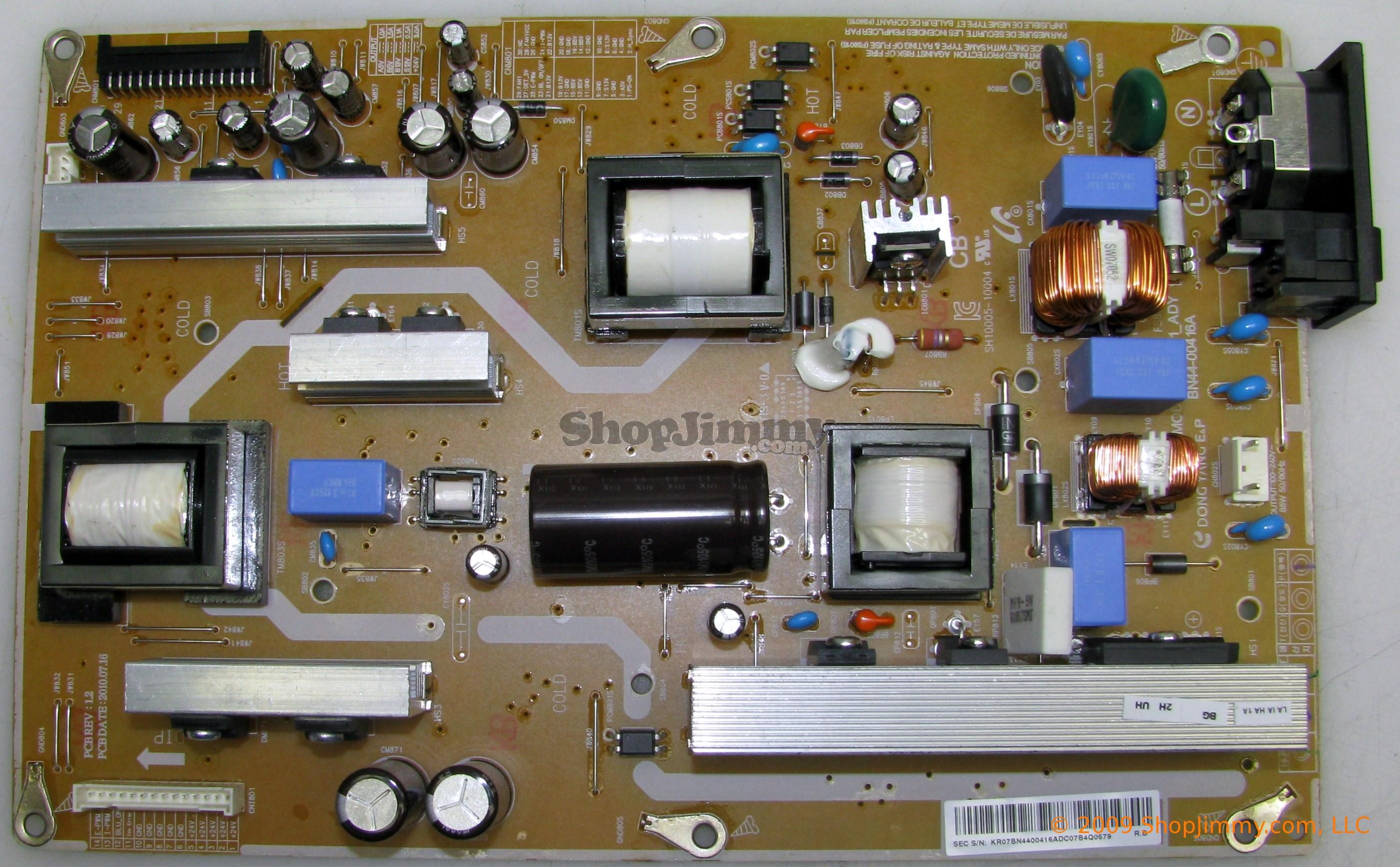

              Some one try to fix this board or other boards before? because the cap is bigger (longer) than the original one compared to the one from shopjimmy, other caps also look like they were replaced.
              What is the history on this unit?

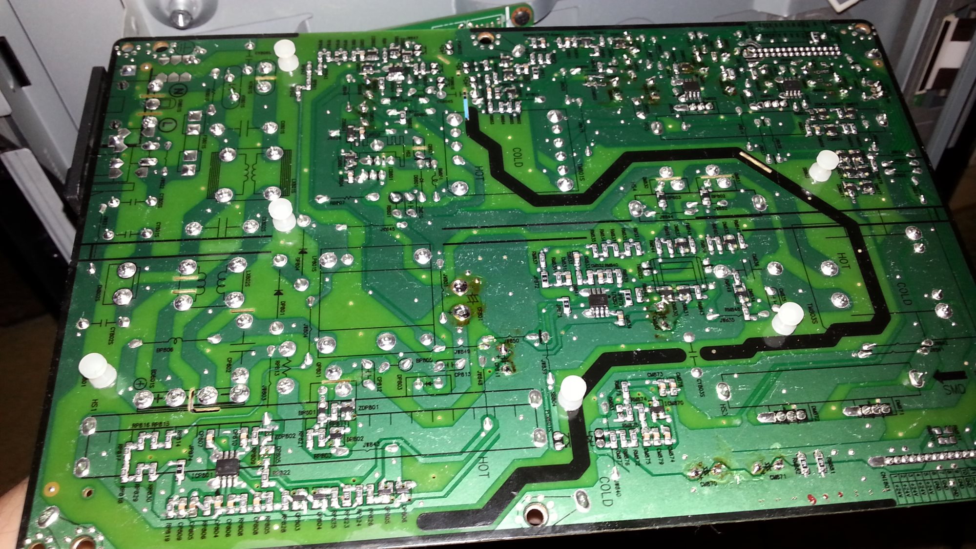

              Please also upload the pictures of the bottom side of the power supply board.
              Power supply board: Samsung BN44-00416A
              http://www.shopjimmy.com/samsung-bn4...upply-unit.htm
              Picture provided by shopjimmy.

                As I mentioned in the first post, I replaced ALL caps. All of them are correctly installed and have proper values. Some have higher voltage requirements but that's it. Before I replaced all the caps the TV was doing the exact same thing.

                I will upload a pic of the bottom of the board in a little bit.

                  OK, thanks for the clarification, I just do like the stain on the main cap legs which does not look normal to me. Reading post 4 with reading of 3.3V and we thought it is steady but the inverter was going on and off, but that is not the case.
                  So the power is fine since the 24V is steady that is what throw me off. It is the backlights inverter being turning on and off.

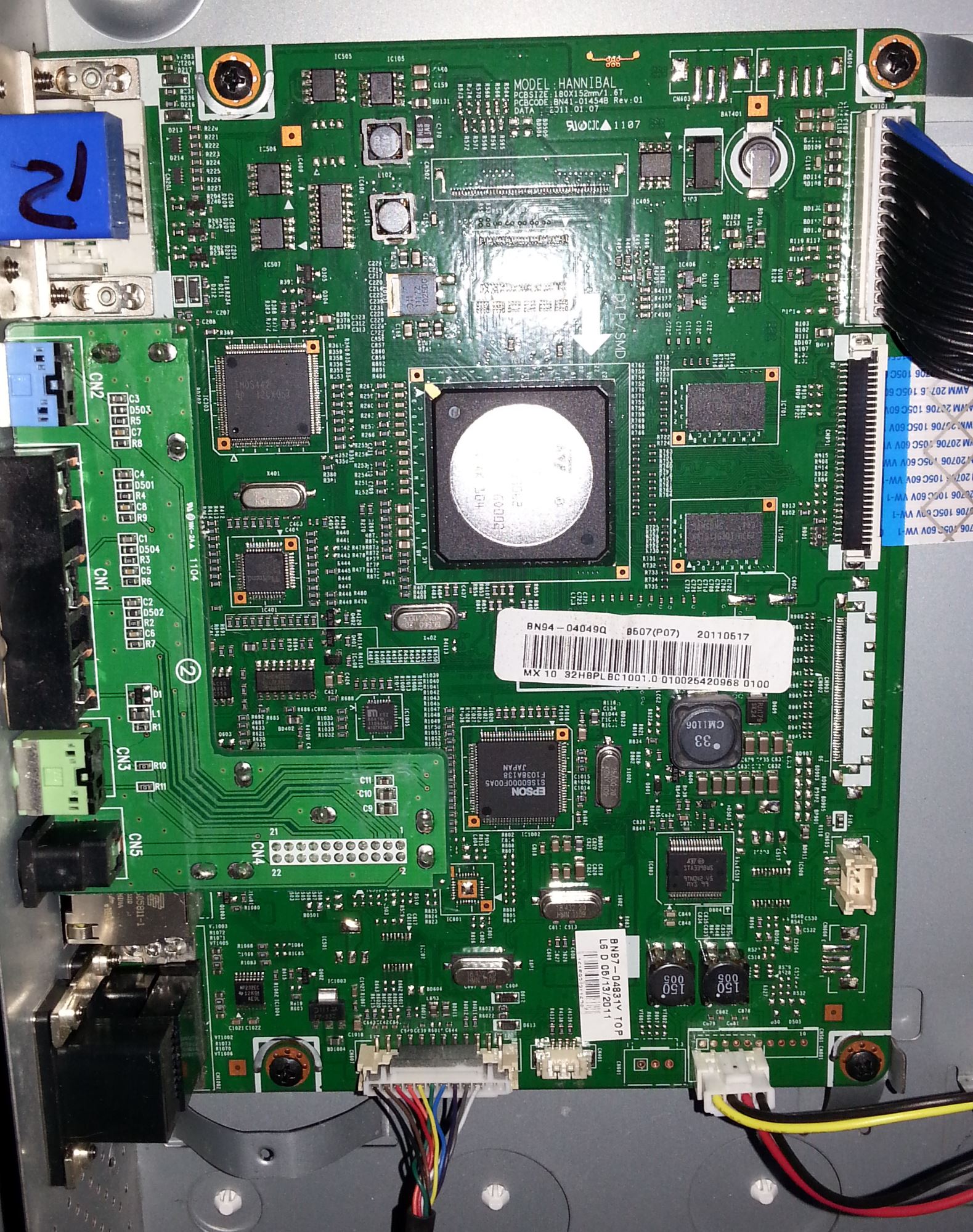

                  The BL-ON is generating by the main board so we need to do now is to find why the BL-ON is cycling.

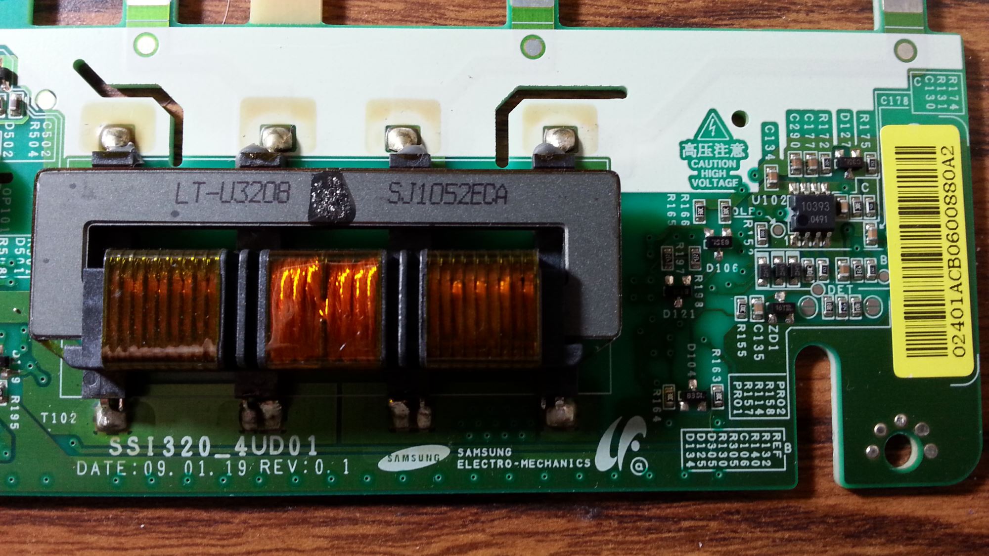

                  Looking at the inverter board, the transformer next to the connector from the power supply, there a chart printed just below the transformer to tell you what each pin of the inverter connector is for, we need to see if there is any feedback pin to feed the main board to tell the condition of the inverter board or not (most of them do not use the error feed back signal).
                  What you can also do is to disconnect just the BL-ON wire ON THE POWER SUPLY SIDE that goes to the inverter board and then use 1K resistor between that BL-ON wire and the STBY 5V to simulate staedy BL-ON signal and see if the inverter will stay on or not.

                    I see what brown spots you're talking about now. That's where I got messy from the flux and the light isn't shining on it. It looks a lot clearer than what it is in the pic. I'll do some more testing per your instructions and report back tomorrow.

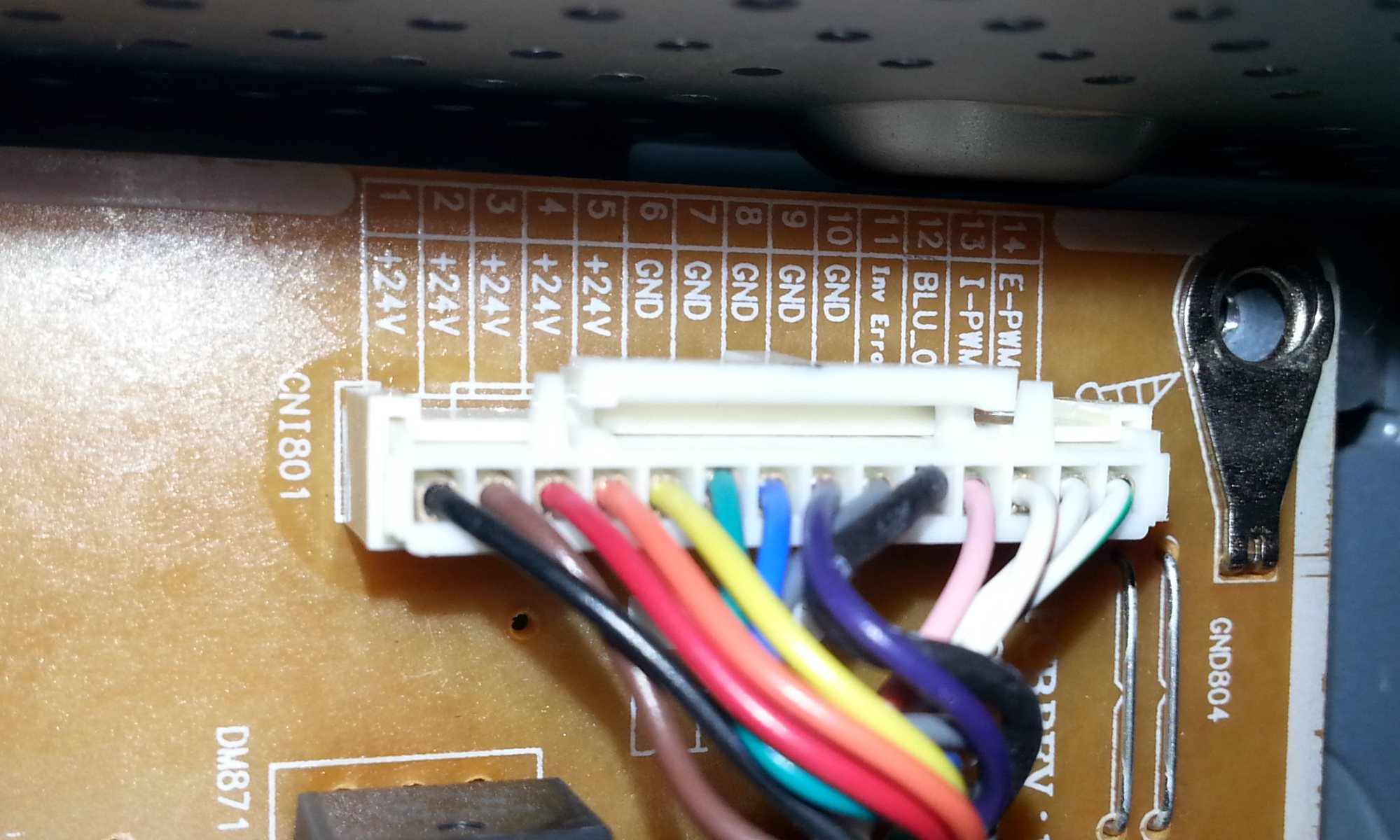

                        I'll be at work for most of the day but until then, I did take a couple of more photos including the bottom of the power board and pinout for the Inverter cable.
                        How would I tell if the error pin is being used or not by the inverter?
                        And yes, it does seem weird that everything seems normal except BL-on cycling on and off.
                          Re: Samsung 320MP-3 Power cycles on and off (already replaced caps on power and inver
                          You need to trace out pin 11 of CNI801 on the power supply board to see if it is routed to the connector that goes to the main board or not.

                            I traced that error pin all the way to the main board where it leads into a couple of resistors right next to the plug. On the main board side of the power board, the pin is labeled DET_5v
