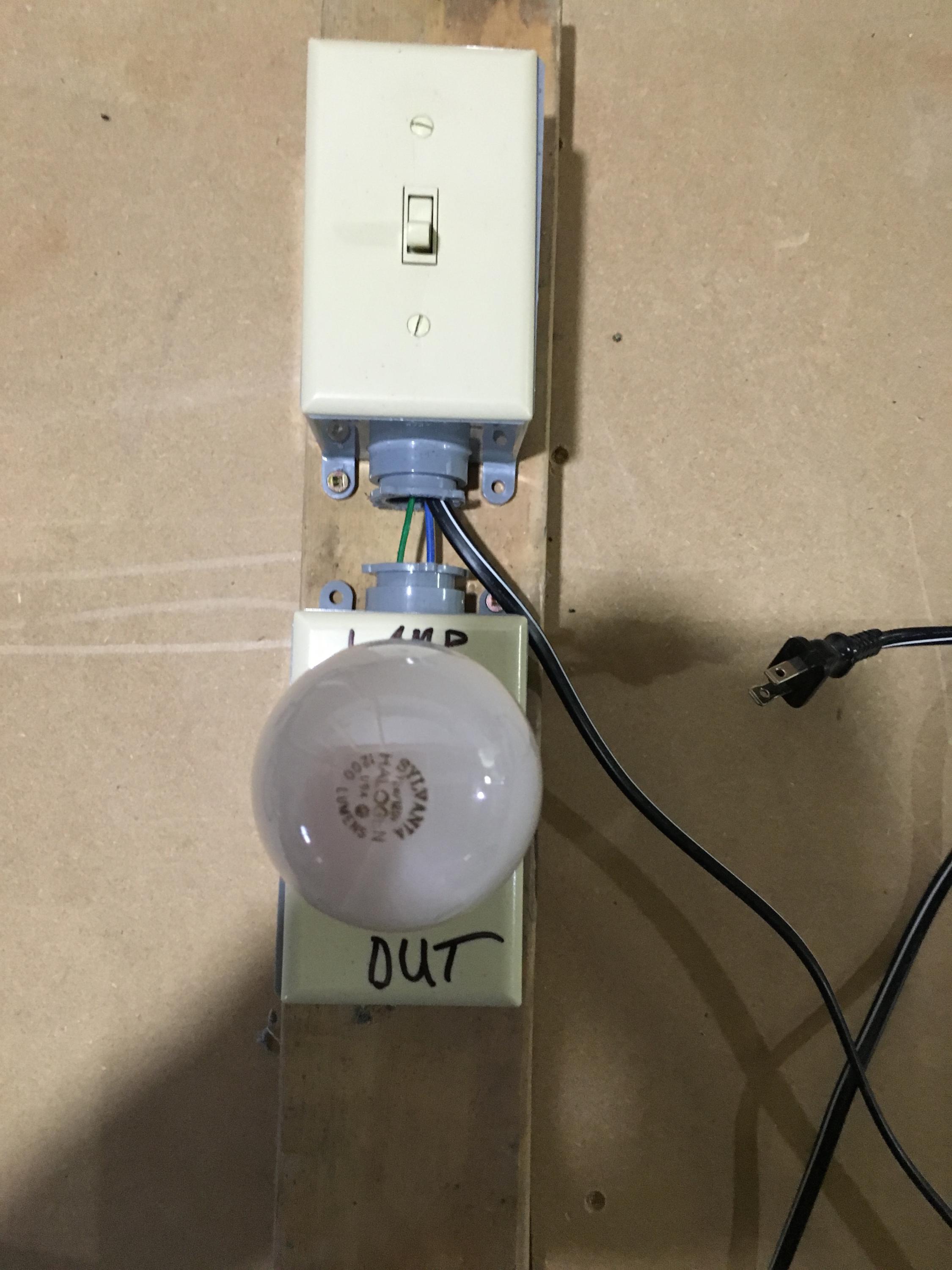

    I found a SPST dim bulb tester on a website. It looks much better then the first one I built. Now I can test older equipment without worrying about frying anything at power up. How many of you use this type of tester?

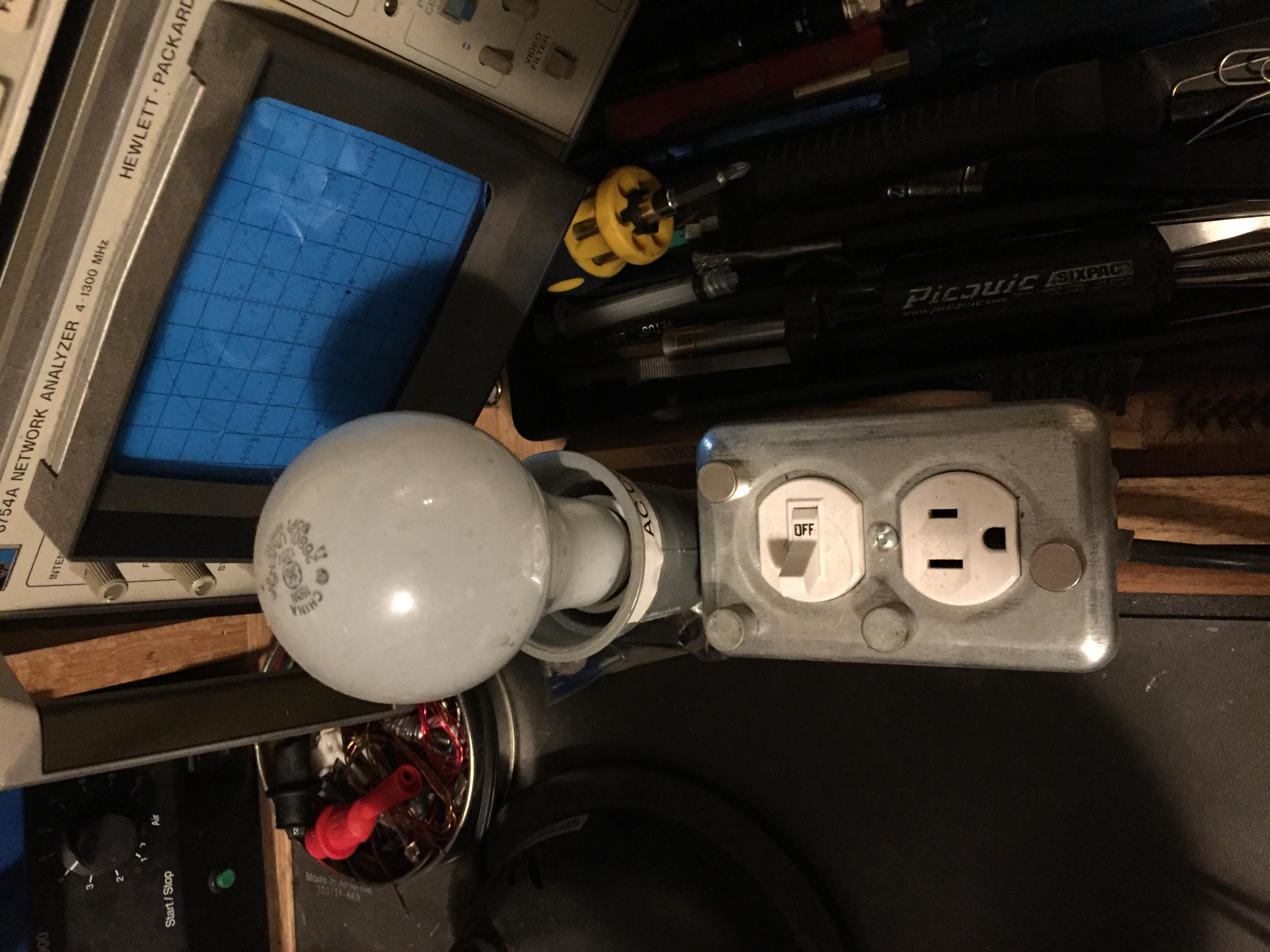

    I do sort of.... Mine has sockets for plugs instead of light bulbs.... It also has a ballast bypass and ground lift switch. Its also rated for 20 amps...... It's not always used to protect the load, but to protect the wiring in the walls when the load burns up

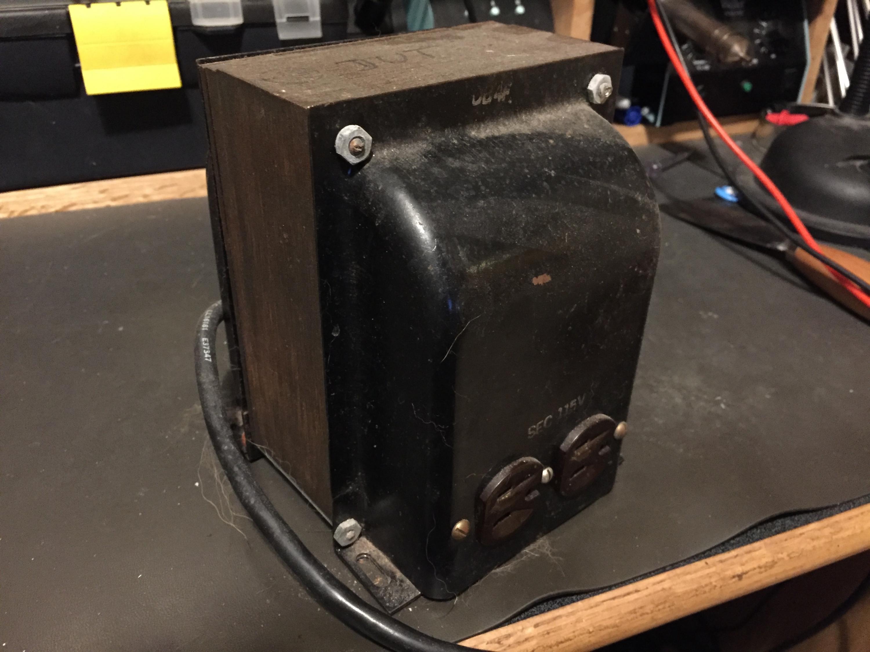

        I need an isolation transformer. Any places that sell these or what parts do I need to build one. Also, I can add a variac to slowly increase AC to see any current meter reactions.

            Here is my dim bulb tester and my isolation transformer.
