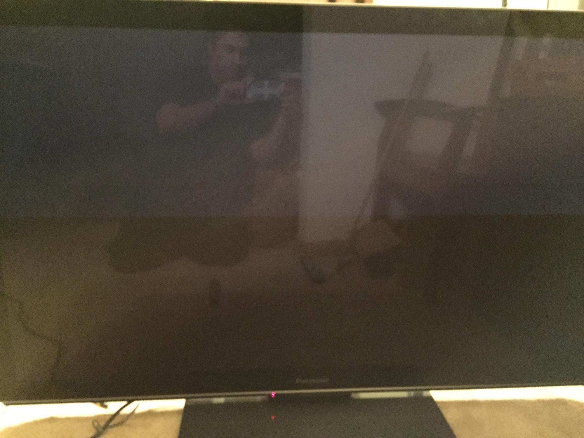

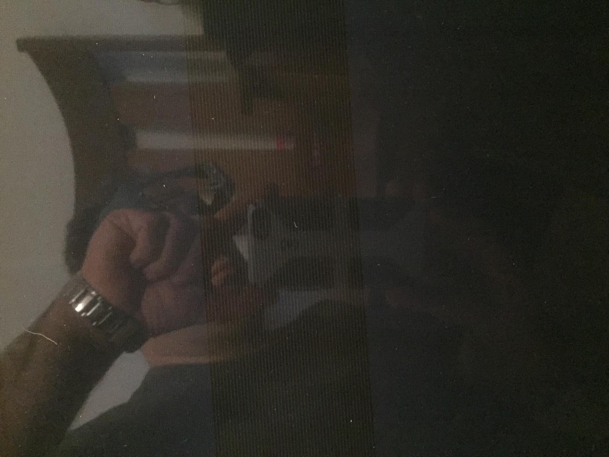

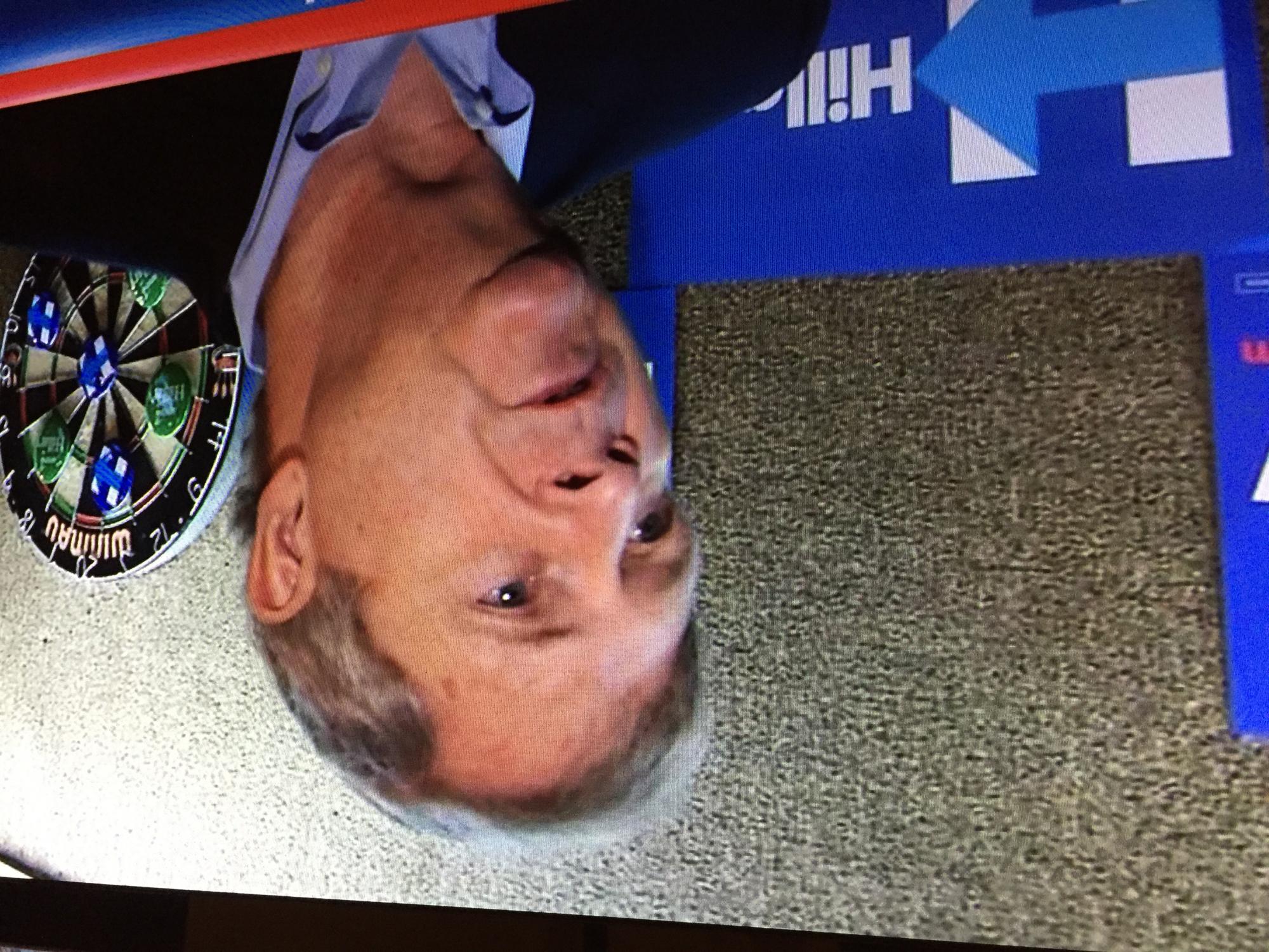

      Re: Panasonic tc-p55gt30
      I installed the sc board. Hooked everything up. No blinking led. The tv powers on, led solid red but nothing really on the screen except for black and a darker black horizontal bar.
      Not sure if it can be seen in the pictures. The picture is rotated 90 degrees.
      Maybe the 2 buffer boards are bad?

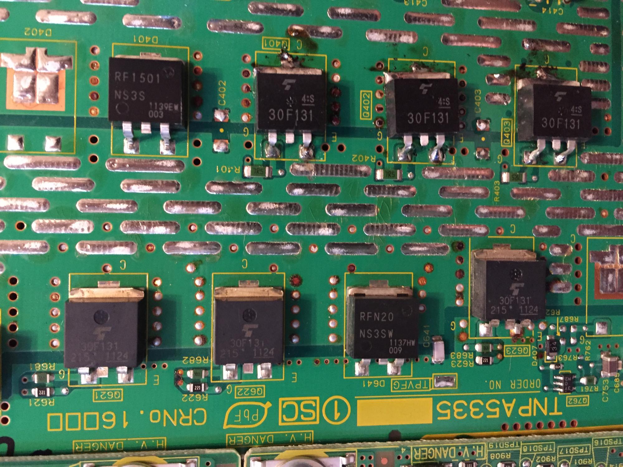

          What are these black components is this picture?
          When I test these with my meter in diode mode, the ones they replaced don't beep but some of the others do.
            Don't put these boards in other tv's that are already "bad". It can kill the new repaired boards.
            The ones that beep probably have "D" in front of it. For example D401.
            The black bars are probably badly seated ribbon cables. Look at my thread and check the pictures.
            The led has to be green? Try and turn it on with the remote , hold the power button on the remote for a few seconds....

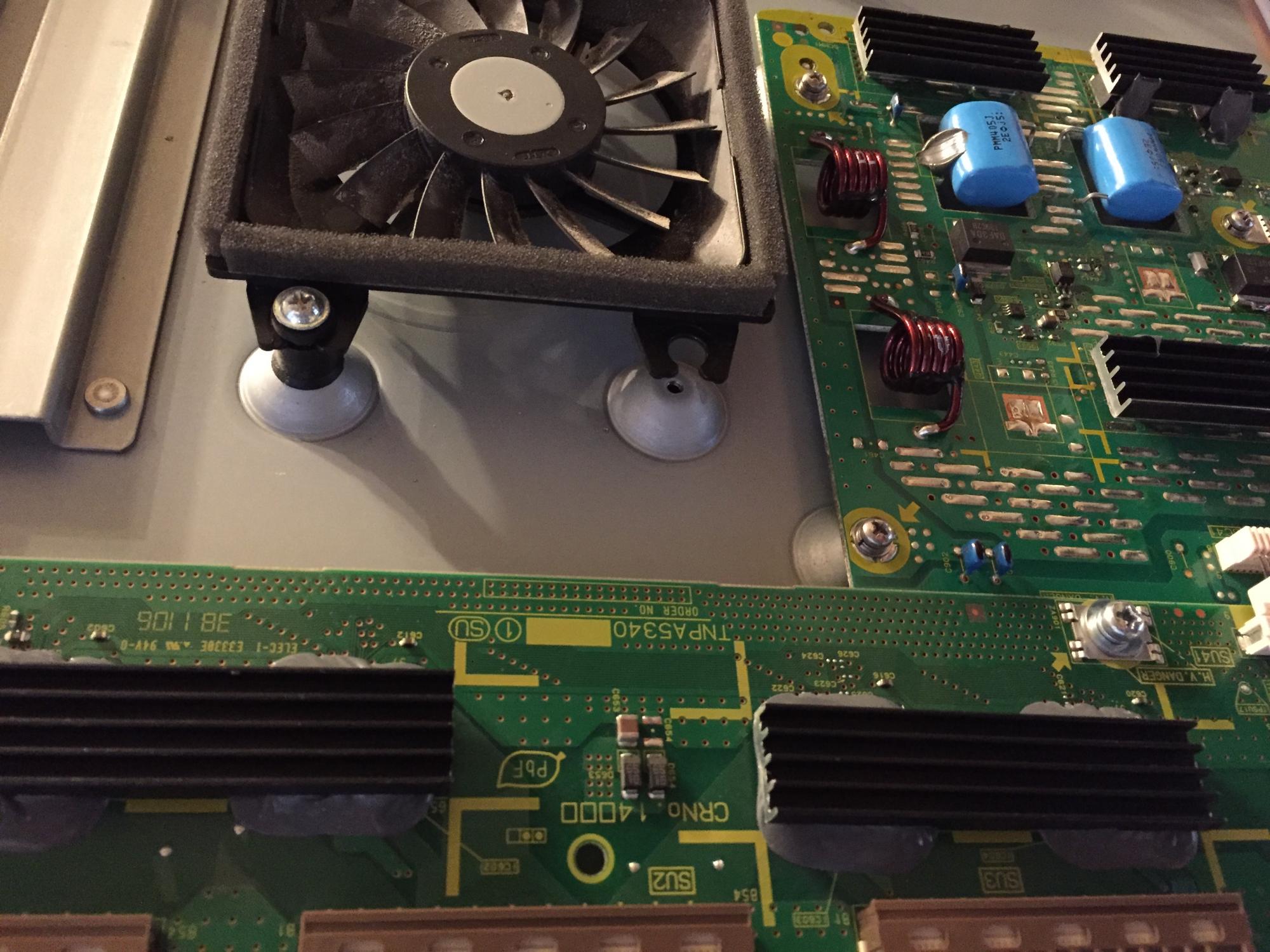

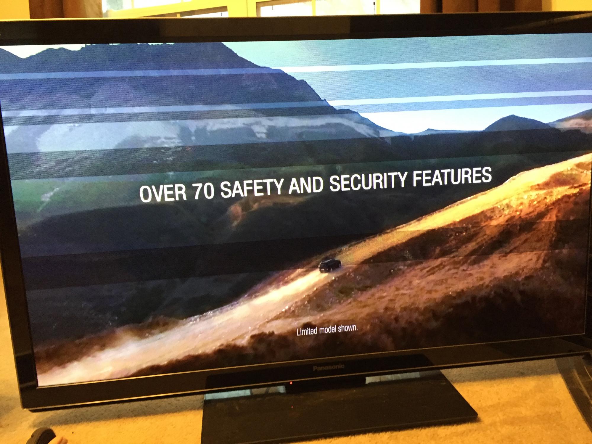

              Made some progress with the tc-p55gt30 with the AC board in.
              Nothing with the tc-p55vt30. No blinking led.
              Here is a picture of the p55gt30.
              • Malachi
                • Dec 2015
                • 1077
                • Usa
                #127

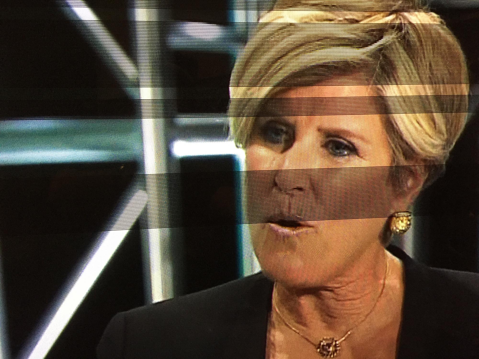

                Maybe a better picture.
                The lines seem to correspond to where the ribbons go into the SU and SD boards. I already reseated the ribbons twice. Maybe faulty SD and SU boards on the p55tg30?
                Doesn't explain the no picture on the p55vt30. I swapped the SS boards and made no difference.
                Does it matter that some of those black components in the picture beep when I check then in diode mode? Some of the same components on both SS boars beep too. Normal?

                  #128
                  Still badly seated ribbon cables!! You need to recheck the ribbon cables on the buffer boards.
                  The black bars match with a ribbon cable , be gentle with it and apply pressure from the middle.

                      #130
                      NO!! Never with tv on. Everything you do do it with the tv off and power plug removed.
                      The black components on the SC board are IGBT's and diode's. The IGBT's are listed on the board starting with "Q".
                      The other ones are diodes , they are listed as "D". ( D401 for example )
                      They work as the tv is displaying a picture! The black bars/lines on the GT model is because the ribbon cable is not lined up perfectly with the board. They need to be reseated.

                        #131
                        tip: Pull the latch as far as you can , remove the ribbon cable and reseat it. Look on both edges , you see there is a small "hook" that has to go into the latch. Try to put it in via the middle section of the ribbon cable...most of the times your hear a "click".

                          #132
                          Holy crap. Thanks Moreno. Got it. You were right.
                          I'm sweating just from reseating ribbons.
