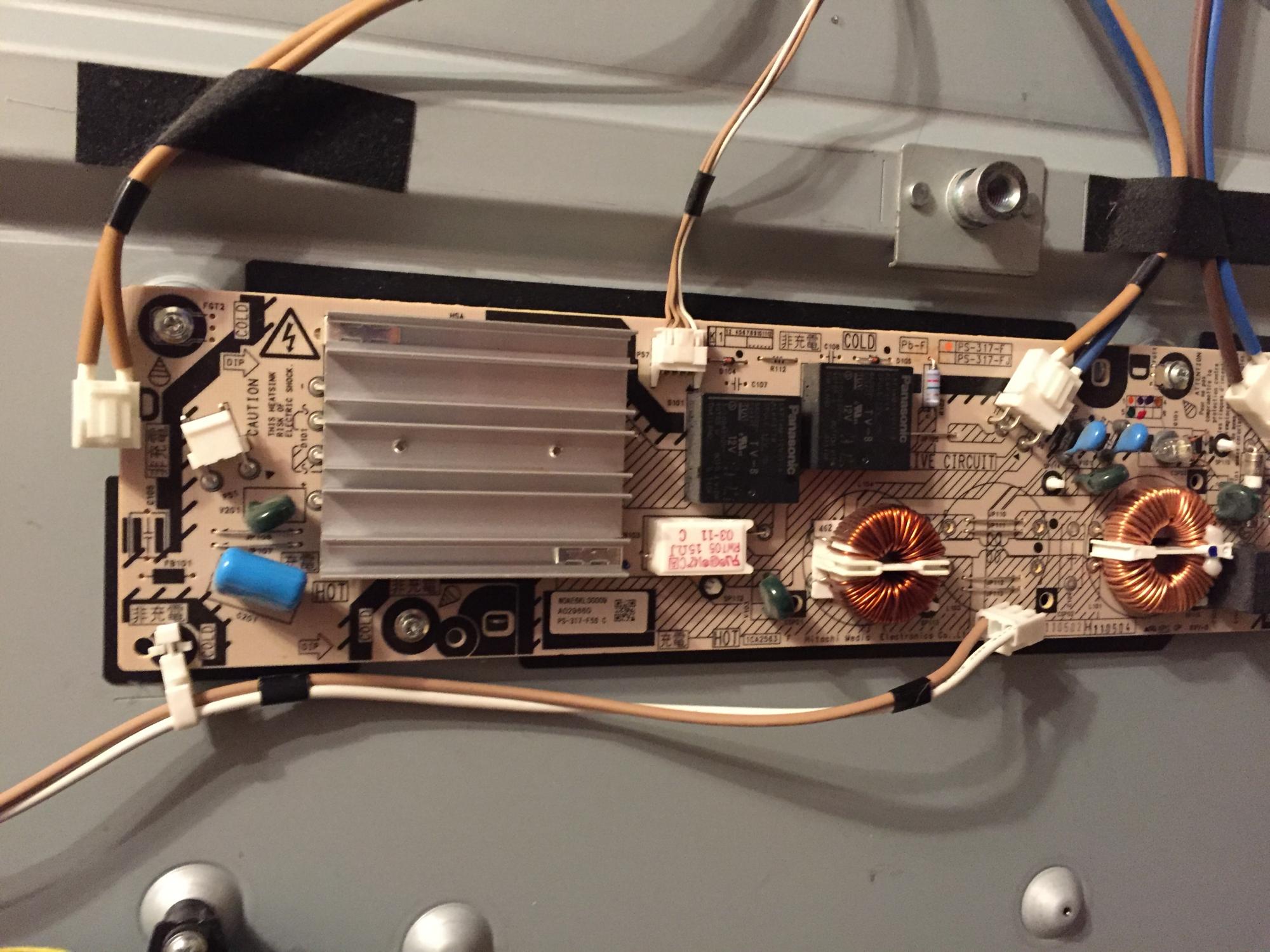

    There is a board that is partially behind the ss board.
    I also took the back off. I couldn't wait.
    There are 2 connectors not connected on a smaller psu?
    I can figure where 1 goes but can't find a plug for the other.

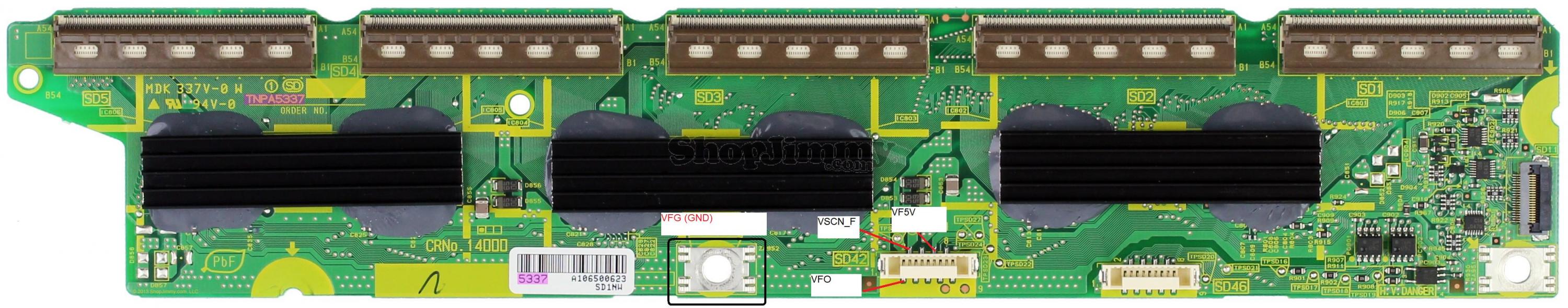

      Lol there is a board missing.
      Can someone tell me what it is? The Ysus board?
      • Malachi
        • Dec 2015
        • 1077
        • Usa
        Re: Panasonic tc-p55gt30
        It's the Ysus sc boards. Of course can't find one on eBay.

                  I'd be checking the sd & su for shorts first. Seems strange the SC is missing, maybe it was still good and been sold separate? maybe they still have it? have you asked them?

                    They bought it as is. Seller told them it worked. How would I check the sd and su for shorts?

                      https://www.badcaps.net/forum/showthread.php?t=51724
                      these are resistances I got off a set for a 50", use the gnd plate Vfg on the buffer boards.
                      Other way is to simply use continuity and again use the Vfg point on the buffers and slowly slide the other probe across all the pins at the ribbons.
                      I would do both because it's possible to have a faulty board and not have the outputs shorted which was in another thread recently. rare but it happened.
                      SD,
                      1 Vfo 4.76M
                      2.Vscn_f 7.79M
                      6. VF5V 28.1K
                      SU
                      8. Vfo 5.52 Meg
                      6.Vscn_f 9 meg
                      2. VF5V 28.4k
                      • Malachi

                          you don't need to know, you need to know how to find the pins and to read and use a multimeter.
                          connectors are Sd46, su41, the numbers are the pins, the rest who cares and the values are what we compare to

                            images, these are 50" buffers but for the purposes of identifying the pins etc, they'll do.
