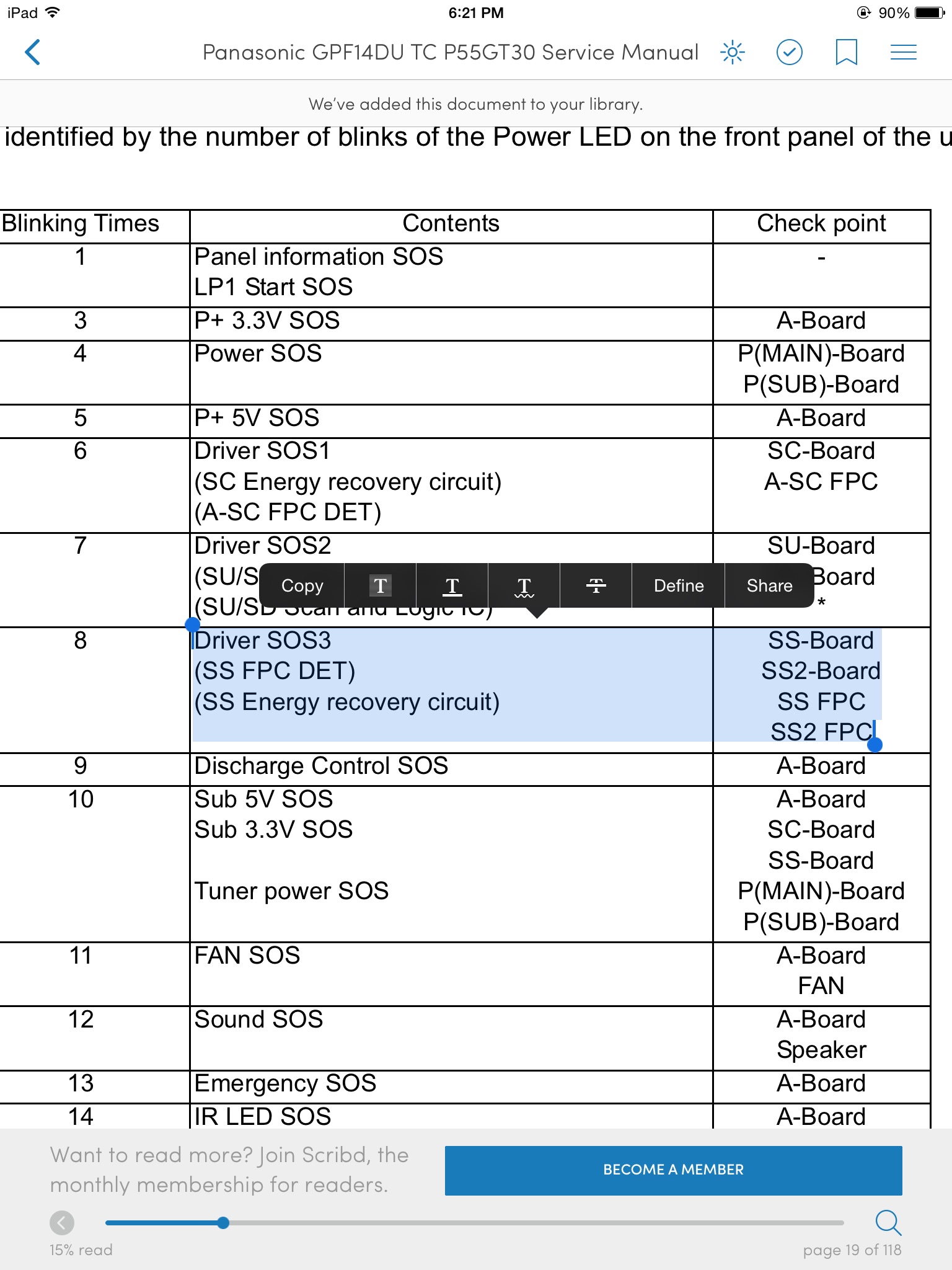

                            It's blinking 8 times. This is what the service manual says:

                              eBay has an ss board (Zsus I believe according to shopjimmy) new for $50 obo free shipping. They accept returns, no stocking fee, I pay return shipping.
                              What is the ss2 board?

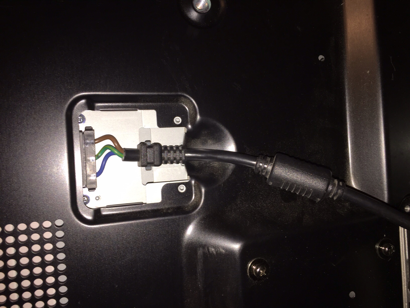

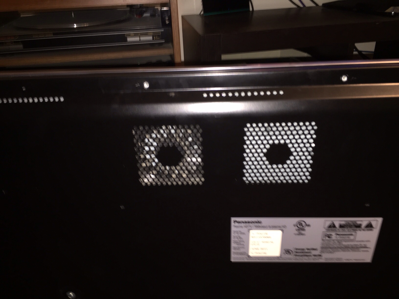

                                A couple of pictures of the back. I haven't doe anything. Tomorrow I'll open her up.
                                There is a part missing by where the power cord is. I've never seen a TV like that. Can any one tell me what is missing?
                                Also it looks like there are slots for 4 cooling fans but there are only 2, on the left side.
                                Is this how this model is?

                                  Again, I'm using manage attachment to try to upload more than one picture at a time but only the last one I add shows up.
                                  That's why another post for the other picture.

                                      You are missing a plastic cover that goes over the power cord. If you are careful with the cord, you could probably just cover the opening with tape to risk shock. I would try to find the cover. Someone has had it apart apparently with that missing. Not sure on the fans, but I think there are four. More than likely with 8 blinks, you probably have a bad SS board which is the board on the right side looking from the back. You will need to remove the "A" board or at least move it out of the way to get to the connections. The "A" board is the one with all the video connections. I will try to look tonight at the training guide to tell you how to check the 8 blink code or if you are lucky tw2005 will chime in as he is really knowledgeable in Panasonic plasma's. The SS board can be repaired at component level, but I think you can get them pretty cheap. Definitely diagnose first. I think on this model if you want to use the component, composite and audio you need adapters which are available. I guess I am getting ahead of myself, first you have to get it fixed.

                                        I forgot to mention the SS2 board is just an extension of the SS board. Its behind the A board.
