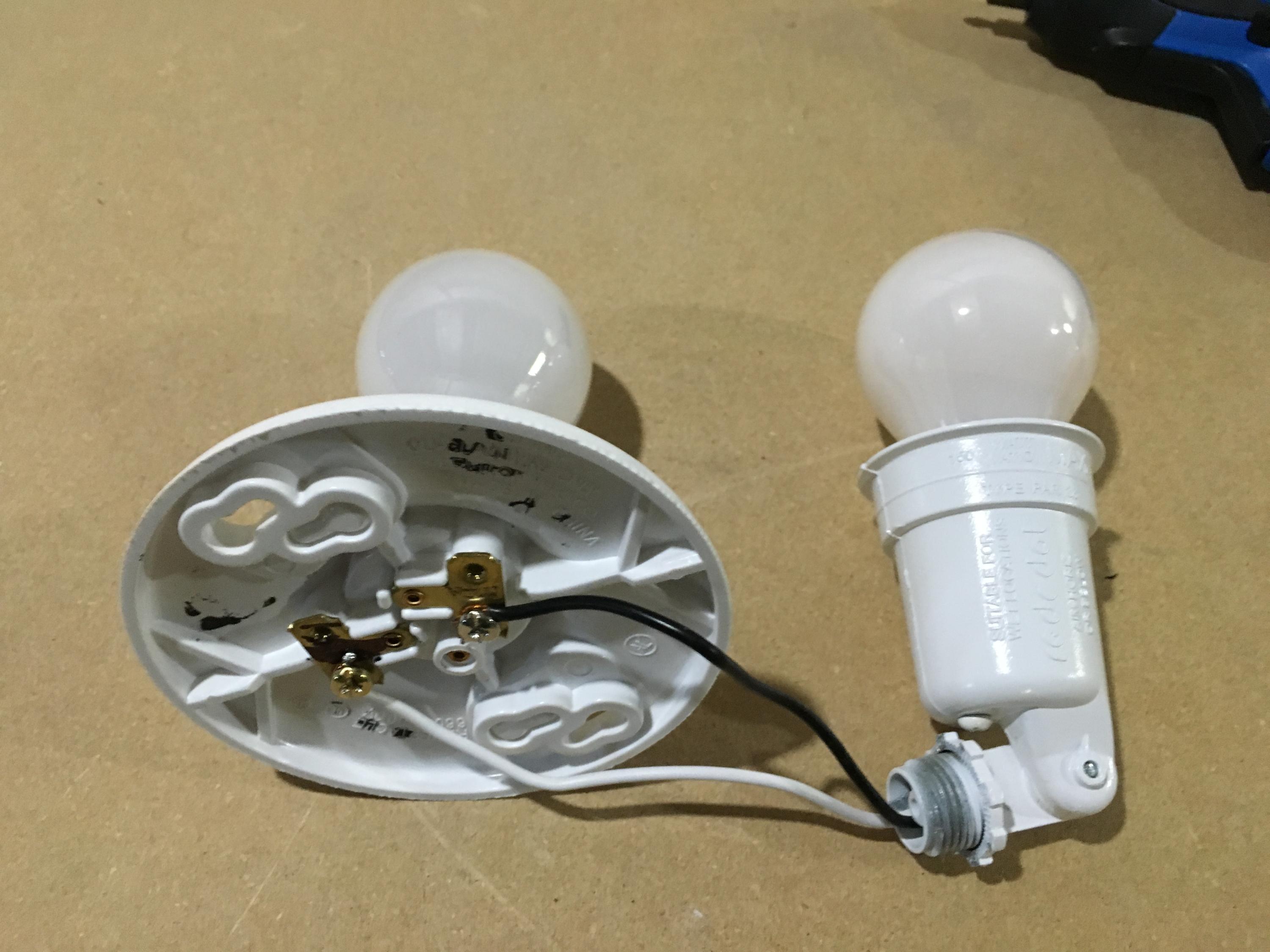

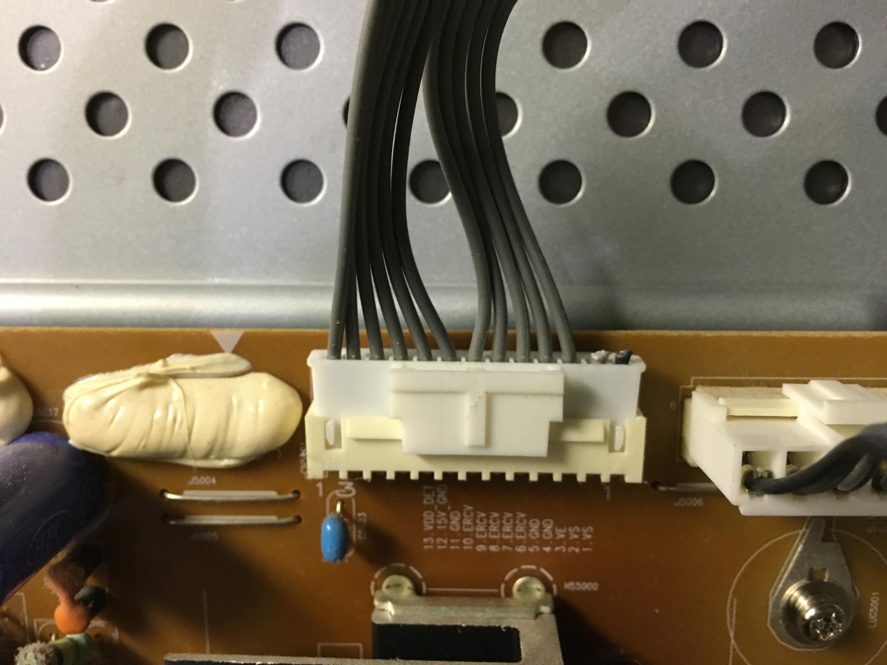

                          OK I am now ready to test the TV with my dim build tester. The XSUS board keeps shorting out and blowing a bunch of IGBTs, the VS line shorts out. To prevent blowing the parts again after repair, I am doing the following:
                          I cut the VS wires going from the YSUS to the XSUS. Now I want to put my two 70W bulbs in series with the VS line. I will connect wires from both bulbs into the connector with the VS lines cut. One bulb wire will be on VS line from power supply and the other will be connected to the connector for VS line on XSUS board.
                          Can someone look and tell me if I am doing this right?
                          See pics below.
                            • 31198
                            #33
                            Re: Dim Bulb Tester
                            that's wrong.
                            wire them like christmas-tree lights.
                            [source]------------[lamp1]----[lamp2]-------------[destination]
                            • tech2014
                              • Aug 2014
                              • 807
                              #34
                              Re: Dim Bulb Tester
                              So the bulbs are connected wrong? I have the neutral of the first bulb going to the live of the second bulb, is that not in series?
                              Can someone explain to me what to do? I have never done this before.
