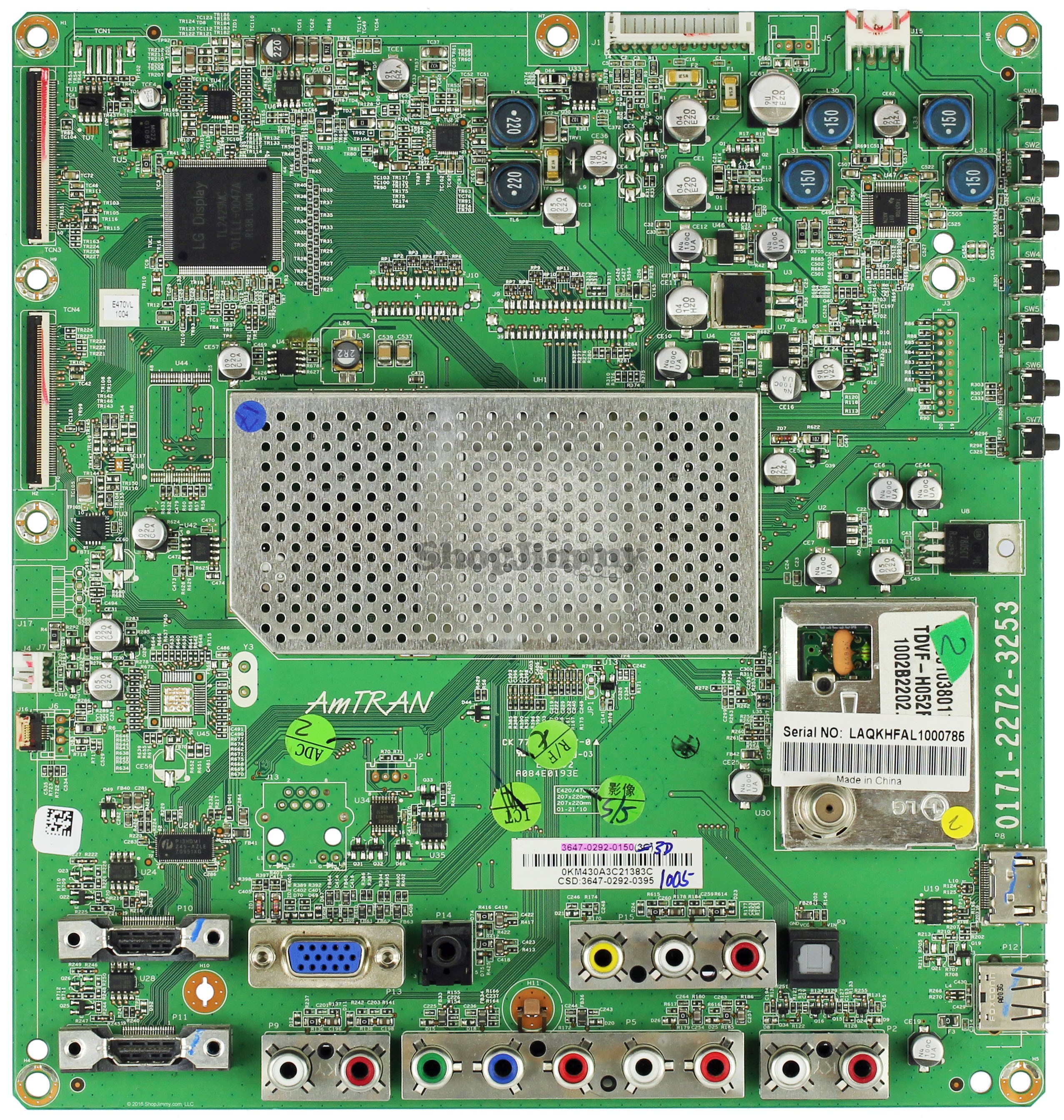

    WTF! Really? Lest see now I do not have the exact same board in front of me to trace, that is right, I have done many tracing and reverse engineering many time before for lots of people here for FREE by spending many hours of my own times!
    So good luck with your repair if you do not want to do some work.
    wow i was just asking if anyone knew where to start like what components to check first.sorry i blew up at ya i guess
      Re: Vizio E470Vl no backlight problem
      Vizio 3647-0292-0150 is your main board based on the number as printed on barcode.
      http://www.shopjimmy.com/vizio-3647-...or-e470vl.htm#
      http://www.shopjimmy.com/vizio-3647-...repair-kit.htm
      Per description from SJ:
      The Vizio 3647-0292-0150 Main Board Component Repair Kit includes all necessary components to repair common failures on the Main Board. Symptoms include stuck or frozen at the Vizio welcome screen, TV turns on when you press the power button but has no backlights.
      Part 2
      Symptoms:
      No Backlights
      Description Quantity Board Location
      Integrated Circuits 1 U33
      You may want to look at U33 to get the P/N as printed on top of the IC to see what it is what its function is.
        thanks bud-you're the best-got the parts ordered and my fingers crossed-sorry i'm such a newbie
          I am curious as to what the U33 is, can you read any printing top the of the body?
          • chandonh
            • Feb 2016
            • 17
            yep the top line reads 4953gm.the bottom line reads a07014-thanks again for your help. i will post results when i get the part replaced..
              That is the dual MOSFET:
              https://cdn.badcaps-static.com/pdfs/...e9f2435410.pdf
                  I know this is an old thread but I'm trying to help out an eBay member with a no backlight issue on this same model. His BL-ON signal is 1.32V and I'm wondering is that's the issue. What is typically enough to activate the backlights? I would think it should be more in the 2.5V - 3V range so I'm thinking he's got a main board problem.
                  Any opinions are greatly appreciated.
                  • aaronwt6
                    • Apr 2013
                    • 855
                    • US
                    #29
                    It was indeed too low of a voltage to activate the backlights. I had the member just jump the PS-ON to the BL-ON pin and snip the wire going to the main board that activates BL-ON. For now, he's watching the TV again with no money spent.
