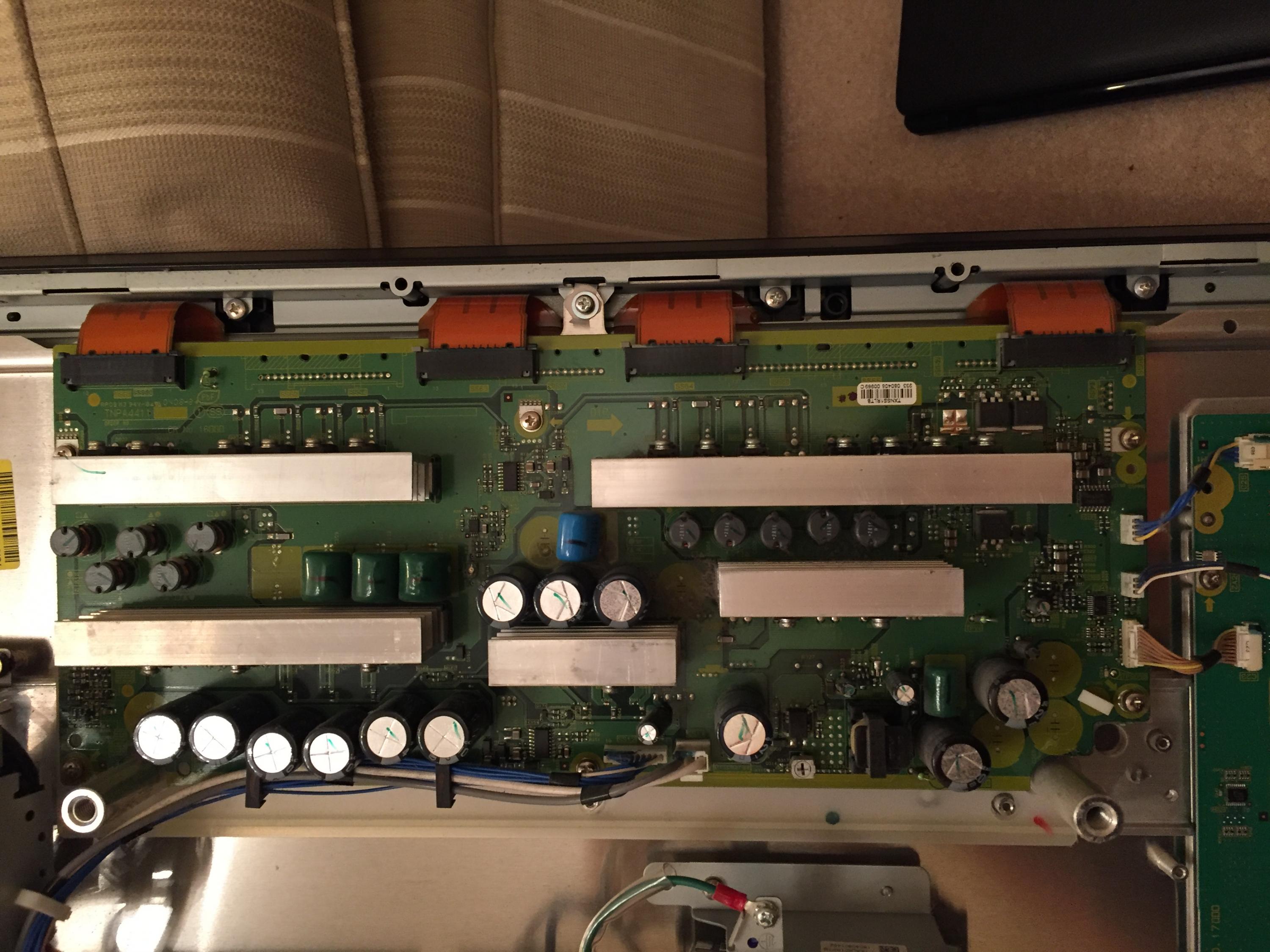

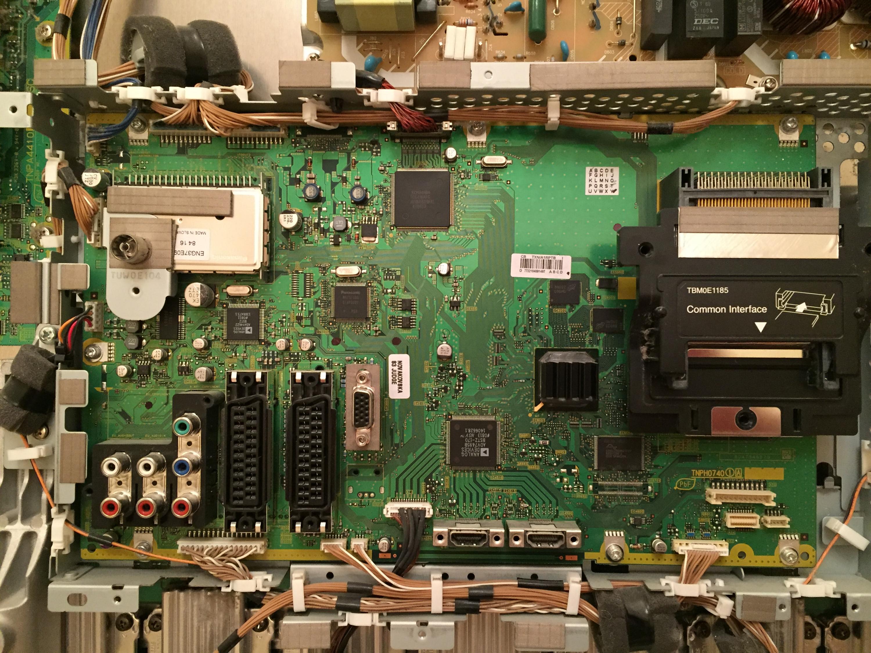

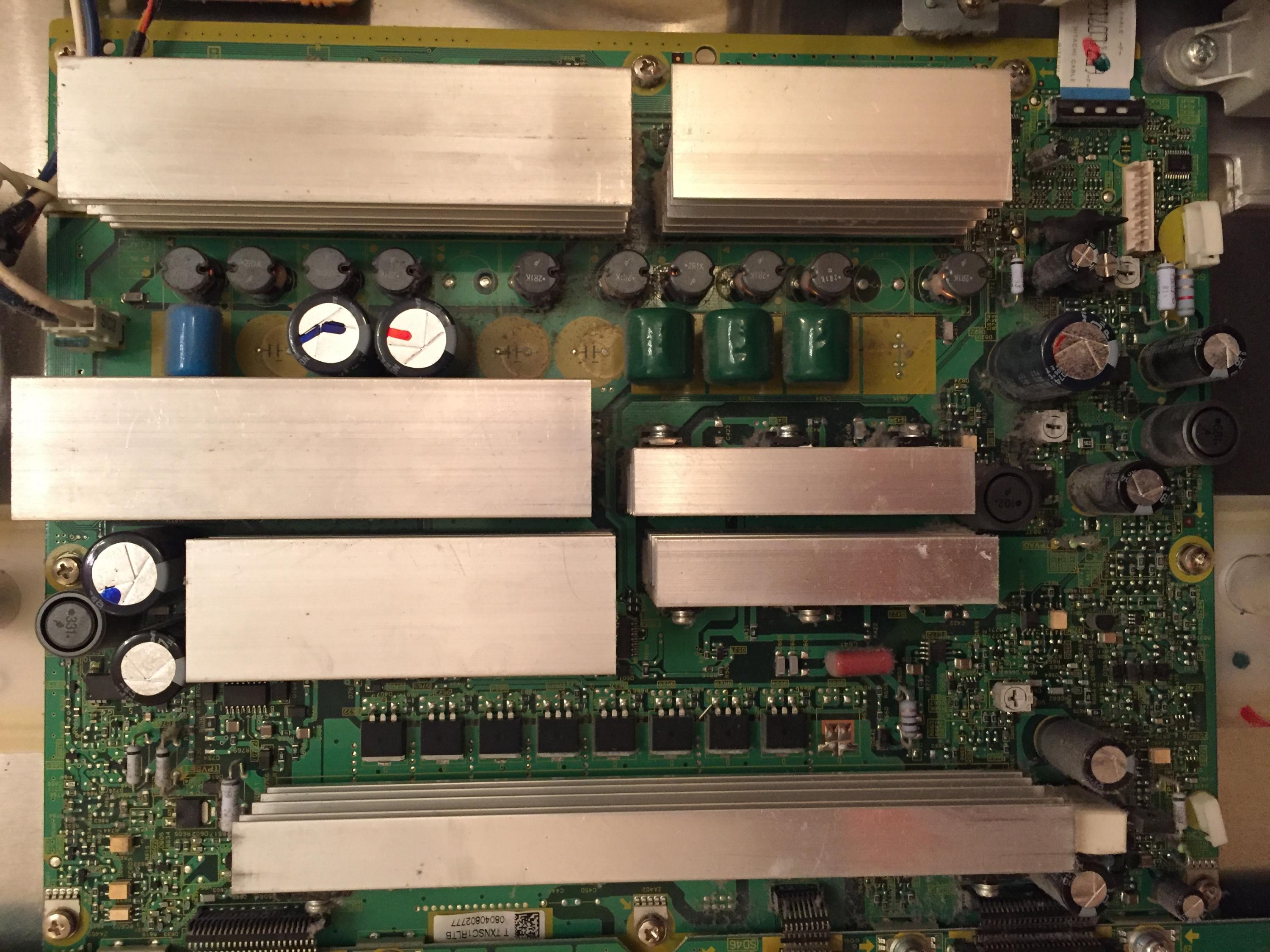

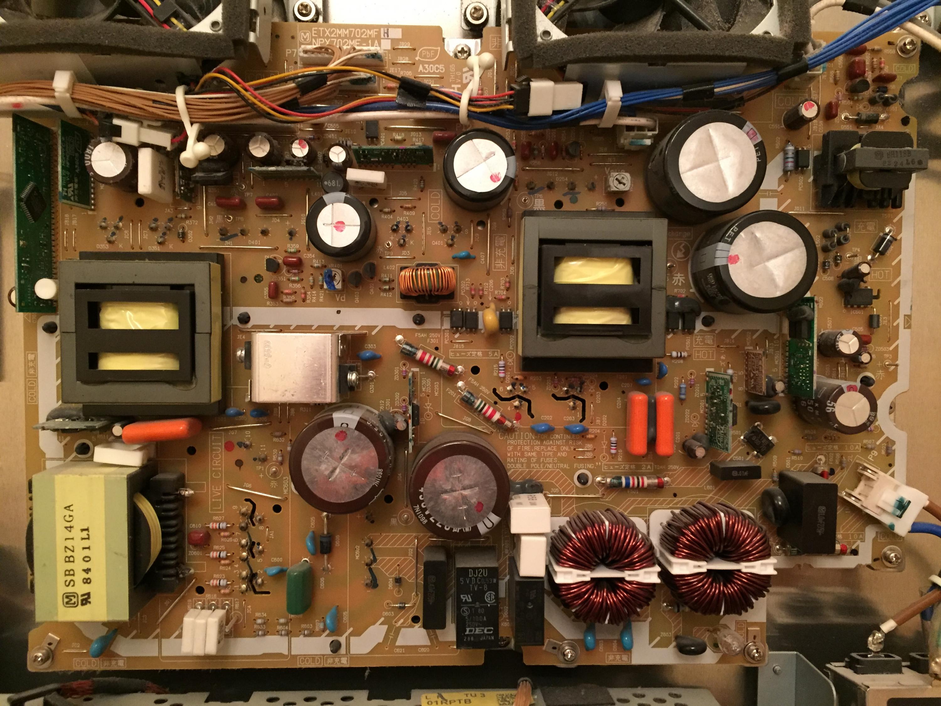

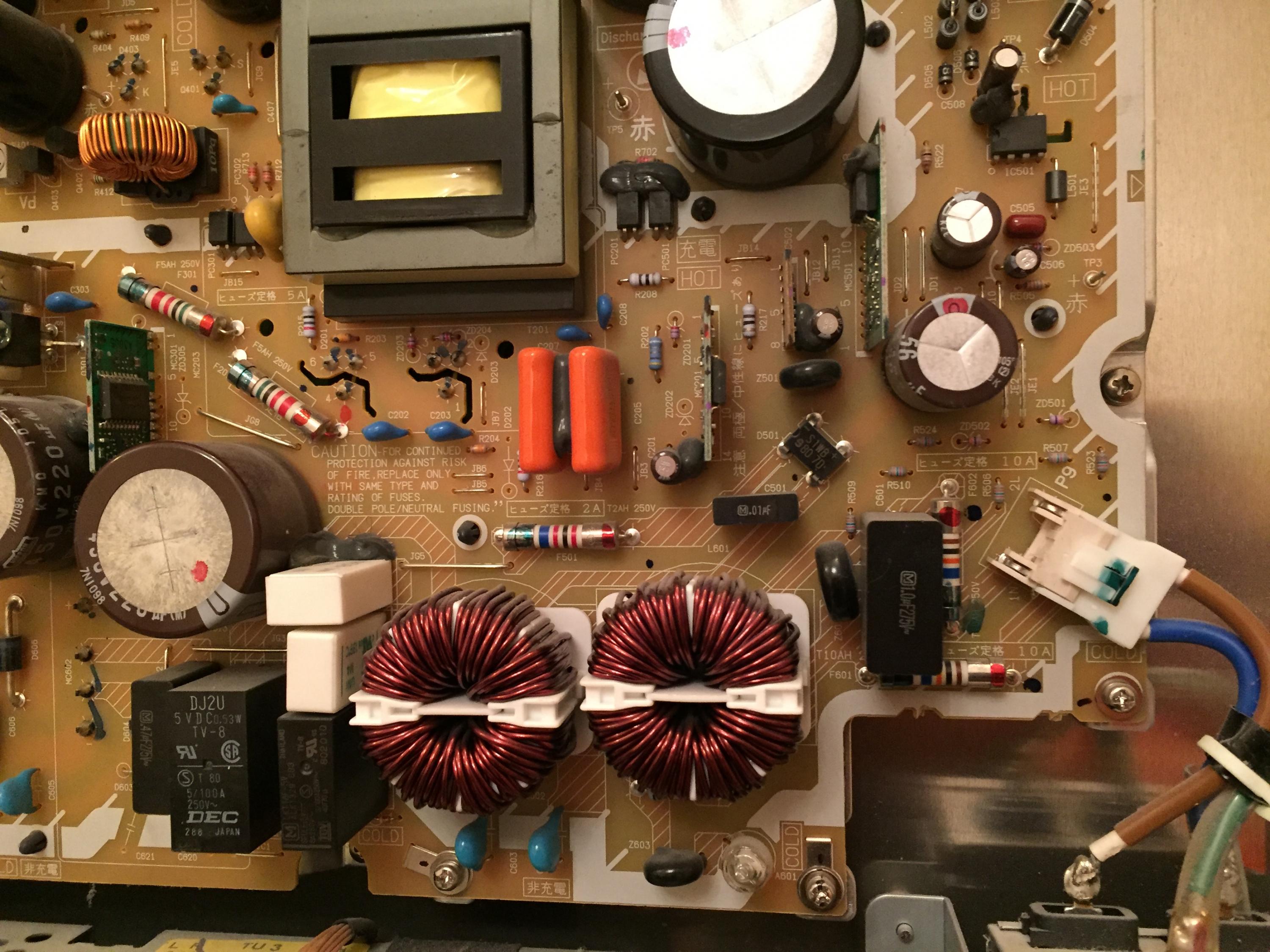

    Some pictures to help...

      Usually lightning kills the A board as it travels down the catv wire, typically the hdmi chip. if you look at the qfp chip just above the vga connector it looks like it might have a pinhole blown in it at the "a" in panasonic. It could just be a dark spot hard to tell without a macro shot of it. Im not terribly familiar with this model but most plasmas have a test jumper on the control board that will light up the tv with test patterns without the mainboard tied in. Hopefully Tom66 or tw2005 will chime in as they are most familiar with the panasonic sets

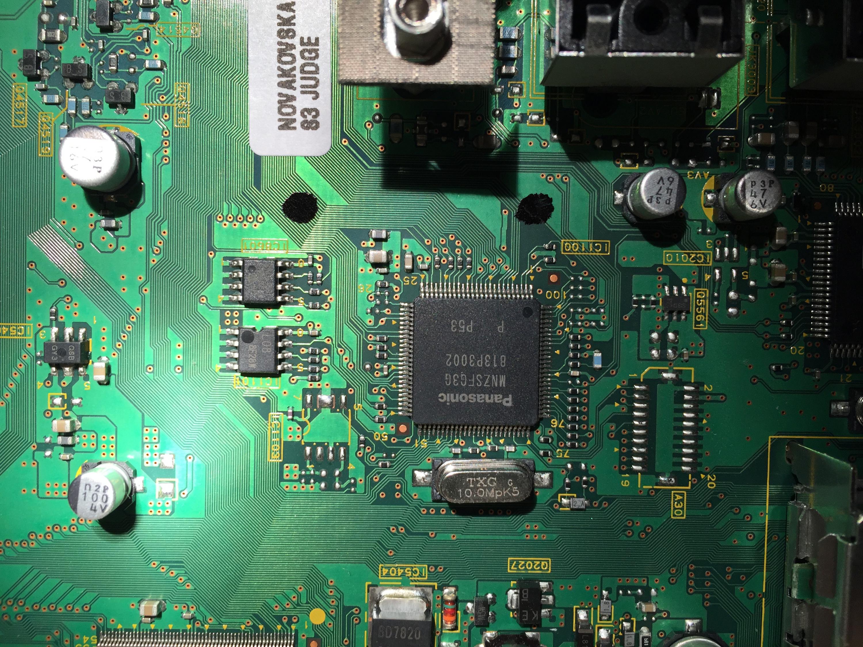

        Thanks Caleb. I've attached a macro shot (I'm not at home during the day so I'm afraid the quality of the pics is poor). Was just a dodgy photo - the chip visually looks fine. The power surge took out the tele and the broadband router/modem off the same power socket so I assume the voltage surge/drop entered through the power cable (it wasn't surge protected as I'd swapped the protector out the other week for something else....).
        If anyone knows a way of testing as Caleb describes or can confirm that what I've done is sufficient to rule out the P board as being faulty I'd be most grateful. If I'm going to replace the A board then is matching TNPH0740 enough or is the 1 in the circle and A in the square some sort of revision number? There's also a TXN/A1RPTB 1 on a barcode sticker - is this the more specific part number I should be matching?
        I've found one here in stock (there's a slight difference in the barcode lettering. If anyone linked to this forum or regularly posts has one they want to sell to me I'd rather give the business to you!!!

            If repairing this main board is something you would like to try... The main HDMI ic on this main board is the ADV7495B BSTZ-170 that is directly above the HDMI input connectors in your photo.
            If you have chip quik and the flux that comes with it or a good flux, see if you can remove this ic without lifting any of the pads or removing any of the nearby small components. Then remove the remaining chip quik from the pads with desoldering braid.
            This ic does not have a solder tab underneath it, so you shouldn't have to use hot air to remove it... although if you do have a hot air gun used at a low setting, it does make it much easier to remove the ic after chip quik is also used.
            This will most likely get the tv up and running (without any HDMI or component inputs) if the power supply wasn't hit.

                I'm not certain that the ic is bad, but it doesn't take long to find out once you get the proper equipment. Hdmi ic's are a weak point when it comes to lightning.
                Sometimes you can remove the hdmi ic and have the set come up only to find out that the damage went further than just that ic once you replace it. Many more times the set is fully operational after replacing the hdmi ic.

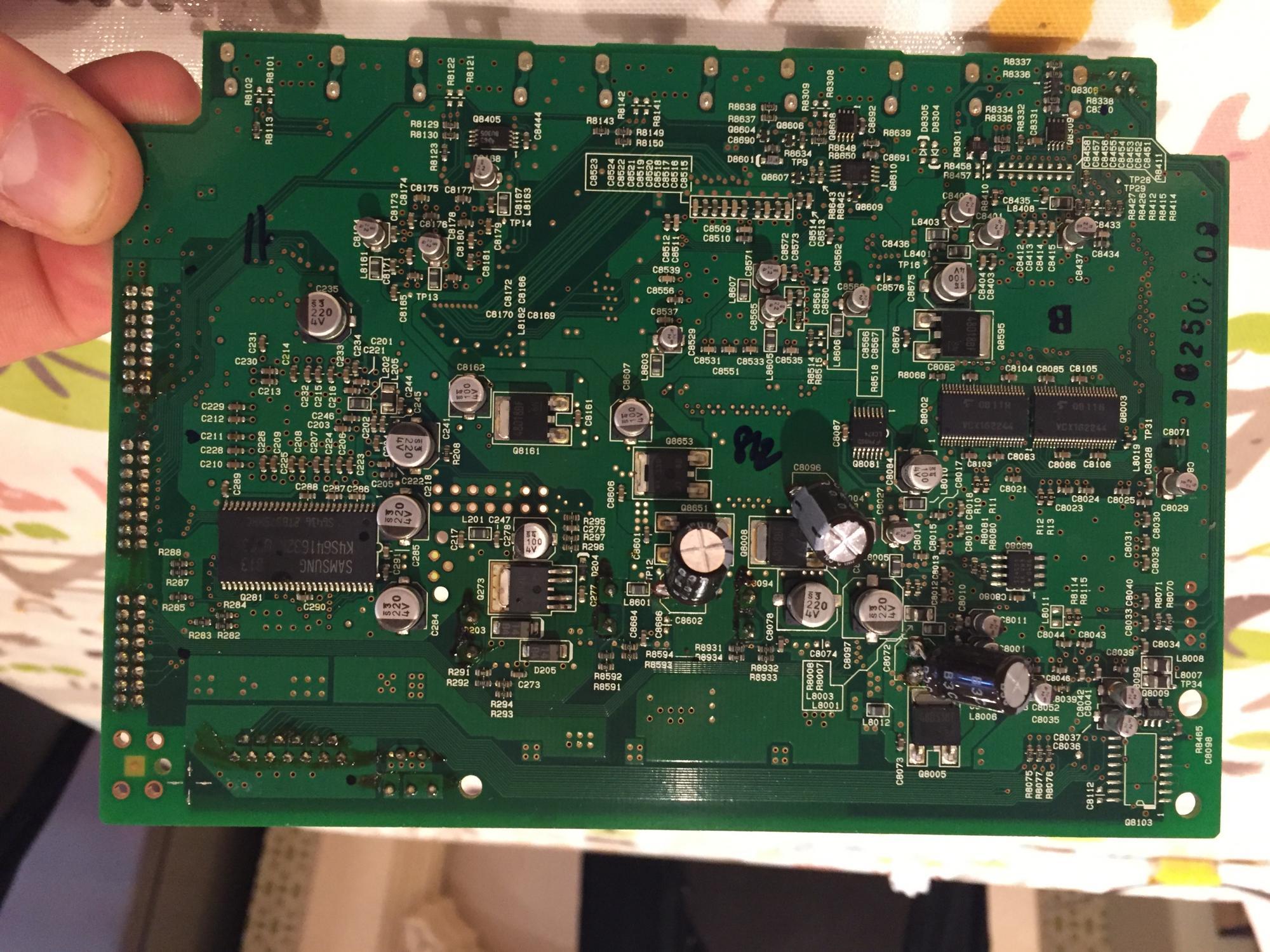

                  However... the hdmi daughterboard on the onkyo 606 has been fried, and also the freesat box. Freesat box has been replaced under warranty. I don't think the onkyo is recoverable as those HDMI daughter boards are like rocking horse poo. Gives me an excuse to upgrade now.
                  The surge must have come through the telephone cable blown the adsl router then through the Ethernet cable and into freesat box from there through HDMI to knock out the onkyo and finally tele. Seems as though anything with HDMI boards are fragile - as you had said

                  • davetherave
                    • Feb 2016
                    • 8
                    Re: Panasonic TH42PZ80-B Lightning Victim
                    Pic of the daughterboard
                    • davetherave
                      • Feb 2016
                      • 8
                      Otherside
                      • michael dranfield
                        • Jan 2016
                        • 232
                        • England
                        Its very common for lightning to cause a massive surge on the phone line and damage everything connected to it, in days gone by people use to say unplug your television aerial during a storm , now its you phone line you need to unplug !
                        • tw2005
                          • Oct 2011
                          • 6458
                          Yep, HDMI ports seem to be a weak point.
                          Lost HDMI on my STB and it took out the HDMI port in my Panny but very lucky just the one in use, left me with 3
