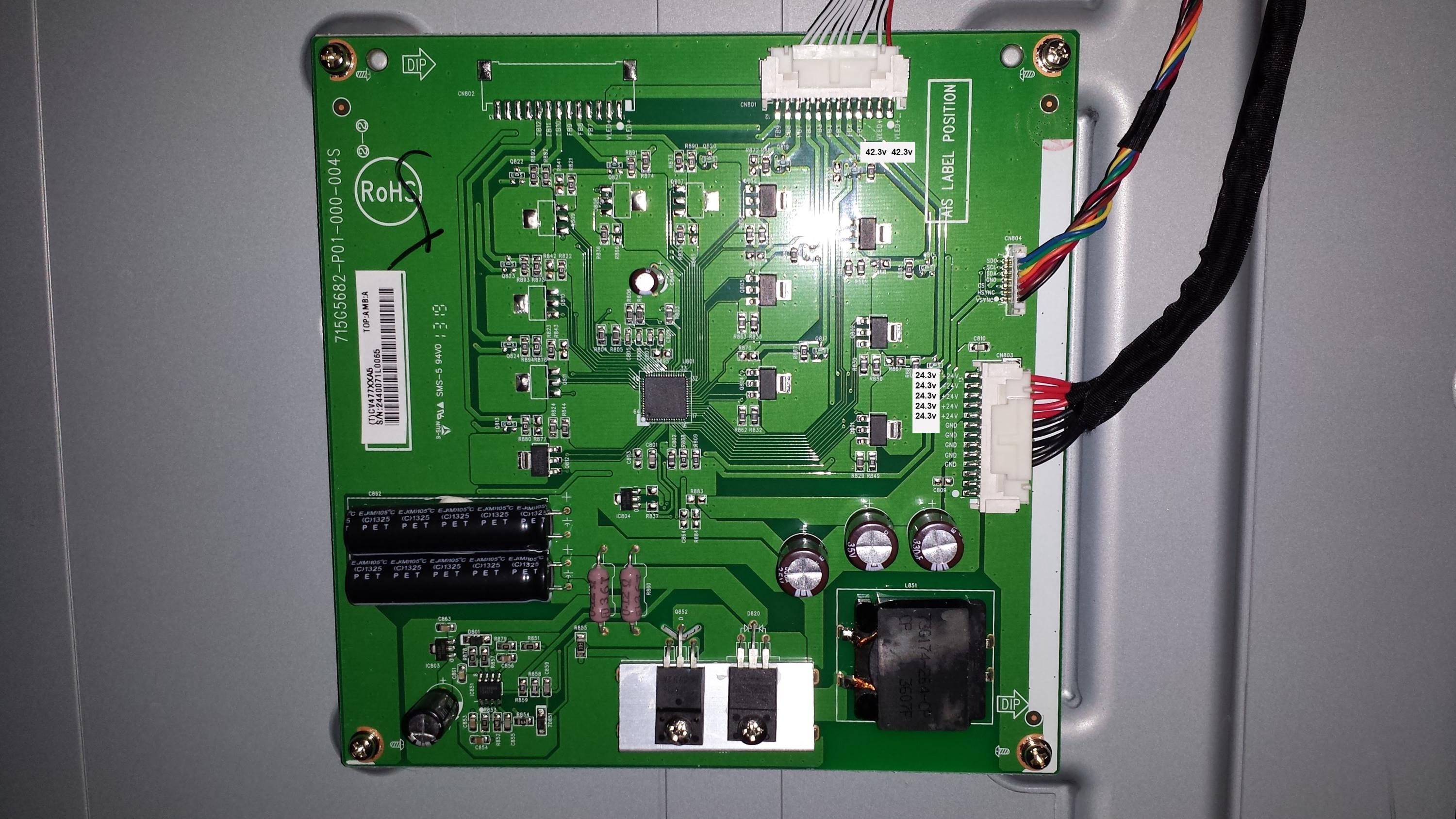

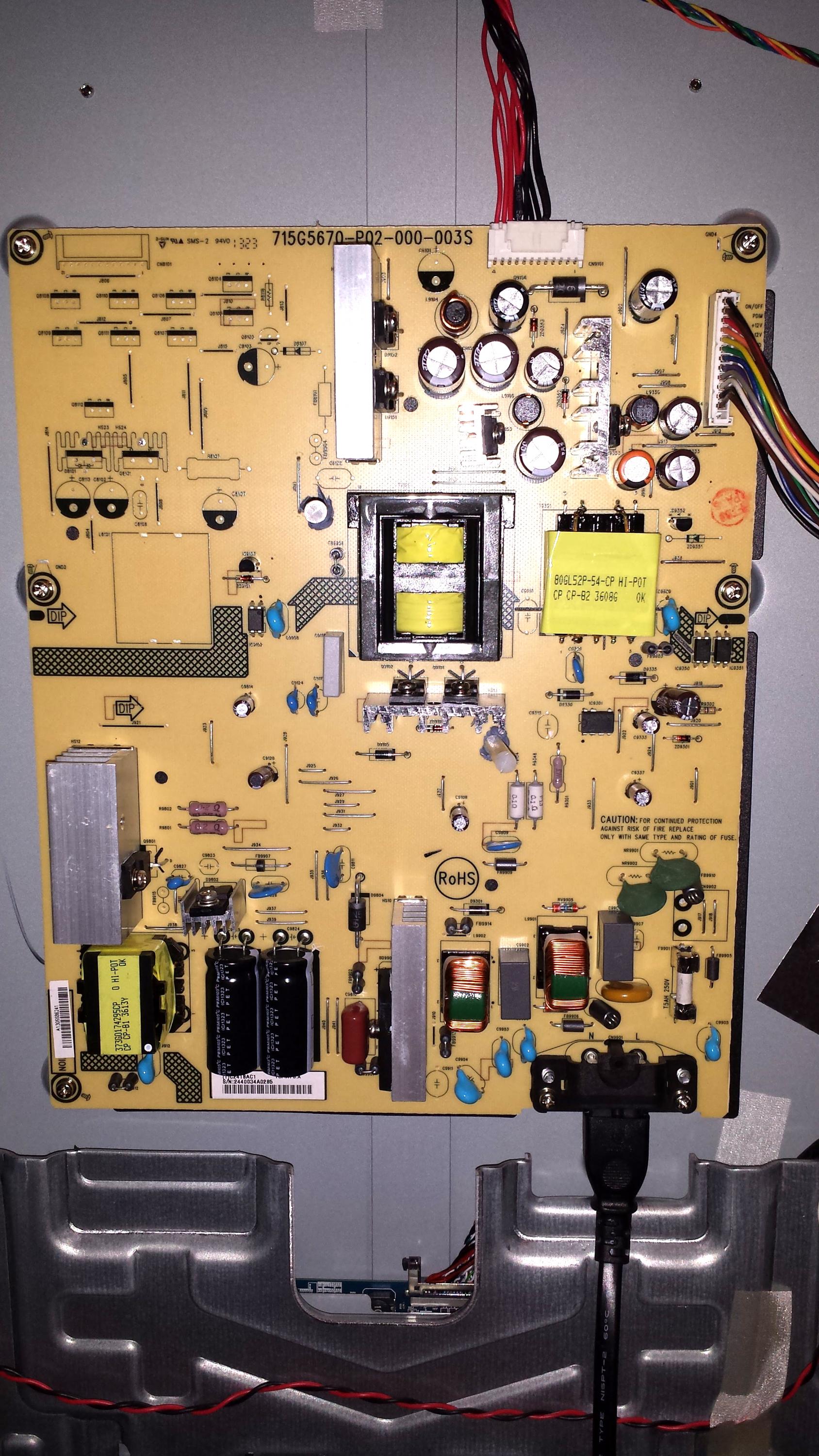

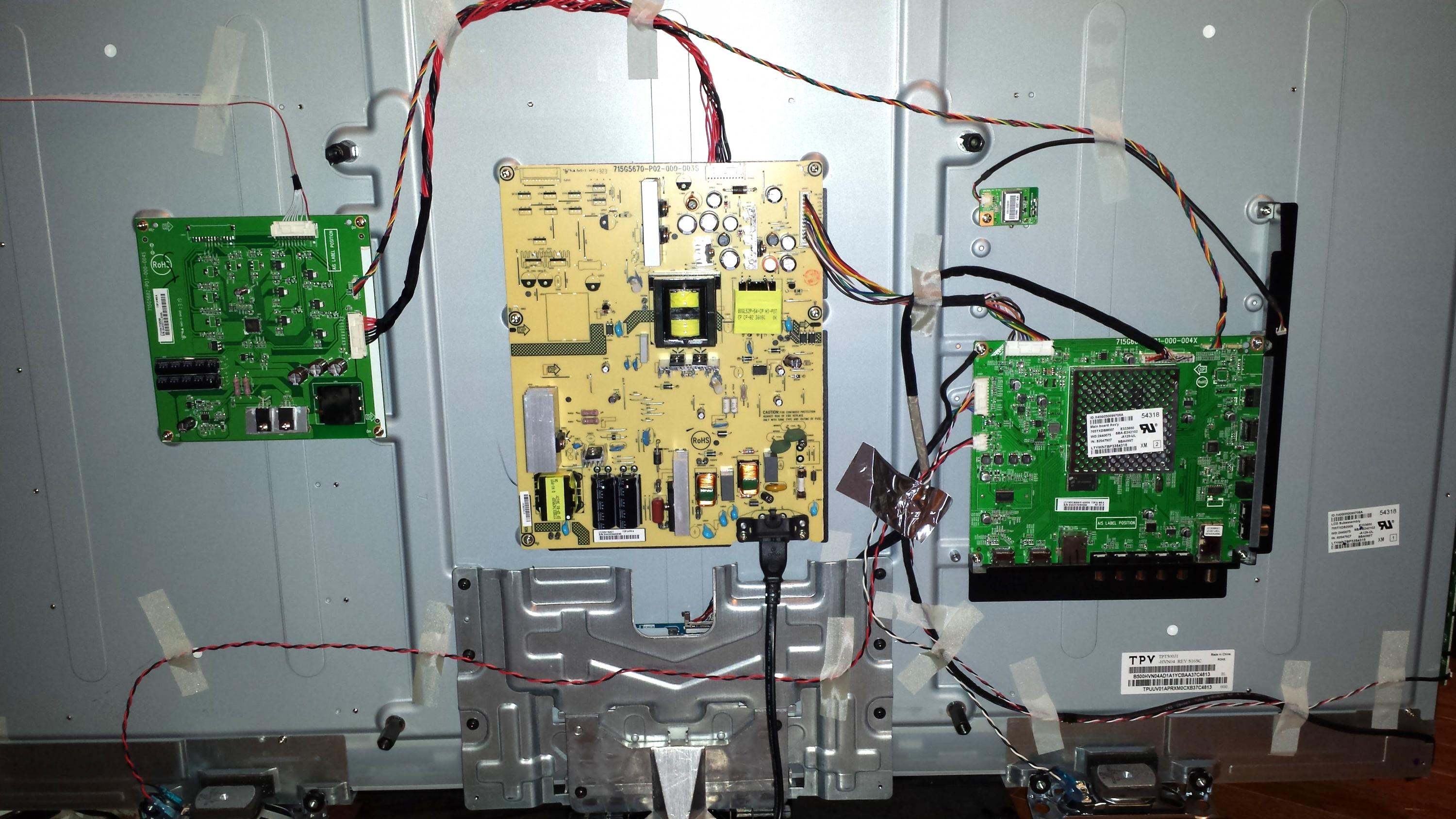

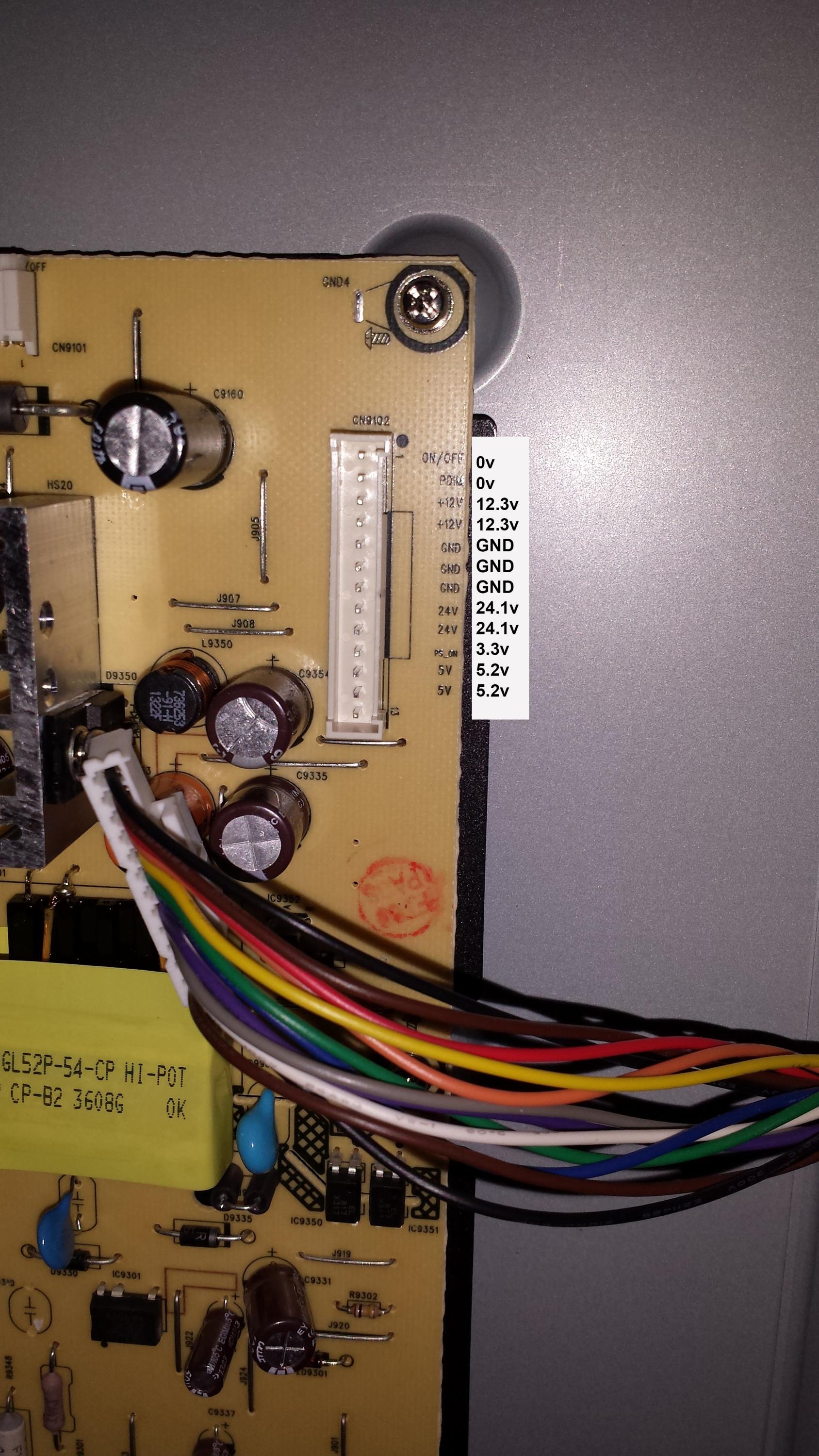

    My new project is a Vizio E500i-A1 which does have voltages present on the power board, however, nothing happens when you push the power button. No backlight, picture or power LED.
    I've annotated voltages I found on the attached pictures.
    Thanks in advance for your help on this one.
    Todd
    Re: Vizio E500i-A1 No Power

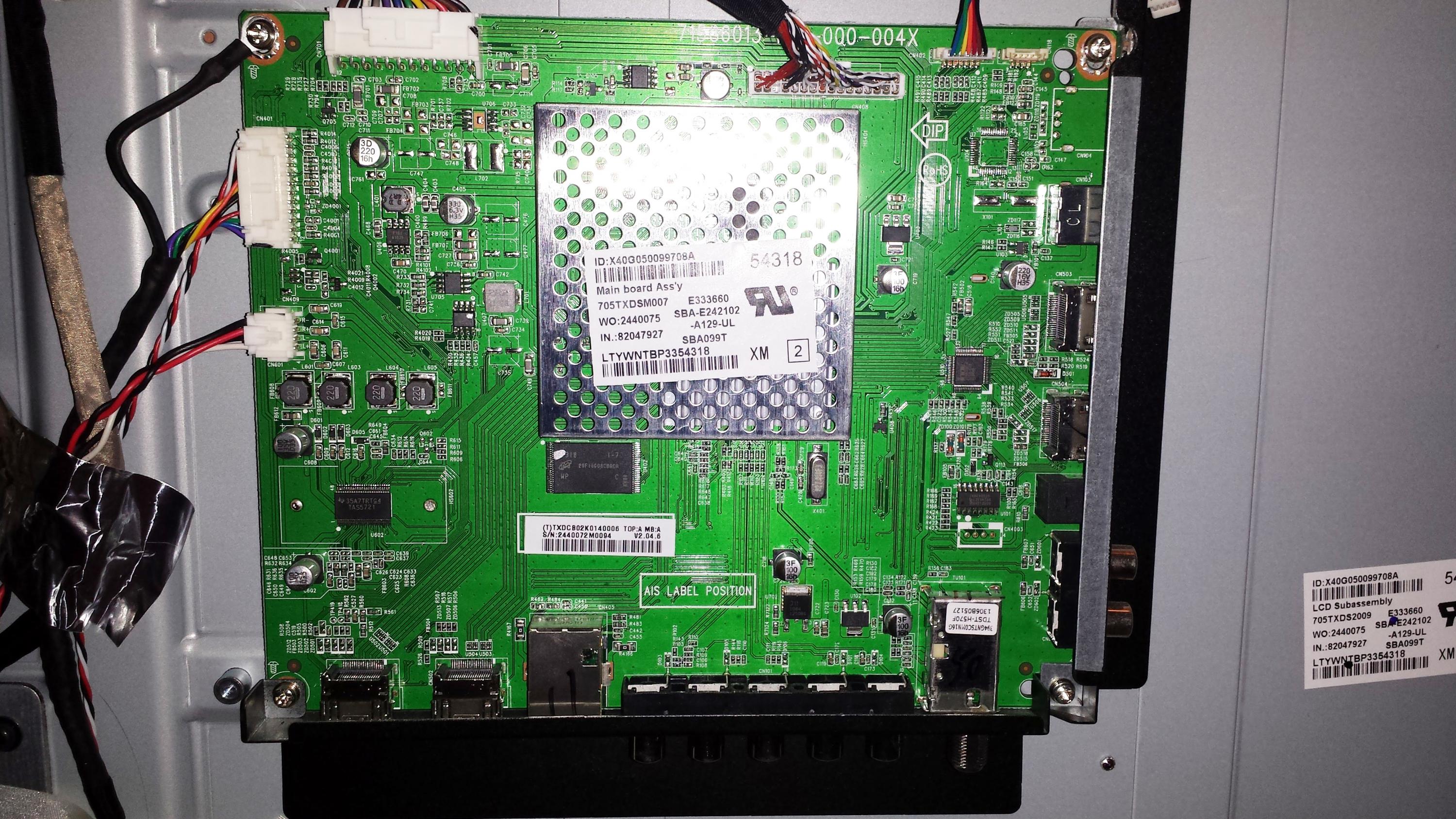

    You do have PS-ON signal from main board to turn on the switched 12V/24V power supply but the main board is not sending the BL-ON and the Dim control signals.
    You have problem on the main board.

        Based on other posts here, I pulled the wire from the ON/OFF pin on CN9102. Then I used a 1k resistor to jump from 5v to ON/OFF. All the voltages on the power board come up to what they are supposed to be and there is 24v at CN803 on the LED driver board. It's interesting that each of the VLED+ pins have 43v on them which seems low based on posts I've read here. I also powered the unit down and read the initial voltage at VLED+ and it doesn't go higher then 43v.
          So you left the connector between the main board and the power supply board in place but remove the ON/OFF pin to force on the backlights but the VLED+ did not jump up from 43V? If that is the case the Boost converter is not active to provide higher Voltage to drive the LEDs.

            That's correct. Everything hooked up except the single wire the ON/OFF pin.
              That means we will have to trace out the LED driver circuits next.
                  I ended up replacing the main board and its still going strong.

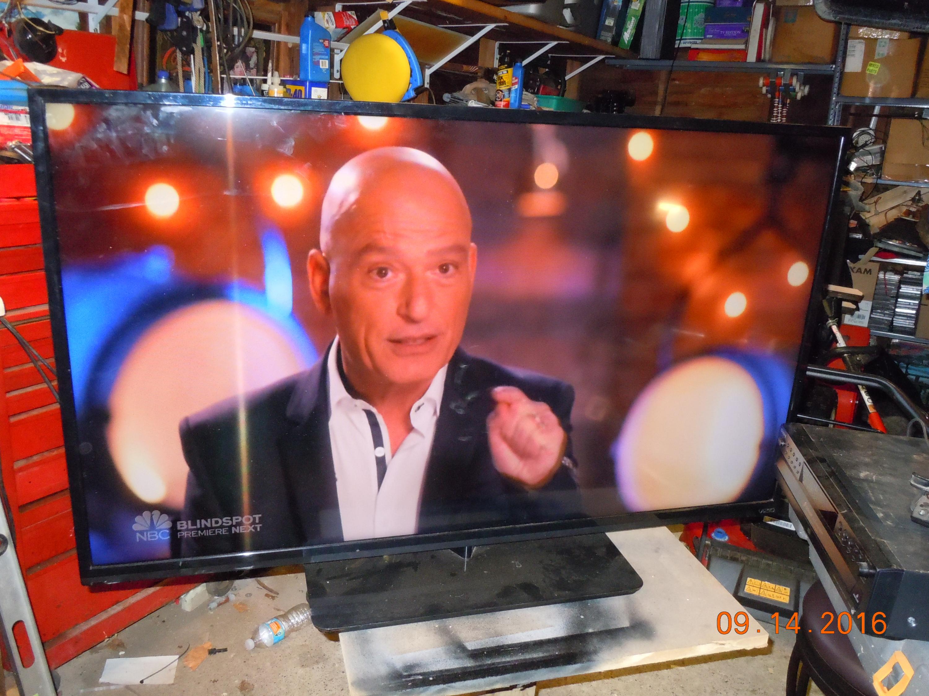

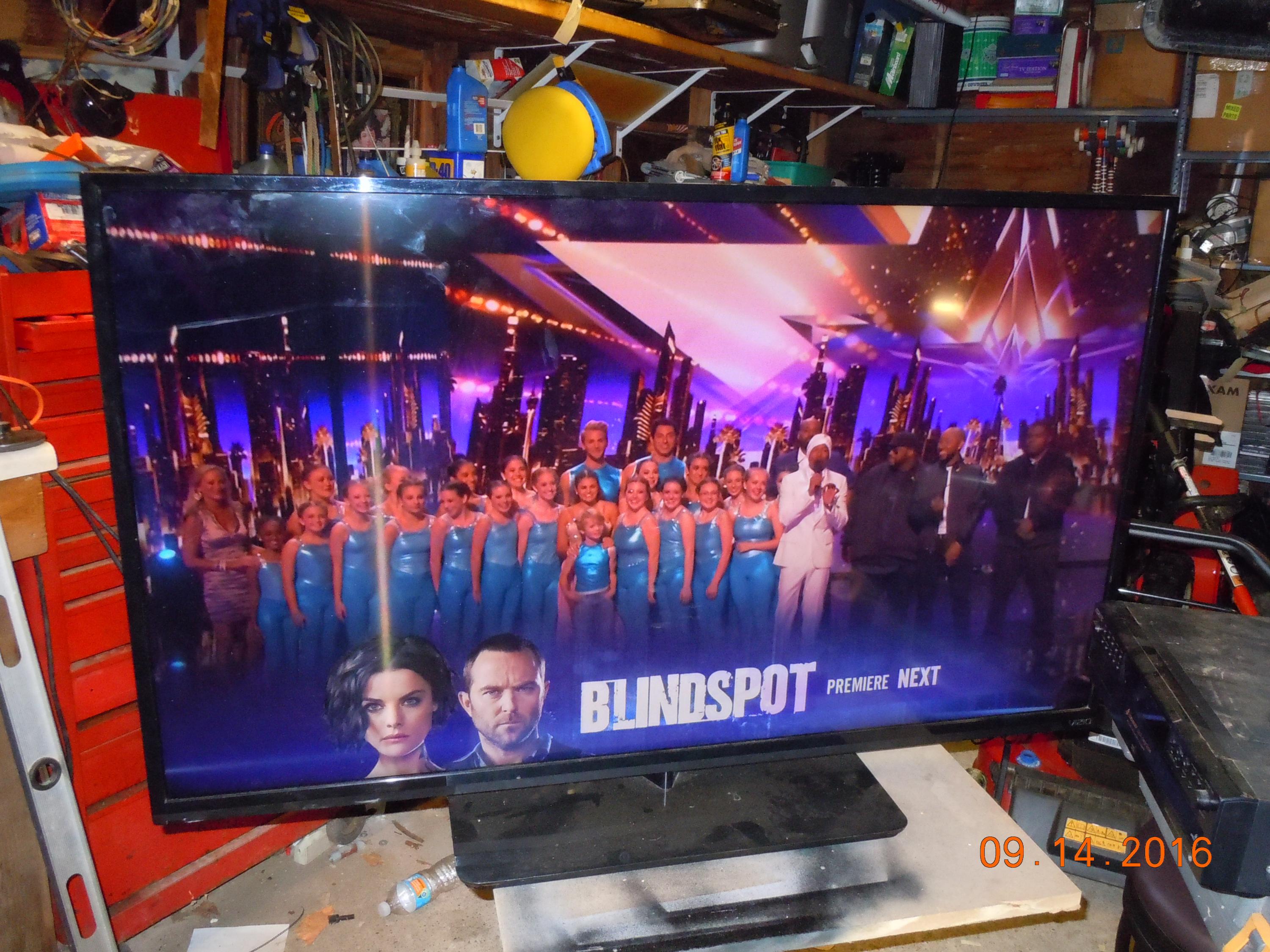

                        Success! It was the main board. I ordered the full repair kit from Shopjimmy as it was only $20 more than just getting the main board by itself. TV looks great!
