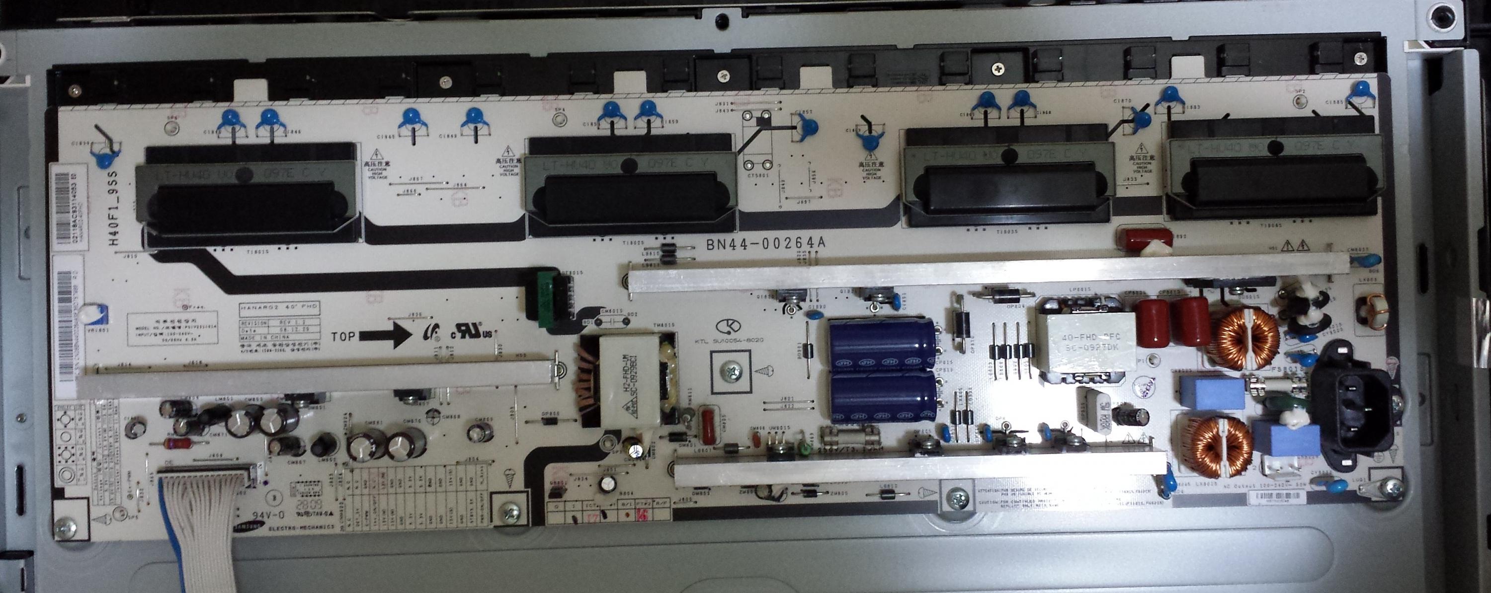

    I've been having a strange issue that I've haven't seen in the searches I've done. I have a Samsung LN40B640R3F which has a BN44-00264A power supply/inverter board which I think is the problem. If I turn the TV on, it works, but then eventually goes off after a few minutes. Then it won't come on again unless I unplug it for a while.
    I checked the standby voltage after I've left it unplugged for a while and then turned it on, and the voltage starts normal and then slowly drops to zero.
    Could this be a simple capacitor problem? I visually checked them and they all look good. All the components look good. No burn marks or damage anywhere, as far as I can tell.

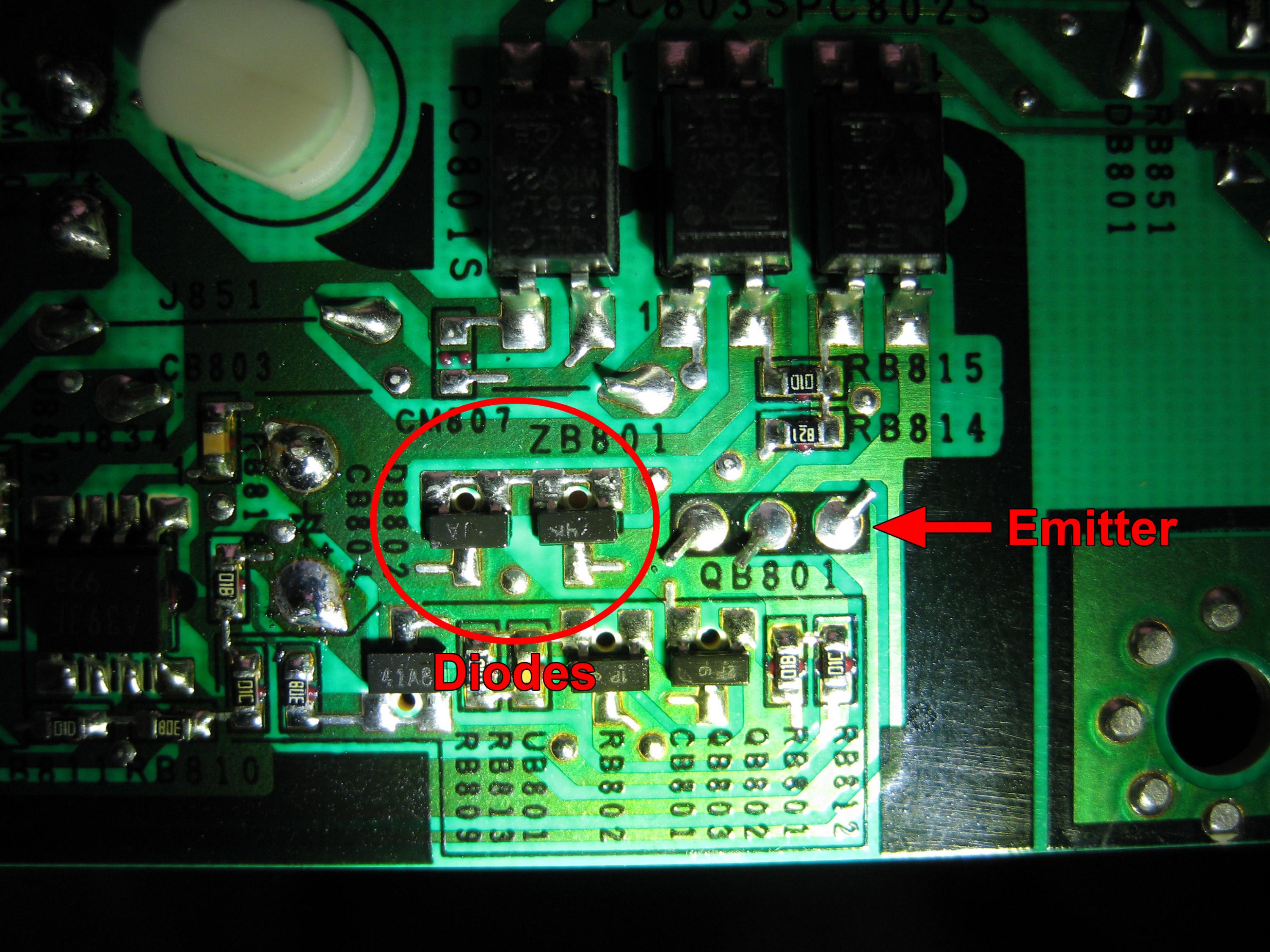

                See the diagram, the two Zener Diodes that Tom mentions are marked in the diagram, you should check the Voltage output at the Emitter of QB801 when it is working and when it is not.

                        Here's a picture of them that I made, corresponding to the circles from the schematic as well as an arrow showing which pin is the emitter on QB801. I haven't gone any further with it. I was going to try to replace those components but haven't gotten around to it.

                              The Emitter of QB801 is the output side of that linear regulator circuit, the Zener diode/or Zener diode + diode at the BASE of QB801 sets the output Voltage of the circuit, so if the Emitter output drops to <1V then you need to verify of the input Voltage at the Collector is still present or not, if it is then check the DCV at the Base of QB801 to see if it is still around 15VDC or not.

                                        It must be measurement error, Collector of QB801 is the input, the Base is connected to the Zener diode/diode and biased through the RB814 and OPTO PC802S, the Base Voltage cannot be higher than Collector Voltage, if the Collector is 0V then there will be no output at the Emitter of the QB801.
                                        The setup is just a simple linear regulator with OPTO used as a switch.
                                        You should check the solder joint of the transistor, OPTO, and the connection from the Collector all the way back to diode DM802.
