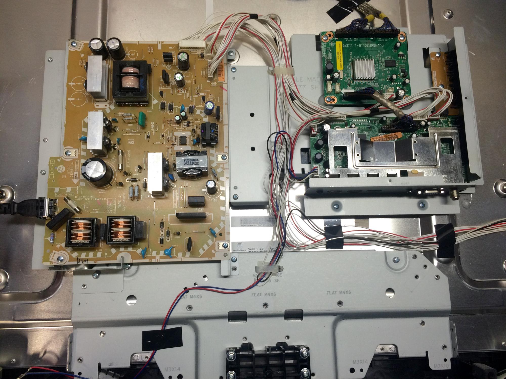

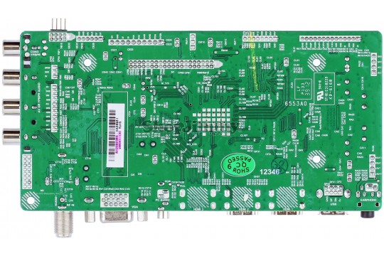

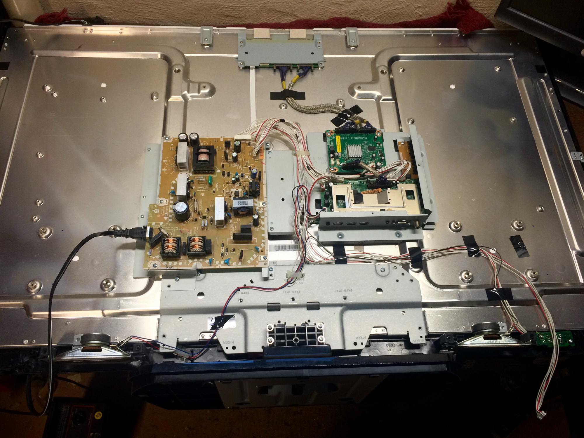

      Here's some pics
      There's another board (looks like inverter board) under the power board and main boards

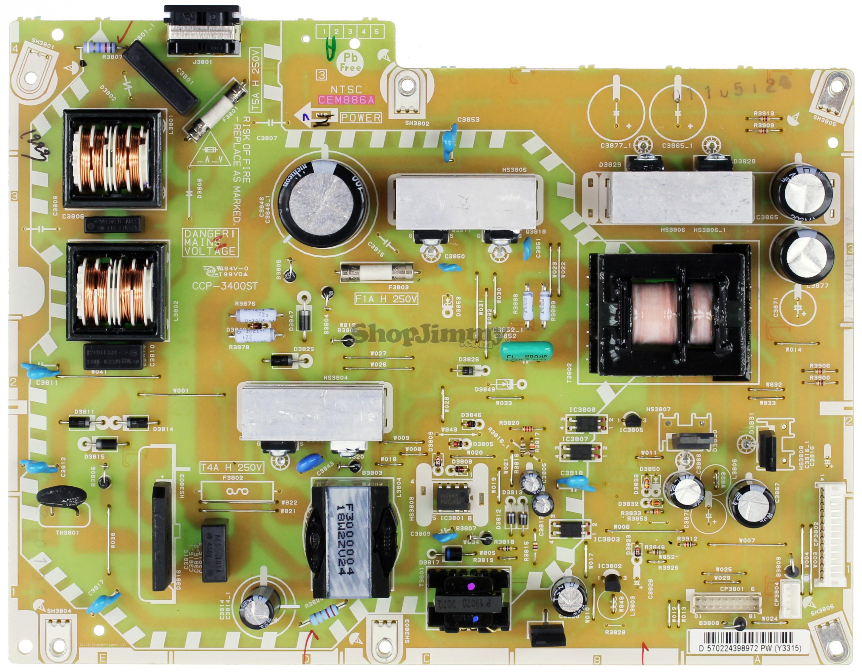

          Re: Orion SLED4668W TV will Not Power Up.
          I see cable with the white connector hanging out, where does that connector go too?
          I cannot see where the connector for the Backlights is.
          None of the connectors have the labels to tell us what each pins are for, it is not going to be easy repair.
          Orion CEM886A (CCP-3400SY) Power Supply Unit
          http://www.shopjimmy.com/orion-cem88...pply-unit.htm#
          Pictures provided by shopjimmy

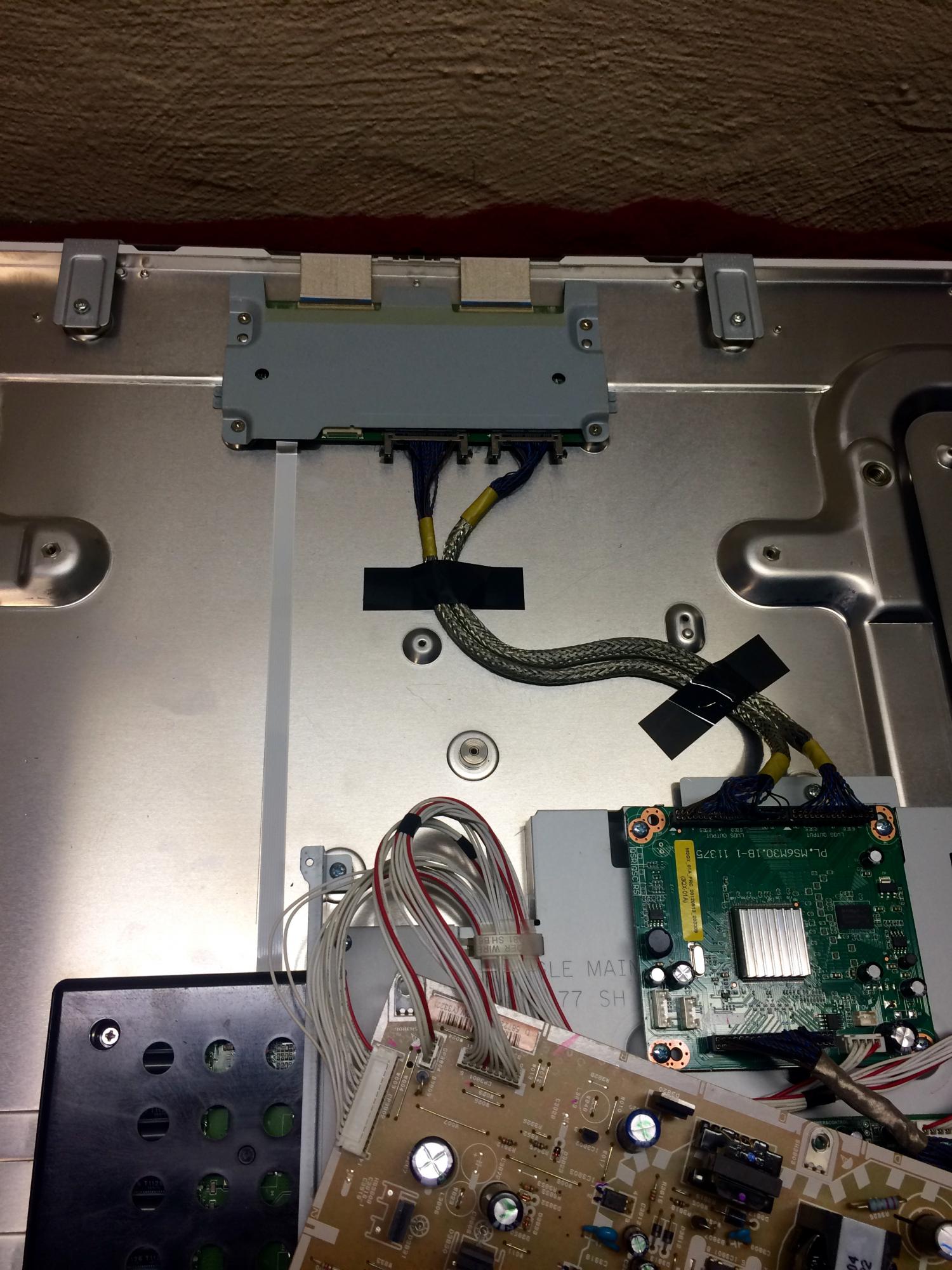

            That red and white cable hanging off, goes to the power/function buttons board

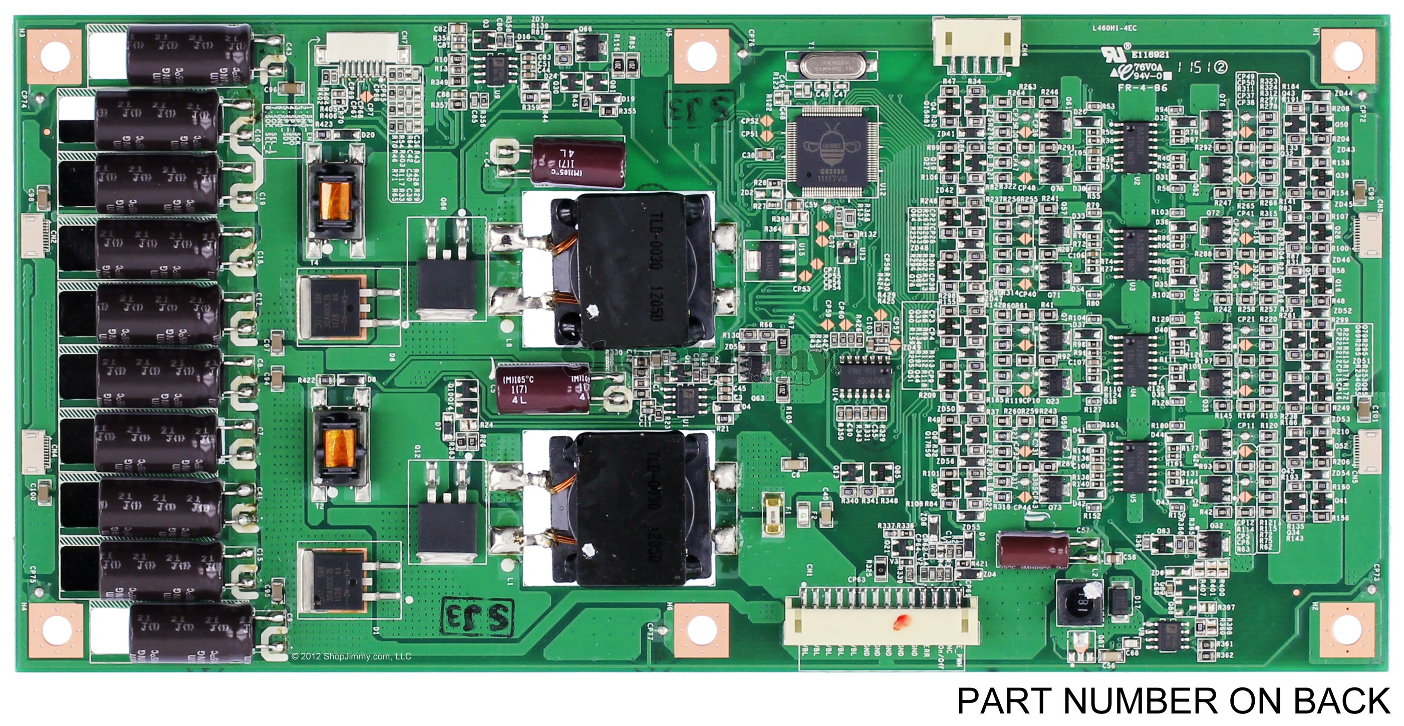

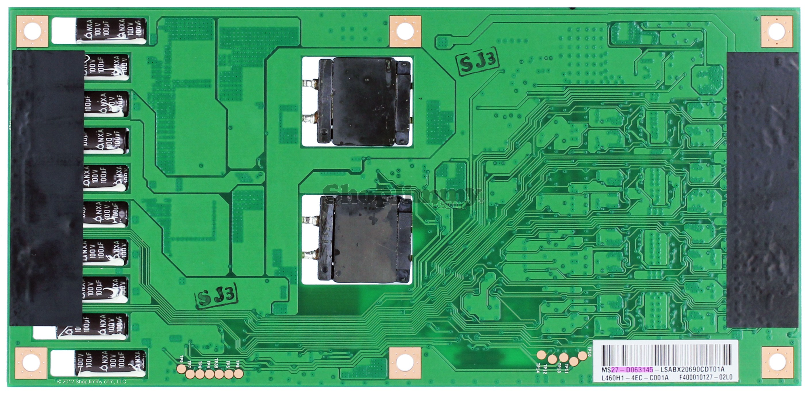

              There has to be a cable that goes to the LCD panel backlights, I cannot see it from the pictures.
              It must have LED driver board some where that I am not seeing.
              Orion/RCA 27-D063145 (L460H1-4EC) LED Driver.
              Pictures provided by shopjimmy.
              http://www.shopjimmy.com/cmo-27-d063145-led-driver.htm

                Yes, the LED driver board is under the power main boards. Look for the black cover in the pic that I moved the power board over
                  LED driver board connector CN1 has pin names for each pin, so check the DCV reading of each pin and make sure to put the pin names after each reading.

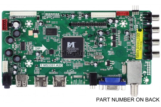

                    I have the same tv with the same problem. I hate when people just desert the thread they started so I will pickup where this one left off.

                          I did replace the main board but same issues. power supply or inverter board next?

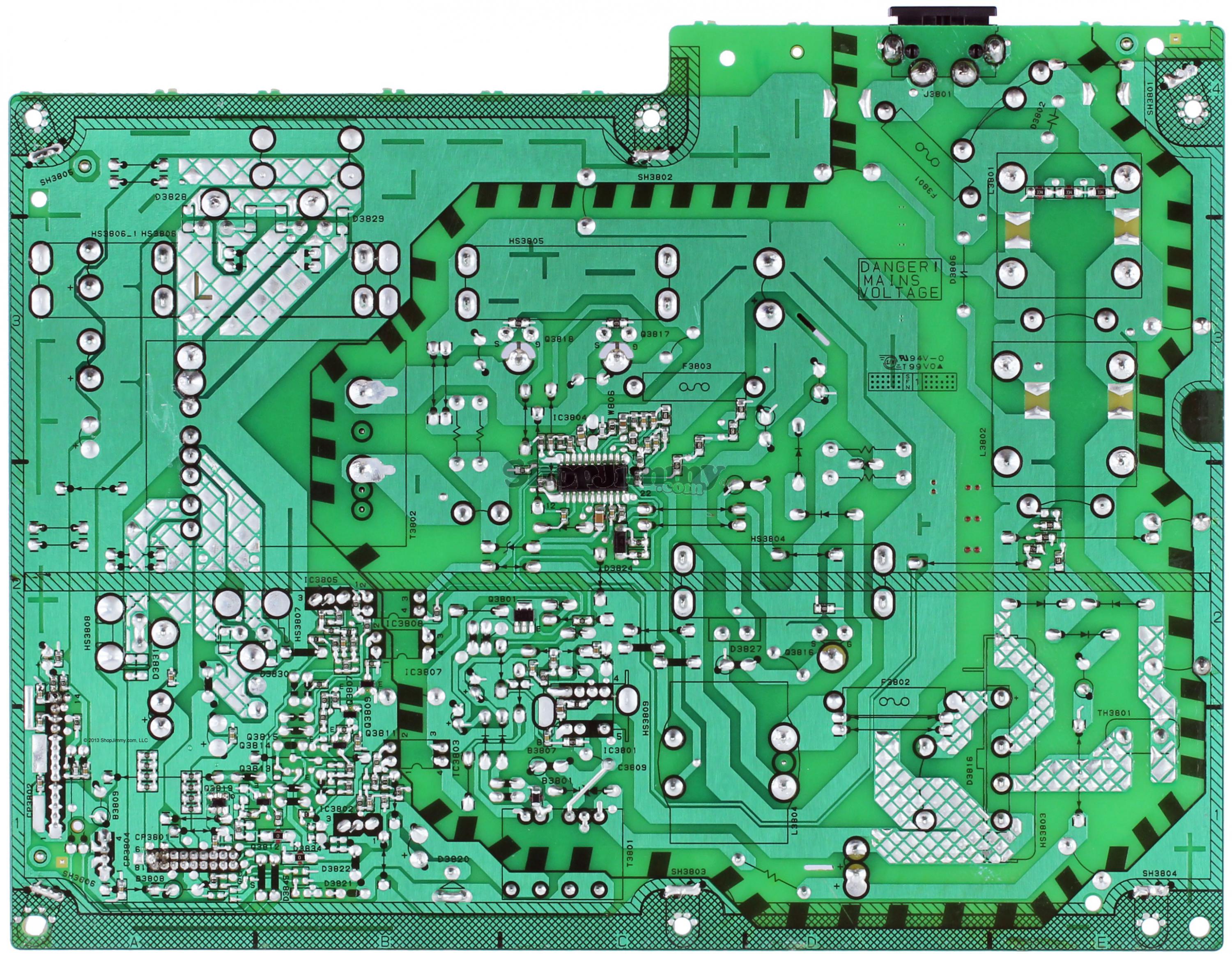

                                    Too bad the pins on the power supply board are not labeled.
                                    Power transformer T3802 is for the 12V and VBL supplies, it is driven by tow power MOSFETs Q3817, 3818.
                                    There is white fuse F3803 that supply the B+ to those two MOSFETs, the fuse is OK, right?
                                    You can also check the DCV between the two legs of the main filter cap C3846 to see if it has close to 400VDC when power switch is activated, if you do then you do have PS-ON signal from the main board, right now you do have BL-ON and DIMMING signals from the main board.
