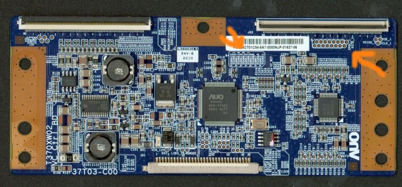

    I looked at the data sheet for the 2 AS34-G chips, its says TFT Reference driver but I dont know enough to understand what its actually doing, also forgot to say I measured all the VGamm Voltages as explained in this forum. Now on the T-conn card itself is only half the test points, I dont understand why, random as well 1,2,6,7 etc. But on the right driver board for panel is all of them, they measure in increments as another thread said they should and the left panel board has only half in order though but also appear to be normal.

      Are you sure you only see the random test points? could you provide some pictures using the attachment button? ( Advanced ).

        Re: Sony KDL-37V4000 Half Panel Too Bright!
        Hi mate, here is a pic off the web of my t conn, when I say random I dont mean all over the board I mean randomly misses some out, see the arrows, one points to the points and the other the labels.
        They go as follows:
        1,2,6,7,8,10,11,12,13,15,16,17,21,22.
        So misses a load out.
        Cheers.
            Well all the Vgam test points are along the top of the left panel board and right panel board and they both test the same either side and are correct as well, moving incrementally. Removing the 2 AS34-G chips, one on the left and one on the right does absolutely nothing to the picture. Still normal on left and brighter on the right.
            Any ideas anyone?
            Or is that the job of them to match the left and right brightness? I thought if removed then at least something would change.
