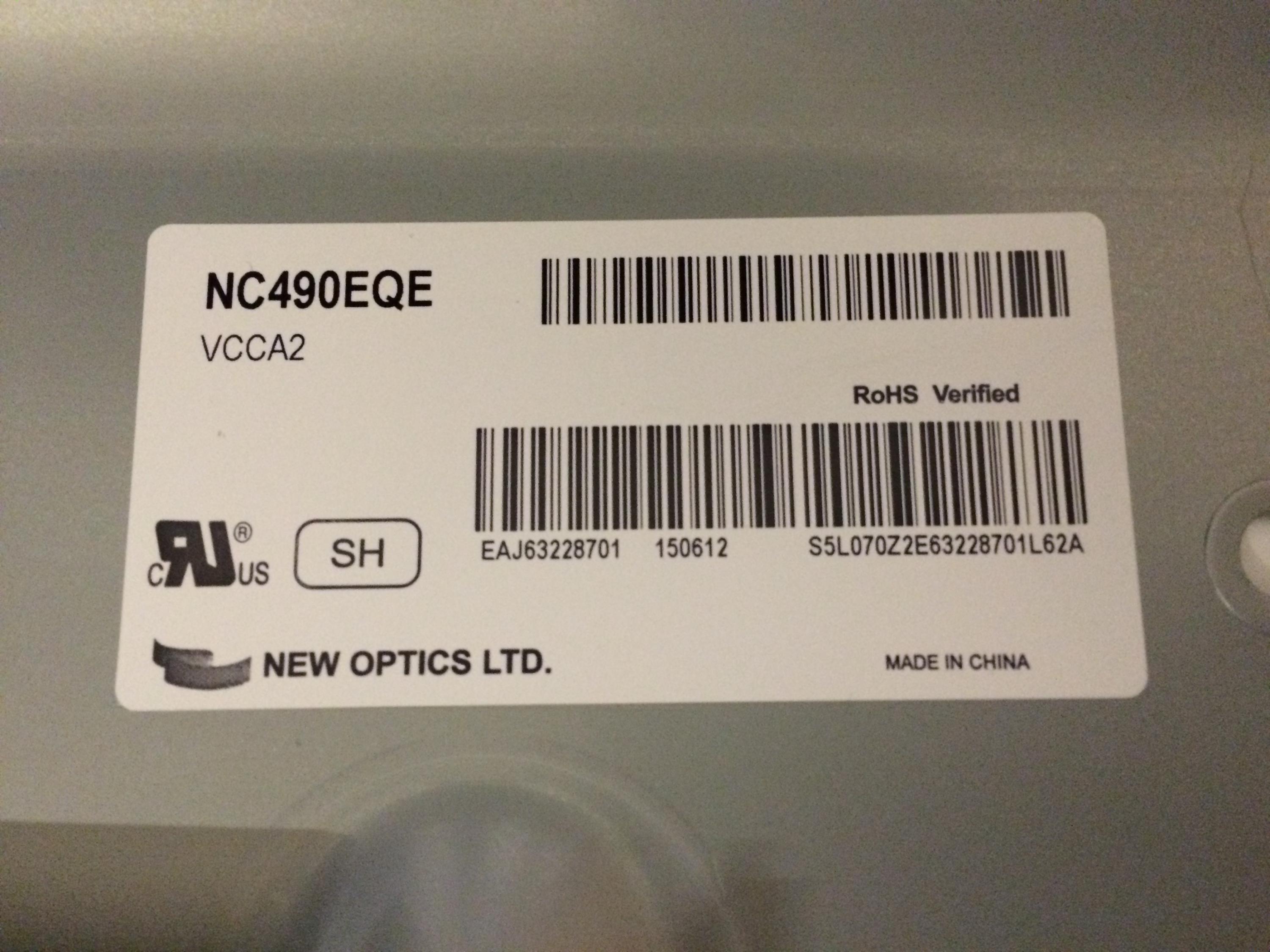

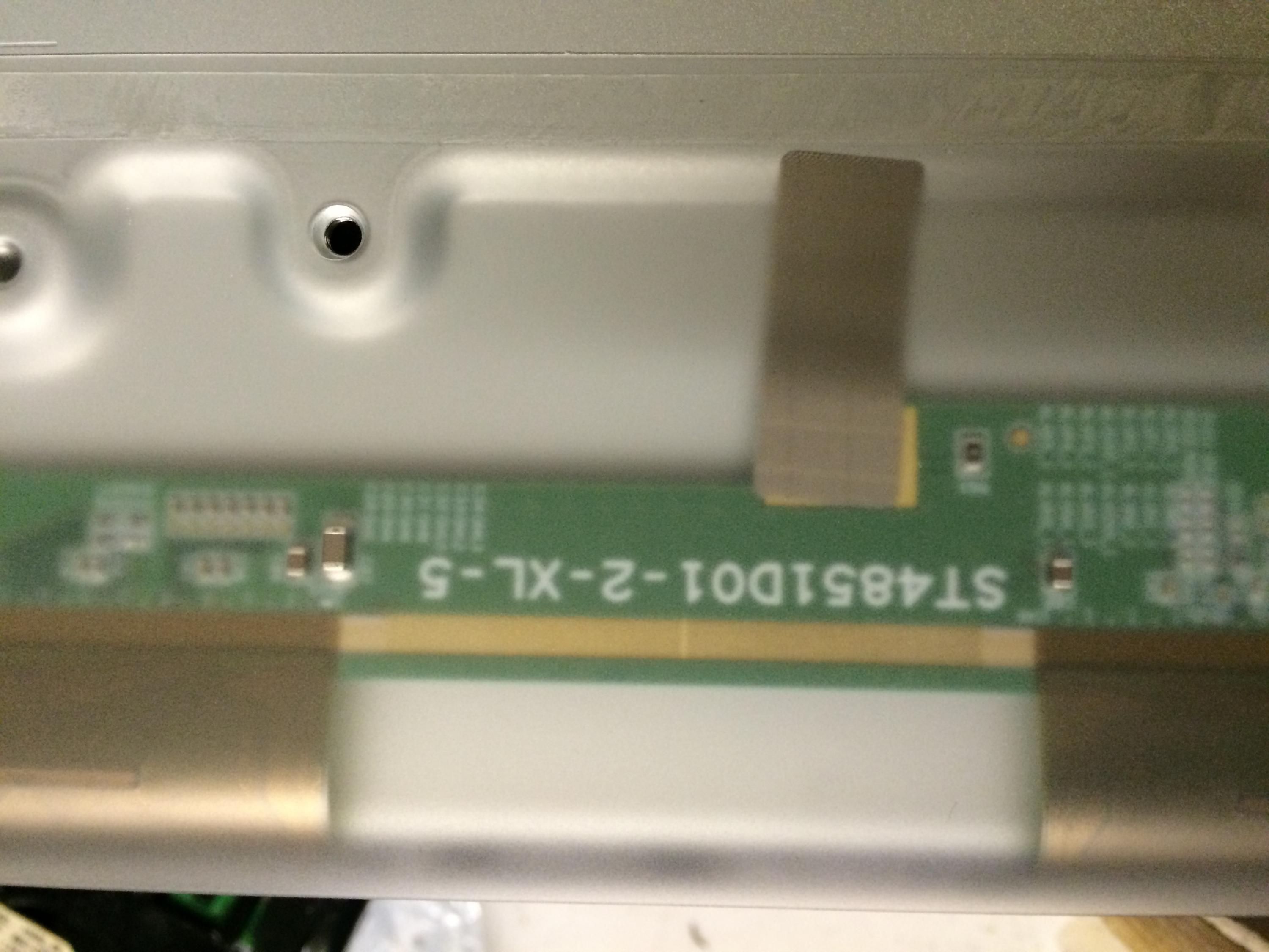

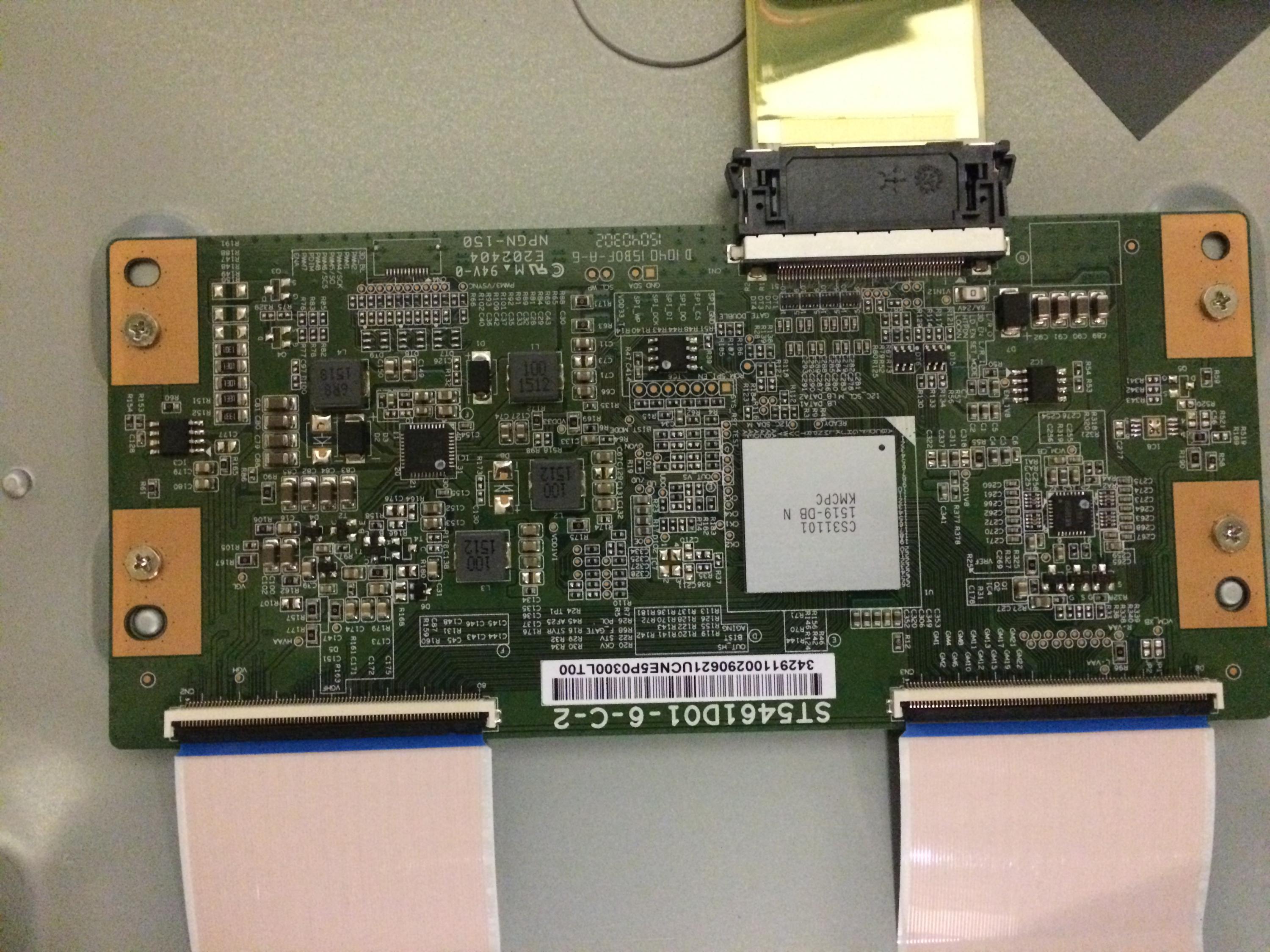

    Hi guys in need of Help and assistance. The Tv comes on fine but has no picture which would believe me to be the Tcon board in my experience. The difficulty I'm having is the Tcon board which is in my set is not the same as the ones listed on Ebay as i found out to my expense. The Tcon that is in my set only has numbers but no actual part number. I was told by a frien that the Tcon board can be found by what screen is in the Tv.......

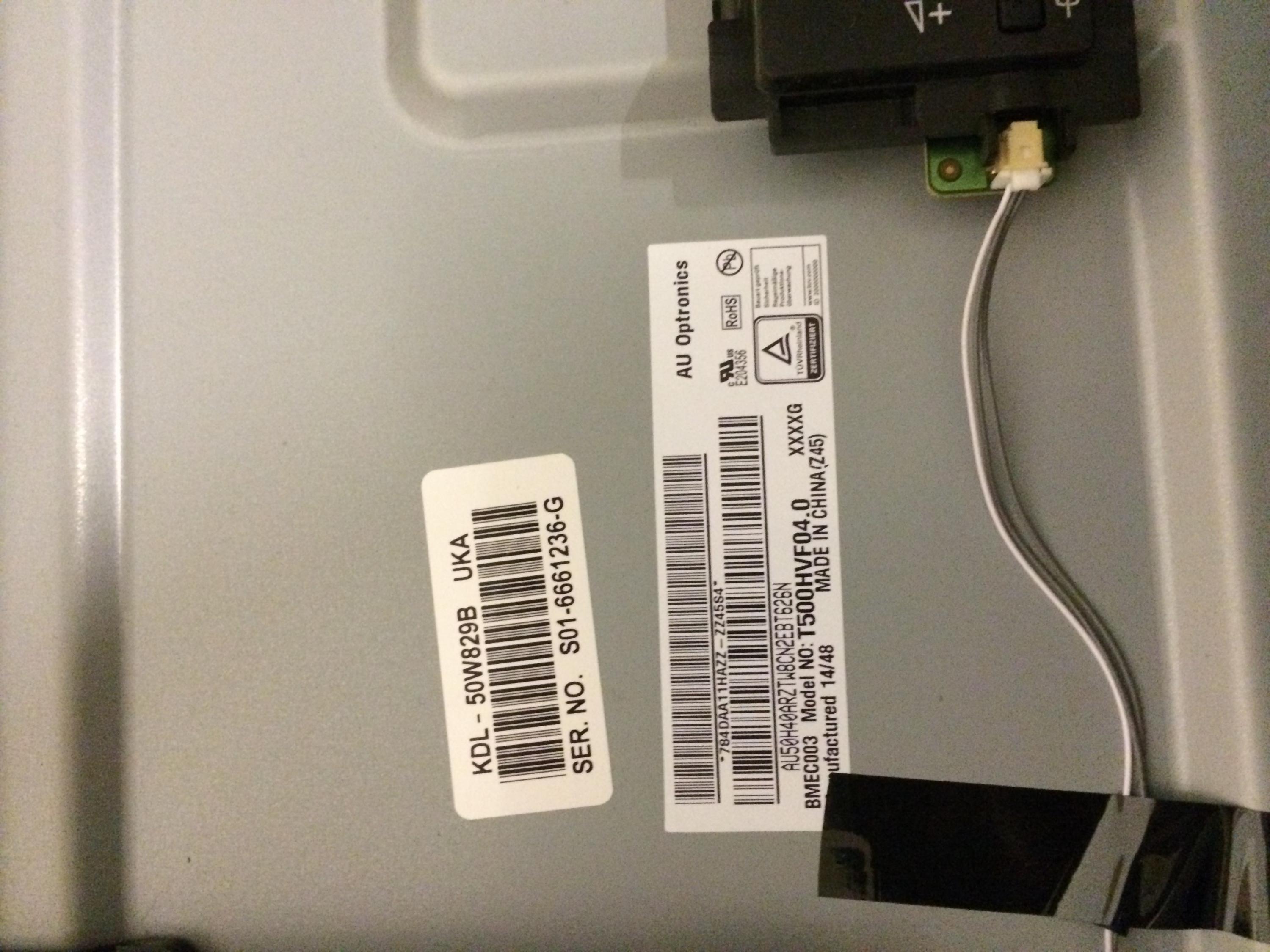

    Re: Lg 49uf770v no picture
    i put the picture of a sony screen by accident pls disregard this picture
          Did you check the DCV at both ends of the SMD fuse on the T-CON against chassis GND?
          So those pictures in post 1 are all wrong?
            i don't know how to do that, if there is any low voltages is there a way of repairing the tcon?
              So what kind of tools do you have?
              So pictures #5 on post 1 is the TC-ON board you have?
                yes thats correct budm picture 5 is the tcon. I have a multi metre
                  hi put your multi meter on dc volts with the tv turned on place the black probe on the metal tv chassis and touch the red probe to each side of the white fuse on the tcon board write down the voltages thanks, just be carfull you dont slip taking voltages as you dont want to short anything out!
                    wheres the white fuse? Do you mean each side of where the tcon connector goes in?
                      where the t con connetor socket is just above it theres a little white fuse has a o on it just touch the red probe tip to each side of it and take voltage reading.
                          Mine had the wrong mainbaord fitted
                            Not to start anything... but how did you get to that conclusion?
                              Because the sticker on the board said 55uf770v and mine was a 49"
                                So the TV must have never worked out of the box?
                                  Thats correct
                                    some tvs though you can alter the panel size in the service menu so the mainboard may of worked then got faulty or maybe a previous owner swopped it out, the main thing is the set is working now so alls good.
