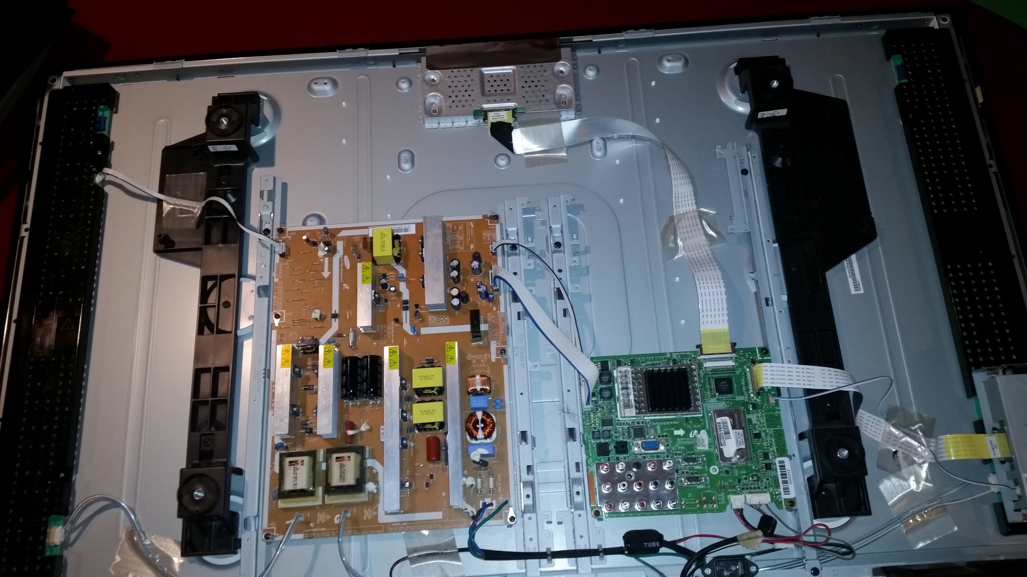

    Re: samsung ln46a540p2fxza red light blinking
    Please up load good clear pictures of the whole back side of the TV so we can see how all the boards are connected together, then the pictures of the power supply board. BN44-??????

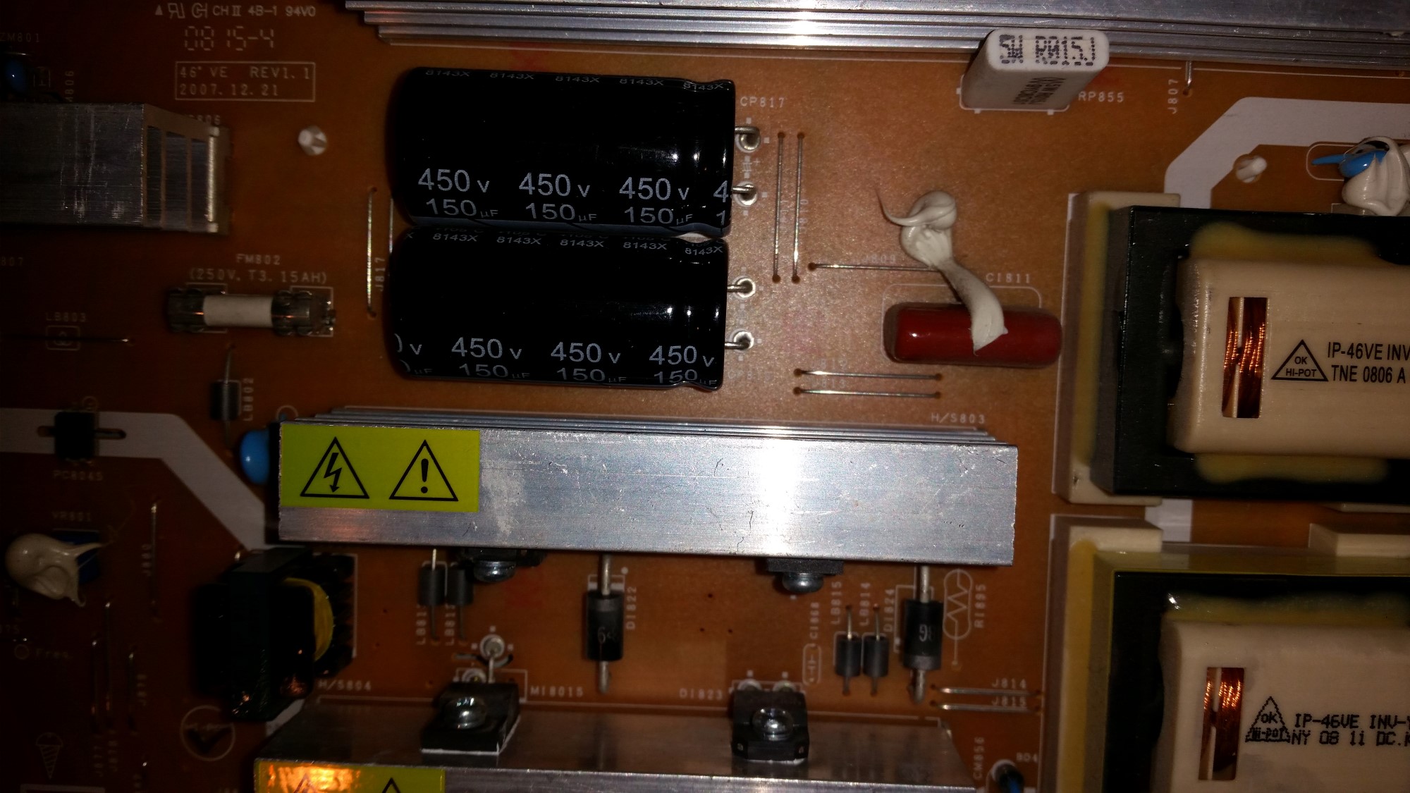

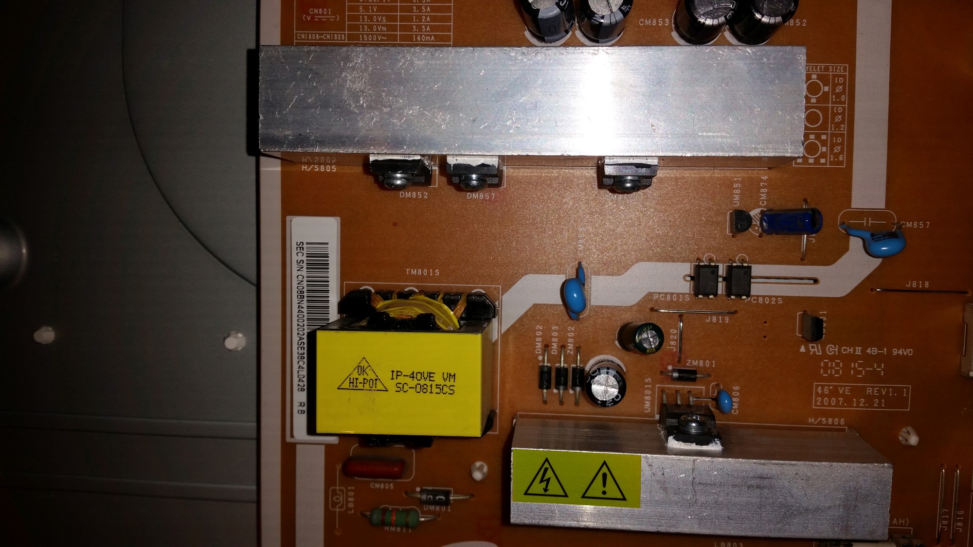

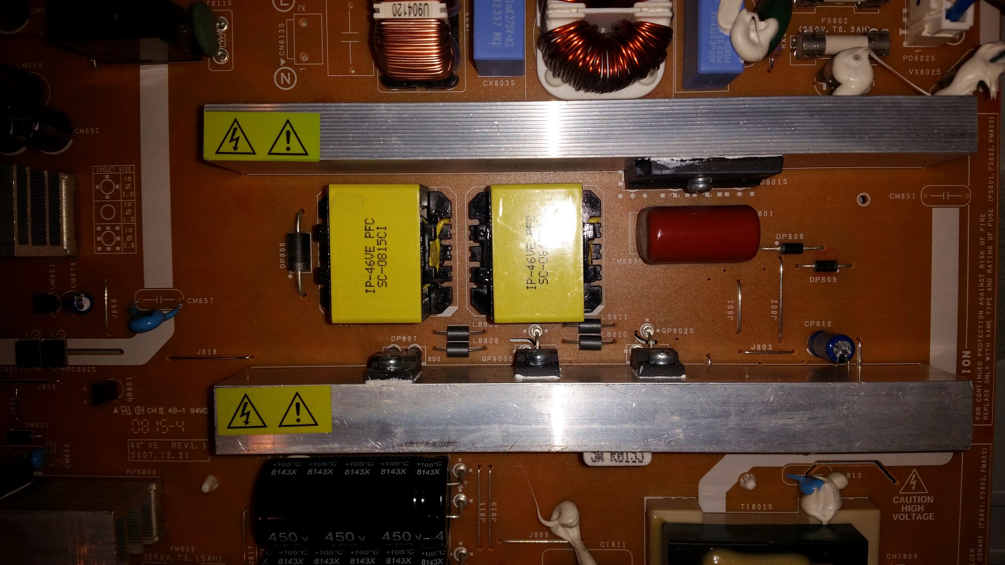

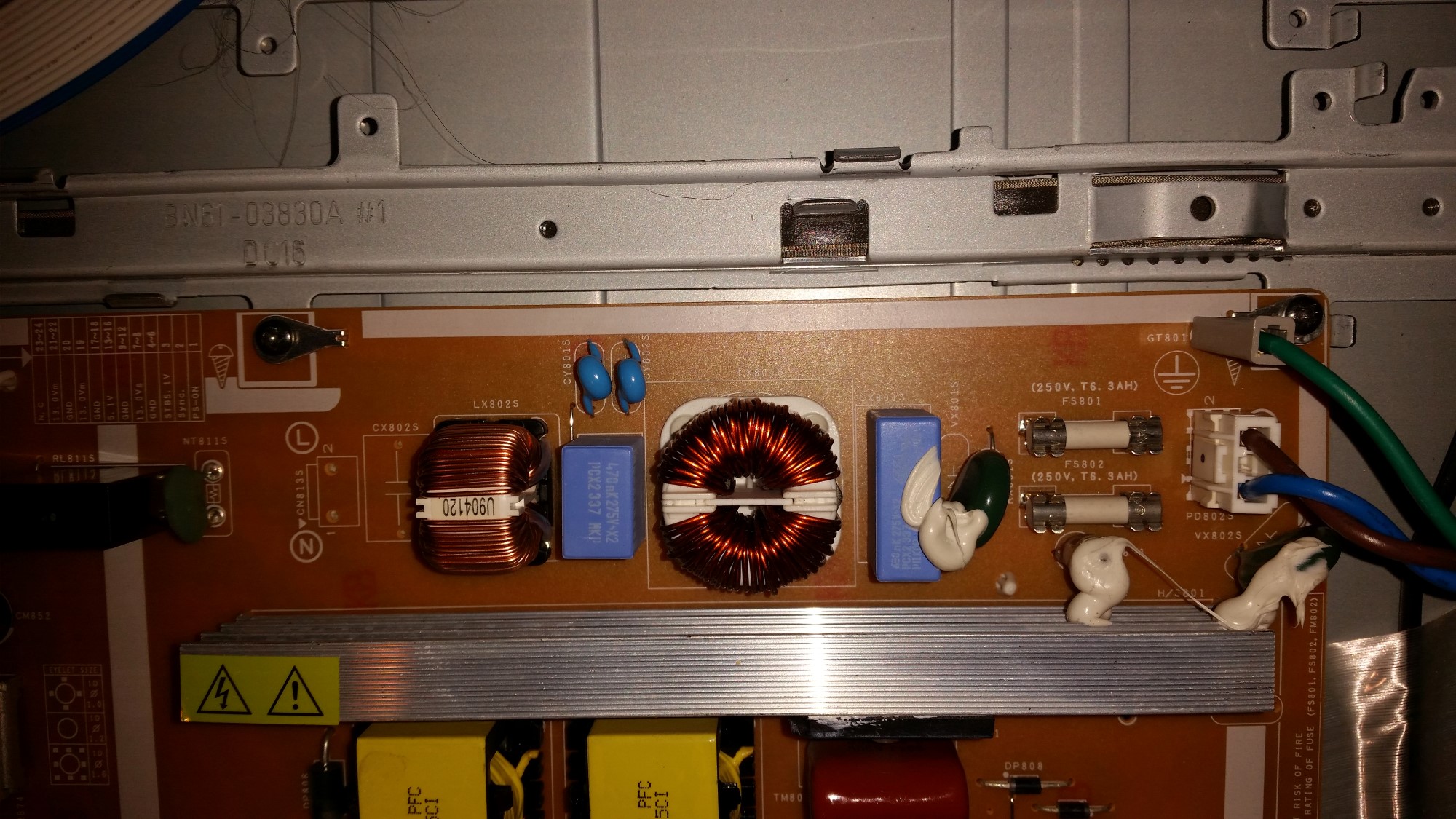

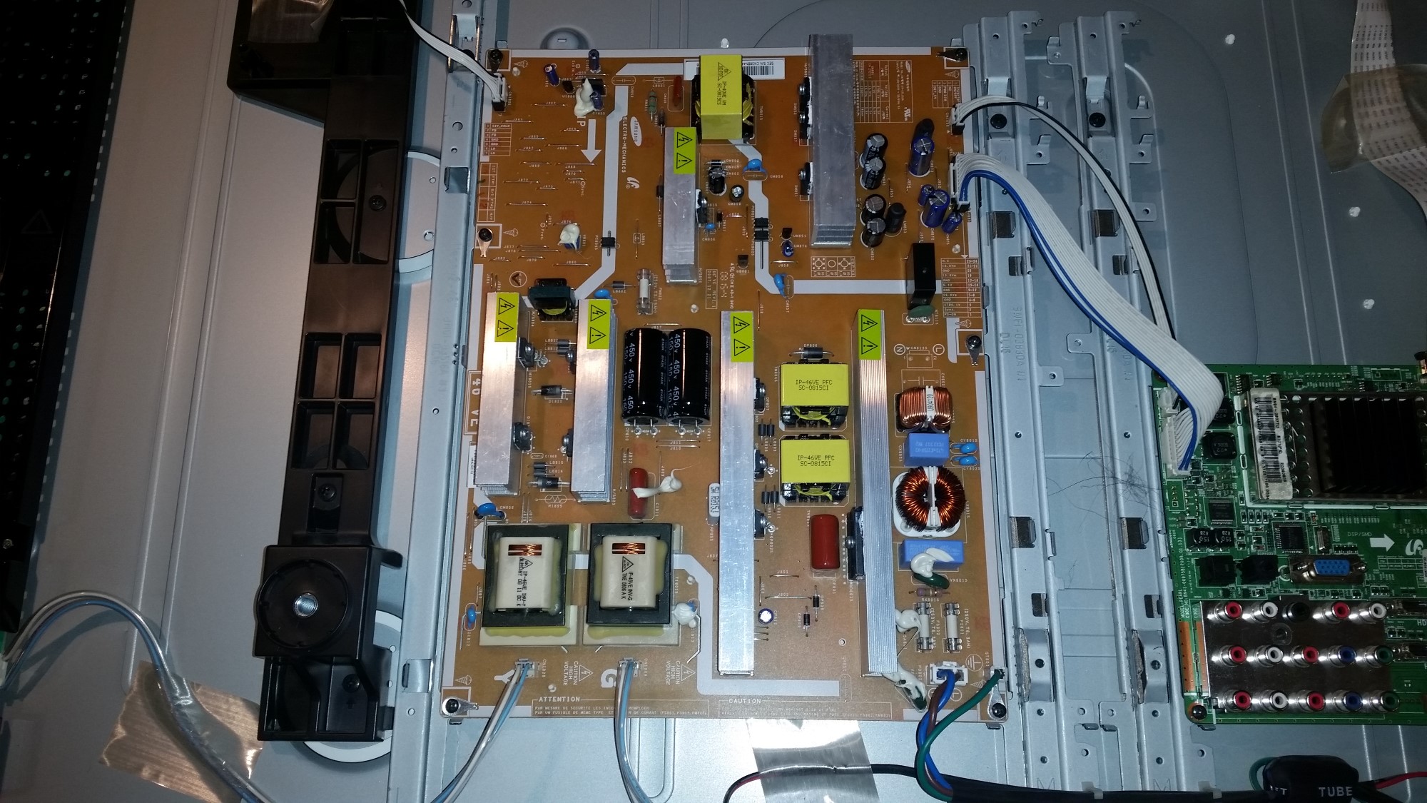

      here are picture of inside the TV let me know if you need more

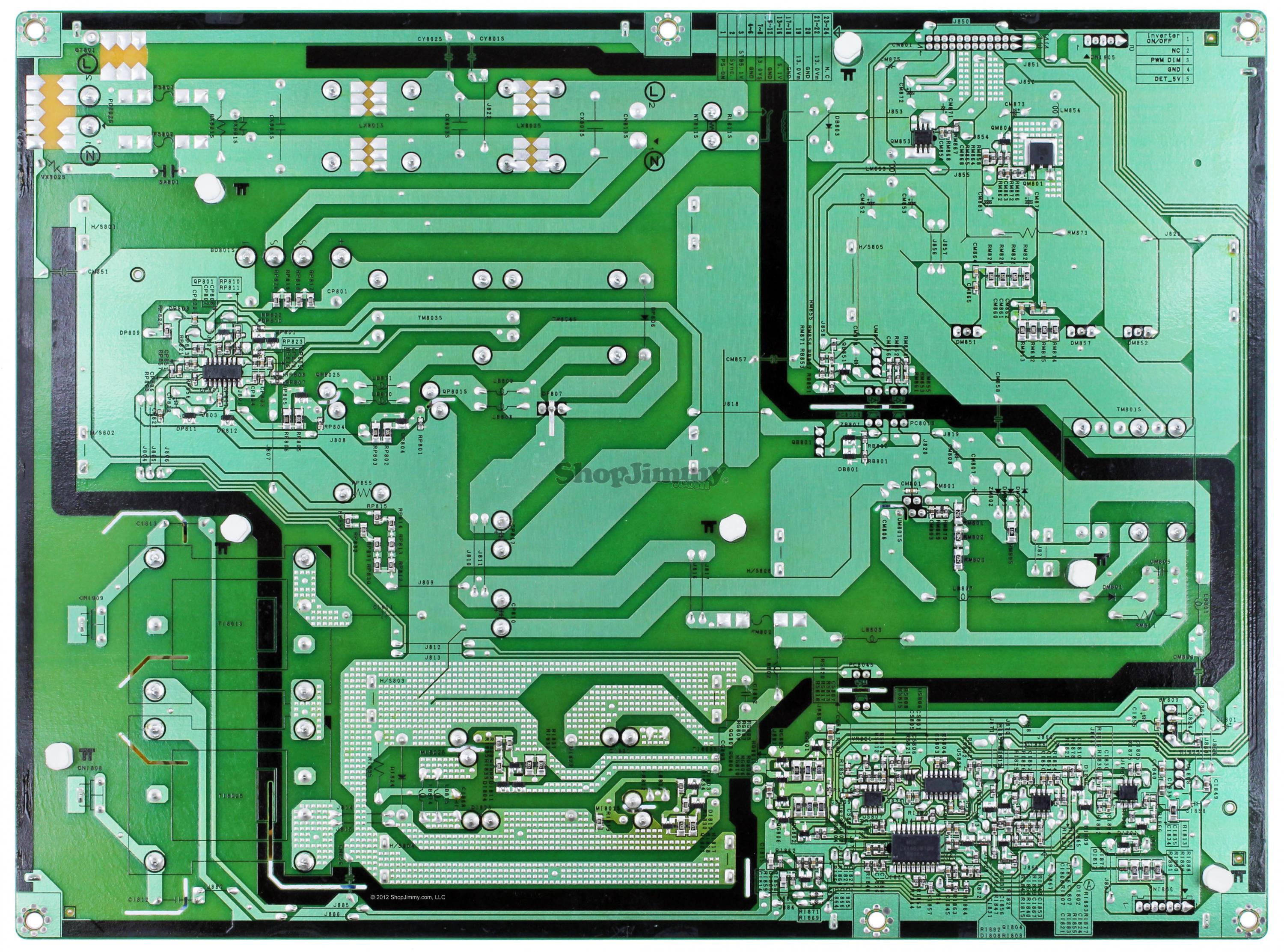

        So the power supply-Inverter board combo is P/N BN44-00202A.
        Here is the diagram.
        Pictures provided by SHOPJIMMY.
        http://www.shopjimmy.com/samsung-bn4...er-supply.htm#
        The relay coil is running of the 5.1V STANDBY POWER SUPPLY.
        The black connectors on the power supply board have the labels to tell you what each pins are, you need to report the DCV reading of each pin, MAKE SURE to put the PIN NAME for each pin so we can see what are missing.

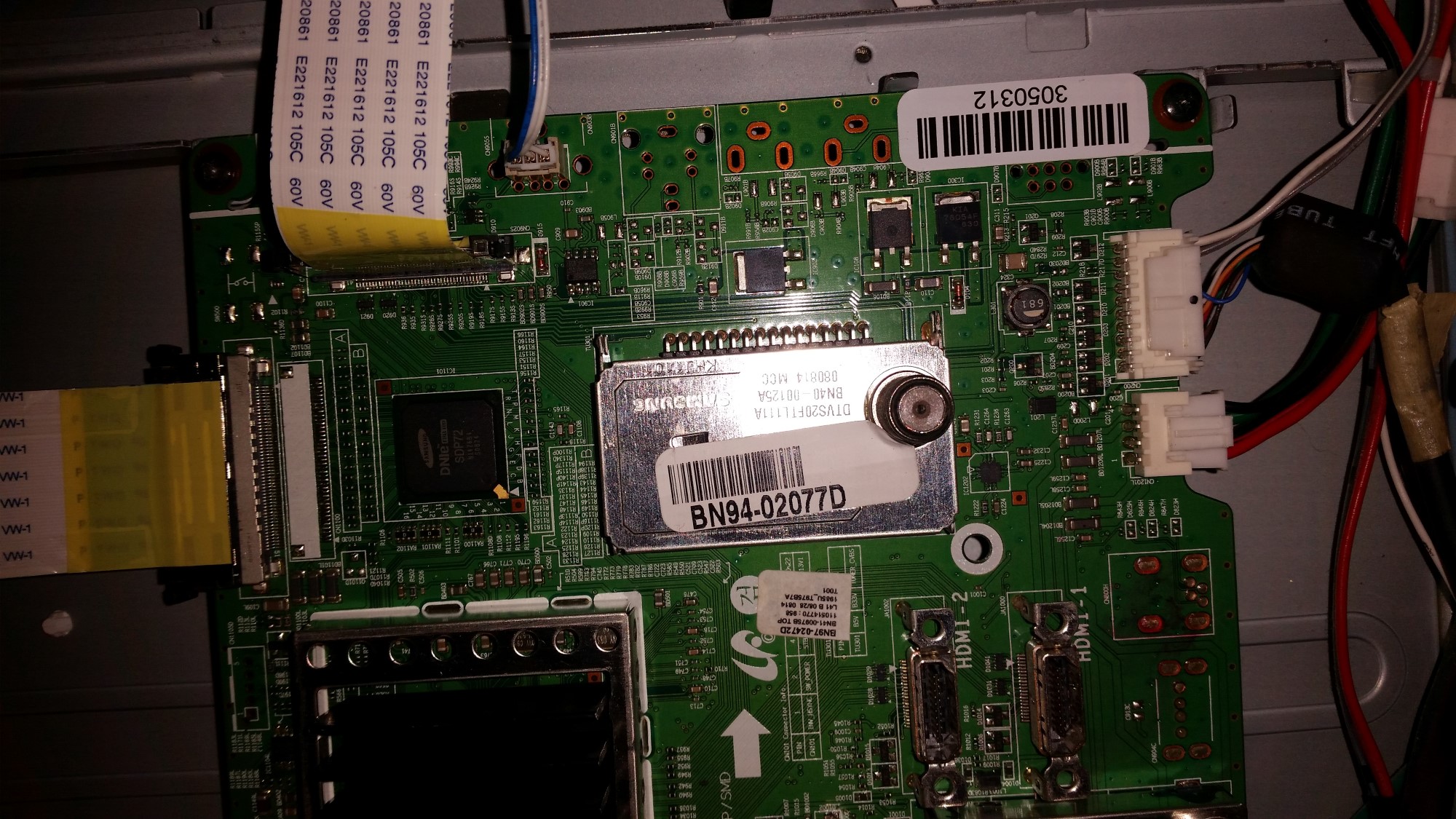

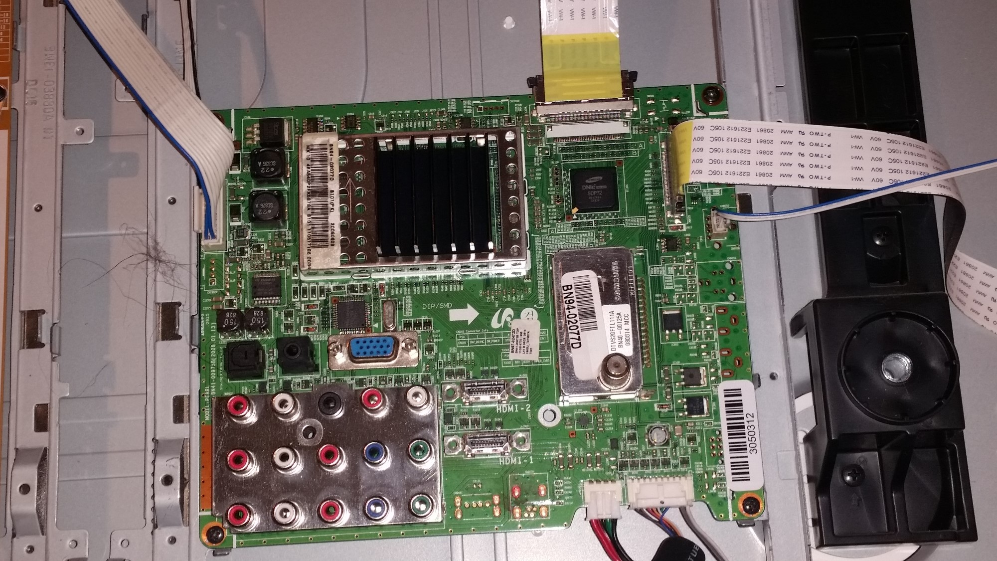

                    here are close up shorts of both boards
                    thanks
                                http://www.shopjimmy.com/catalogsear...sung+ln46a540p
                                Which one of these is your main board? You may have the bad C102 SMD cap bad on the main board.
                                    For the main board I see a part number of bn94-02077d
