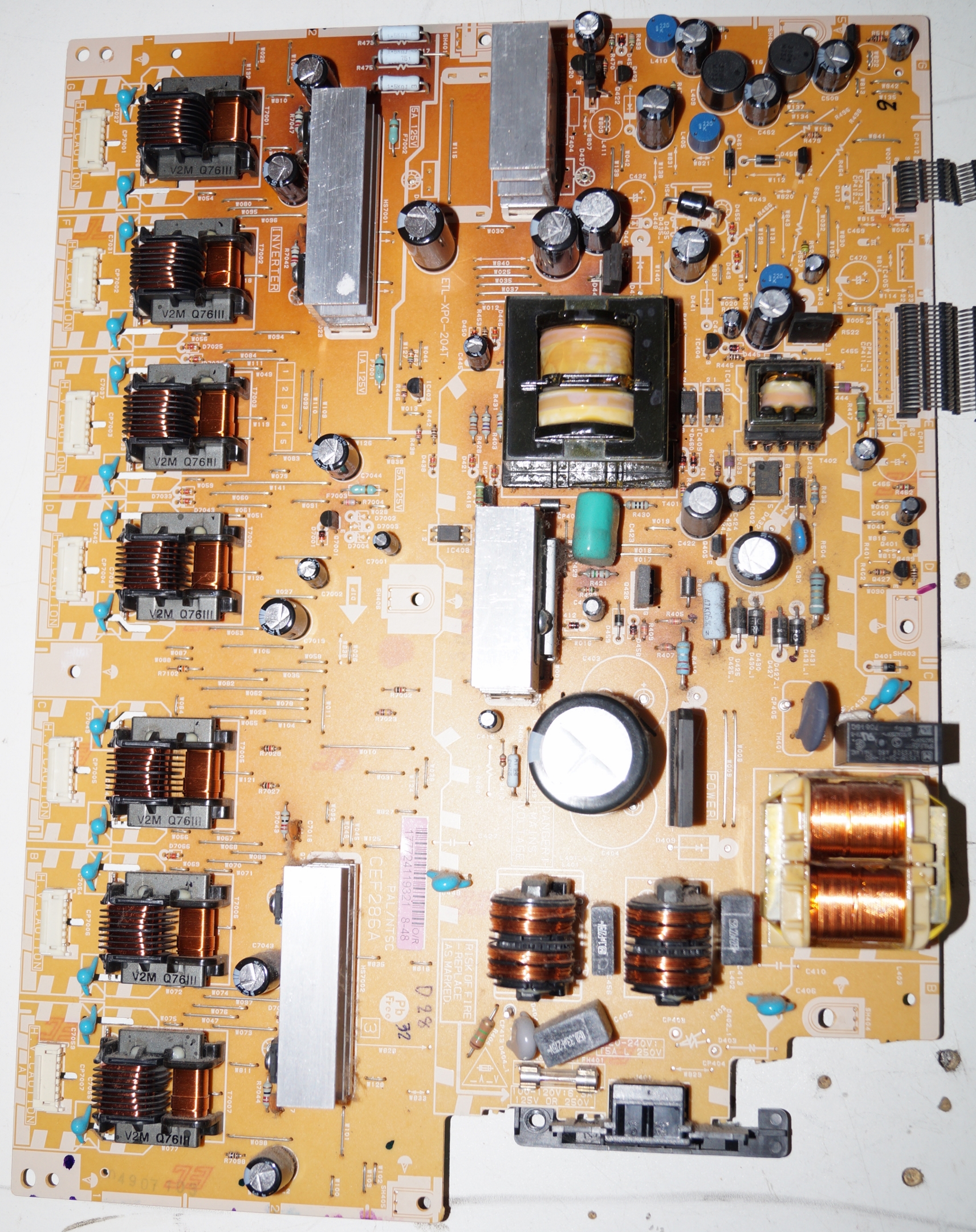

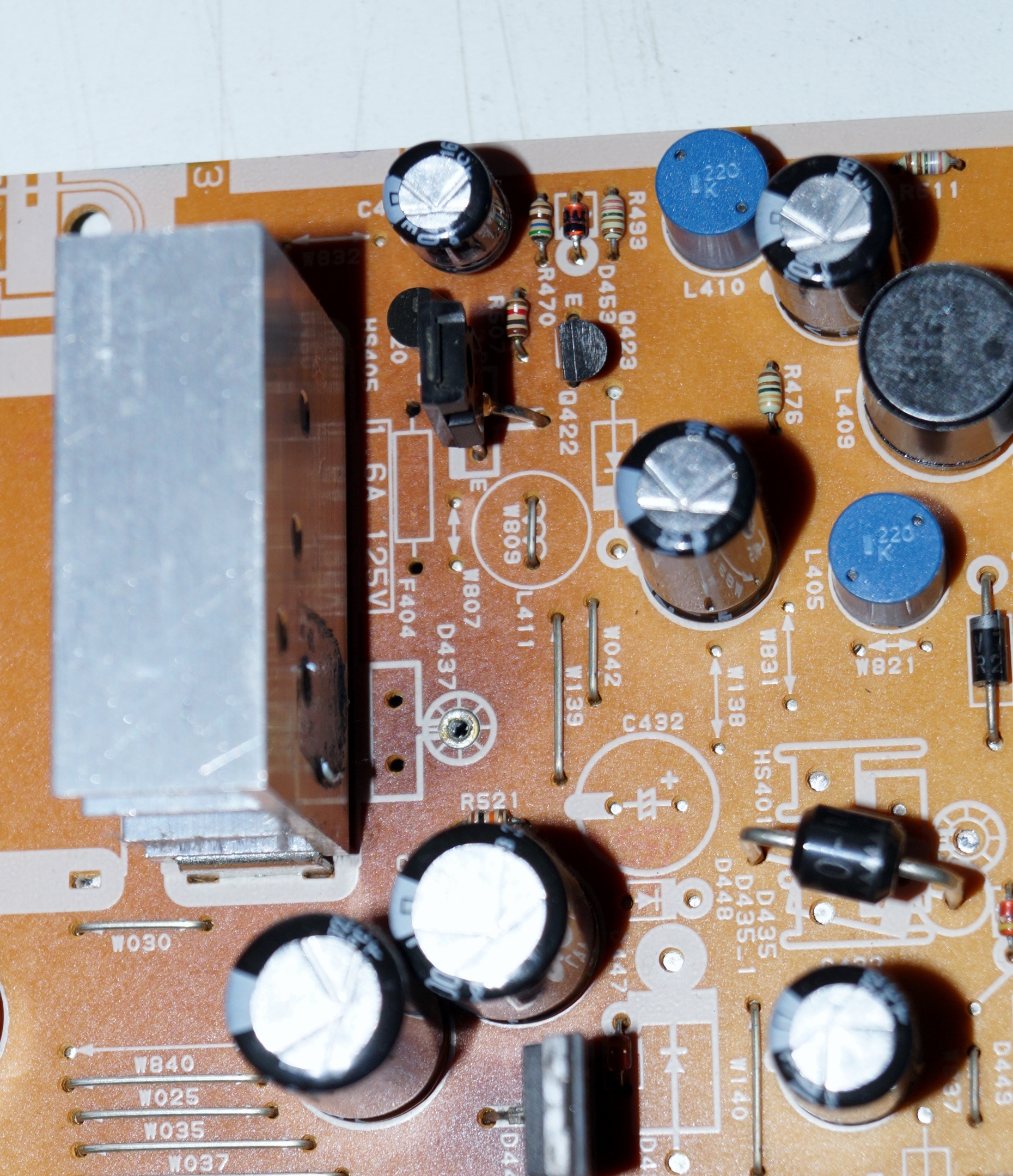

    Got this LCD which powers up from standbye, power indicator turns to green but get no picture and no backlight. Once powered up cant turn it off either.
    Ive found a 1.6a 125v fuse that is blown near the top middle heatsink. Ive tested the 3 transistors around it which all check out.
    I'm struggling a bit testing this schotty barrier diode attached to the heatsink(as not done before)
    yg862c10
    It is only reading one way in diode mode but only reading 0.233v
    Black probe in on middle pin and red to either side L / R pins 0.233v
    From other diodes I have tested its usually between 4 and 6 is good, but not sure if this 0.233v with this particular type of diode is low.

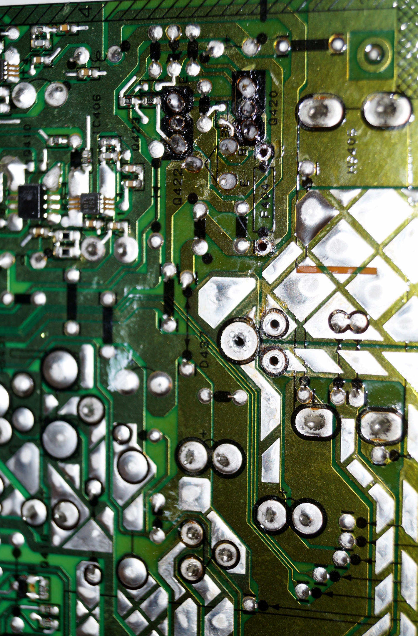

        can you upload a picture of the bottom of the board that the fuse has blown on thanks
        • mikay786
          • Aug 2014
          • 765
          Re: Orion 32" LCD
          yep one sec

            What I have found is another identical diode further down, so can measure that to see how they compare.
            • mikay786
              • Aug 2014
              • 765
              Re: Orion 32" LCD
              Yea they both measure the same so probably good
              • mikay786
                • Aug 2014
                • 765
                Re: Orion 32" LCD
                cant see anything else around that could have blown the fuse, little diode uptop is good too.
                Worth replacing fuse and just testing?
                • mikay786
                  • Aug 2014
                  • 765
                  Re: Orion 32" LCD
                  Looks like it was just the fuse
                  Ive just used a regular 1.6a 250v Quick Blow glass cartridge fuse (Soldered some legs to it)
                  The specs on the board are 1.6a 125v (not sure if quick / slow / delay) etc
                  Its seems to be working fine, is that alright as a long term solution?
