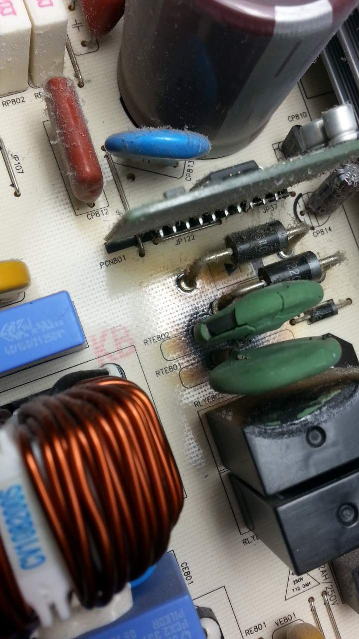

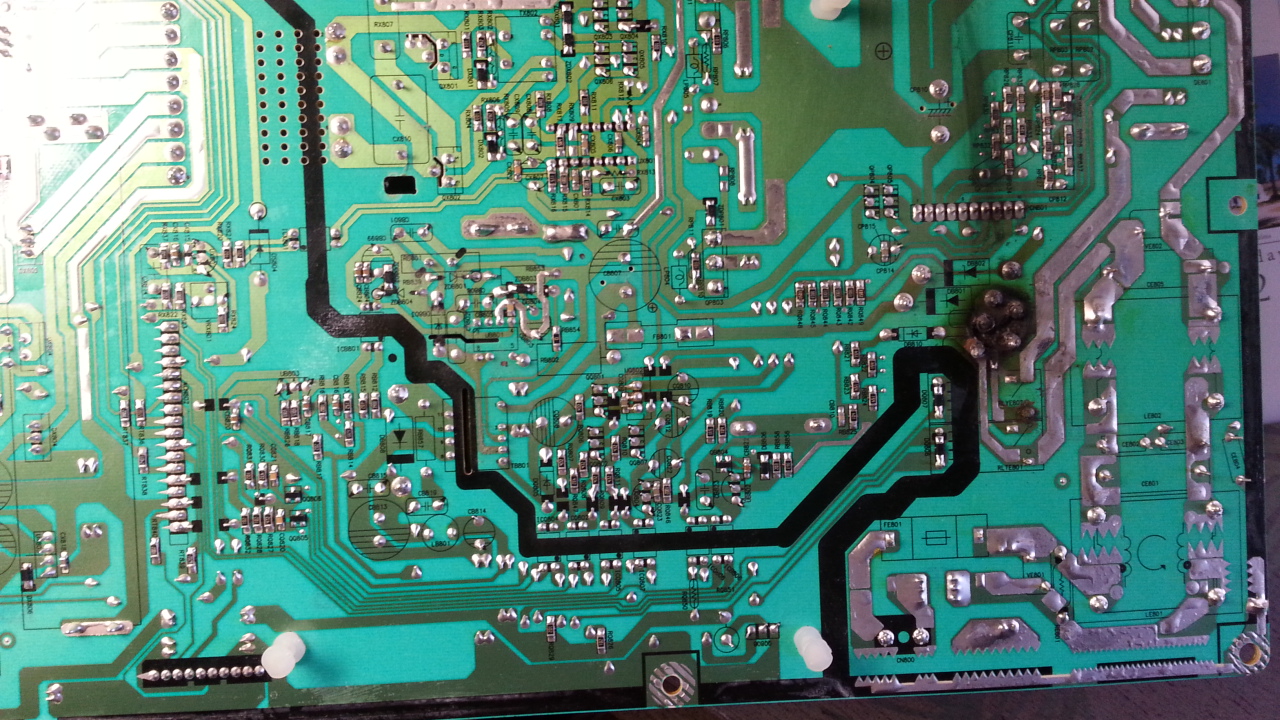

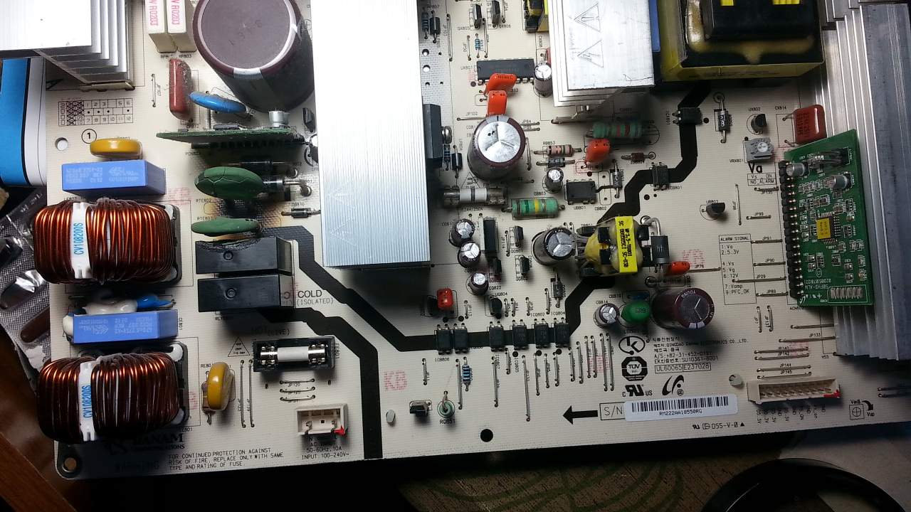

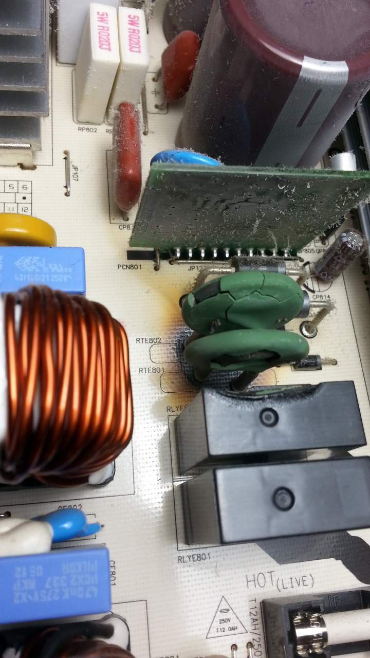

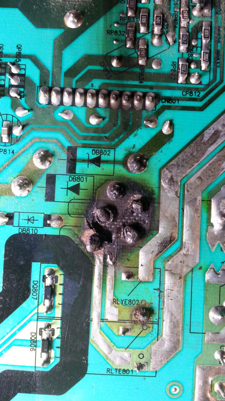

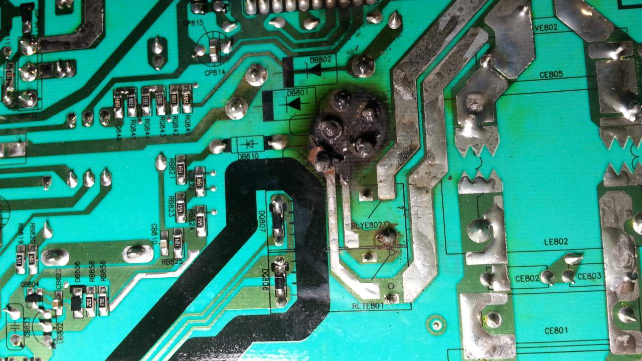

    BN44-00222A board with burnt inrush current limiters
    Hello!
    I decided to open a "new" thread with old issue.
    BN44-00222A board with burnt RTE 801 and 802 and poorly soldered
    RLYE 801 and 802. The board was burnt so much that it lost traces.
    My question is where to put new RTE 801 and 802 and use some JPs perhaps with insulation on them and connect to existing board traces.
    Also, first I have to solder relays properly to a board. Before drilling new holes maybe it is worth to simulate use of new RTE 801 and 802 away from a board and see if the whole set would work. I attach some pictures to let you see the damage done by high temperature.
    Thanks for a suggestions how to fix it and what/where parts to buy .
