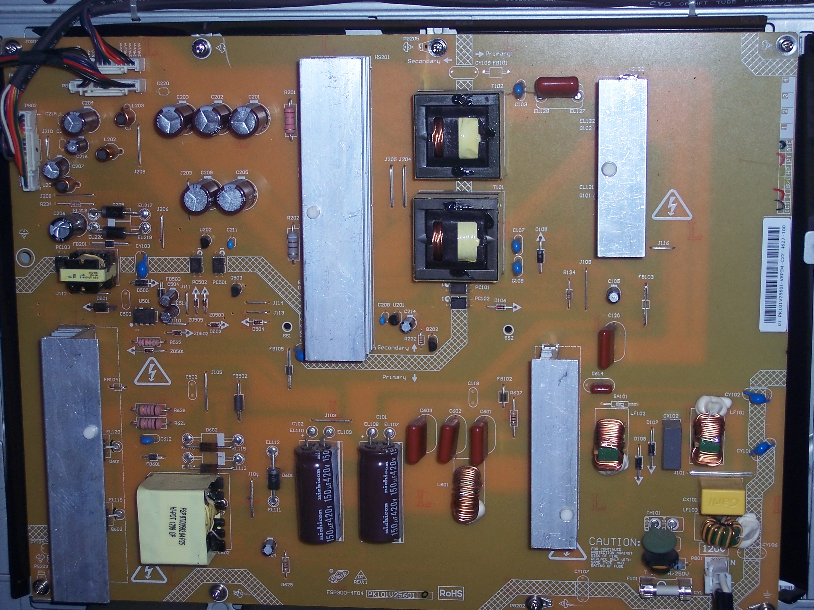

    I brought it home and determined it was the power supply. There was a mosfet blown out (EL122, Q102). There was also a spot on the back of the power board that goes from FB103 to Q101 that is burnt out. On top of this C112 and Q106 are bad as well. I replaced the power board and the TV now turns on. I am wondering if it had a power surge or lightning hit.

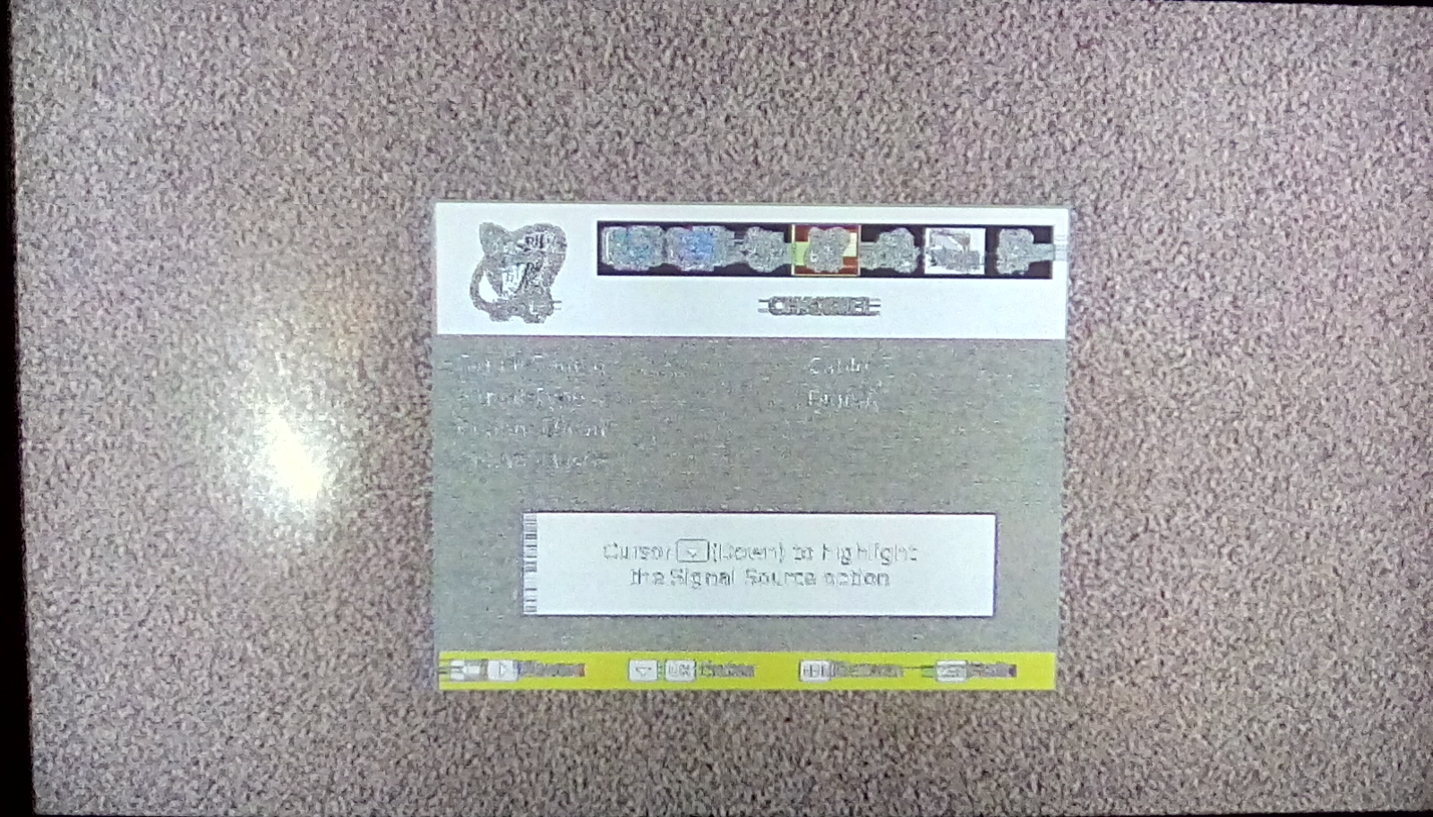

    The problem I am seeing now it a screen that is unreadable, even the menu is (see attached picture). This leads me to believe a bad LCD panel. Then there is also the volume, I have hooked the TV up to our cable box and coax and get the same sound. The sound coming out isn't very loud and it is all static sounding, drowning out the voices.

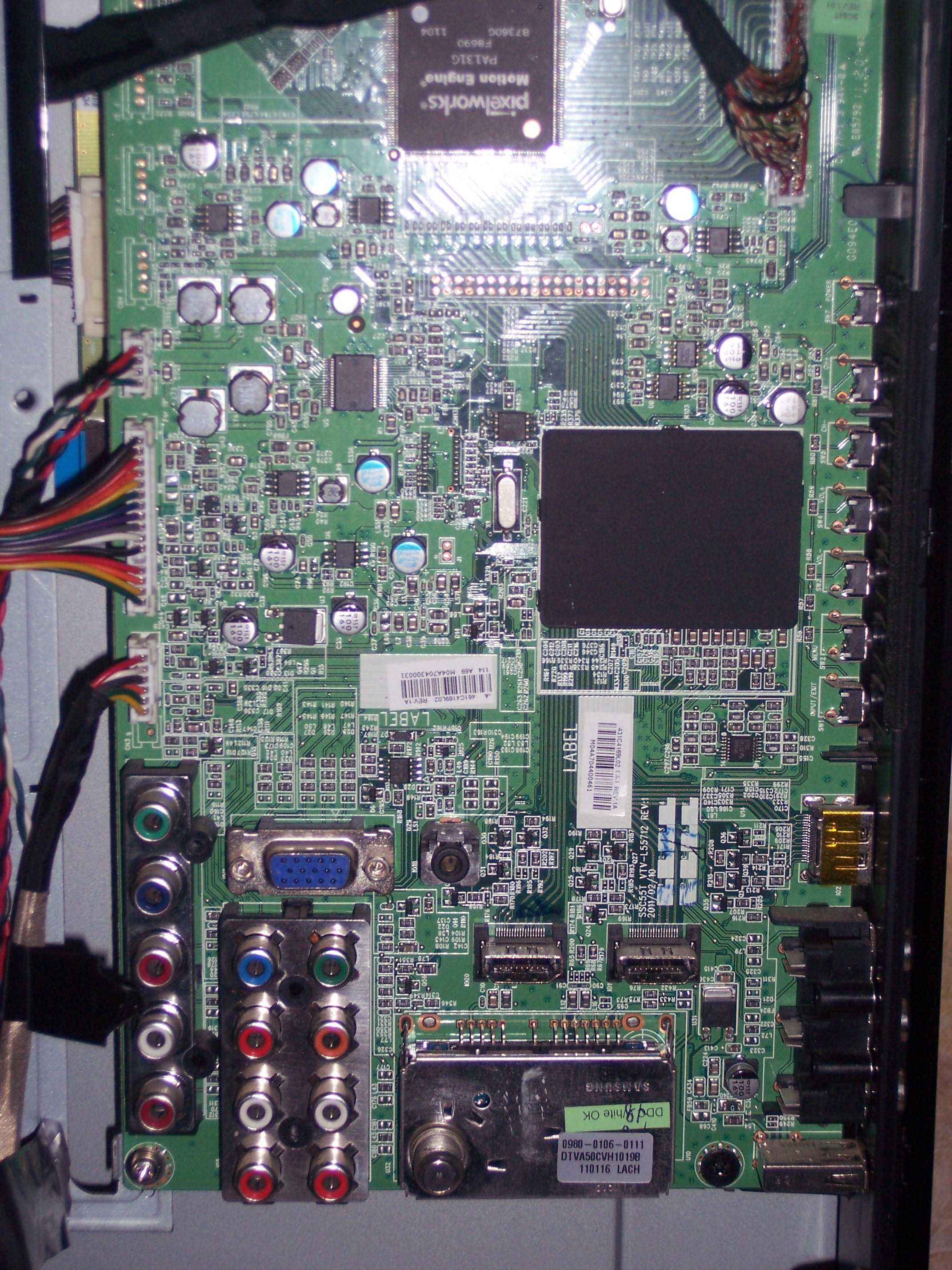

    Due to the problem with both the picture and sound I am now leaning towards the main board. I am looking for some assistance in determining if this is the case.

    The problem I have is I don't understand schematics enough to know where to check the mainboard. I am looking for some assistance on where to look for both sound and video output.
    I haven't found similar problems with both sound and video being scratchy. I have seen some with similar pictures and it being either the TCON or bad panel. This wouldn't explain the sound or the fact that there are no horizontal or vertical lines.

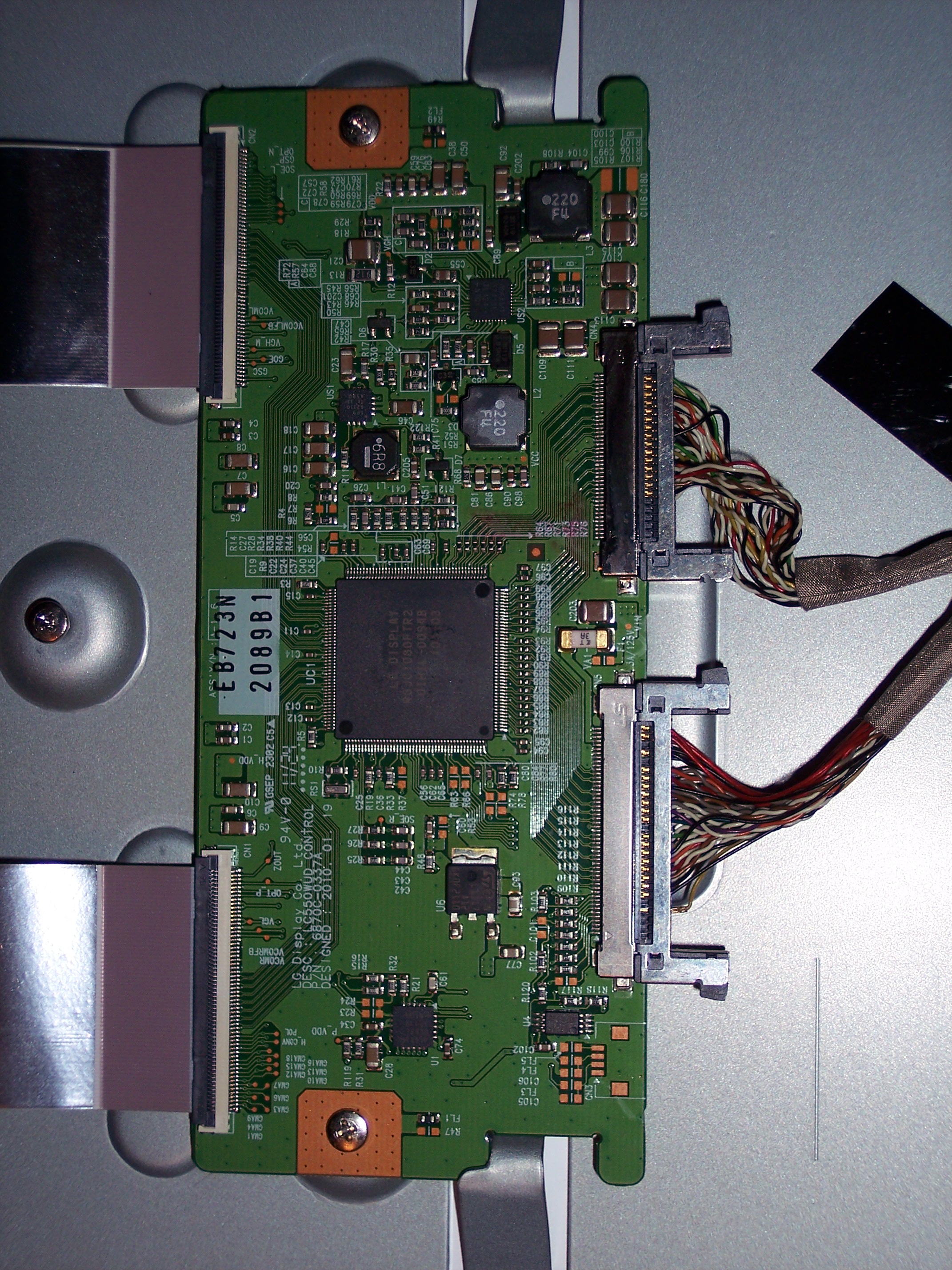

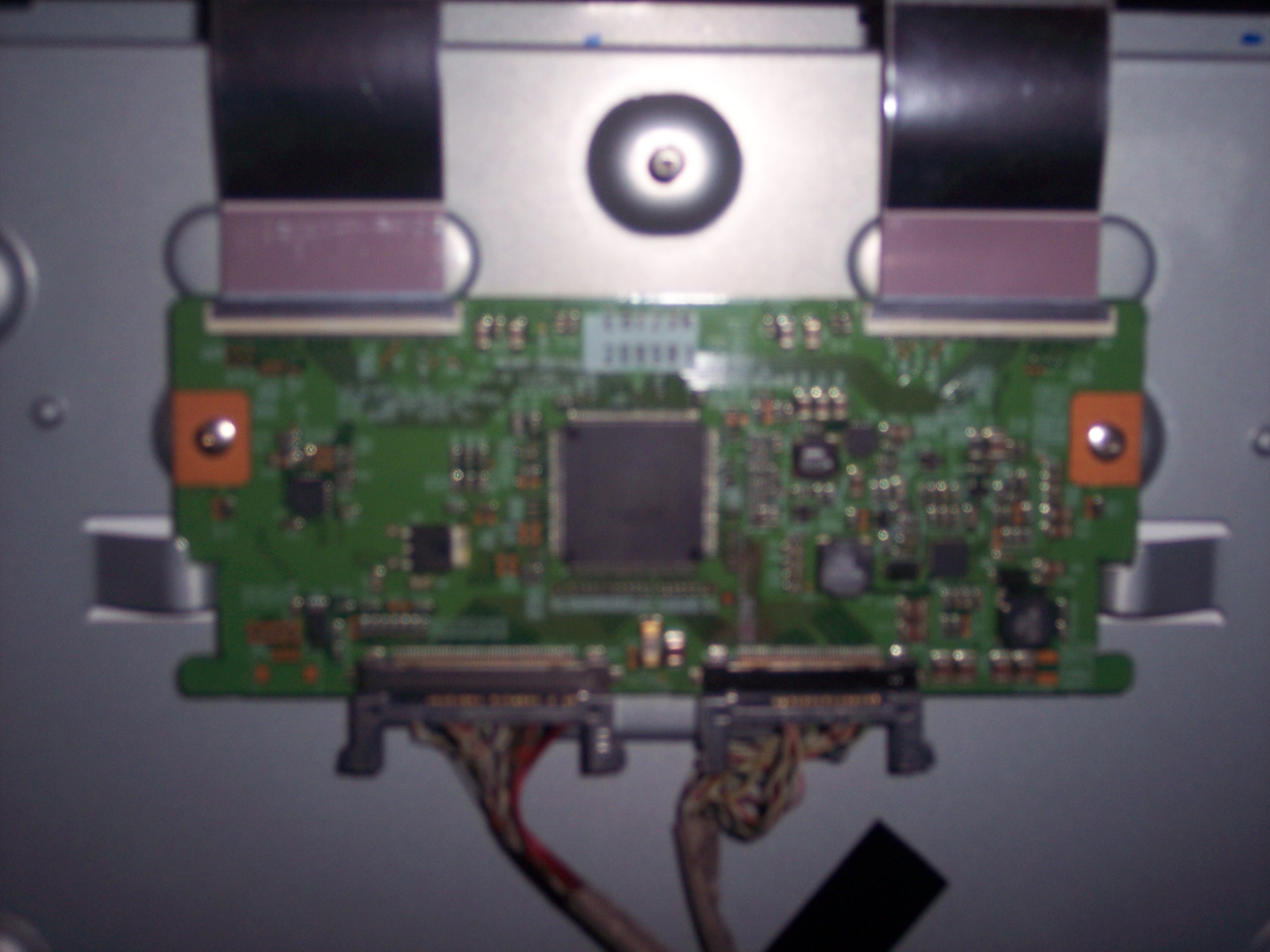

      For some reason the pictures for the TCON are not coming out clear. I have taken about 20 different ones of it and all are the same. I have disconnected one side at a time, when one side is disconnected there is no picture at all.

        Can we get good focus pictures of the T-CON board? The third picture.

          Thanks for the response, and I was finally able to get a clear picture of the TCON. For some reason my camera would not focus on this board, and 40 pictures later this is what we have.
            Re: Sanyo DP55441 Strange Picture and Sound
            OK, please check the dcv at those test points GMA1~18 on the T-CON board.

                You also indicate static sounding, that will be main board problem.
                Did you already try reseating the cables/connectors, etc.
                No sign of damages on the main board at all?

                  There is no visible damage that I can see on the main board. I bought a can of contact cleaner and sprayed all the cables. I was thinking main board as well due to the sound issue.

                    I am looking at getting a mainboard for this TV. The mainboard on this TV has the number 431C4169L02 on it, I am assuming the L02 on the end is a series number. I am asking because seems to be a hard one to get. Could I purchase 431C4169L03 board for this?
