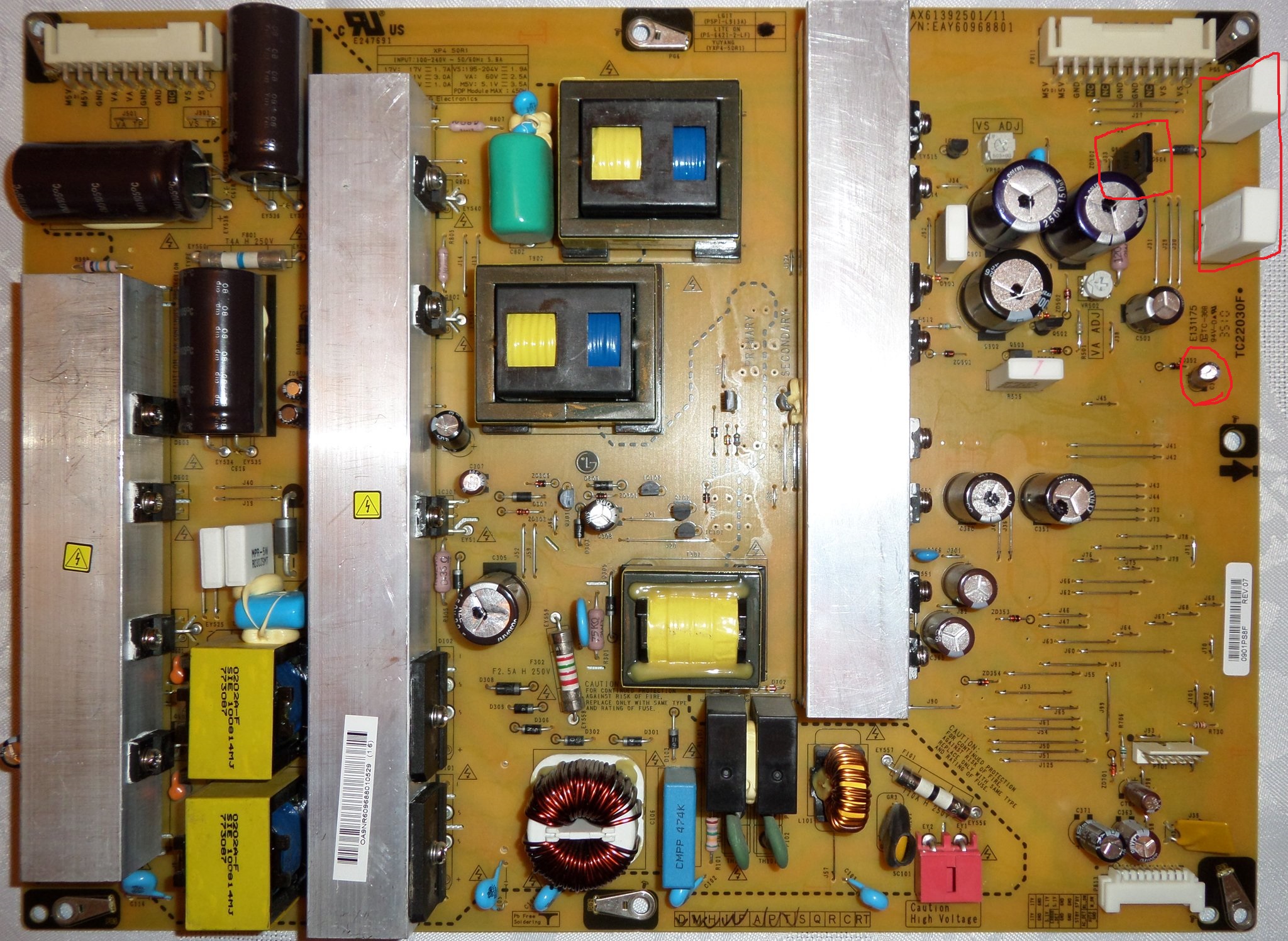

50PK350 Repair Log
  • ReeceyBurger123
    Never Give Up !
    • May 2014
    • 7325
    • Britain
    50PK350 Repair Log
    Brought this 50" slimline Lg Plasma for £80 off a local sales site on facebook. Has stand, remote and is full Hd so not too bad. Fault is it switches on panel lights up then the Tv shutsdown, protection circuit engages and shutsdown the Tv. Im suspecting a sustain board fault probably the Yfr fets short very common on these which loads down the Psu and causes it to shutdown.
    The Vset up ramp is working as the screen primes but doesn't dim (set down ramp not engaging properly) so guessing something is shorted I bet its the 30f124 or 30j124 fets on the heatsink on the Ysus that have shorted, seen it before on the 42" version of this Tv. We shall see
    TBC
    Last edited by ReeceyBurger123; 12-01-2015, 03:45 PM.
  • Hamie
    • Apr 2014
    • 1383
    Re: 50PK350 Repair Log
    From your description it sounds more like the common fault of the wirewound resistors failing on the power supply.
    • ReeceyBurger123
      Never Give Up !
      • May 2014
      • 7325
      • Britain
      Re: 50PK350 Repair Log
      Possibly Hamie, so many issues on these sets I have serviced a few not seen them resistors at fault yet seems common though from what others say. Will have to see tomorrow buddy.
      • ReeceyBurger123
        Never Give Up !
        • May 2014
        • 7325
        • Britain
        Re: 50PK350 Repair Log
        Well you are right Hamie one of the 2 resistors is completely open also smells burn, fets test good on the sustain boars. Got the resistors on order should hopefully sort it. I have also re-soldered the coils on the Zsus as they are prone to breaking through the solder joints on these causing issues.
        • Hamie
          • Apr 2014
          • 1383
          Re: 50PK350 Repair Log
          Do you have an esr meter reecy?
          • ReeceyBurger123
            Never Give Up !
            • May 2014
            • 7325
            • Britain
            Re: 50PK350 Repair Log
            I dont have one at my place atm, however my uncle has on I can access. How come ?
            • Hamie
              • Apr 2014
              • 1383
              Re: 50PK350 Repair Log
              There's a cap that usually fails but looks good. It will even test good with a capacitance meter.
              However test it with an esr meter and it's off the chart.
              It's the 16v 100uf cap usually located just below the resistors.
              the FET thats also close to the reistors (the one not attached to any heatsink) will also need changed, even if it tests good.
              If you change out only the resistors; the tv will work, but after a few weeks/months the resistors will fails again.
              If you change the capacitor and the resistors, almost every time as soon as you apply power it will short the FET and Short the resistors (obviously the will test short anyway but they will test 1-4 ohm rather than the 10 or 22 that they are supposed to)
              But if you change out the 2 resistors, the FET and the cap all is good.
              There's a few stories saying to use 7-10w resistors but they will also fail in a short time if you don't change the cap and the FET.
              • ReeceyBurger123
                Never Give Up !
                • May 2014
                • 7325
                • Britain
                Re: 50PK350 Repair Log
                Ok cheers, will have a look at it in a min will get some parts together.
                • ReeceyBurger123
                  Never Give Up !
                  • May 2014
                  • 7325
                  • Britain
                  Re: 50PK350 Repair Log
                  Hamie, what is the Fet the one just before the resistor ? At college atm but sure its something like a str250 will let you know after.
                  • Hamie
                    • Apr 2014
                    • 1383
                    Re: 50PK350 Repair Log
                    sorry i cant remember the part number, think i used a sub.
                    addding attachment incase someone else has similar issue.
                    • ReeceyBurger123
                      Never Give Up !
                      • May 2014
                      • 7325
                      • Britain
                      Re: 50PK350 Repair Log
                      Right, I replaced the resistors, the transistor also heatsunk the new one and replaced the 100uf 16v cap and the set now works Screen fired up no brun in what so ever. Now have a 50" 1080P PDP to sell whooooo ! Thanks Hamie
                      • comptek
                        • Aug 2013
                        • 606
                        • uk
                        Re: 50PK350 Repair Log
                        picked up one of these today clicking no screen prime, turns off again, no bad caps, replaced voltage regulator just in case no dry joints the 3 wire wound resistors are all between 10.2 & 10.4 ohm 5v,17v are there, ac-detect gets up to 4.6v or so and drops off again, NO VA or VS well VS gets to 1.3v and shuts off, all fets seem ok no shorts no burn items.....
                        tried disconnecting ysus and zsus still doing it any ideas chaps ?
                        regards Gary
                        • sordids999
                          • May 2013
                          • 2155
                          • uk
                          Re: 50PK350 Repair Log
                          check R103,R104,R105,R106,R107,R108,R109,R110,R111,R112, R113 on the underside of the power supply board
                          check 3BR1565JF for shorts
                          and the diode next to it out of circuit just lift one leg
                          good luck
                          Last edited by sordids999; 03-23-2016, 06:01 PM.
                          • ReeceyBurger123
                            Never Give Up !
                            • May 2014
                            • 7325
                            • Britain
                            Re: 50PK350 Repair Log
                            Originally posted by comptek
                            picked up one of these today clicking no screen prime, turns off again, no bad caps, replaced voltage regulator just in case no dry joints the 3 wire wound resistors are all between 10.2 & 10.4 ohm 5v,17v are there, ac-detect gets up to 4.6v or so and drops off again, NO VA or VS well VS gets to 1.3v and shuts off, all fets seem ok no shorts no burn items.....
                            tried disconnecting ysus and zsus still doing it any ideas chaps ?
                            regards Gary
                            Also checked the Vson signal bud ?
                            • comptek
                              • Aug 2013
                              • 606
                              • uk
                              Re: 50PK350 Repair Log
                              Originally posted by sordids999
                              check R103,R104,R105,R106,R107,R108,R109,R110,R111,R112, R113 on the underside of the power supply board
                              check 3BR1565JF for shorts
                              and the diode next to it out of circuit just lift one leg
                              good luck
                              All resistors measure ok not open or short either, i had replaced the 3BR1565JF just in case but no shorts, diode was checked out of circuit not shorted either way.... still stumped
                              • comptek
                                • Aug 2013
                                • 606
                                • uk
                                Re: 50PK350 Repair Log
                                Originally posted by ReeceyBurger123
                                Also checked the Vson signal bud ?
                                VS-on ? i have M-on and RL-on bud
                                • ReeceyBurger123
                                  Never Give Up !
                                  • May 2014
                                  • 7325
                                  • Britain
                                  Re: 50PK350 Repair Log
                                  Its RLON, the relays are in place to control the power signal to turn the Vs rails on.
                                  • comptek
                                    • Aug 2013
                                    • 606
                                    • uk
                                    Re: 50PK350 Repair Log
                                    Originally posted by ReeceyBurger123
                                    Its RLON, the relays are in place to control the power signal to turn the Vs rails on.
                                    yes bud both RL-on and M-on go to about 4v and stay up until it clicks again
                                    strange thing though without Z sus vs goes to like 1.355v then clicks then it goes up to 1.505 for example then shuts off its like its trying to ramp up then fails
                                    • Moreno83
                                      • Jun 2014
                                      • 2008
                                      • The Netherlands
                                      Re: 50PK350 Repair Log
                                      Reecy , Is this symptom you had on this set the same for the 60PV250? Can i use any 22ohm resistor?
                                      • ReeceyBurger123
                                        Never Give Up !
                                        • May 2014
                                        • 7325
                                        • Britain
                                        Re: 50PK350 Repair Log
                                        Originally posted by Moreno83
                                        Reecy , Is this symptom you had on this set the same for the 60PV250? Can i use any 22ohm resistor?
                                        Maybe mate, have you checked the resistors for the Vs output ?
                                        • Rictech
                                          Panasonic SA-MAX770PU SMPSU board fault....
                                          by Rictech
                                          Hello everyone. 😀
                                          As per thread title, this unit has a serious SMPSU fault. It blows F1001, which is a 10A M205 in the phase from the mains input.
                                          Very first thing I tried, was simply replacing the fuse, but the replacement ceramic fuse blew immediately.
                                          Looking at the schematic for this PSU, I then removed what I thought was the next likely candidate: D1001 - the HV main bridge rectifier.
                                          This isolated the fault(no longer blows the main fuse), but does not point me to the actual fault.
                                          There are no devices that have exploded or otherwise show signs...
                                          08-26-2024, 01:05 AM
                                        • howardc64
                                          Samsung QN75Q6FNA backlight no display, red LED blink 2x, fault in panel
                                          by howardc64
                                          • Prior owner tried a replacement main board. No difference.
                                          • Samsung 2x red blinking standby LED = panel fault
                                          • Jumpered FB_TRDY_1 (pin 1 CN1300 left. main tcon->left side buffer boards) and FB_TRDY_3 (pin 95 CN1301 right. main tcon->right side buffer boards) This allows testing individual T-Con (on main board) connection to panel on this Samsung. Found fault on left side (viewing from rear of TV)
                                          • Each side has 2 buffer boards, disconnected left side flex between 2 buffer boards. Fault is on the left most board.
                                          • Tape masking eventually isolated to CN1300 pin 15 (CKV4_GOA) Display
                                          07-19-2025, 10:54 PM
                                          ESR meter came to the rescue again today with a PLC I/O card fault
                                          by sam_sam_sam
                                          I have been having a fun time at work with two pieces of equipment that had shorted components or shorted component cables to machine frame
                                          I would check what my multi meter was telling me about how many ohms I getting with the multi meter was telling versus the ESR was telling me about weather or not it really was a short to machine ground or not
                                          One note at first we thought that it might be a bad I/O card or a malfunction PLC including me as well but I thought I would try and see if removing the I/O cables would make a difference or not and this time it did make a difference...
                                          12-18-2023, 08:17 PM
                                        • cazi1001
                                          Strange fault on Lenovo ThinkPad E14 Gen. 2
                                          by cazi1001
                                          I have a strange fault with a Lenovo ThinkPad E14 G2 (Board No. NM-D011 Rev. 1.0).
                                          The first Problem, which I fixed already, was a dead TPS65944AD (USB Type-C) controller. After I fixed this fault, all functions working fine and the notebook run very well with the charger and battery.
                                          On the next day, I tied to start the notebook with the battery, but nothing happened. I started with the charger and on windows, I saw, that the battery was empty. And this was nearly impossible, because the battery was charged. I disconnected the battery and found out, that the board...
                                          03-24-2024, 04:16 AM
                                        • spleenharvester
                                          Cordless Dremel 8220 rotary tool power fault
                                          by spleenharvester
                                          Hi all
                                          I bought this Dremel several years ago (8220 + 880 2.0Ah battery). After about a dozen light uses it developed a power fault. I asked Toolstation to start a warranty claim for me and they just refunded me in full without asking for it back instead. Would be nice to fix it instead of consigning to the dustbin.
                                          It is complete luck of the drawer whether it powers on or not. Sometimes it will be completely dead, no lights no response. Switching power on and off repeatedly and/or removing and reinserting the battery will eventually make it spring to life. After that...
                                          04-13-2025, 02:10 PM
