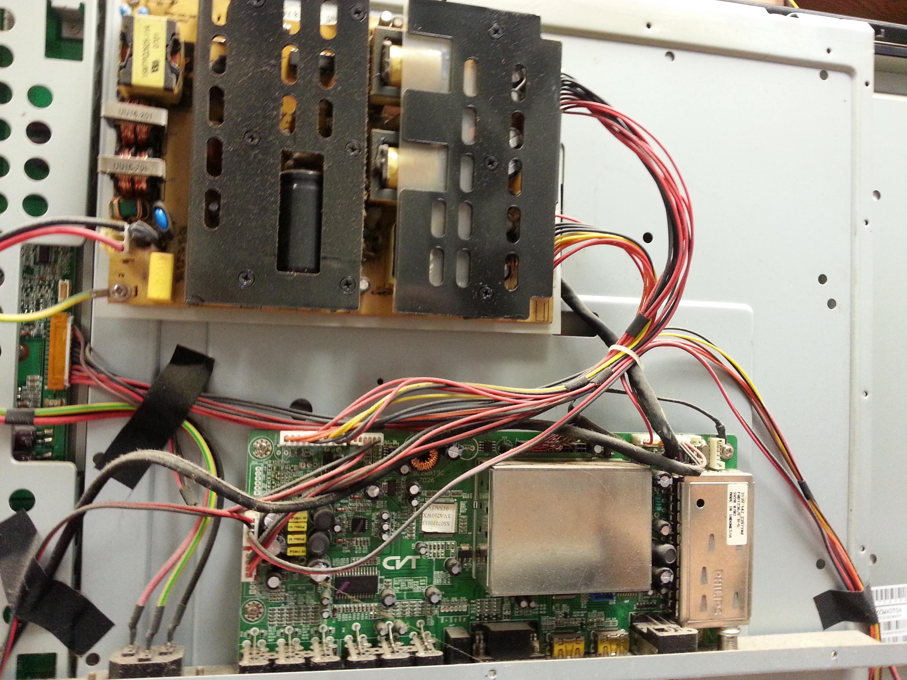

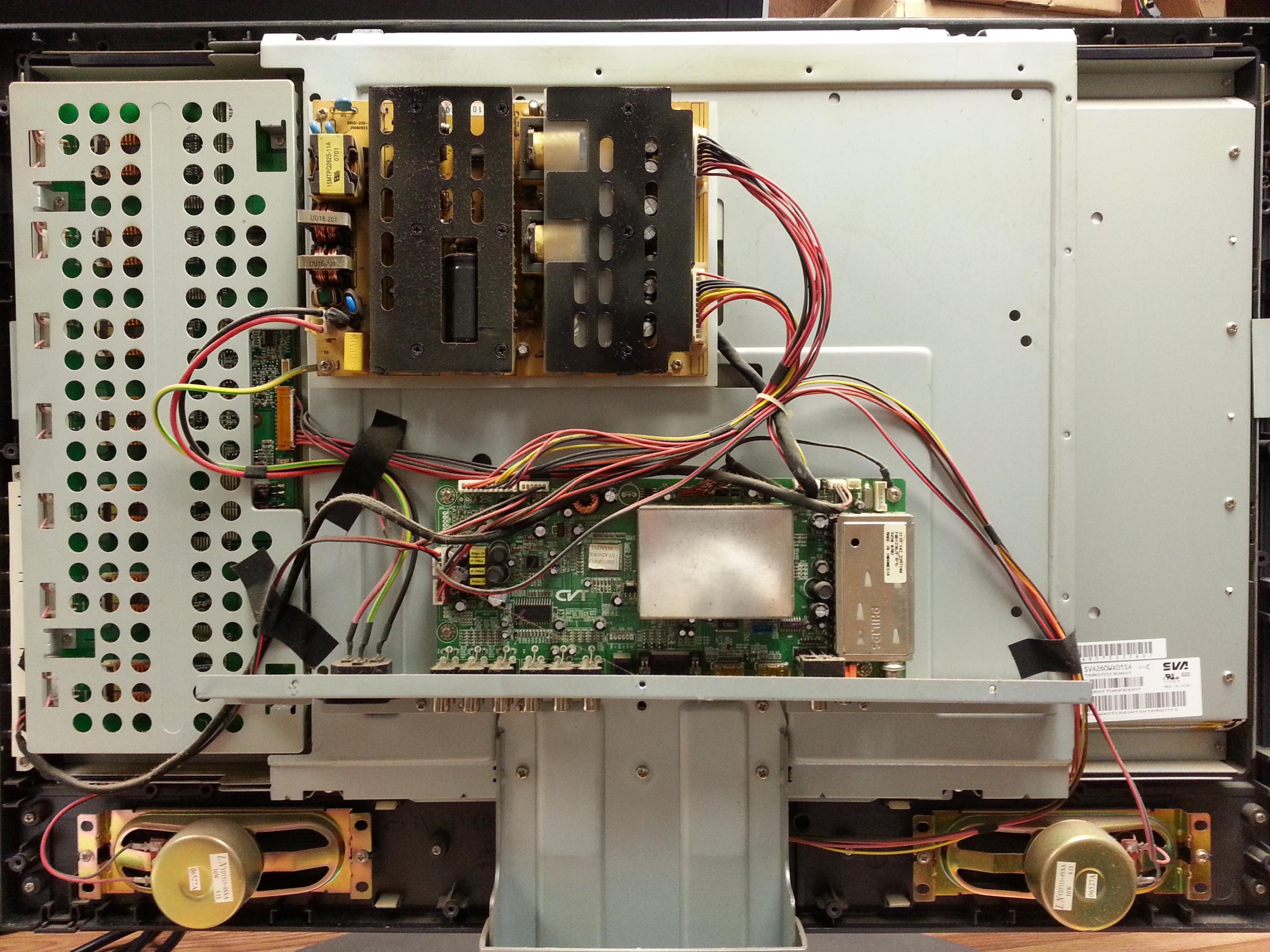

    I'm working on a circa-2007 "Proscan" brand 26" LCD HDTV. When it is plugged in, the red standby light comes on, but when the power button is pressed, the blue power light only comes on for a fraction of a second before returning to red. A brief visual inspection of the internals reveal no obviously bad parts. Any ideas as to what could be causing this?

    unplug the cable from the lamp invertor and try again,
    it it still wont start, it's probably the psu - are the caps under the black heatsinks visibly o.k. ?
      Re: Cheap 26" Proscan 26LA30Q LCD Television won't power up
      These look bad to me.
        i agree Budm first thing i noticed

          Indeed
          Ah, good eye; not sure how I missed those .
