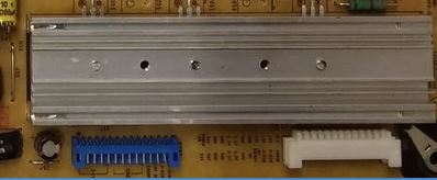

                    Can you supply a closeup picture of the blue and white connector and the text written alongside giving the pinouts.

                        Re: lg 32lv375s no backlight no picture
                        http://postimg.org/image/5g2fw39mh/
                        rechecked the block capacitors,all OK,but the gretz don't have any voltage on middle pins,and side pins
                          Disconnect the white connector and check the power supply by connecting a 1K resistor from Power-On to 3.3V on the power supply white connector and check for 12V & 24V
                            With 1k resistor i have 12V and 24V on the pins and the 3.5V
                            • dick_barton
                              • Aug 2015
                              • 6642
                              • Wales
                              Remove the Power On pin carefully from the connector and plug the white connector back into the socket. Connect the loose wire to the 1K and connect to the 3.3V and check your backlights.
