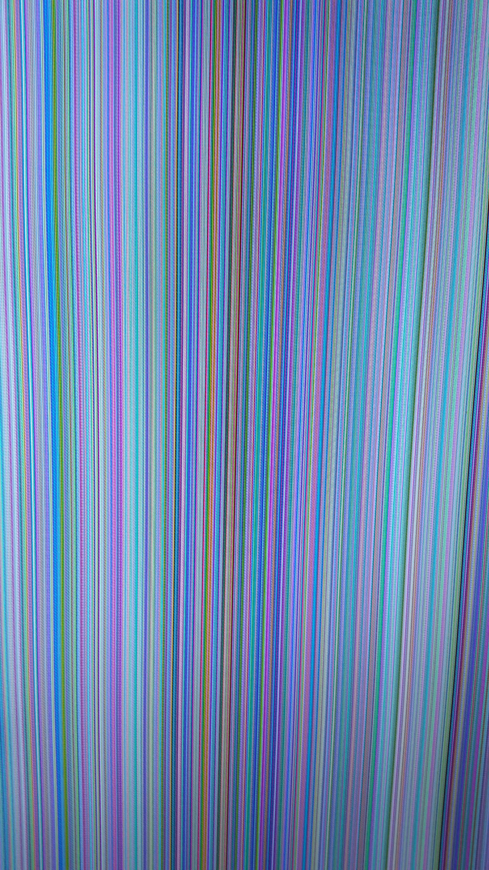

    I have a screen full of colorful vertical lines on my screen. Samsung UN55B7000WFXZA
    Hey gang, this all started with a ghost picture, was like having two pictures offset on my tv, I scouted forums, and decided to try and reset the ribbon cables on the t-con board and even tried putting a piece of tape, yada yada, nothing worked. Now I have a screen full of colored vertical lines. I cant even get the ghost picture back up. I bought a new t-con board, the same lines still there. I cant see the menu, or any display, just these lines. I can change the source with the remote, it changes some brightness between changes but no picture change.
    Any of you guys have an idea of whats wrong?

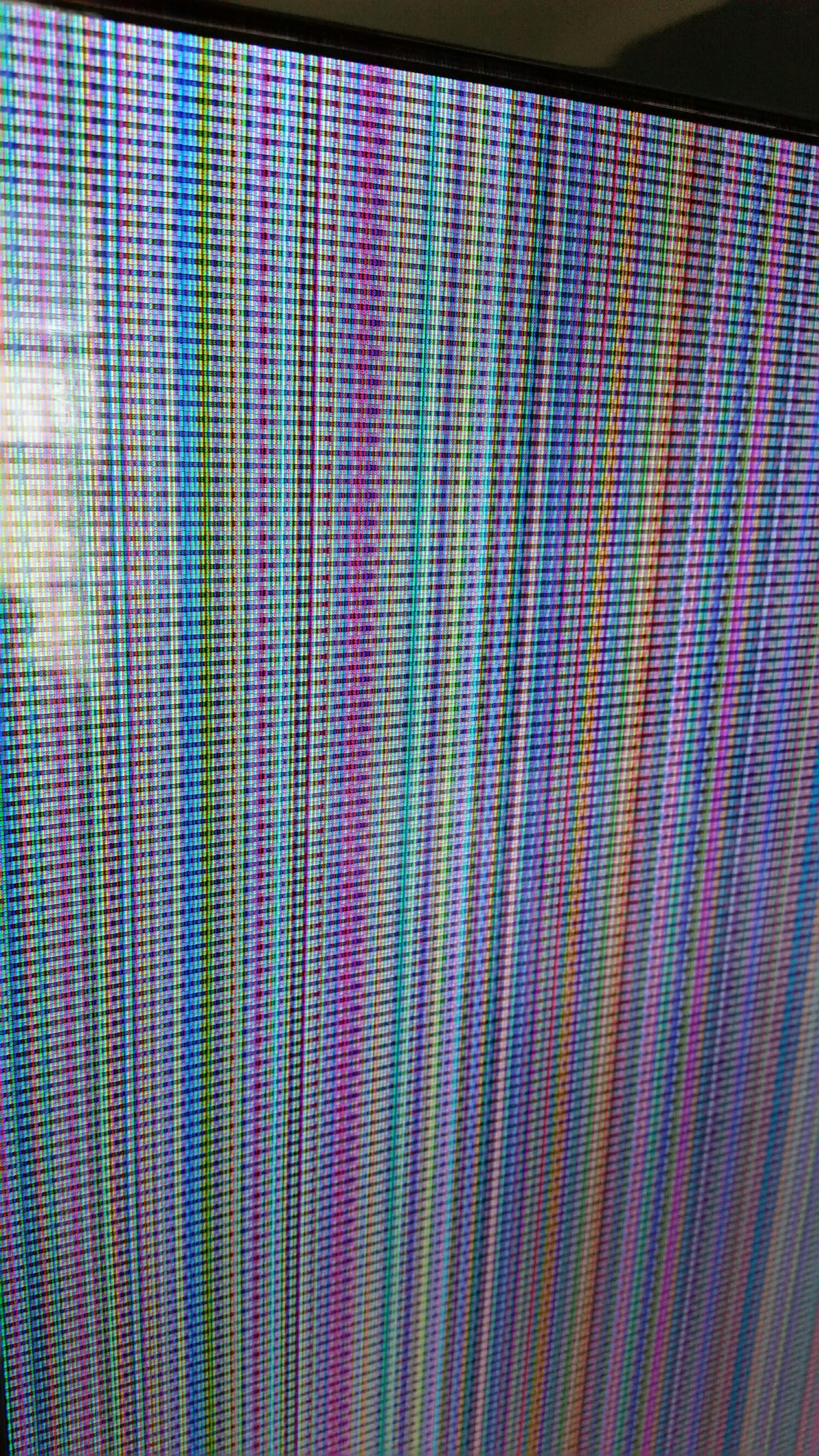

            Re: I have a screen full of colorful vertical lines on my screen. Samsung UN55B7000WF
            I visually inspected all of the tabs on the edge of the panel and didn't see anything that looked burned or loose, I didnt try pushing on them with tv on though. It went from ghost image to this with me messing with the ribbon cables that attach to the tcon board... I purchased the t-con board from a seller on ebay in china, took almost a month to get here. my board is a 02719k and the one sent to me is a 02852d. The seller said they are compatable.. the screen looks a little different when I put in the new board, instead of smooth vertical lines, it has some horizontal looking lines. Ive attached pictures of the screen with the old board and new board...
            My question for you guru's, if it was a tab, would the entire screen go colored lines like this, wouldn't only a portion of it? Is there anything else that could do this?

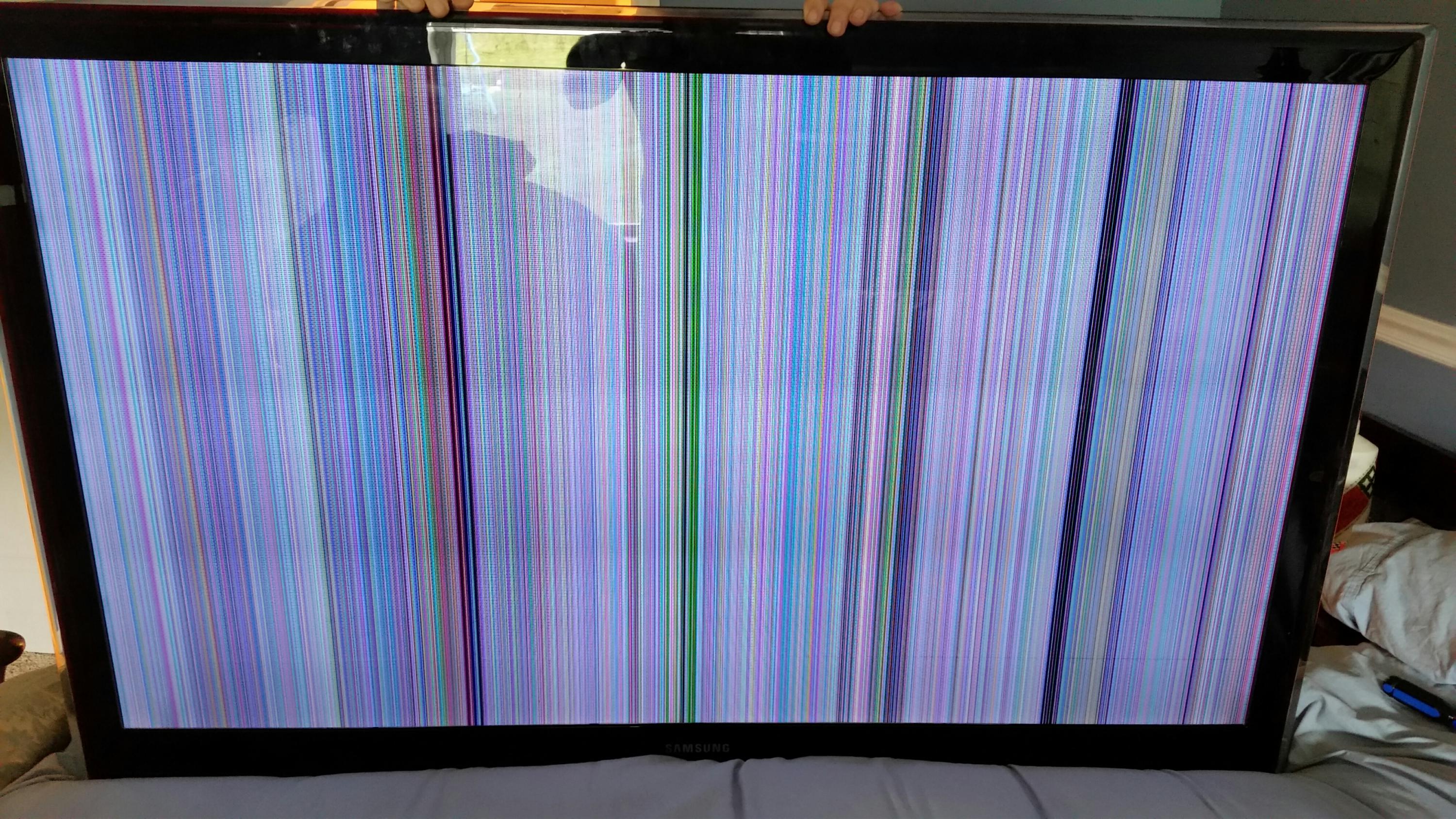

                Hello all, I'm dealing with a Samsung LE32C530F1W that now has vertical lines on the right side. It started with a ghost image on the top of the screen and then I tried the old trick of masking a few contacts in the flat cable that connects the T-Con board to the screen with some tape. It worked for a while and now out of the blue it turned into what you can see in the pic. I was able to get my hands on a known good T-Con board but the problem still persists. Now, what I've noticed is that the cooper colored flat cables that are directly connected to the screen itself are very hot to the touch...
