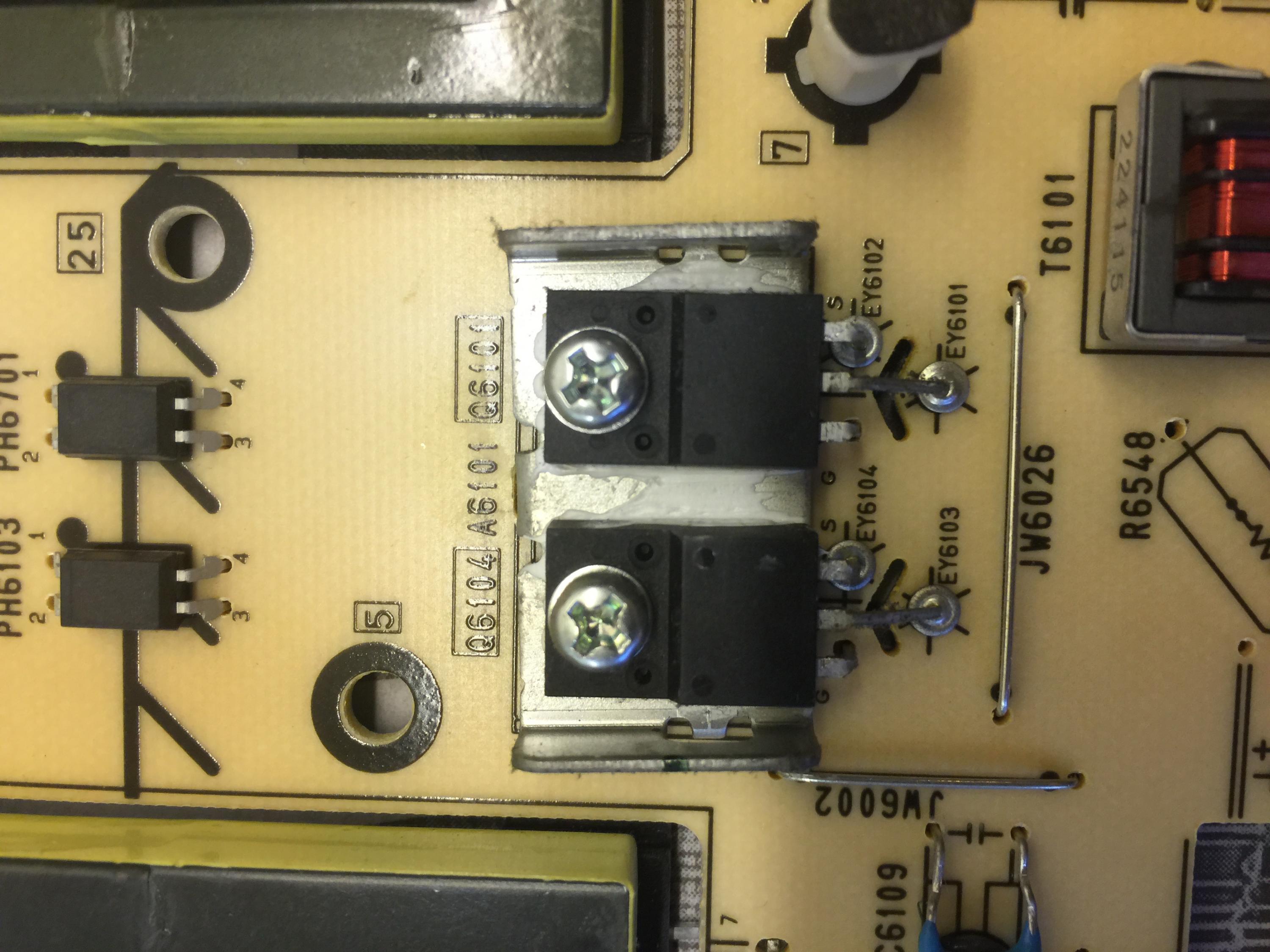

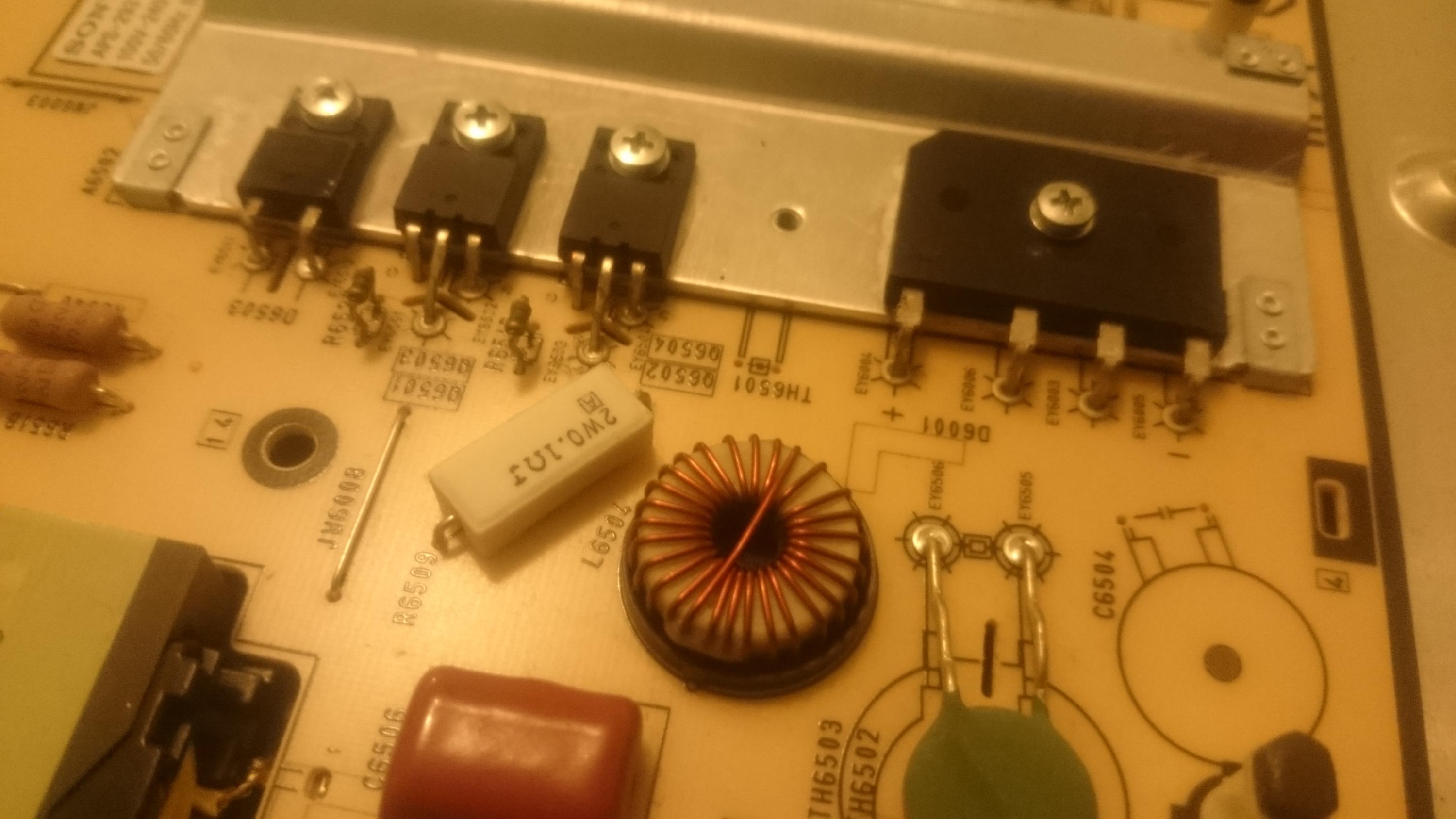

    hi all, just got this in, now it seems like a common fault but I cant seem to find the schems in the Service Manual
    Ive found that the R6548 Ceramic Resistor of 0.1 ohm/1J6 has Blown - now before I change this I was wondering if I should be checking any thing else other than the obvious Transistors that normally short, ive had the meter on them all and nothing seems to be out the ordinary from what I can tell
    any advice would be great

    Have you checked the transistors ?
    Its very unlikley thats just the ceramic resistor has blown.

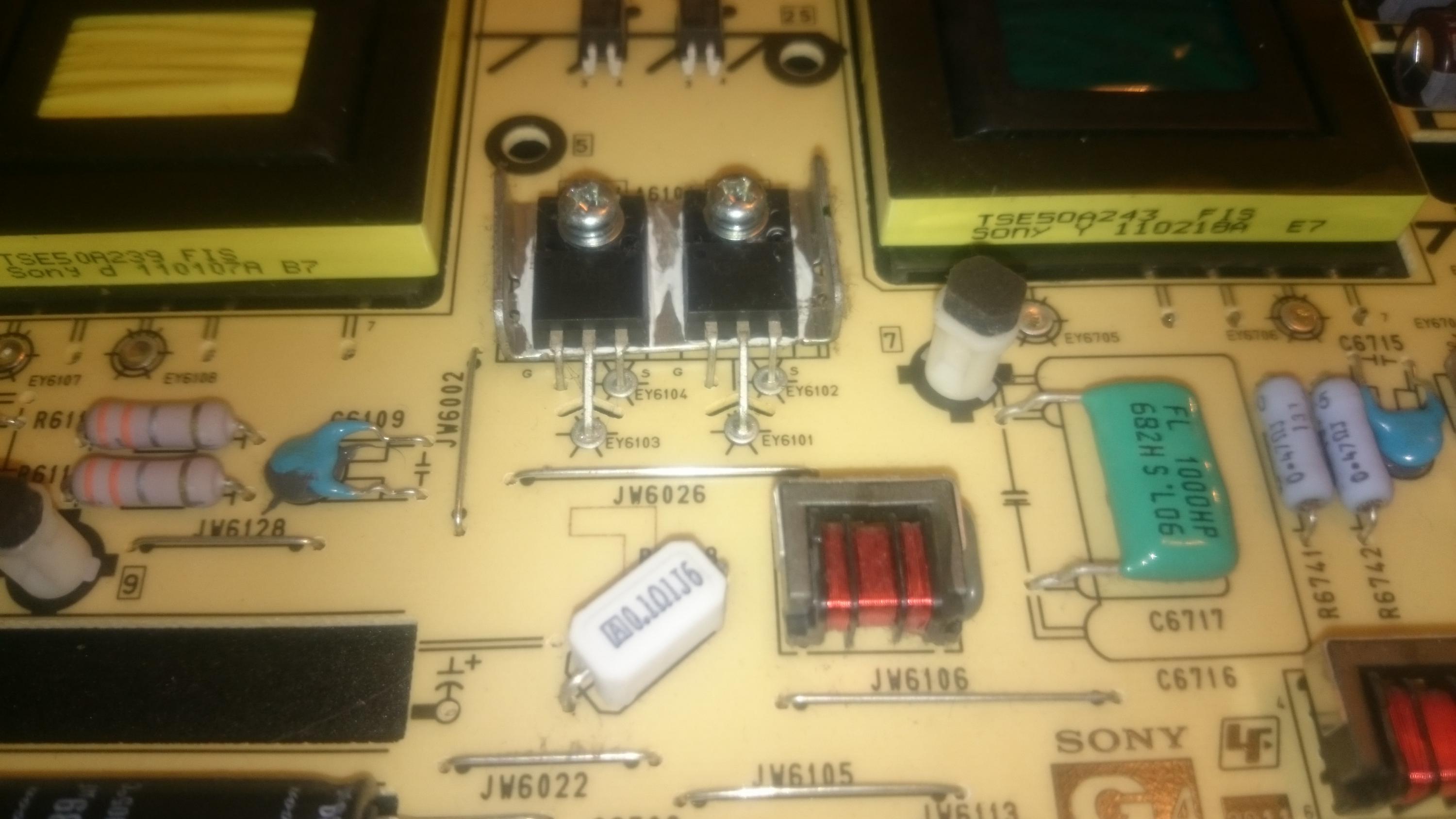

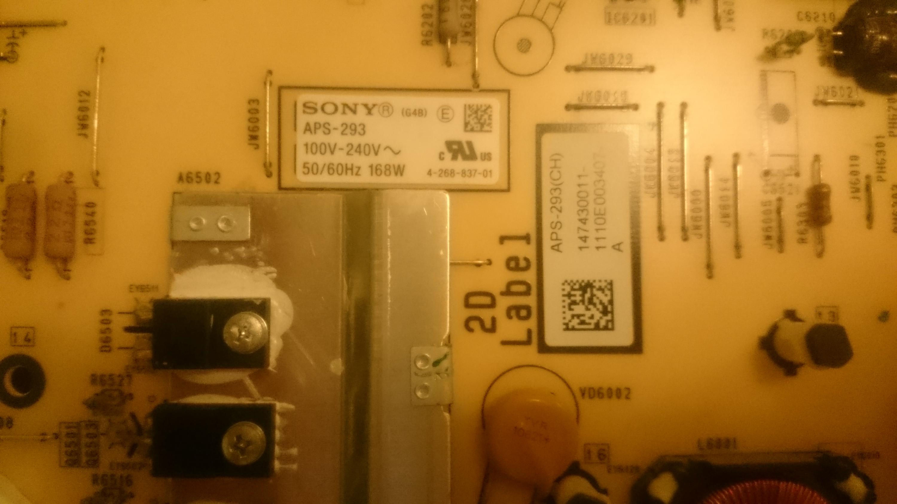

      Re: Sony KDL-40EX723 - 2 Blinks
      Ive diode checked across them....
      from left to right pins...... 1+2 I get 0.65v on diode and 2Meg ohm resistance
      1+3 I get 0.17v on diode and 330K ohm resistance
      2+3 I get 0.5v on diode and 2Meg ohm resistance
      thats on both of them in the 2nd pic

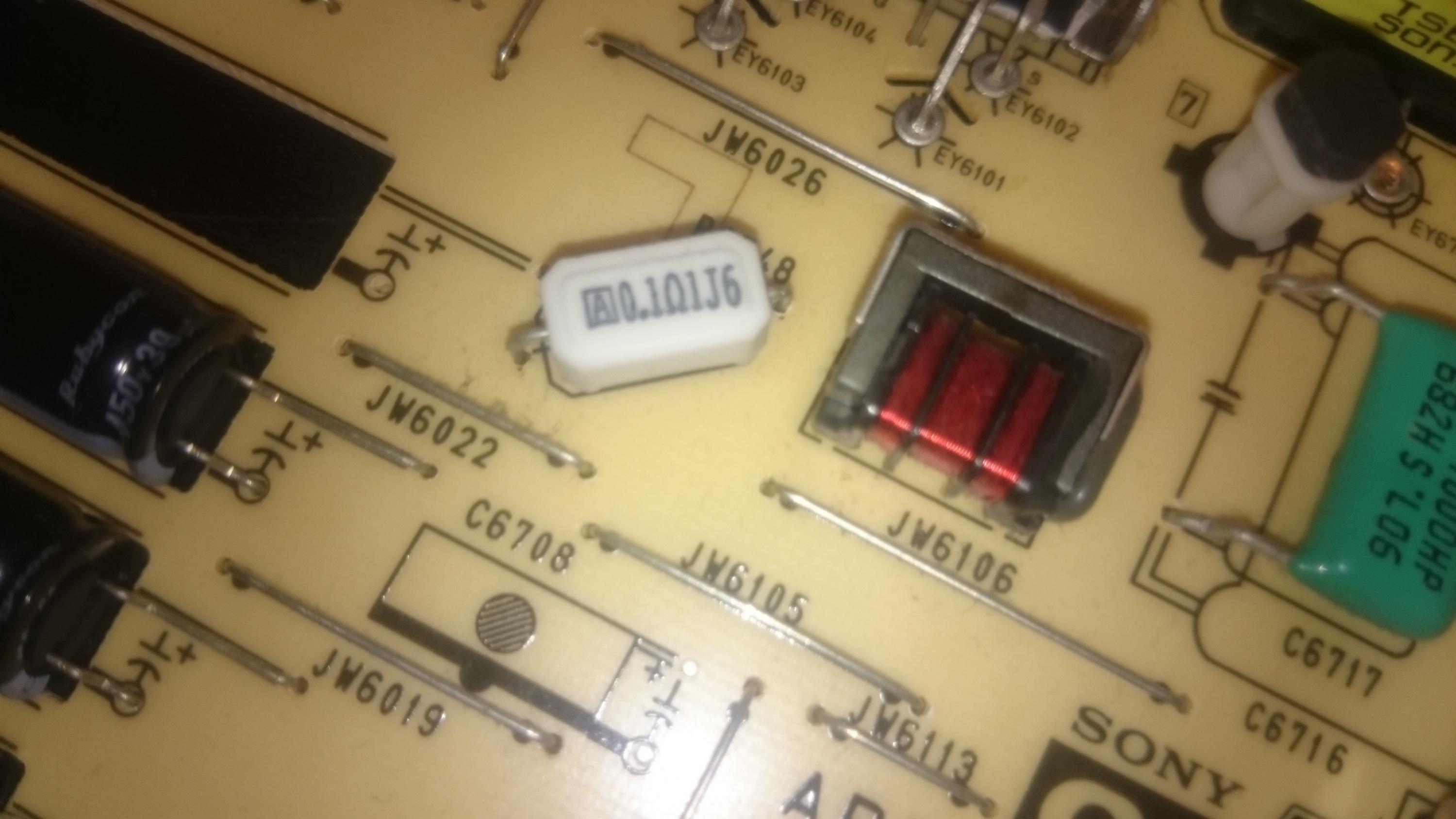

            anyone know what the difference between a ceramic and a welwyn resistor is? and if it will be ok using that instead, cant find one of the little ones the same as pictured :-(

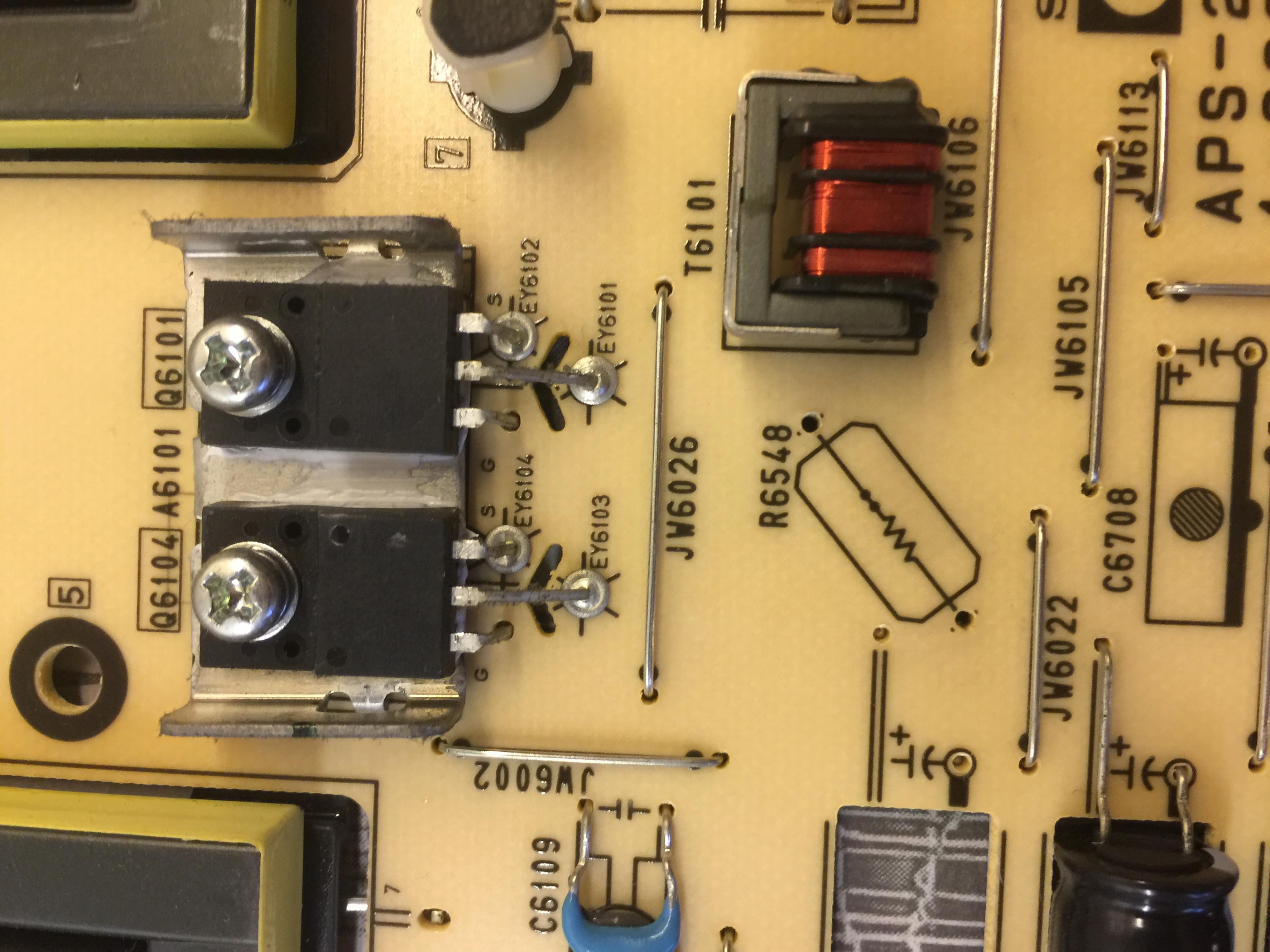

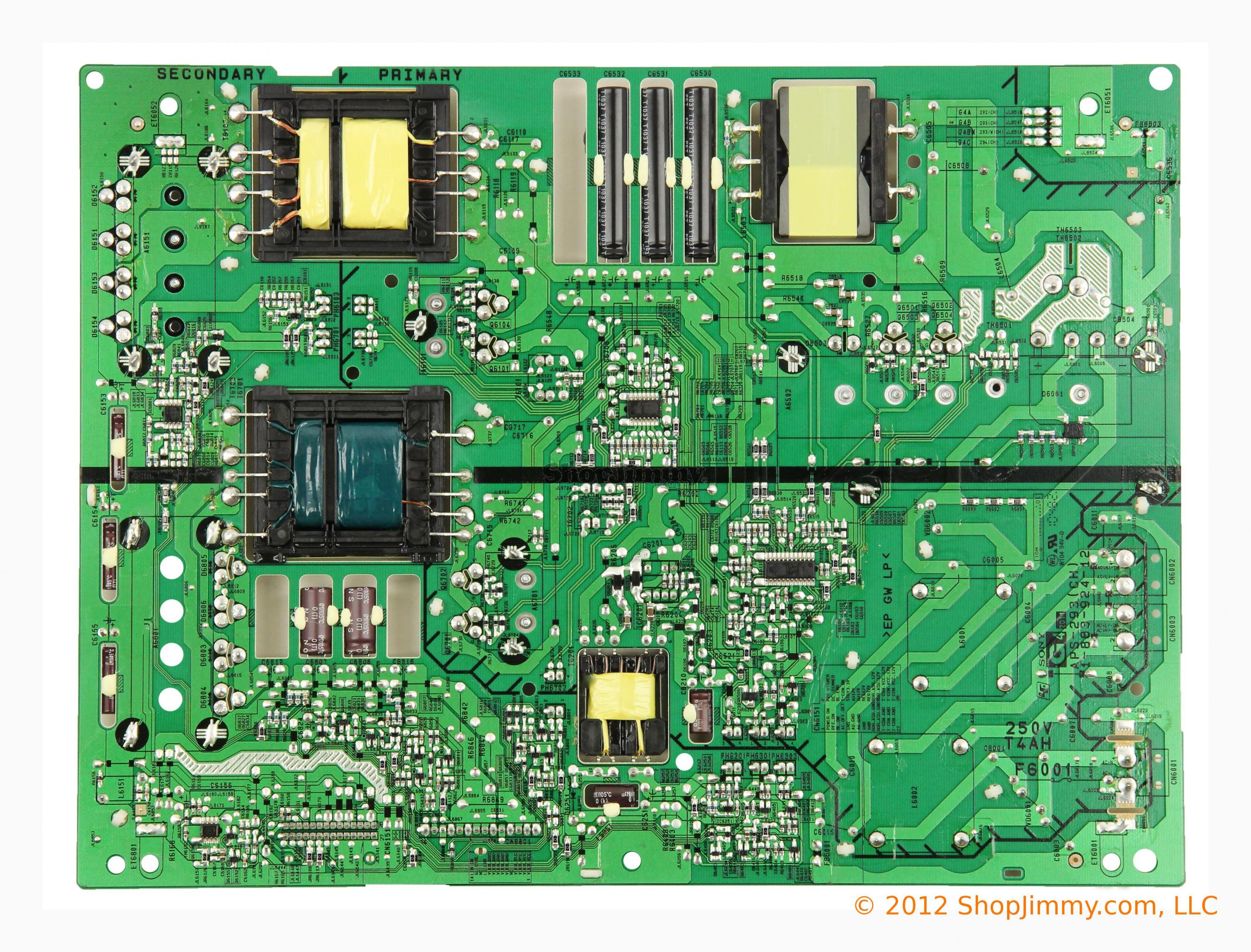

              That is the fusible resistor, so you have shorted out component on the output side of the resistor which will be the power MOSFET Q6101, 6104, 6701, 6702.
              APS-293, APS-293(CH)
              Pictures provided by shopjimmy.
              http://www.shopjimmy.com/sony-1-474-300-11-g6-board.htm

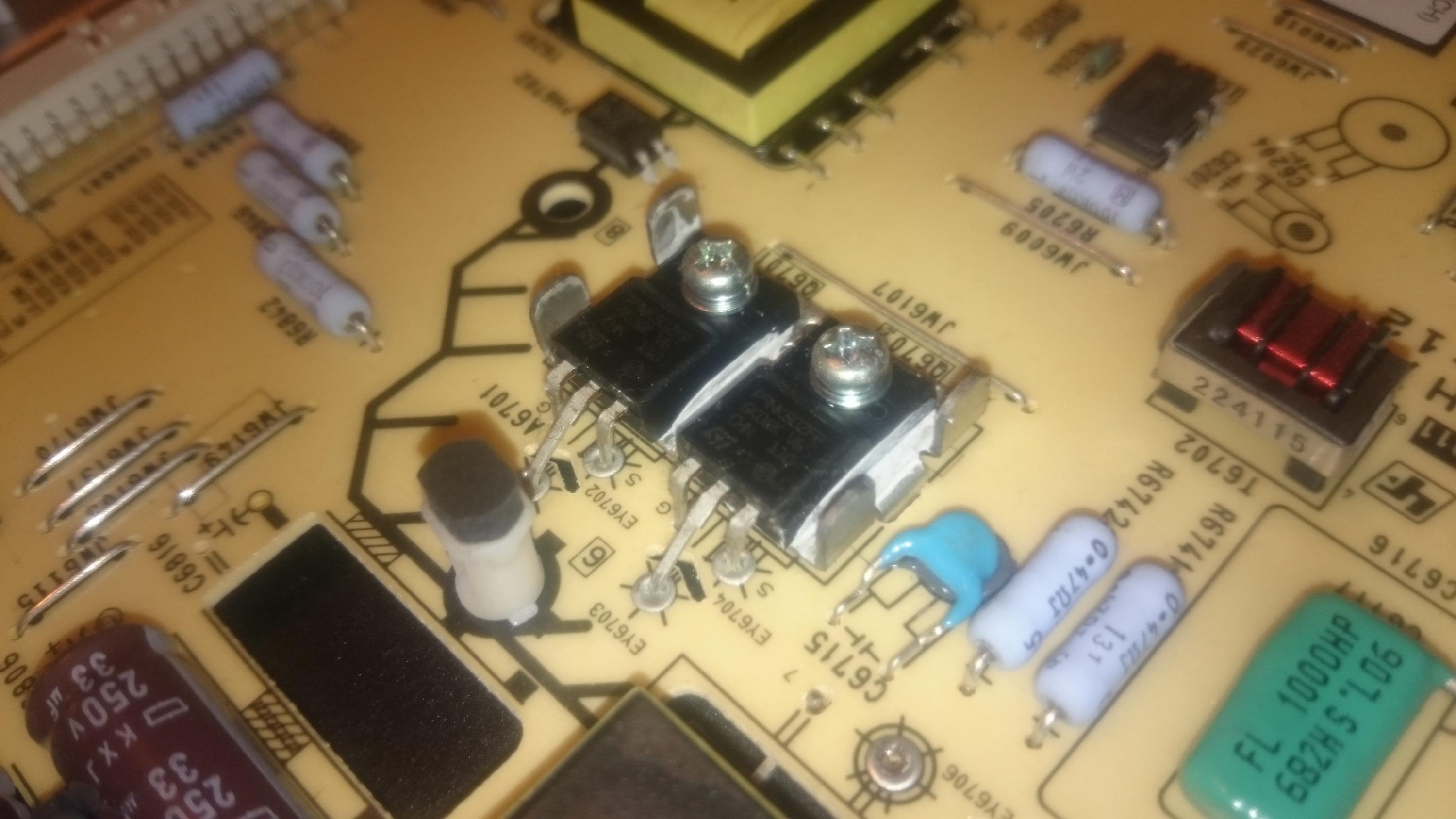

                just tested Q6701 and Q6702 and its 0 ohms across all pins will remove tomoz and retest :-)
                I didnt test them I must of missed them 2, but thought Id tested them......doh!
                thank you budm
                  Successfully fixed, thank you guys for all your help again
